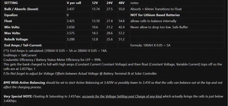

Below is my recommended Solar Controller / Charging settings for LFP.
Steve's Recommended SCC settings

Thanks Steve! Glad you’re still checking in.

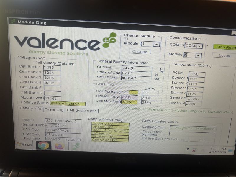

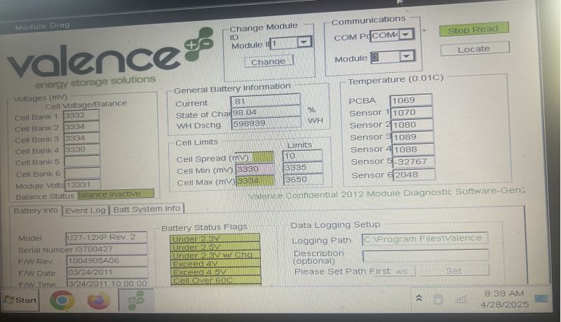

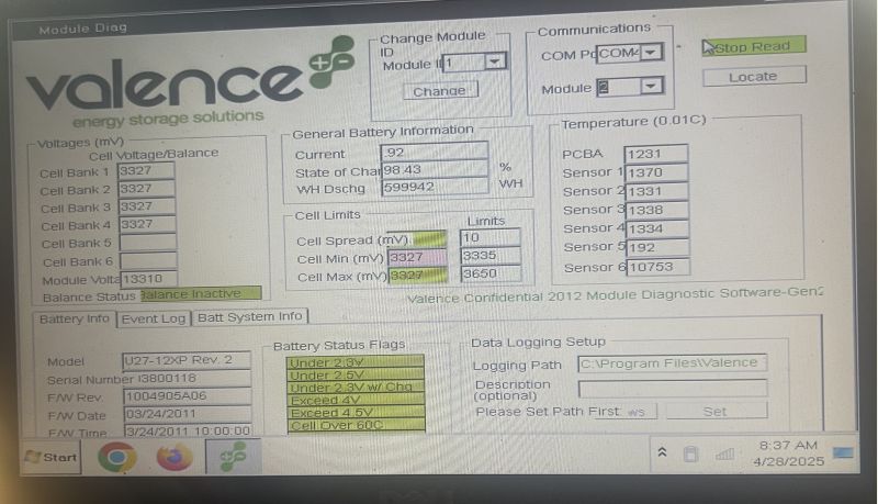

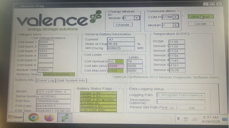

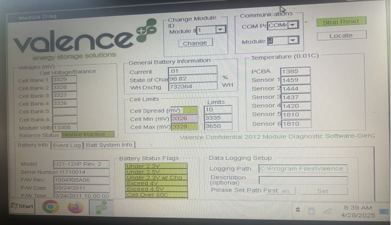

All this talk got me to plug in my old laptop (windows 7!) and have look at my 4 LFPs, which have been working great. This is what they read, 9am, tv on, inverter, wife peddling away on her stair stepper thingy, fridge on.
Looks ok to my blurry eyes, except one battery shows .01 current and the others .5-.9. Don’t know if that means going out or coming in. Solar monitor says 5 amps coming in.

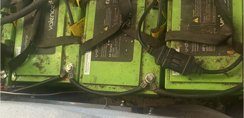

Couple of things about my last post/images. First, the bat that showed .01 current again had a loose terminal. I swear, the dog must be going over there at night and messing around. Tightened it up, all currents now close to matching. Then I turned on the microwave oven (some leftover beef stew for lunch but that’s beside the point) and current values went up to 24 per battery, so that is amps out.
This is all 20 year old technology, came with the Valence batteries. Haven’t pulled it up in a long time, usually just read the charge controller panel, but glad I did this time. Darn dog.

Paul, I think its a good idea once a year to pull, clean and reinstall all those connections to avoid surprises.
# Posted: 29 Apr 2025 10:39am
Right. And my batteries are interconnected by individual short crimp terminal cables. Remember I did this when we were all children. When I bought new bats last year end, a friend gave me enough of this thick bar stock to make bus bars, but with the old bats still hanging in there I not messing with it till I change them. At least your thread here got me to pull up the valence software one more time and discover the loose bolt. To be honest it probably wasn’t the dog, I’m always testing some new 12v gadget by taping into those bolts.
