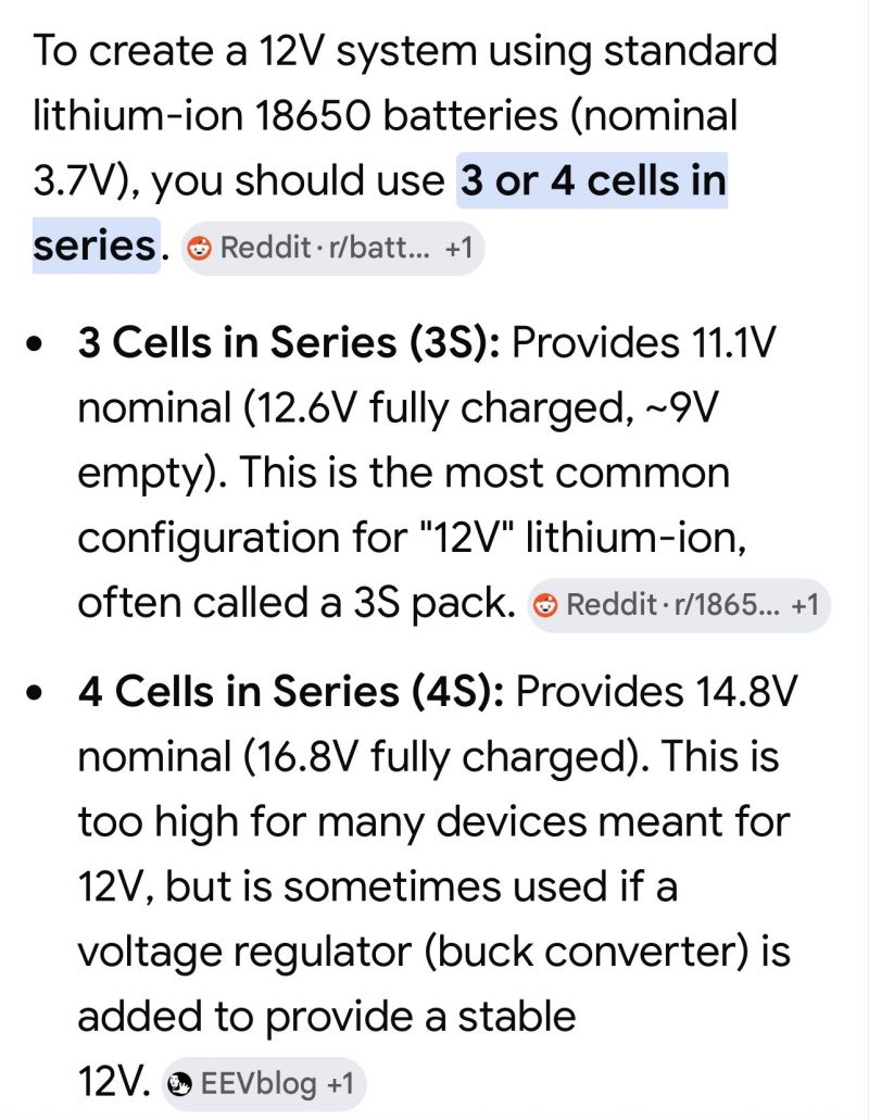

12v
# Posted: 21 Jun 2026 03:01pm
That looks like a pretty generic, maybe even AI, page of questionably (to me) 'info'.
I dont think Ive ever seen a 3S pack with a 9-12.6v rating and believe that would result in early device shut down due to Low Voltage Disconnect on the '12v' stuff we run in cabin.
The 4S I believe is what our typical 12v LFP's use and they settle in voltage quickly to ~13.3/13.4v so no worries about that paper's 'high voltage warning'.

LFP versus NMC/NCA chemistries follow different config rules due to their voltage curves. That AI generated twaddle is best left ignored. LFP is the closest "proxy" for FLA voltages & power delivery curves. For example: 24V systems 30.0V charge is acceptable for both FLA & LFP as is 15V for a "12V" system.

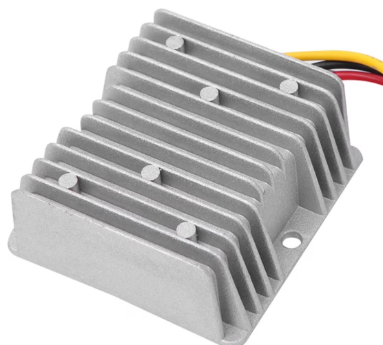

Cheapo "buck converters" will 80% of the time will fail due to over-voltage because they rarely can handle a proper charge voltage, such as they will not take more than 13.0V. for a 12V system. The "Good Ones" take into account a higher potential source voltage and regulate a precise output voltage and can compensate.
I actually run 24V & 12V DC devices with proper regulated converters that deliver precise voltages. That runs Ether Switches, Modem/Router and even a couple of Raspi's - none of which have tolerance for screwy voltages. I quite literally melted down a few buck converters (1 terribly scary one caught fire) but they were those cheapo's that folks buy without realizing it.
Image of the Most Evil types...
Cheapo Buckverter
Cheapo Buckverter

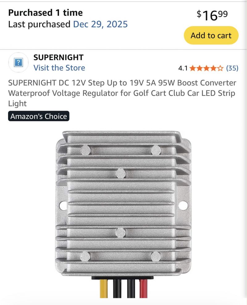

Thanks Steve. Speaking of volt converters our 40” TV uses one. Same old TV i used to run on AC until last year when I realized it used a 19vdc power supply, so I bought one of those cheapo converters like you pictured, 12 to 19 volt. Now it runs right off the bank, no inverter. So far so good. Its a flat screen LED, doesn't use much juice.

The devil is certain in the details (specs). Those"Buck Converters" are trixy ! I went through 3 (last one caught fire) the first 2 burned out, and one of those passed along the "24V" to 12V which fried the motor on the RV Furnace in the powerhouse. Boy I was emitting a lot of "Blue Words" because it was -20C outside then, fortunately I had backup options.
Using the 12V examples. The detail to look for is the Input Voltage that they can take (in the spec fine print) where some will only take 24V, while others may take 30V, and of course, my being 24V-based it means I charge my battery bank @ 28V, so the input has to handle that. I then chose to buy a slightly more expensive ($30 USD) converter/regulator, which always outputs a clean 12V regardless if input voltage is 28V or 23.0V (my cutoff).
Those "Potted" ones are a nasty piece of work and if you ever tear one down you'll understand.
A digital device like a TV, Router/modem/Rapsberry Pi, have no surge draws and are light power-wise is one thing but anything that has a surge draw will fry these little buck converters, they just aren't designed for that. IE: Never try to run a 12V fridge with one of these !
