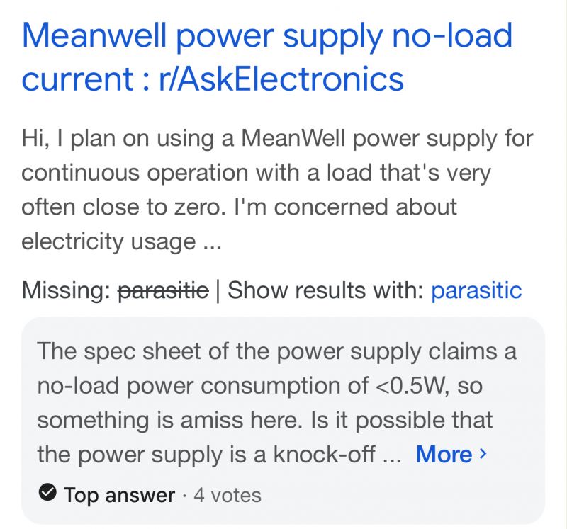

My Meanwells paperwork is misplaced as usual but found online text saying the powered off consumption is <.5W. Unless I’m misunderstanding.
That said, one of the two I had wired to the bank quit a month ago (just testing, solar doing the job at present). Wonder if that caused a capacitor to wear out. Could have also been funky AC output from the genny but the other is still ok.

Played around a bit yesterday. The Meanwell, unplugged from AC power, drew .12 amps, immediately after the DC hookup spark, and that figure continued indefinitely.
Next the inverter, that drew 1.7 turned on with no AC plugged in, but turned off Zero, 0.
# Posted: 6 Sep 2025 12:16pm
That looks like it accounts for my drain-down while hooked to the MW. Lesson learned!

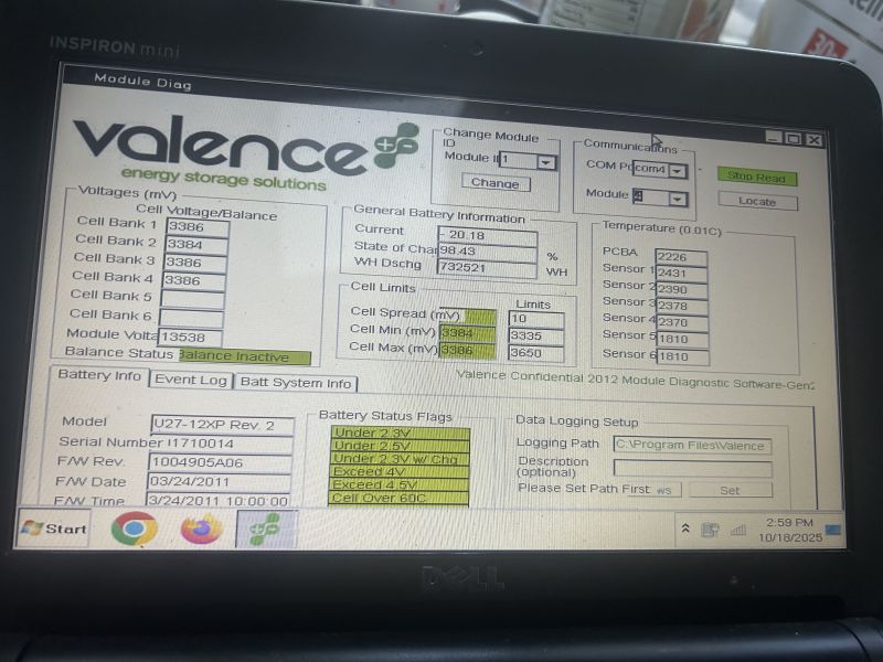

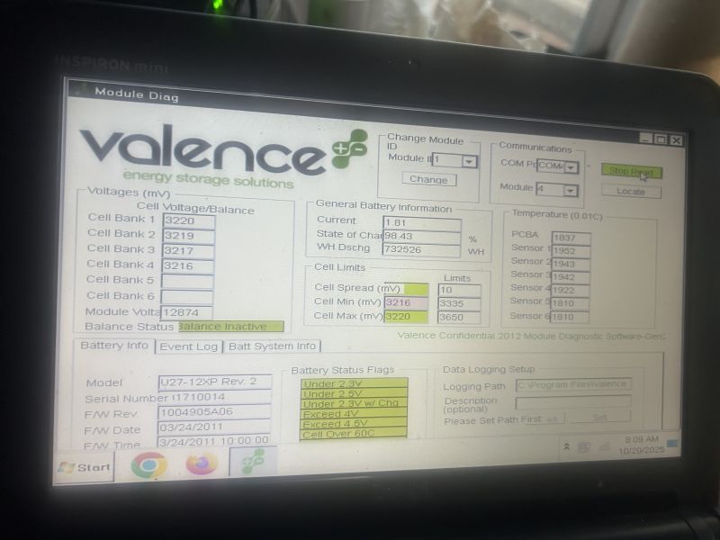

YesterdayI fired up the big gen and ran my bank for about an hour, over 80 amps going in. I stopped at about 13.6 volts, I have run them up over 14 in the past, don't recall how long that took. Second photo is right afterwards, of one of the 4 batteries, other 3 within a hundredth of same.
Soon dropped to 13.2, the sweet spot. This morning way down to 12.8, first photo. Still cabin fine, even nuked my food. Green lights still flashing on bats. Got to be in danger zone, how much lower?

Hi g, i have a full time ammeter going. It’s between 5-8 amps all the time. Fridge uses about 3, modem about 2. Those run 24 hrs. Throw in a few hours TV, half dozen bright LEDs, phone and laptop chargers, occasional water pump, nuker, toaster..
But yeah, does seem like the 15 year old lfps are feeling it. Fresh ones bought last Christmas are sitting under the bed waiting.

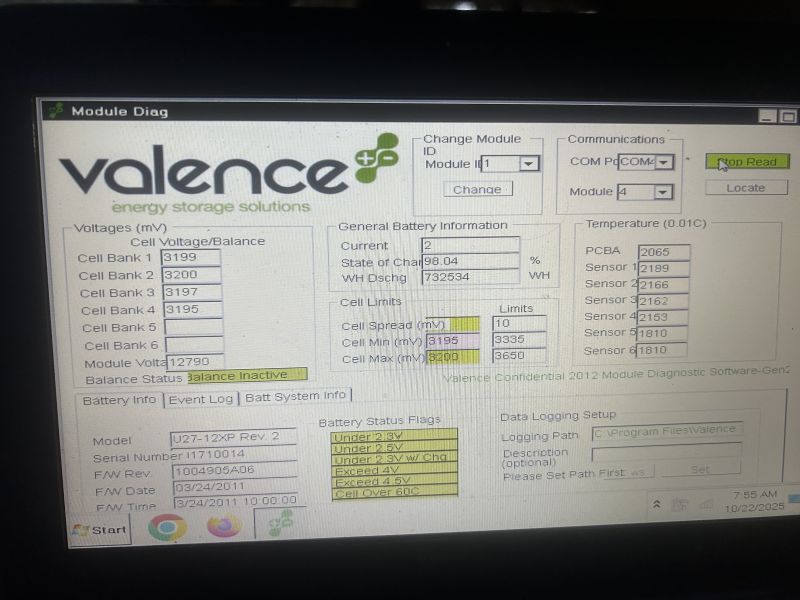

G, we've read how Steve and others warn that voltage is a poor indicator of state of charge, but for us dopes it is the simplest indication.
So yesterday after no charging for a couple days (my shaded solar now gives out under 5 amps for an hour or two), voltage was down to 12.79, yikes! But everything still working.
Later that morning I had to split some rounds with the electric log splitter so while the big genny was going I had the charger plugged in. Again it ran the bank up to 13.6 but no higher, even after an extra hour afterwards pumping in 80 amps. Dropped to 13.2 shortly after as usual.
The good news is this morning it”s still at 13.2, even after nuking the eggs and toast. A bit more watching but I’m becoming a believer in this voltage equals state of charge not so usefull.

Small correction Paulz, I haven't said that Voltage is a poor indicator for any Lithium-based battery tech and some will argue that as you pointed out. Simply put, it is the only way to see your State of Charge and Depth of it. By depth I mean the saturation level, s opposed to the surface level which requires a slightly different way of accounting as opposed to FLA for example. The accuracy & calibration of the measuring device(s) is critical for this, so that the device reports actual voltage as seen on the batt terminals, taking into & corrected for losses along the wire - the proverbial offset correction.
Example, the Midnite Classic SCC's have offset settings so you can compensate for the line losses between SCC through to batteries. That will show True Voltage as a result. My Samlex Inverter does not have such a feature so I have to manually correct by including the offset values in the settings for both charging and discharging... BTW: the offsets are different between those two modes. This is a fact, but most trip over that, as it seems "unnatural" being electricity. Gauge & quality of wire does have an effect on this of course.
13.2V = 3.3V per cell is pretty good for 15 year old batteries. IF you could charge to 13.8V (3.45 vpc) and maintain a charge till that amperage drops to 5A that would fully saturate the cells (fully topped) they would still settle to somewhere around 3.380 - 3.350, For real accuracy to determine actual SOC, you need proper 3 decimal measurements which most gear unless really new won't do, and even then, the cheaper devices won't do that. FYI Midnite Classics only do 1 decimal point as they were designed for FLA, my Samlex EVO only does 2 decimal and designed for multiple chemistries from the outset. 2 decimal is most common now days. The voltage charts I posted previously show those breakdowns ... that 0.100 difference is actually significant when it comes to SOC. This is not the case for FLA etc.

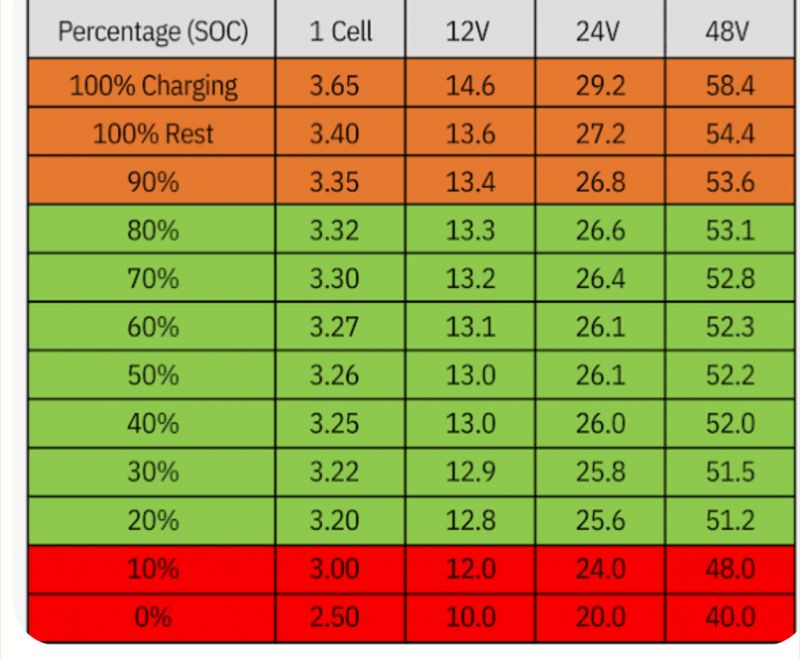

I’ve been going by this online common graph. So both you and I were down in the borderline red range. Mine dont have LVDs that I know of. There must be some documentation of when yours kicks in.
# Posted: 25 Oct 2025 07:36pm
Ive used similar charting, according to that I should be at 15%ish soc (leaving more on the table than I like).
The bat co literature states LVD as something less (iirc 11.8?) but this one has always shut down higher. By the time I found that out it was too long in time and the company had a fire that put em under.
Guess it means I have an 85ah bat.

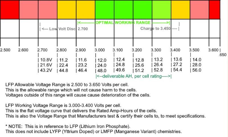

I'm attaching a chart I posted on DIYS which may be of interest... I think I've posted it on this forum but who knows in which thread now.
LFP Voltage chart
LFP Voltage chart
# Posted: 26 Oct 2025 12:23pm
Thanks Steve. According to that chart even at 12.8 we’re still in the green zone.
