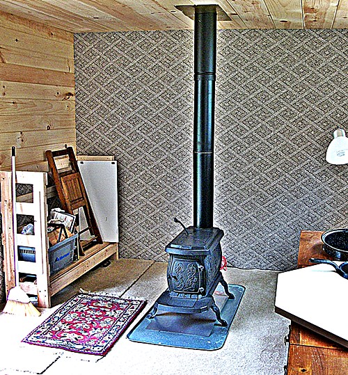

# Posted: 19 Sep 2011 07:03pm
I found a near new Vermont Castings Aspen on Craigslist including all the stovepipe for $400 -- installation was pretty straightforward it heats my 10x20 cabin on the coldest of nights -- and it's walls are 70% heavy canvas -- Use it for any cooking that can't be done on the fire pit. Unlike propane wood is free ...
