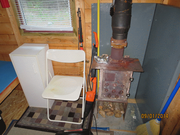

Our cabin came with a woodstove in place. It is hideous but functional. The cabin is only 10x10.
Has done the job so far with little fuss but it comes at the cost of some lost space.

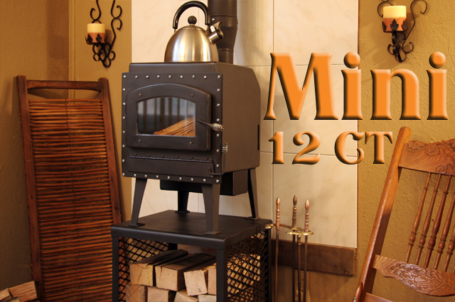

The perfect wood stove for your cabin would be the Mini 12 from Gray Stove Works. They are not cheap, but they are incredibly well made. There is also nothing like a wood stove burning on a cold winters night.
Gray Stove Works
