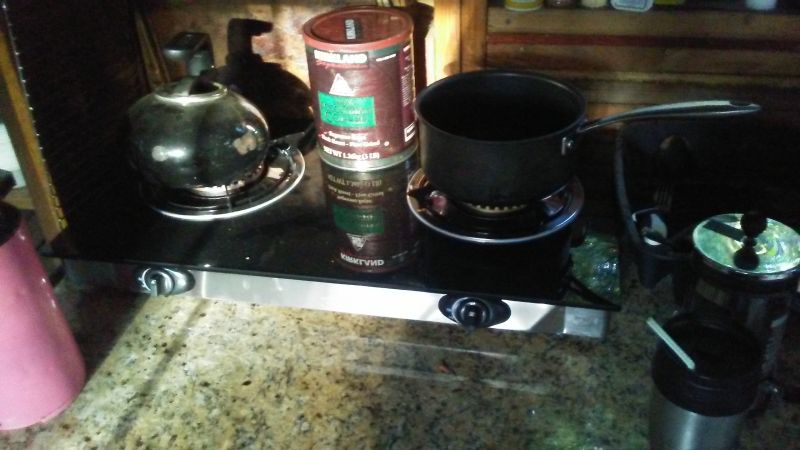

I bought an inexpensive cooktop to replace my camping unit. It came with a hose and regulator so I hooked it up to a 20lb tank to test it out. Works fine. I kmow having tanks indoors is a no no but it sure was handy turning off the tank before bed.
Anyway I guess the next step is iron pipe through the floor, a T, two valves and flex pipes.
# Posted: 25 Jul 2019 03:52pm - Edited by: NorthRick
After further investigation, it says you push the knob and turn. I guess the push triggers the igniter.
One of the camp stoves we have sounds similar to this. You have to push the knob in before it will turn. However, the "click" indicating that the igniter fired doesn't happen until you actually turn the knob to high (first setting).
It usually lights off with a big burst of flame. I'm not crazy about that but it does work.

Yep that's how this one works. Like a dope I stuck my ear by the burner and slowly turned the knob to see if gas comes out before the click. Ah the smell of burnt beard. That's the second time I've almost killed myself today.
# Posted: 25 Jul 2019 10:23pm
That's a good story Paulz. My brother did a similar no no a few years back with a new gas grill he assembled. He didn't have the igniter wire pushed on far enough. He did a couple two or three knob turns...click...turn ...click... Then pushed the wire on the igniter connector. Fortunately that fixed the problem. Unfortunately he left the lid closed while checking the piezo wire......whoosh...baboom!! The grill lit and blew the lid off, about 20 feet in the air, also removing portions of his facial hair! Thank fully I was there to throw some Budweiser burn cream in his face. Lol

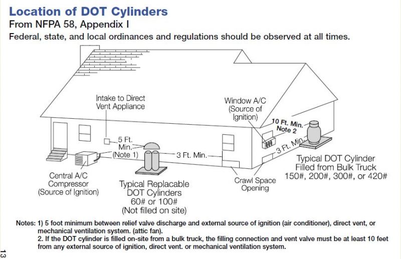

What I'm seeing online is up to 100 lb. tanks have no restriction on distance from structure other than 3' from any wall opening and 5' from any ignition source.

If you go bigger than 100lb you have to be ten feet away from structure.

I wonder if the "3' from any opening" means vertically and horizontally? i have a nice spot but has a window above, over 3'.

This is what the code requires for portable tanks. The larger horizontal tanks are different.
If you google "LP Gas Serviceman's Manual" you'll find this and lots of other useful information like pipe sizing, etc.

At our cabin we have two 100# tanks right up against the cabin wall, the proper distance from the nearest window. At home we have two 420# tanks on a concrete pad about 6' from the house (they could be against the house but the pad was already there from an old shed or something). I used copper tubing with flare fittings for all the gas plumbing in both places, it's easier to work with and bend around corners.. At home, I encased the copper tubing in black plastic well pipe where it went underground between the tanks and the house. If underground, code gives a minimum depth it has to be buried to.
