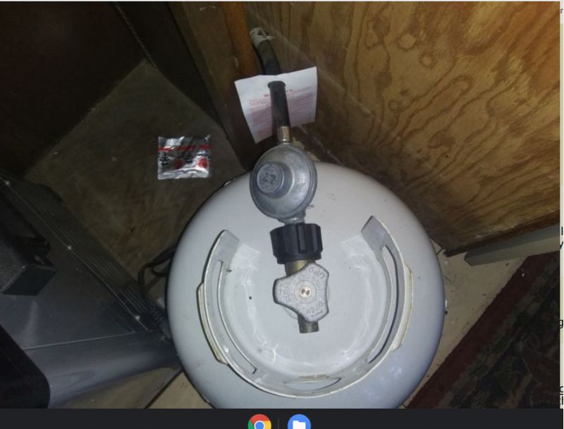

Thanks guys. Happy to report I now have hot water and stove again, and no leaks. I had tried a single stage regulator out of the pile, it made no difference, even connected straight to the L5, bypassing my new plumbing. Started to think maybe the L5 took a dump so I hooked up it's original regulator, which I had been avoiding because it has a non-removable rubber hose. That did the trick, scalding water again, so I connected it to the new plumbing, got a hot stove again and as a bonus the wall heater is cranking out the BTUs much higher than with the two stage it had.
So I'm stuck with the rubber hose regulator for now, which has never been a problem. It looks to be small diameter but runs everything at once fine. No idea why the first single stage regulator I tried (with NPT output) doesn't work. It's a larger diameter but I don't see any ratings on any of them.

Might check the inlet hole size on the regulator fitting (pol?) to the tank, they vary, often less than the hose ID. But that is high pressure coming into the reg, still, I gotta wonder.
I have a bunch of reg's off bbq grills, and those big grills use a lot of btu's. A reg off one off those is likely to work better for you than one off a little grill. You can mount one of those off a 10-15psi 1st stage reg at the tank and have an effective 2 stage.
Or,
Why not add up the btu's of all your stuff and talk to your local propane supplier about regulator and pipe sizing for what you are doing and get a proper 2 stage reg (they arent horribly expensive) and hard line with copper to your cabin piping/manifold?

Thanks, well It's working great now and I'm not worried about the rubber line. I turn the gas off whenever I'm not there and the only critters I have are banana slugs.
I may be going to 100lb. tanks soon, at which point I can rig up a new regulator and hard line.
