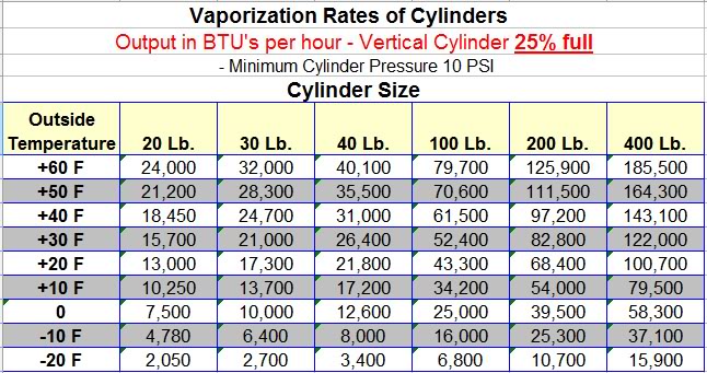

This may help if you need to calculate propane tank size.
A 30kbtu heater you will need a 100lb tank to support removing 30kbtu at 30* but it would also work at 10* unlike the 40lb tanks.
How big is your tank paul?

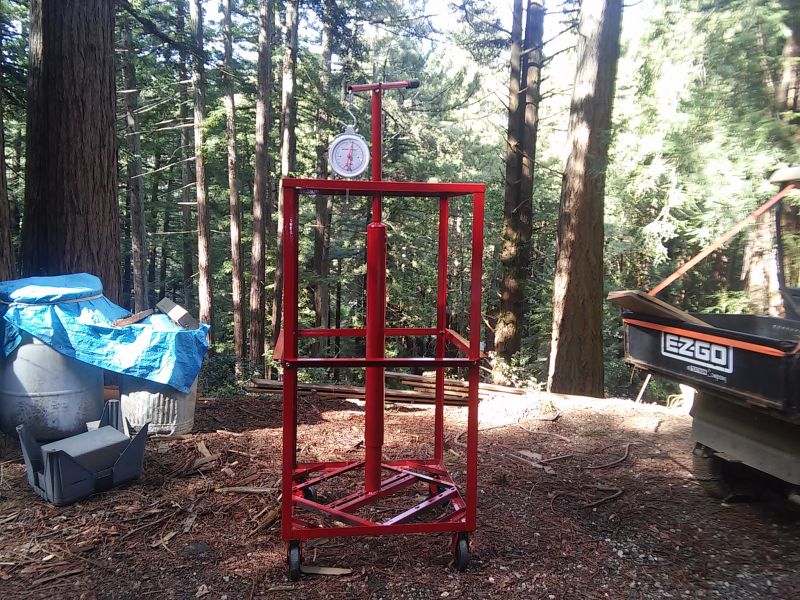

Thanks Brett. Interesting. I have it on a 40lb., it does fine but only about 6' of hose running out side the cabin to the tank, and the cook top is on a separate 20lb. tank. We only get a few days in the low 30s a year. Been wanting to get this done right for awhile..
A few years ago I made this rolling rack for the four 100lb. tanks down at the firehouse for the emergency generator. They are talking about getting a permanent tank, in which case I will get the rack and the tanks.

That chart is for the tank being 25% full. Do you find in the cold weather the tank has some left or freezes up when the heater slows down?

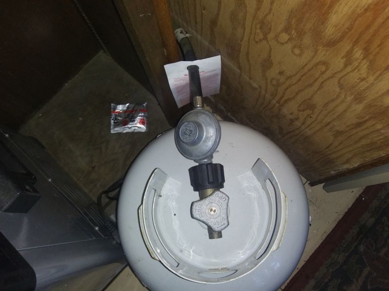

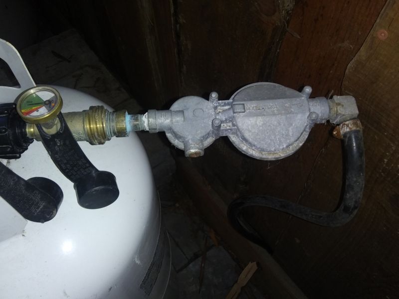

Hey guys, got my propane plumbing done yesterday, so I thought.. Now instead of separate tanks for wall heater, cook top and water heater, I have one tank feeding all three.
I have the two stage regulator that was feeding the wall heater at the tank. That's working fine, but the cook top burners are much weaker. That may be OK, takes longer to boil water but maybe my pans won't be so sooty. But the L5 water heater is now weak, lukewarm on highest setting.
So, can I put the single stage at the tank and the two stage feeding off it at the wall heater? See first post for photos.
# Posted: 10 Dec 2020 01:35pm
What pressure do each appliance take?
# Posted: 10 Dec 2020 01:57pm
Both the L5 and the cook top came with single stage regulators and work great with them. The wall heater required the two stage. I don't see why I can't use a single stage at the tank and run it through the two stage at the heater. Going to try it.
