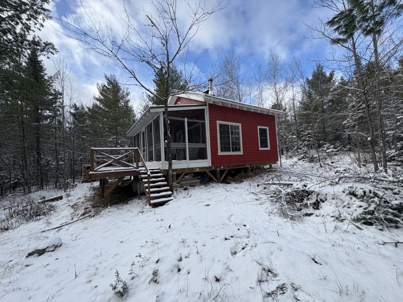

Still hadn’t Fixed the chimney supports from this winter yet. Fixed them this weekend by installing a new set, and securing them with spax lag screws instead of just normal screws. I think it really was a fluke last year so we’ll see moving forward.
Finished painting the outbuildings finally as well this weekend. Looking good!
Also just did some more general cleanup.
This is such a beautiful time of year. Colors are almost peak and there aren’t any bugs at all. That and 60-70 degrees every day.
But we know the cold stuff is coming!!!

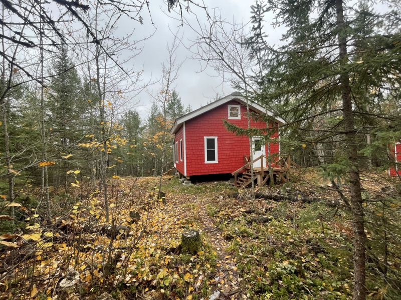

We are shutting the cabin down for the 3rd Time this weekend… always bittersweet.
Last weekend we did a lot of grouse hunting. I also installed our permanent water system. Used copper to replace the vinyl tubing I’d been using all summer. I have more work to do on the copper but So far looking good.
Been a great year. Been able to enjoy the cabin this summer vs just working and building.

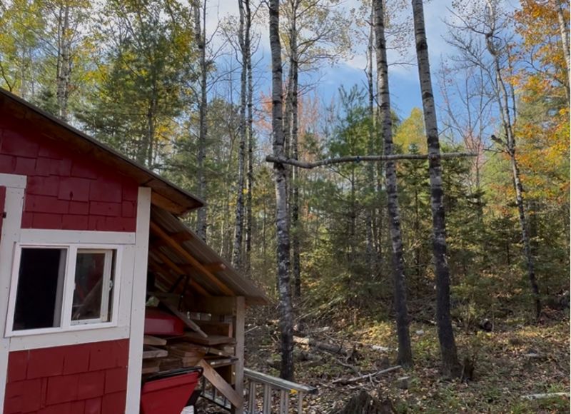

Closed down the cabin this weekend. Will be the last trip until the lake turns solid.. then a few winter trips.
Fall is just so incredibly pretty up at the cabin- hard to leave. Got a number of grouse this weekend too.
We have FINALLY cleaned up the ENTIRE site. Took lots of hours here and there spread out over the summer to do so. But everything is now in its final form. I still have some hacking up fallen logs and chipping to do… but that is all stuff in the forest surrounding the site. Filled up my sauna woodshed to let the wood season so it should be decent by spring.
I’ve learned that You can ALWAYS use one more day…But if I did have one I would have completely filled my big wood shed with split wood. Oh well it’s 1/2 full. Lol.

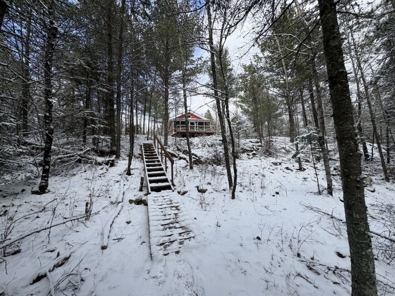

- finished widening treads on the staircases up the bluffs

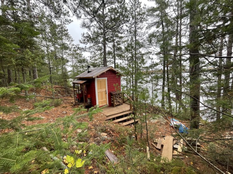

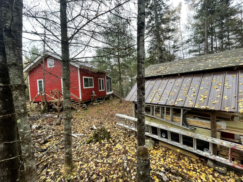

Life is good. Enjoy a few Northern Minnesota fall pics!!

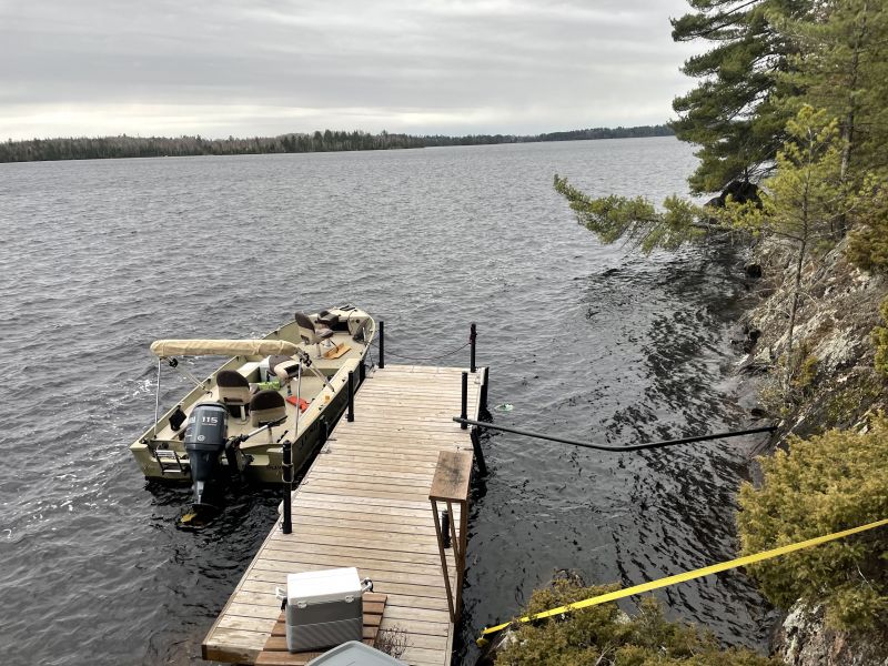

One interesting thing though is our dock took a beating. We have a permanent dock. Usually the ice locks up and doesn’t move once it’s there until it goes out. Rocky lakes like ours can handle permanent dock if they’re built right. This was such an odd year for ice. It came and went and strengthened and weakened almost the entire winter. No snow means no insulation and the ice was a lot more Susceptible to temperature swings and would basically keep adding and moving all night long every night, and start to weaken in the sunlight during the day. Some snow is incredibly important for ice.
You normally can hear the ice popping and moaning somewhat, but it really was a trip this year. When we were up in February the ice was pinging and “laser sounds” literally all night long. You could just stand outside and it was so loud and nonstop- especially on the wilderness lake.
Anyway, the ice cycling caused a massive heave on our side of the lake. Normally rocky shore lakes aren’t susceptible to heaves as the rock doesn’t budge and therefore the ice can’t heave- sandy shorelines are different- But rocky shores lock it up in place.

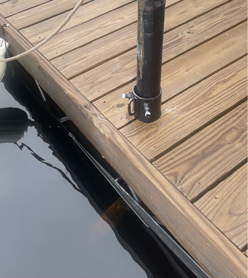

My dock has a 2” “insurance” steel pipe bolted to the rock wall to keep the ice from pushing the dock into the shore. It also has an angle iron bracket with a 3/4 bolt fastened into the rock on the shore side. The ice sheered the 3/4 bolt off the angle iron bracket. Not bent, straight up just sheered it off. The heave lifted it and sheered the bolt clean.
The 2” steel pipe bent like a hockey stick. See pics below. There a couple of where it was starting to bend vs how it finished. I haven’t seen it yet- these were just from a neighbor. I can’t imagine the force needed to bend a 2” pipe in straight compression, just incredible… it also bent the 3/4 bolt that fastens it to the shoreline
The dock seems to be in decent enough shape still- we’ll see this weekend- the dock guys are going to come and reattach everything next week. It’ll probably have to be adjusted back into place and re-leveled too.
They make these permanent docks ultra beefy for this reason. The legs are 3” pipe so they shouldn’t bend. The ice bent the heck out of the permanent bumpers but that’s a quick bend back. If it can last through a winter like this…

Well our dock was still there but beat up.
That bar folded and is bent at about 45*. The whole dock shifted about 3-4 ft toward the rock wall shore. That bracket that sheared off the bolt is bent almost up almost perpendicular- ice must have heaved underneath. Also one of the legs of the dock is bent 45* under water. It must have caught on the rock and not budged when the dock moved. In one of the photos you can see it sticking out under the water at a 45* angle.
The whole dock is overall in good shape just a little messed up a bit. Should be fixed this week by the dock company.

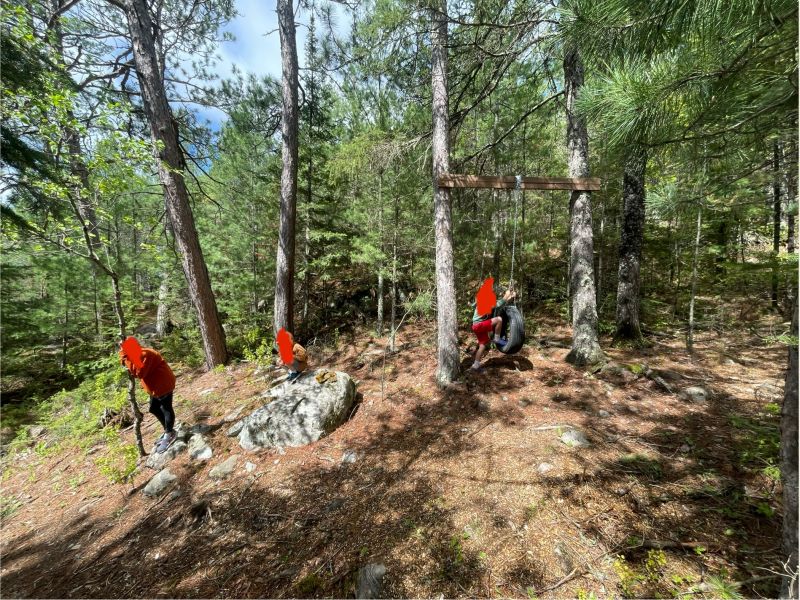

I also put a tire swing in for the kids.

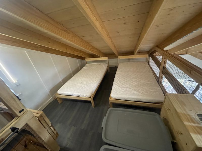

-biggest project was insulation. I insulated the floor with spray foam from underneath. This was actually fairly easy surprisingly and not as horrible as I had imagined. The floor now stays warm in the fall and the foam also helped to deaden the floor a little bit making it feel more solid.
- I did a lot of clearing and chipping deadfall this summer. Chips used to build up and pad trail up to cabin.
-thinned out trees quite a bit creating a much clearer(but still private) lake view. May take a few down next year yet.
- my better half finished painting interior entirely- including loft.

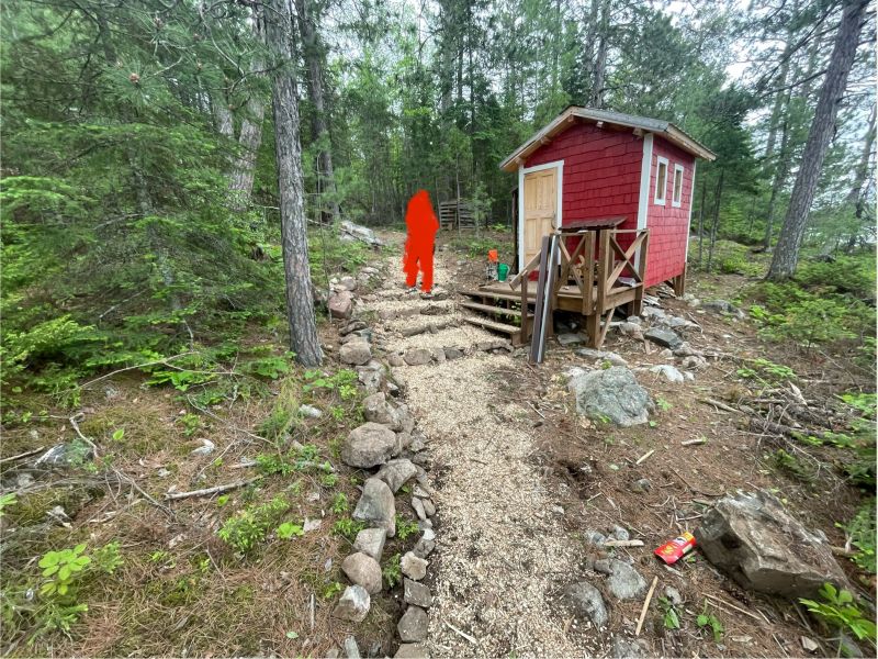

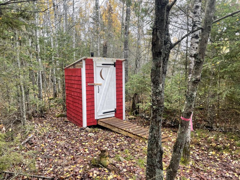

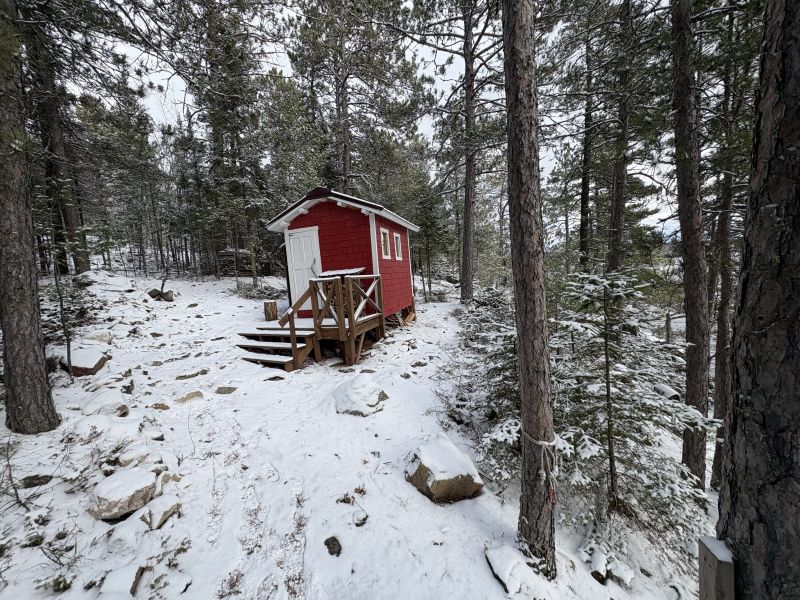

-Exterior stained sauna eves and fascia. Also painted outhouse interior (note picture shows removable brace installed only for snow load in winter)

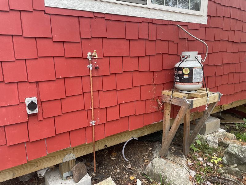

-replaced some plumbing and faucet setup. This will be our final/long term water system. The faucet is a large curved high faucet and elevated above the counter so that it can swing over to fill up our water filer, and then swing back to provide unfiltered water into sink.
- installed sink drain and u-trap through floor to allow for sink to drain out of cabin. No longer just using a slop bucket for grey water.
-installed a few other usb chargers around cabin
- bought and ran permanent extension cords to make water pump and generator operation easier.

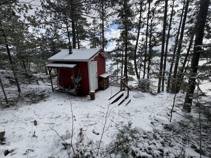

# Posted: 5 Oct 2025 09:24am - Edited by: Grizzlyman
Was up doing some work this weekend. Winterized the water in the cabin. Will still use it for a few weeks yet, but shut the water system down for the deep freeze.
Also, got a few other projects done I’ve been meaning to do.
-Put a steel roof on my shed.I lost the ridge cap to a gust of wind crossing the lake so I just put a scrap piece on. I just put the steel over the shingle so it’s fine without it, but will need to put another one at some point.
-Built a second woodshed for cut but not split wood. I should have built this bigger but didn’t have any extra roof panels. May enlarge it later.
-put up a tree stand back in the woods and a deer pole to hang deer.
- started on a shooting gallery. 25,50, and 100 yards steel gongs. Built from scrap wood. Not perfect by any means, but it’s 1/4 mile hike back to it and with what I had to work with is just fine. May make a nice shooting bench at some point.
-lots of chainsawing and clearing.

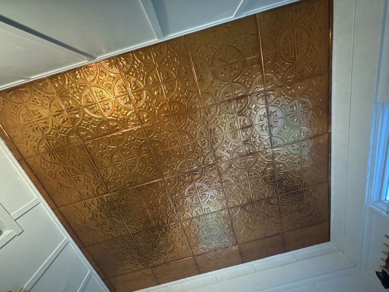

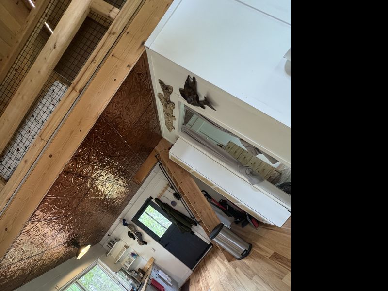

I had another thread on this but thought I’d add it to this project thread. Put a copper tin ceiling in the kitchen and bedroom this spring. That was my other biggest project this year.

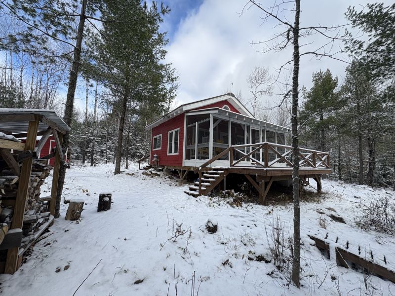

# Posted: 11 Nov 2025 02:01pm - Edited by: Grizzlyman

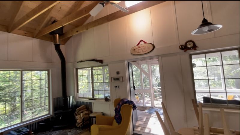

Just buttoned up the cabin this weekend for the foreseeable future. Was up deer hunting and got down to 12*. 3”+ of snow over 2 days. We had to break a little ice with the boat on our way back in.
Aside from the ceiling not much construction done this year. Added the 2nd woodshed and some smaller things but nothing major. Did lots of clearing though starting to have a nice “pocket” in the woods. Here’s a few photos where I left it for the winter.

# Posted: 11 Nov 2025 02:31pm - Edited by: Grizzlyman
Few more
