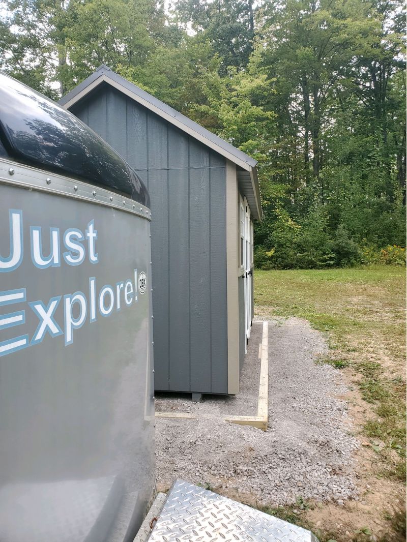

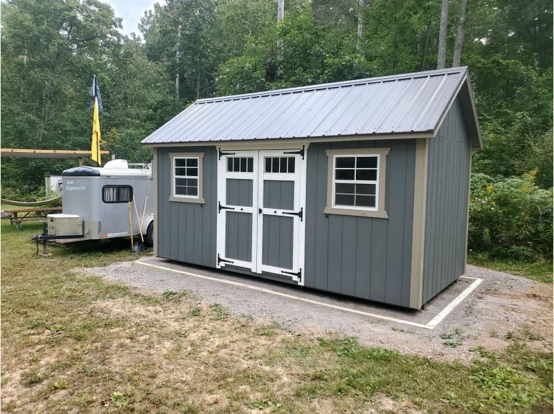

I am purchasing this little shed to be moved to my camping property. Before I have it moved, I'm building a gravel foundation surrounded by treated 4x4's.

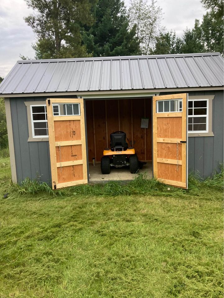

It's not the exact thing we wanted, but it was local and it was a decent deal. One thing I would have preferred would be a normal entry door over the wooden doors. Is there a good way to seal those up for use as a cabin, or should I just plan on reframing for an entry door?
My plan will be to run some wiring for lights and some receptacles , insulate the ceiling and walls, and then cover the ceiling and walls. I was thinking like 1/4" luan, but I would consider other budget ideas. On one end I think we will do a bed on a bunk so there can be storage below it. Probably a table and chairs maybe a small counter top.
It will pretty much be a place to sleep and get out of bad weather.
I think I will also want to build a ground level deck in front of it.
I would appreciate any advice or suggestions, especially from anybody with a similar build.
Make the gravel pad 14x16 so you can pour a concrete front porch. Make sure the framing for the porch is 1/2 bubble sloped away for rain. Make sure to use rebar in 2'x2' grid square to keep the concrete from cracking.
Looks like not enough room to attach a porch roof. Put up a roof gutter on the front and build a taller sloped porch roof.

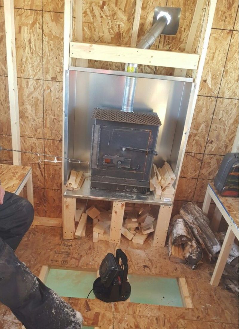

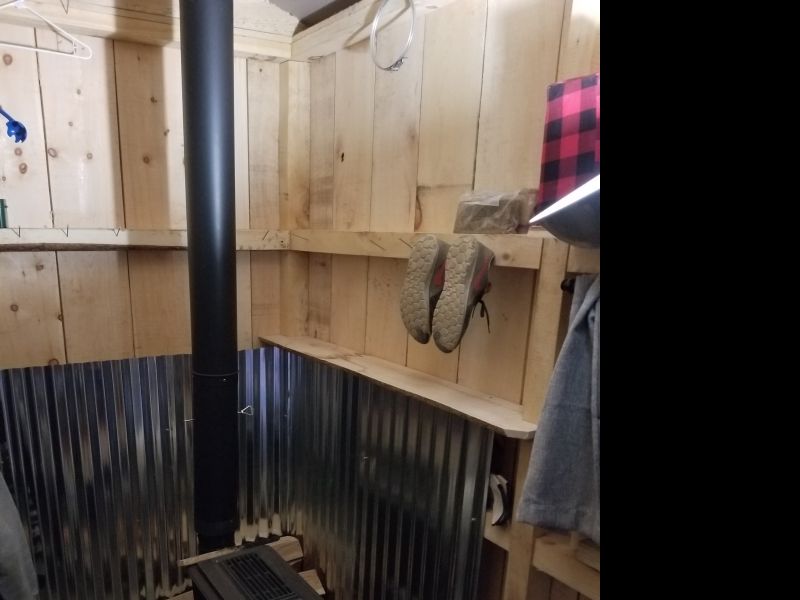

Wood stoves definitely take up a fair amount of space. This is ours in a 10x14. The beds go next to it so not actualy that much loss of space. This setup including the stove cost under $500. With no insulation ar 4*f it kept us warm. It prety cold in the morning though. This was always going to be a temporary cabin for us. If it wasn't I would prob insulate and use something like a chinese diesel heater in it. Small, cheap and cheap to run.
