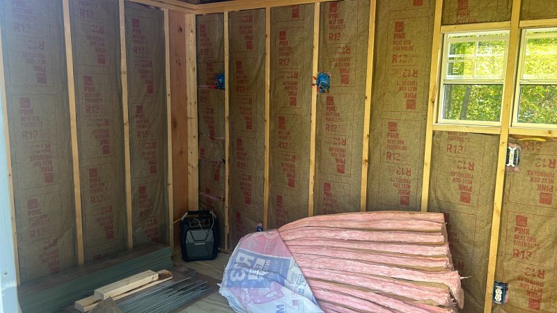

I think I'm going to work on doing some insulating on the walls this weekend. I'm just going to do r-13 rolled fiberglass insulation. What should I be thinking about for the ceiling?

# Posted: 5 Oct 2024 06:42pm
It’s going good!
Fiberglass batts
Fiberglass batts

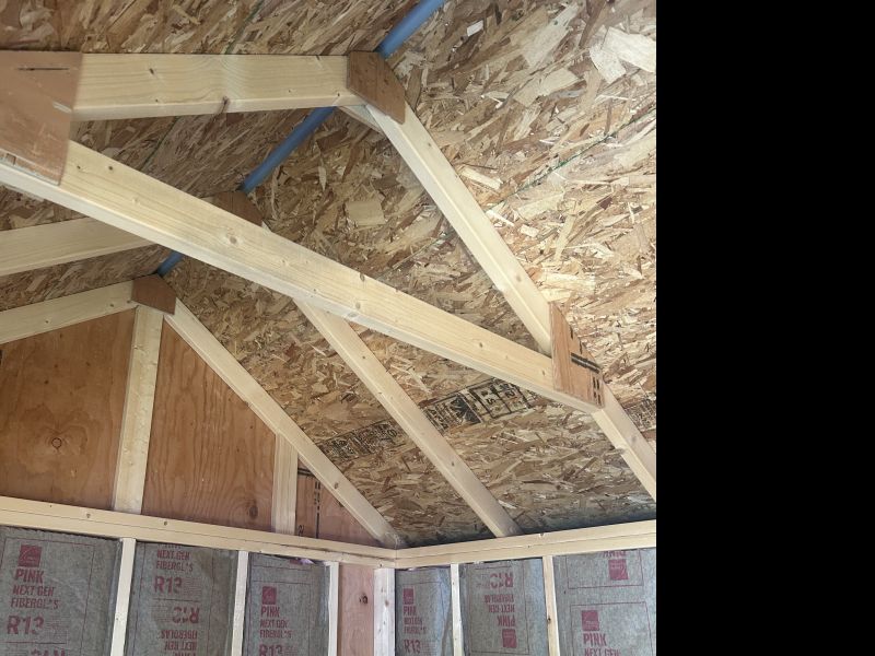

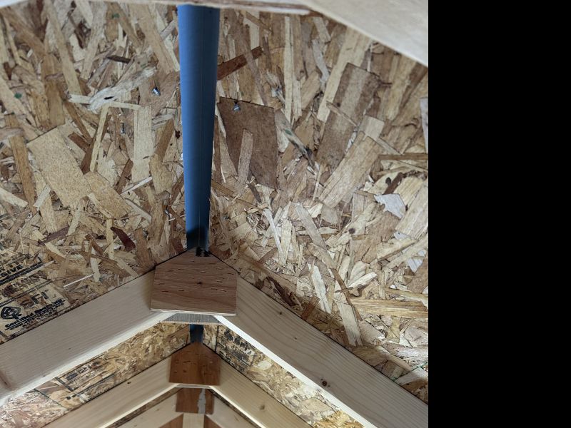

This is the ceiling. I have a ridge vent. Can I use wider fiberglass batts for this or should I be using foam board? Q

# Posted: 5 Oct 2024 09:09pm
Quoting: mikesova
(not really leaving an attic space
Does that mean you intend to insulate between the rafters and fasten the interior finish ceiling to the underside of the rafters? The 2x4 rafters do not provide sufficient space for adequate insulation in a north MI climate. Not to mention the issues of providing ventilation space against the underside of the roof sheathing. You have stated you have a ridge vent. Are there inlet vents at the lower end of the rafters (at the wall top).
Foamed in place insulation and sealing the ridge may be better. However, that would still fall short of best practise R-value.
Insulating a roof such as this often involves compromises with something ending up being short changed. My opinion.
Is there any requirement to meet state building and/or energy codes?

# Posted: 6 Oct 2024 01:37am
Yes, that’s what I’d like to do. This is a small shed that will probably not see much use in the winter. I’m ok with not having the absolute best r value, I am mainly worried about moisture issues due to seeing other posts about it, but not completely understanding the causes.
The ridge line vent seems to be vented out the steel roof covering.

Yes, that is more or less normal practise. Normal practise also includes soffit keve) bents and an air path from lower vent to ridge vent, behind batt type insulation. That vent space should be an inch which would leave only 2-1/2" of insulation space.
It would be inadvisable to use the same full depth batts that you used in the walls in the roof, as most likely room air and water vapor could and would find its way to the cold skin of the roof sheathing and condense. That depends on the humidity level in the room. Cooking, bathing and unvented heaters can all add humidity. Just breathing can too as can whatever the weather is doing.
You might be able to cut XPS foam panels and fit them inside the rafter mays. Seal the edges with foam in a can. The idea would be to keep moisture laden air from getting behind the sheets to condense on the cold roof sheathing. It is even possible that a MI winter might be cold enough to allow condensation to form on the underside of the foam insulation. I can't say for certain. Closed cell foam like XPS would likely be superior to batt insulation though.
If you limit use to the warmer periods of winter you may be okay.
Watch what you select to use for heating. A non vented propane heater is a poor choice as burning propane produces water vapor, which may create a moisture condensation problem.

Metal roofing ribs are primarily there to make the panels siffer and easier, safer to handle. Most peoperly installed such roofs aill have foam rubber insect stop-strips inserted at the eve and upper ends to prevent insect access and nesting.
The rib channels are on the exterior side of the sheathing and can do nothing to vent interior water vapor moisture to the exterior. The moisture in the interior can be the problem.
If you install 3.5" thick insulation between the rafters there will be zero airflow even if soffit vents were present. Hoe er it is possible that moisture laden air could infiltrate the batt insulation and condense on cold roof sheathing. You would need a perfect vapor barrier installed on the warm interior side of the insulation. That is hard to achieve, which is one of the reasons roofs should have ventilation that works.

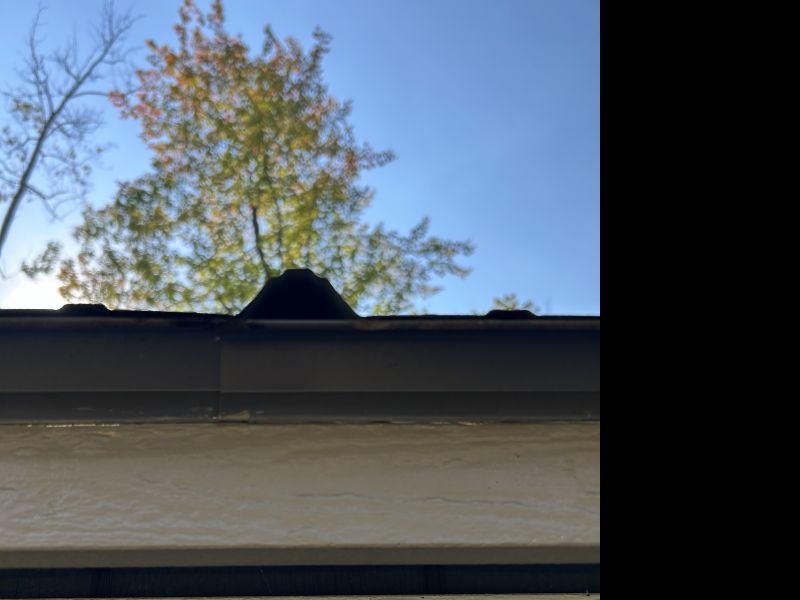

Well I just shone a flashlight from the eave and saw the light in the building on the ridge cap. It’s clear through.

I'll take a guess at what you may have there.
Knowing what you have is a good start.
The metal roofing may or may not have a 'membrane' (even tarpaper) under it. It should, but.....
The raised ribs/channels have no insect barrier but flow right up to the roof ridge vent. You might be able to shine a light inside at the ridge vent and peak up some ribs outside to see.
And/or ask the builder?
I can verify that moisture WILL find its way into batts up there; our old shack was poorly built by the prev owner and when we tore it down it was a mess up there. Above the ceiling planks was faced f-glass right up to the roof deck, metal on top. Pls don't do it that way.
We had considered getting a larger prebuilt than yours with a similar roof build. If we had I would have made a high ceiling (so a small 'attic') with lots of insulation.
The short angled eve sides would have been fairly easy to fit in styro then ceiling of choice. We like the exposed beam look so I would have fabbed up some fake ones.

On a shed roof that is common. Not that big a deal.

You don't really have any soffit to put a vent in if like my toolshed. The outer soffit looking piece is just a trim, it has no access/breathing up into the rafter bays. Id have to cut some kind of opening into it from inside to make it work.

It appears there may be sufficient room for a soffit vent in this image... (As long as there is an air path from the strip into the rafter bays.)
https://live.staticflickr.com/65535/54035410216_9050413963_c.jpg]imageimage
It would need to be insect screened, one per rafter bay.
Too bad the manufacturer did not screen the ridge before finishing the roof. Perhaps you can staple a strip of metal window screen (1/8" minimum opening size) over the ridge vent gap from the inside? Ot if the ridge cap is screwed on, remove it and install screen from the top. Whatever works. I recommend metal screen but that is because I am in an area that is highly prone to wildfires.

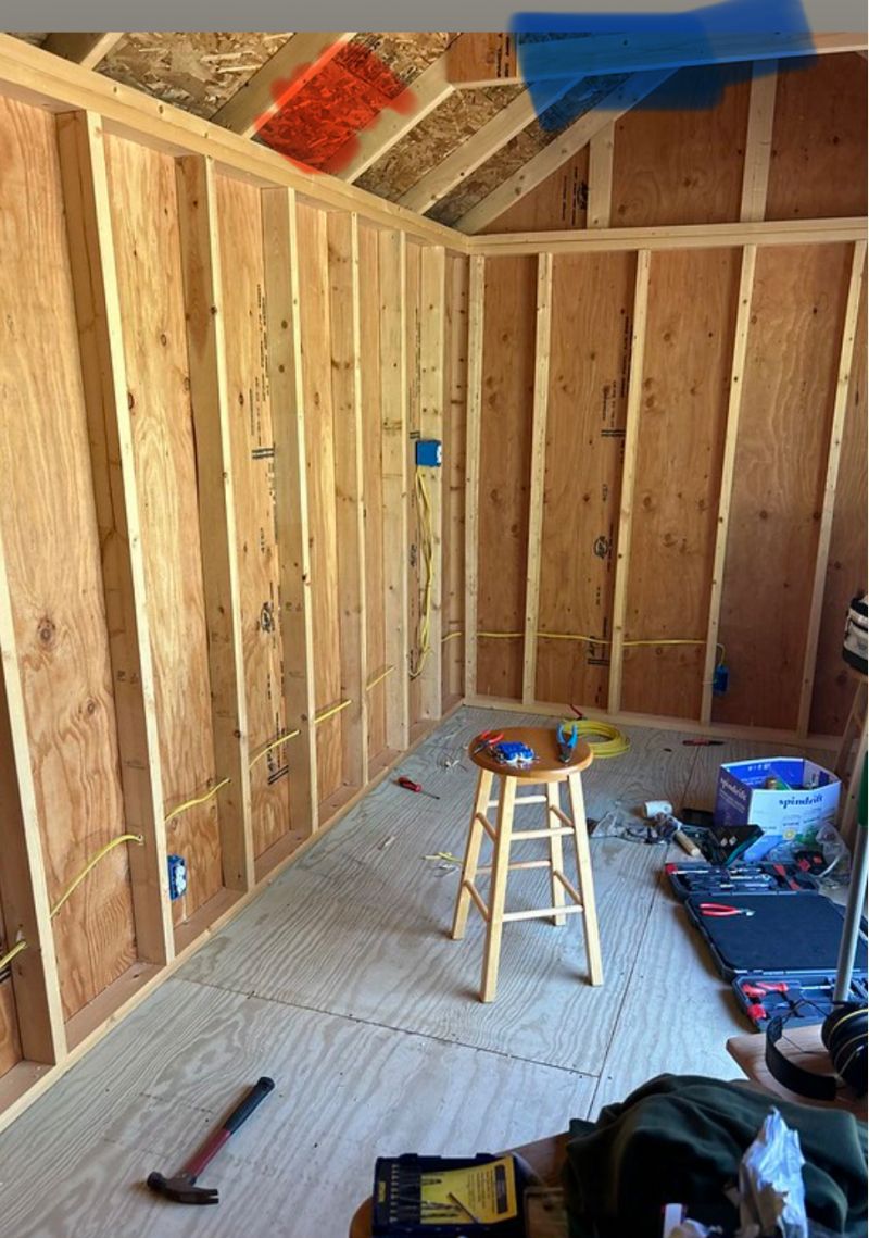

So I’m back at it again. This spring I installed a vinyl plank floor with underlayment for a little r value, then did luan wall covering over the insulation and have installed trim around the floor and trimmed out the windows. I’ll get pics soon.
So it’s come time to think about insulating the ceiling. We have decided to go with a normal attic style ceiling, so my dad and I installed some more truss braces so we have places to attach insulation and luan.
My initial plan was to use 2” foam insulation in the “red sections” pictured as to leave an air gap between the foam and roof sheathing and use r-13 in the long “blue” sections in the middle that will have a large air gap “the attic.
My thought is that the attic space should get air flow from the ridge vent.
Then I was thinking about materials and the r-13 comes in a package that would cover the entire ceiling w/o the use of the foam. From a practicality aspect,I wouldn’t end up having as much left over material as if I had used the foam in the red sections.
How big of a deal would it be to use just the r13?
Would issues be mitigated if I installed gable vents?
I really don’t want to install vents in between each truss on the soffits.

Gable vents would work, keep an eye on humidity, don't make a swamp inside or you'll have condensation issues.
