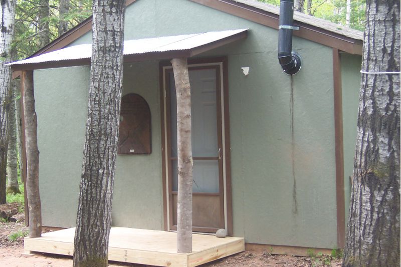

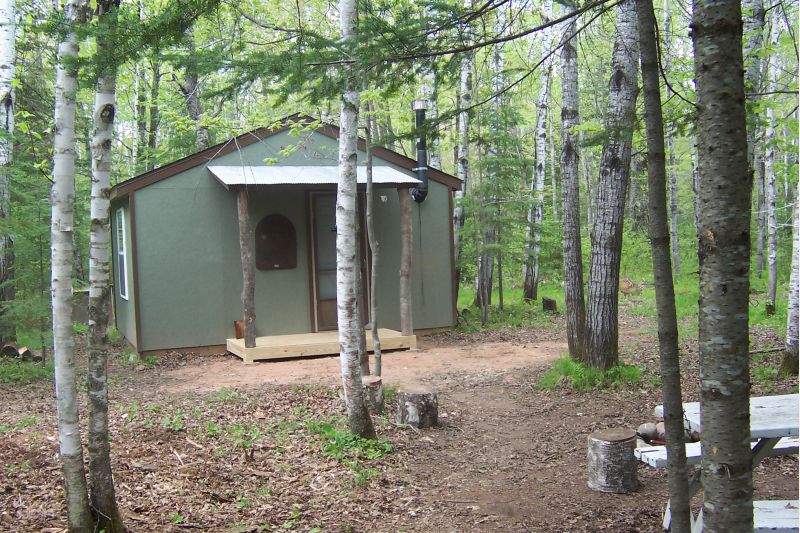

Our "little" cabin
Our "little" cabin

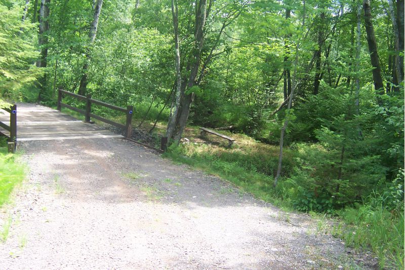

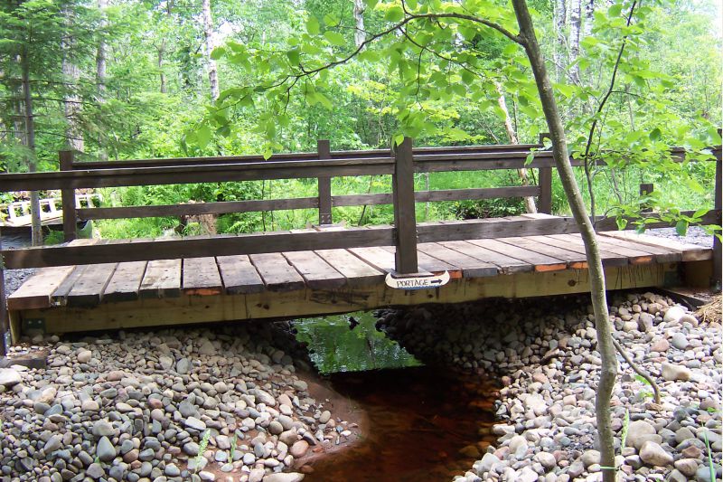

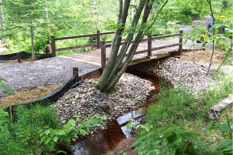

bridge that was a nightmare to get permits for.

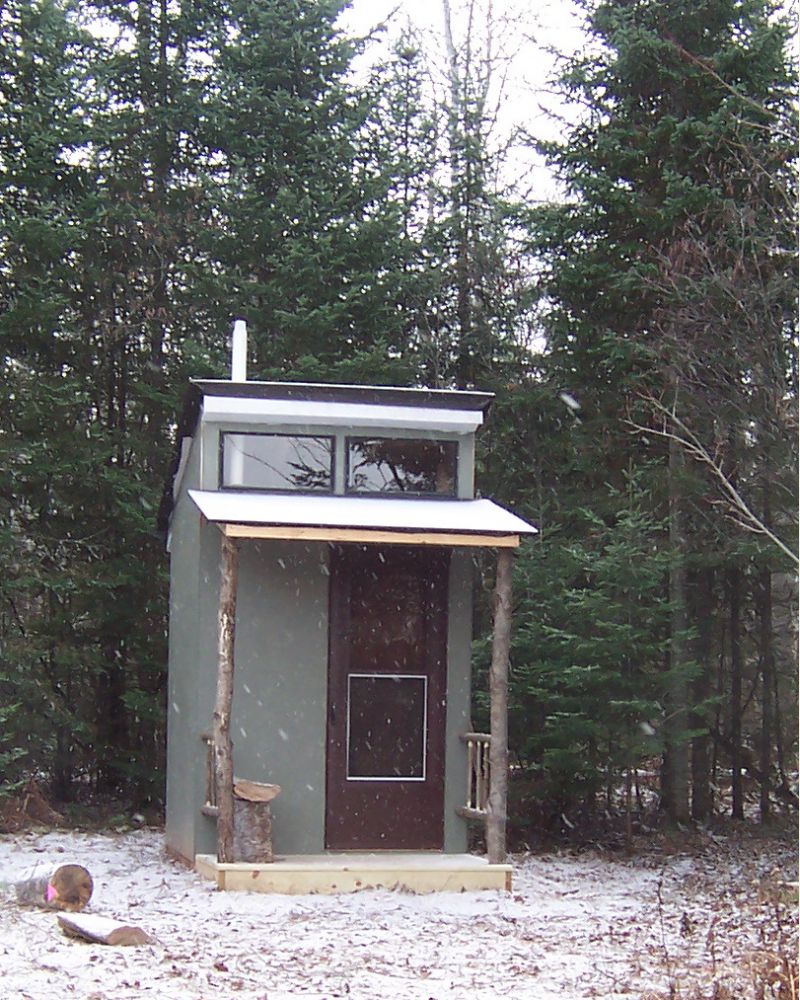

our outhouse
our outhouse

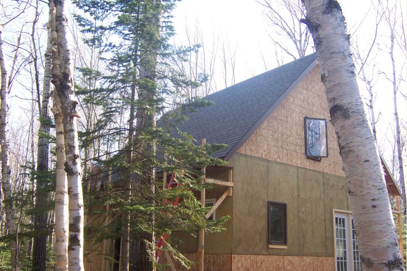

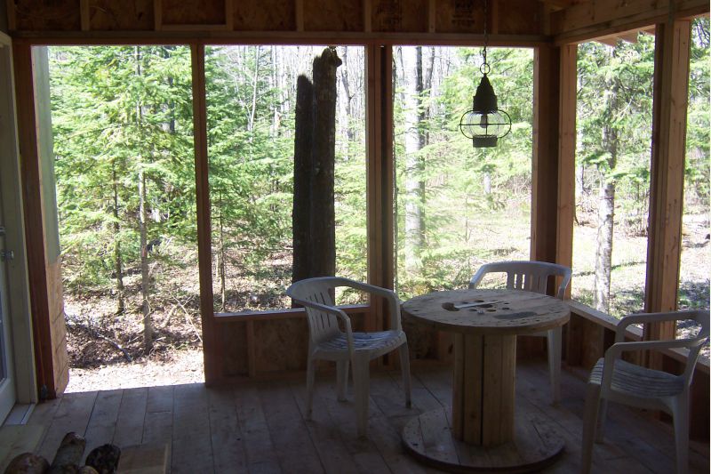

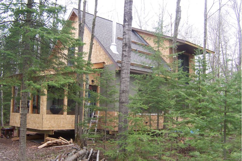

Here are more pics of where we are at now. The little cabin is 12x16 and the bridge is 12x20. The big cabin is 24x26 with 10 foot sidewalls and a 12-12 pitch plus the screen porch, which is 10.5x20 with the end angled.
"big" cabin
"big" cabin
"big" cabin
"big" cabin
screened porch
screened porch

I love the bridge; should be able to move tank over it.

Wow- that is spectacular!! I love the logs/branches you have used as columns and railings. And that bridge is fabulous! Ours was already built when we bought the land- thank goodness. I have the same question about the size of the cabins. Will you be using the small cabin as guest quarters? Also, do you have interior photos?

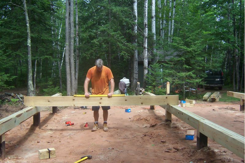

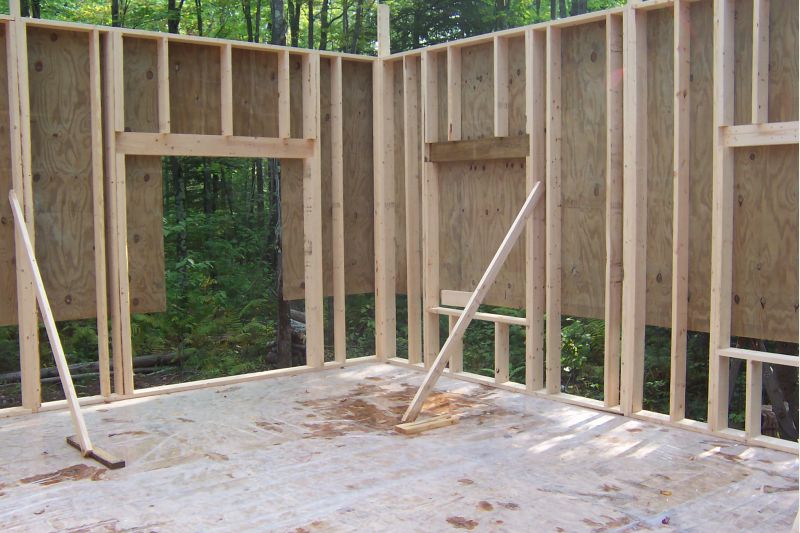

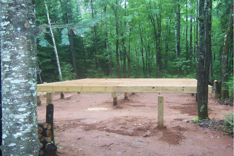

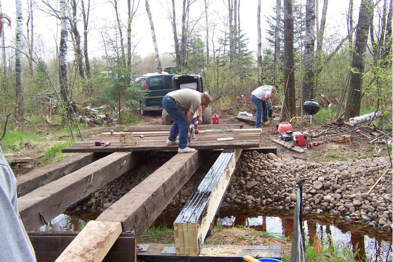

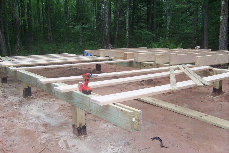

Here are some early shots of us framing the bridge and the foundation for the 'big' cabin.

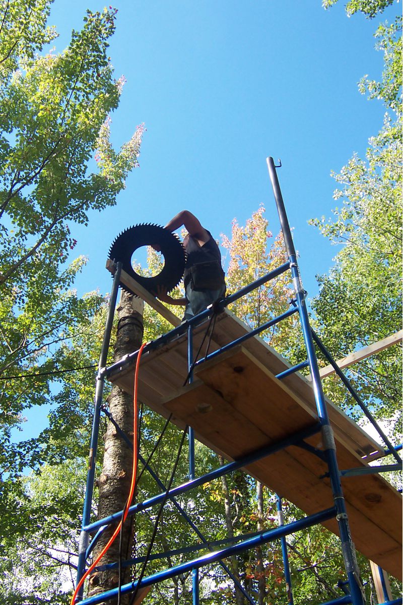

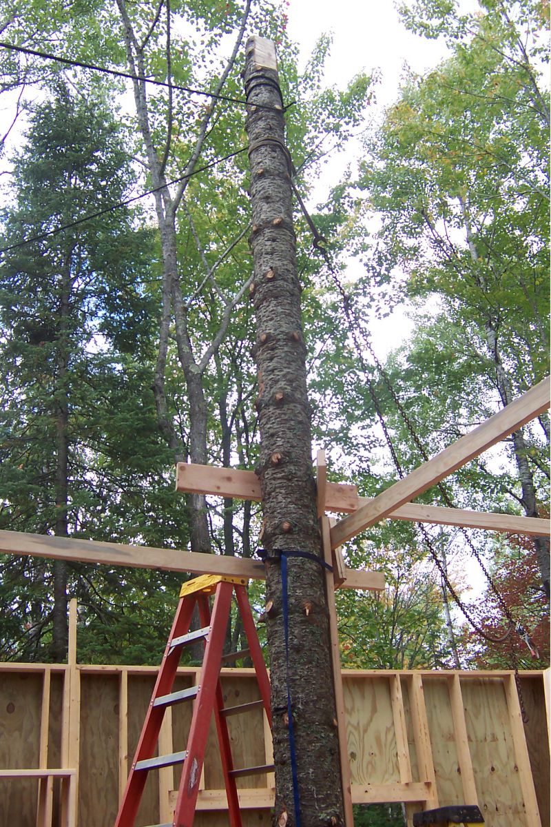

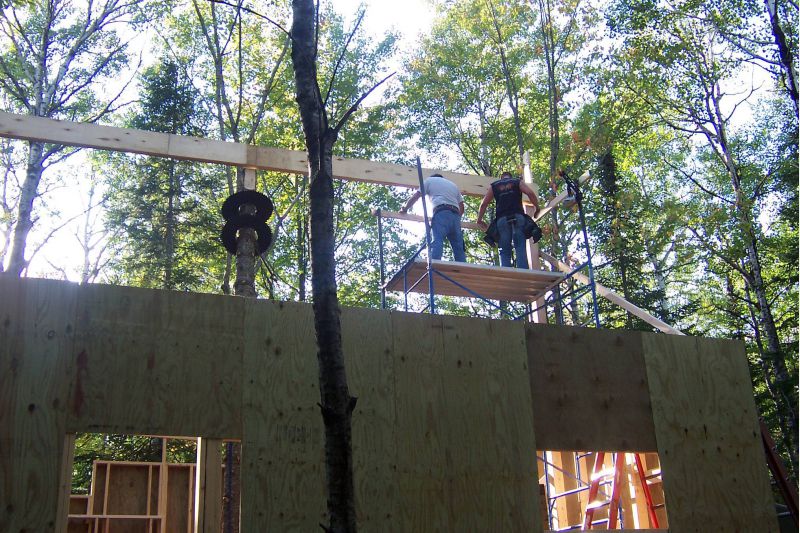

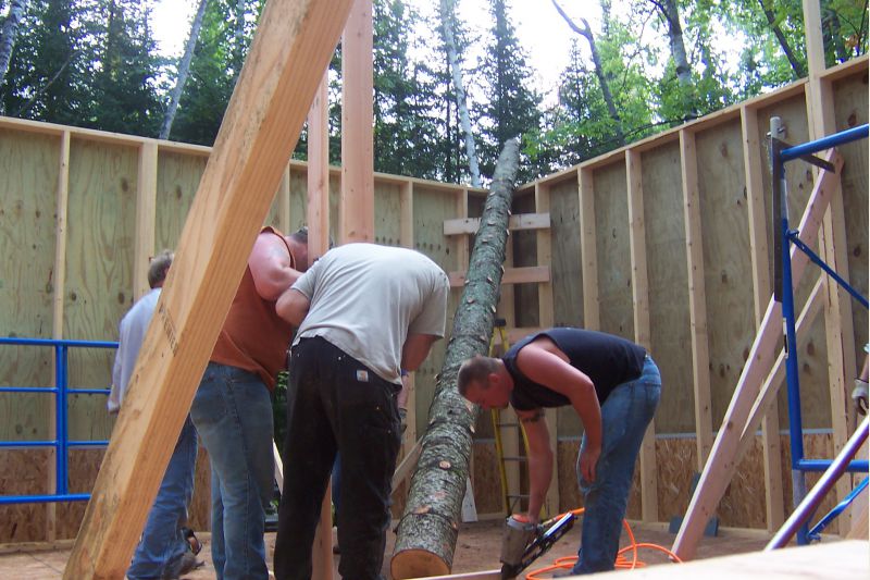

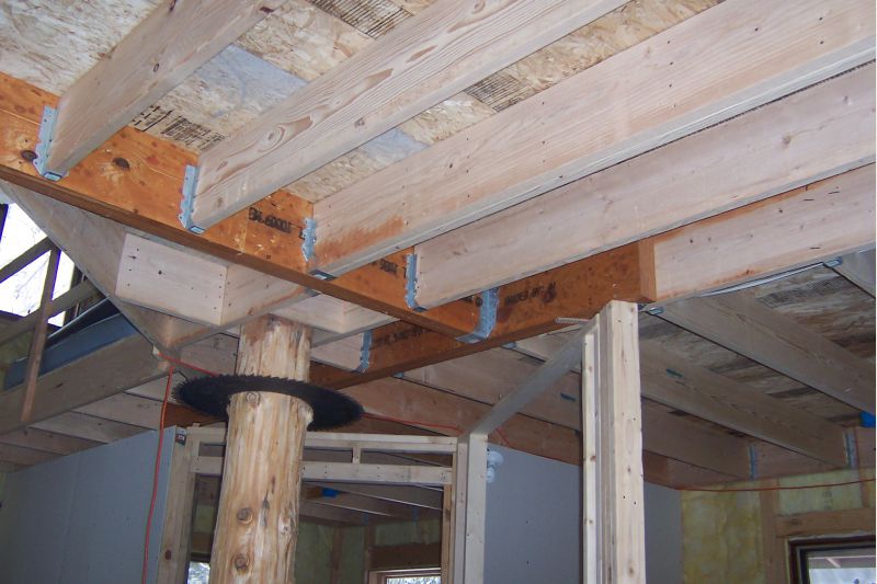

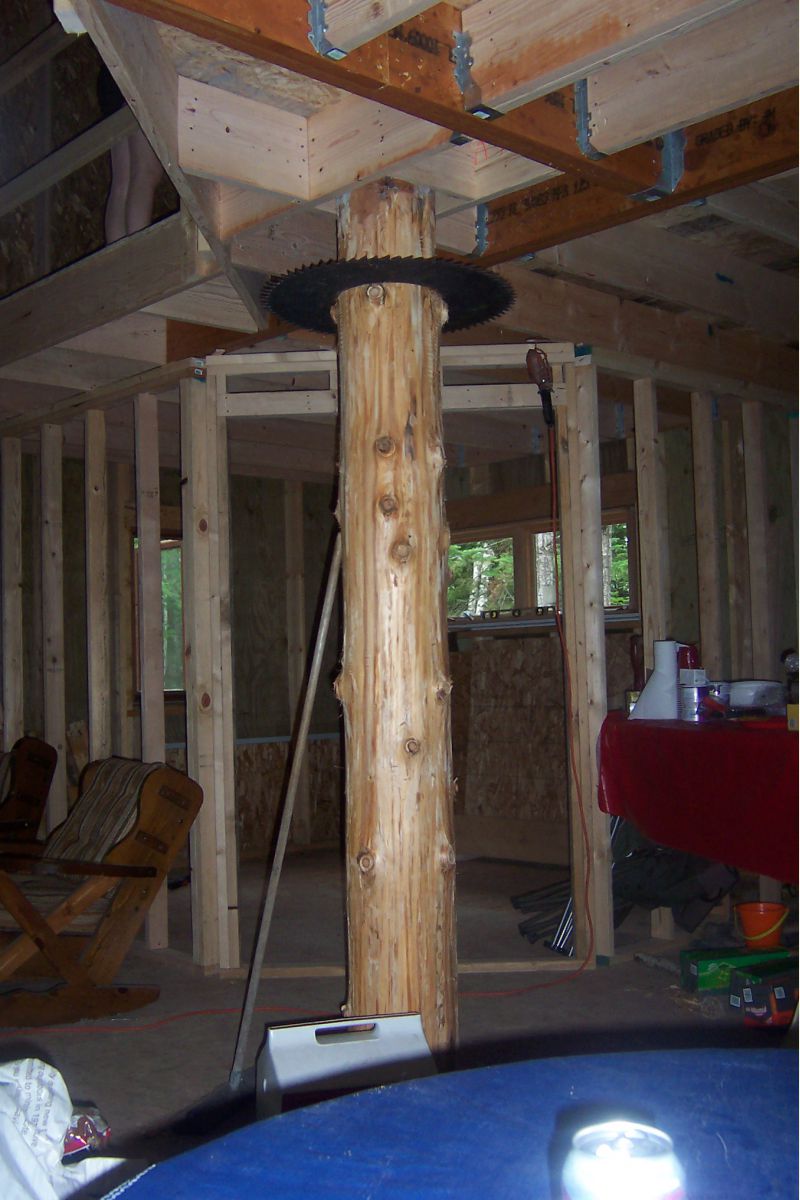

Here are some shots of us standing up the giant pine tree. We took two old saw blades and cut holes in them with a plasma cutter so that we could slip them over the center post. You will see that later!
# Posted: 23 Jul 2011 09:17pm

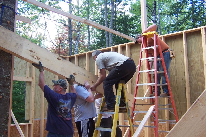

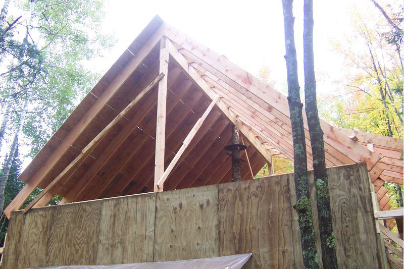

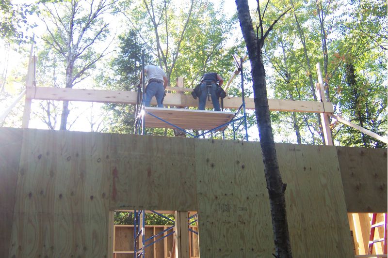

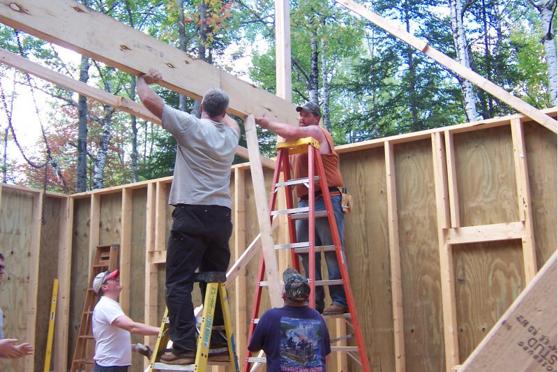

Here we are lifting up the ridge beam, which is double laminated 12 inch LVL's. Fortunately we didn't lose anyone this day!
# Posted: 23 Jul 2011 09:22pm

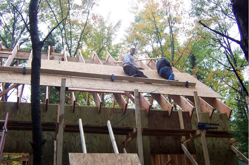

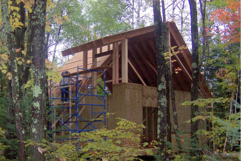

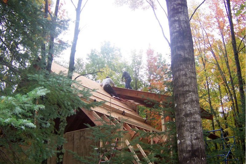

Roof decking going on and a shot of the dormer. We still didn't have any casualties!
# Posted: 23 Jul 2011 09:32pm - Edited by: trollbridge

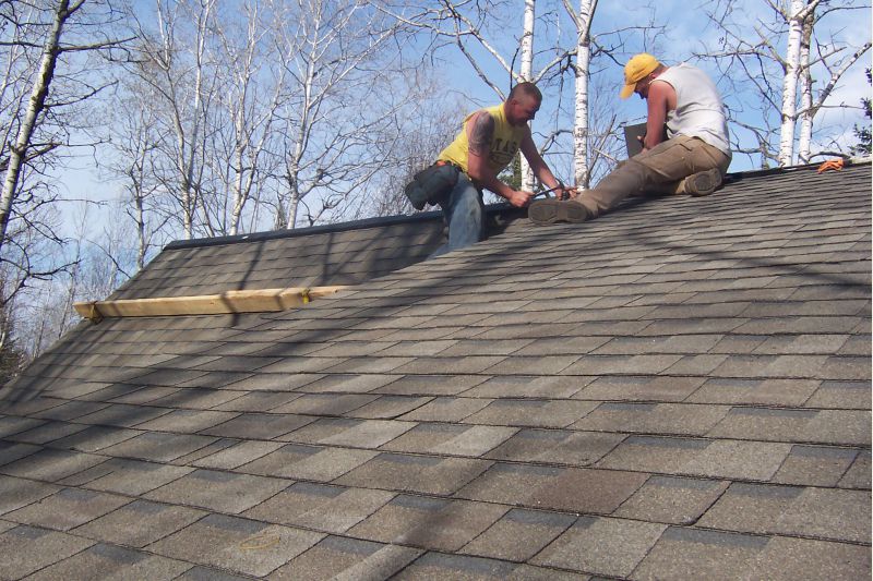

Putting up shingles and a nasty fall off a rickety, wooden, 6 foot step ladder! My advice - never stand on the very top of the ladder! We tried to keep warm with an outdoor fire pit inside the cabin but we ended up smoking ourselves out!

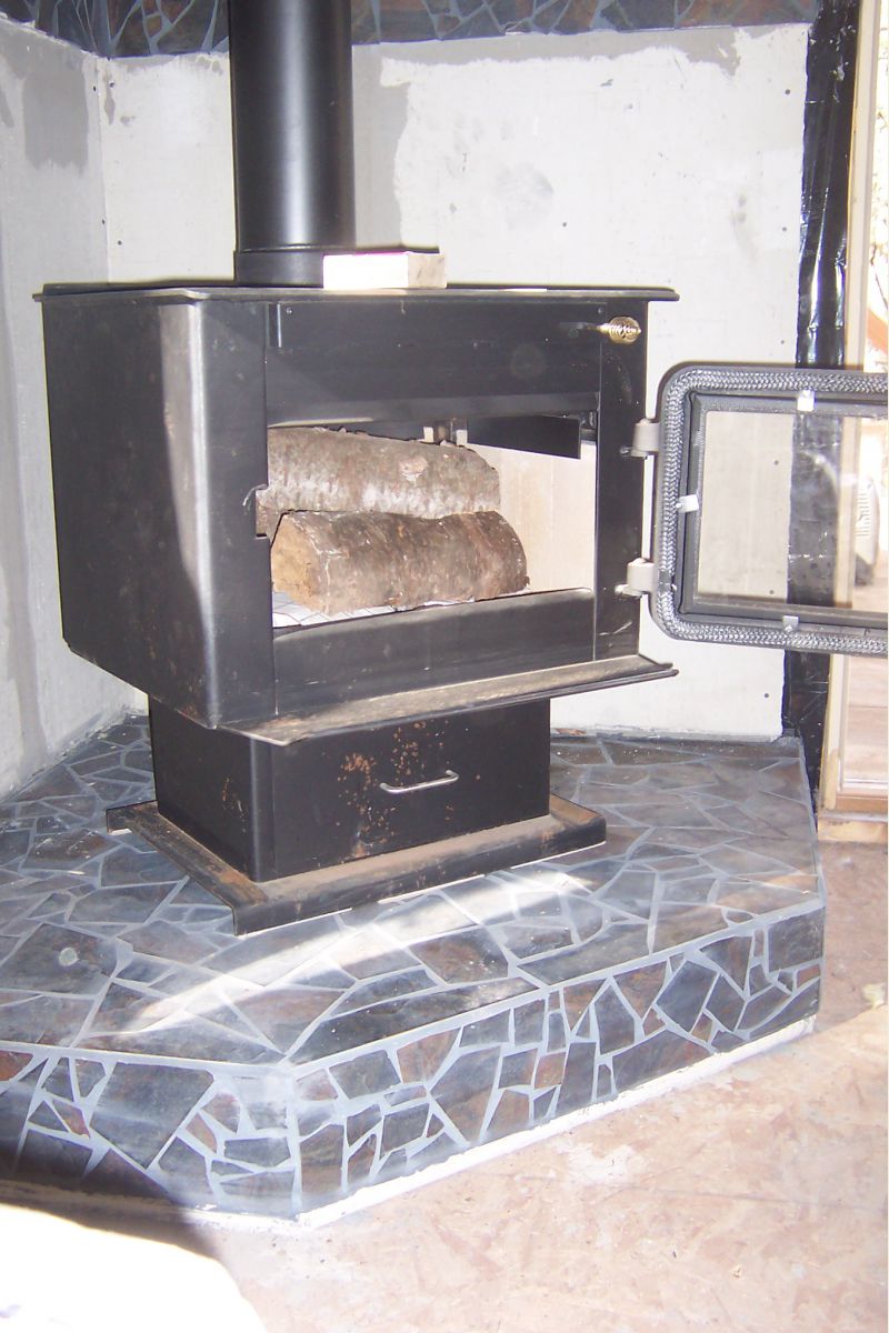

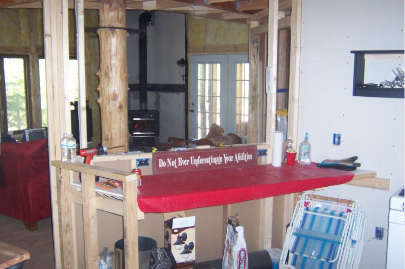

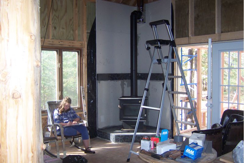

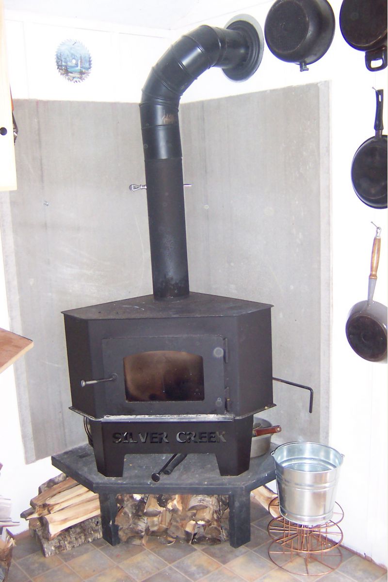

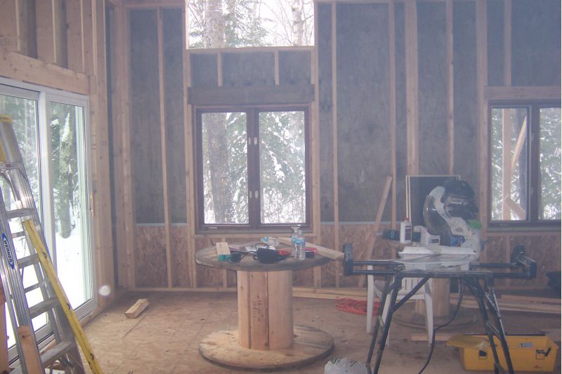

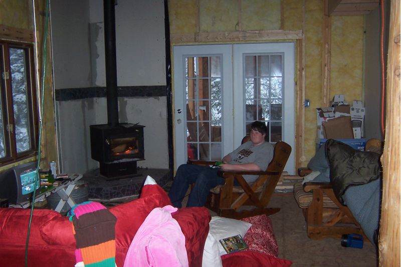

Interior and wood stove.

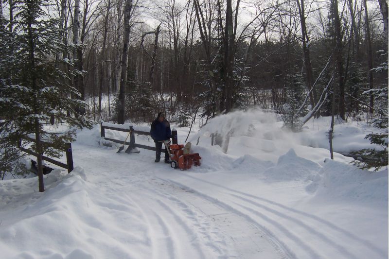

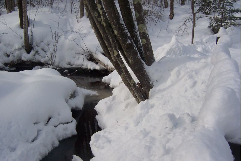

Here are some winter pictures.

Photos are great. How long is your driveway/road in? Do you snow blow the whole thing, or do you have a plow? That's going to become a significant issue for us this winter and we have no current plan (other than park at the bridge and snowshoe in!)

As far as plowing the driveway we have a local guy up there come and plow in January. We have only needed him once each year so far and he is very reasonable in cost. We pay $40.00. We bring the snow blower up in January to clear our paths to the cabins and outhouse. The total length of our driveway is approximately 300'.

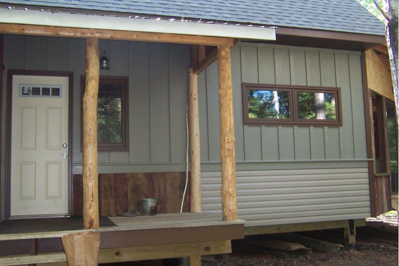

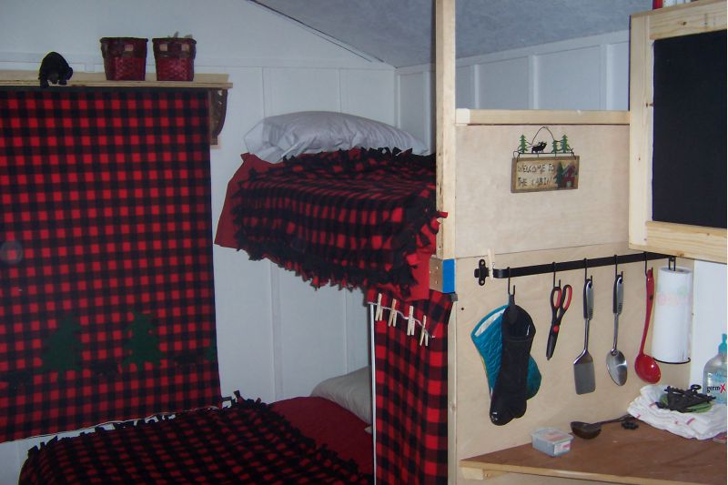

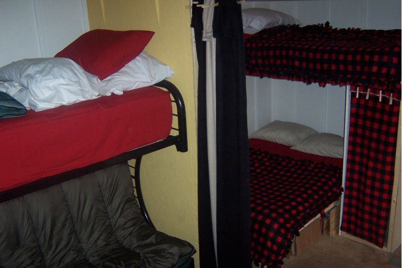

We are planning to use the little cabin(we call it the bunkhouse) as guest quarters. It is set up to sleep 6 and can seat 8 to eat if we wish. It has a woodstove in it that keeps us toasty. So it has worked out very nicely for us.
To answer the question about the holding tank for our outhouse...it is awesome!!I highly recommend this type of system. We researched forever and finally this type was recommended to us by Young Plumbing out of Superior. We bought it through him for $750.00 but the tank is made in Rice Lake,Wi. Our outhouse is 6x6 plus the porch and there is no stink! We use holding tank deodorizer from Walmart and it works great! We have not had it pumped out yet-probably next year. The tank is 300 gallons with the toilet built right in and the vent. We sank it into the ground and built around it. I can actually say I love my outhouse!

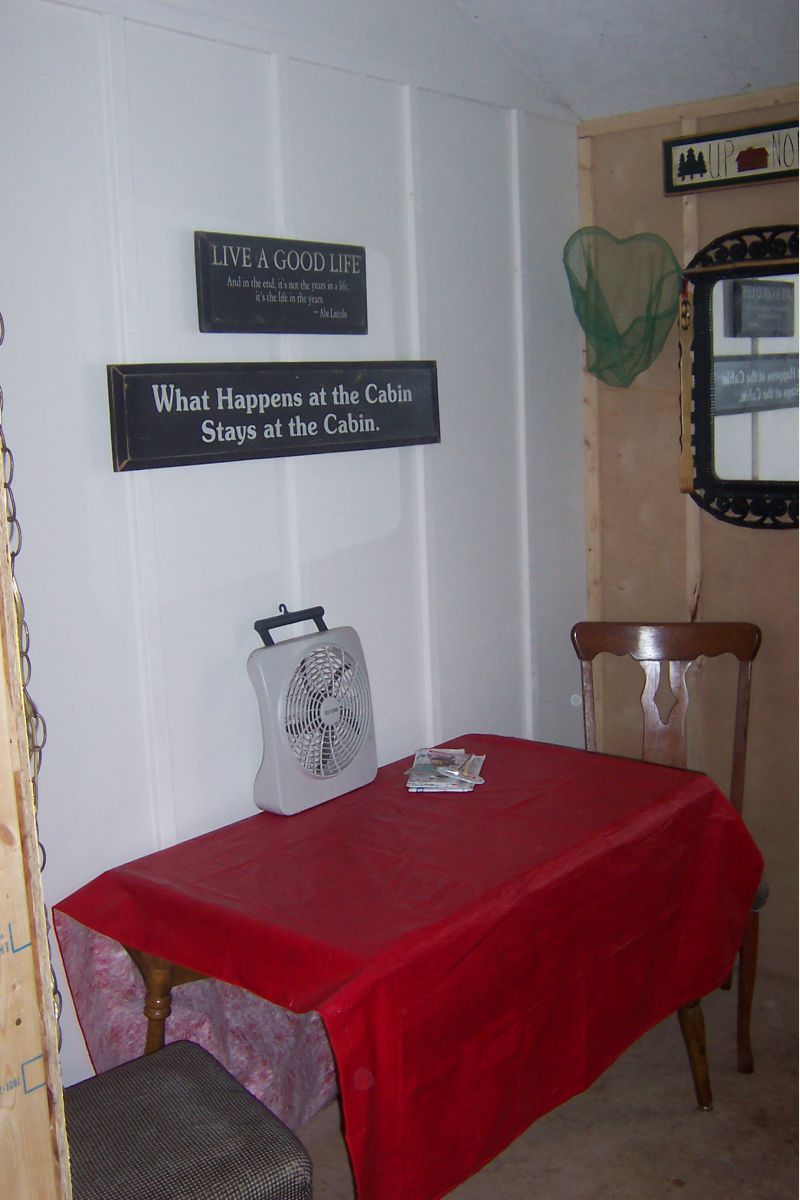

bunkhouse
bunkhouse
bunkhouse
bunkhouse
bunkhouse
bunkhouse
bunkhouse
bunkhouse

I also have good news to report on the cabin-mainly our bridge. My husband went up early this morning because luckily he is working way up north today. The bridge is fine. The water had been flooded over the creek banks but has receded. They call our tiny creek a "flash" creek meaning water rises high but goes back down fairly quickly. The river close by was as high as he had ever seen it by far...it was about a foot under the bridge that crosses it. That is amazing to me to imagine. Yesturday I had a fever and felt like I had been run over by a semi truck. Today I am feeling better -so far no fever- and since we don't want to go anywhere near the NICU we are going to the cabin. I don't know how much work we will get done or even what we will choose to work on but it will be good to get away. For everybody who is able to get to their cabins this weekend-ENJOY!
