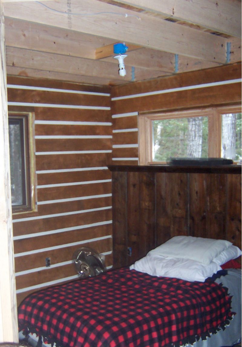

We got a little work done-the last railing built and ground fault interrupters installed to meet code. I got our bedroom walls "chinked" too.

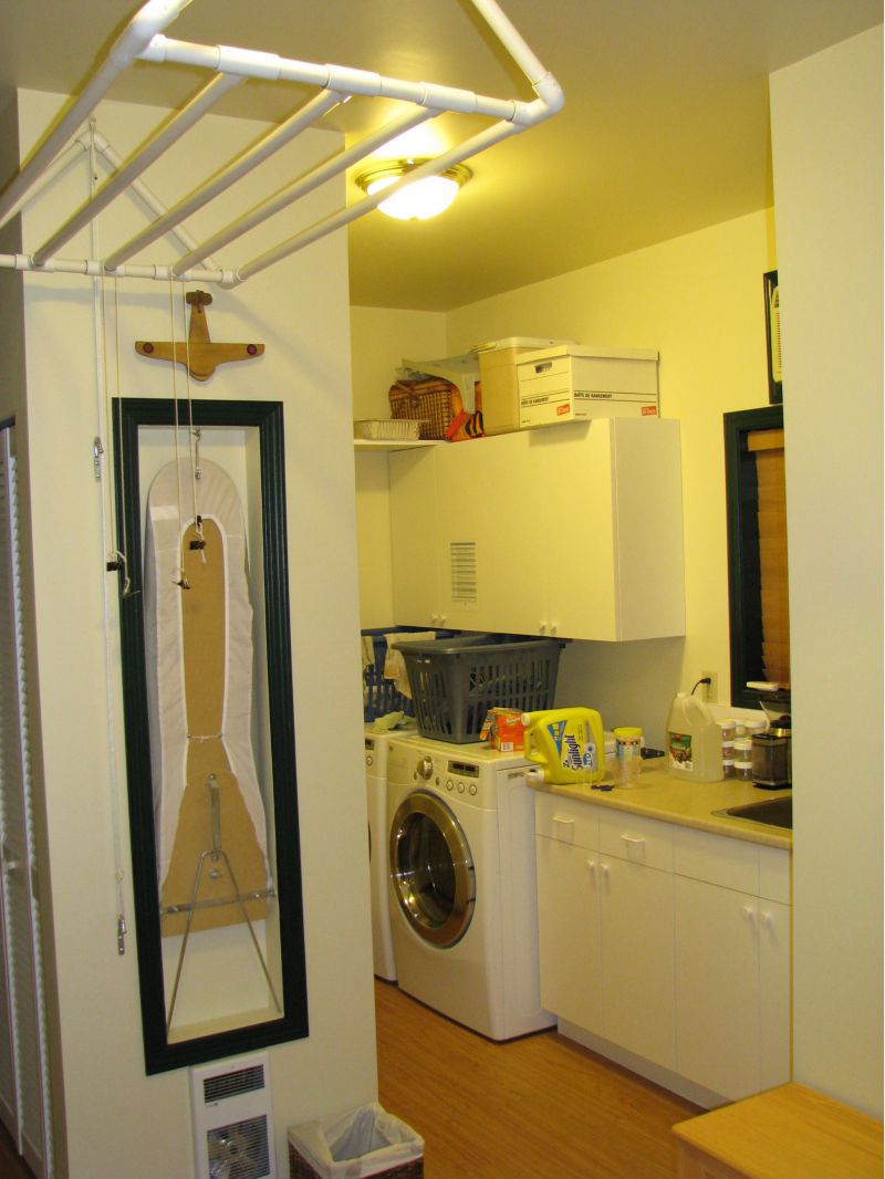

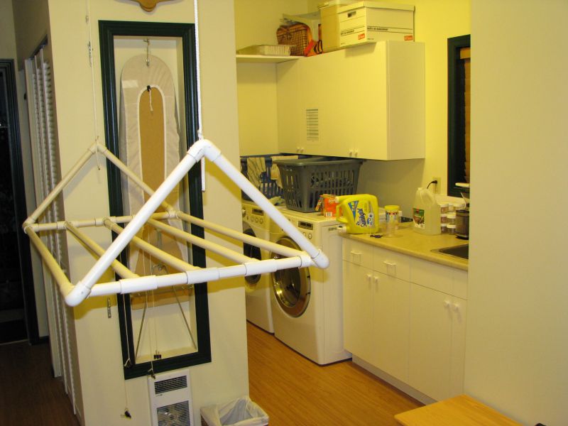

Hubby built this rack out of PVC Pipes. It is extremely strong and can hold soaking wet winter coats without bending. I use it weekly to dry our laundry on. I drape clothes over the pipes and also hang clothes on wooden hangers from the pipes to hold a LOT of laundry.

How does your rack move up and down Hattie? That is what I want to be able to do too-except would it get too hot for PVC? I would like to have some sort of a pulley that raised and lowered it. Your laundry room looks like a very efficient use of space BTW!

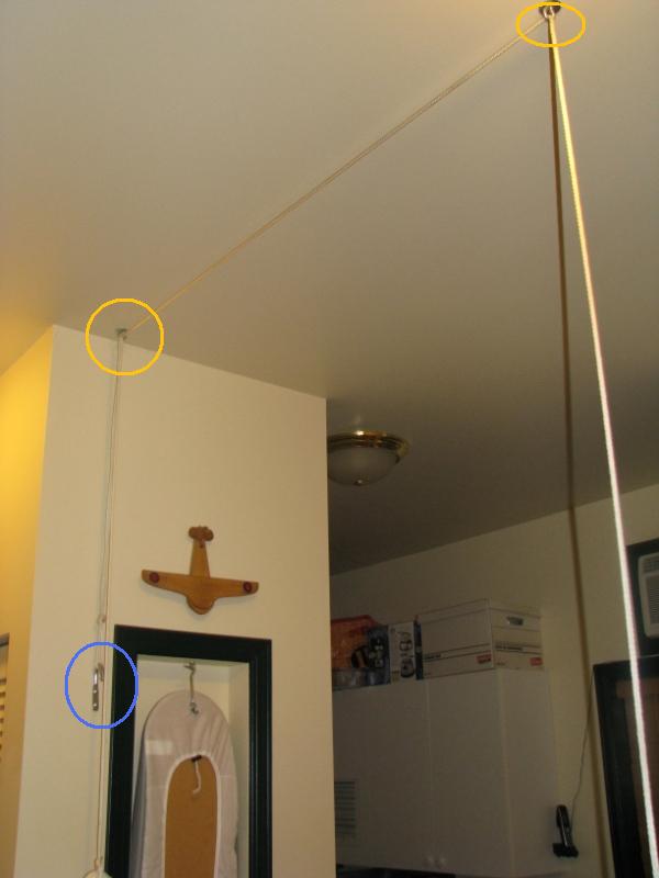

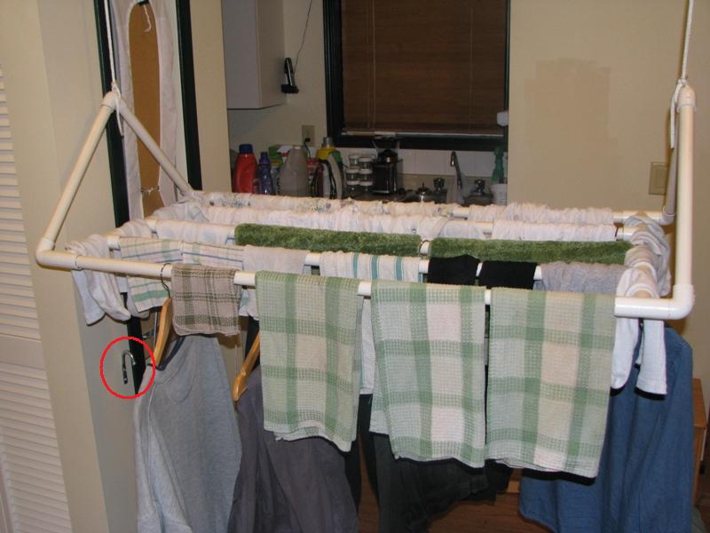

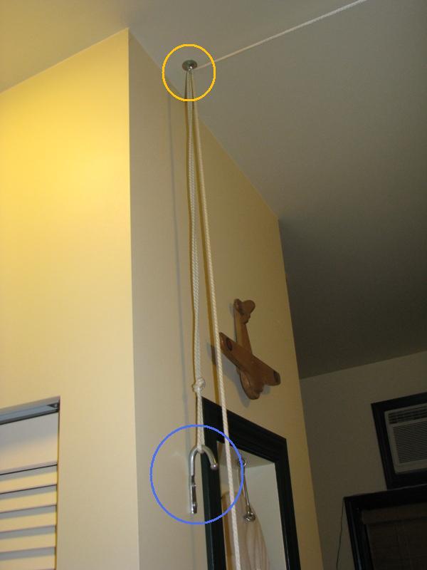

Thanks trollbridge...Here are some close-up pictures Hubby just took for you. I did laundry this morning so excuse the laundry on it. *LOL*
I just asked Hubby about your question about getting too hot and he said "PVC pipe is good for the hottest water from a hot water tank. If it gets too hot for that, then it is probably too hot for your clothes too."
The rack is just pulled up and down by a rope that it hangs from and put on hooks at the desired level (up or down). We don't use pulleys because that would take additional height. We wanted to be able to walk underneath it when it was up. Instead, we used eye bolts. I usually have the rack down when I have laundry on it because we have a heater just behind it that does a great job drying things. When I need to use the laundry room for other things, I raise up the rack. It can be heavy to raise when it is loaded with laundry but if I get Hubby to help, we can get it up and out of the way.
In the photos, the ceiling attachments (screw eyes into joists) are circled in yellow, the lower hook is circled in red and the upper hook is circled in blue. There is just a loop in the end of the rope that hooks over the hooks on the wall.

Thank you Hattie for taking the time to post pictures and all. I guess your husband is right...if it's too hot for the PVC than it probably would be too hot for the clothes too :P Duh, I guess I didn't think that one all the way through!! Mr. Trollbridge wants to put up hooks for coats/pants and a shelf for mittens and hats-we shall see. At this time of year I always feel like winter will be darn near over by the time we are able to get back up. We have stuff going on every weekend into Christmas but maybe we will be able to get away for just a day and one night. I miss being there but it is hard to justify the gas $$ for just one night.
I am thinking your drying rack would actually work out very well in my home laundry room---I always run out of space on my one short hanging pole. How long would you say it is?
# Posted: 6 Dec 2011 06:08pm
You are welcome trollbridge. Our rack is 51 1/2 inches long. The pieces of tubing are 43 inches. It is made from 3/4 inch PVC pipe. It is 25 1/2 inches wide. Hubby said if you make it too long it would be too difficult to raise and lower and it will be too flexible.

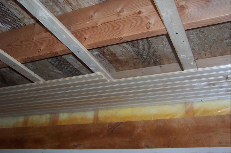

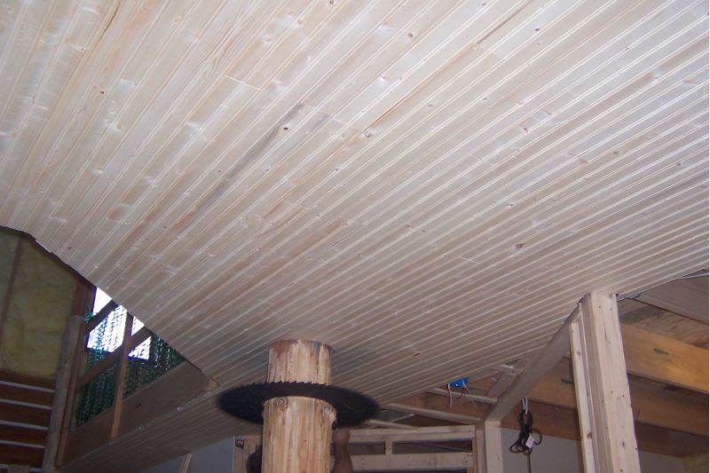

We worked on putting up that beadboard ceiling. Kinda a one person job and took longer than I thought it would. We put up 1x3 strapping to span the joist and then the boards were tongue and groove. Glad that we got as much done as we did. We also framed out the closet door under the stairs.
