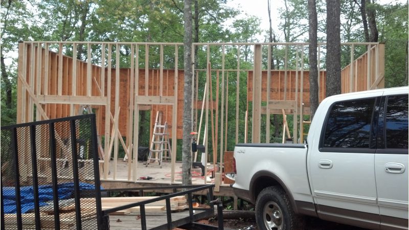

Got the front wall up this week with the help of my wife Jodi! It was in two sections and one section was really heavy for us to lift because it is a 12' high wall 16' long with one header that is three 2x8x7' and the other is three 2x8x42" long. I will post pictures later this week. Now its time to finish up the sheathing!

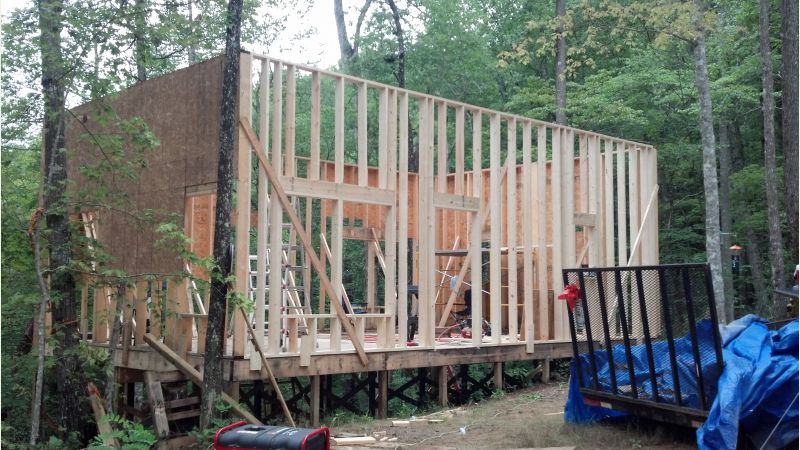

# Posted: 3 Aug 2012 03:08pm
Here are a few pictures of the front wall Jodi and I built!  201207front_wall.j.jpg

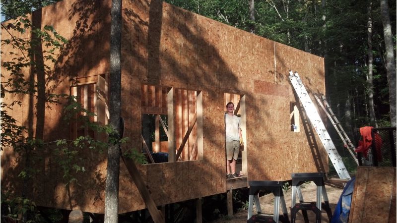

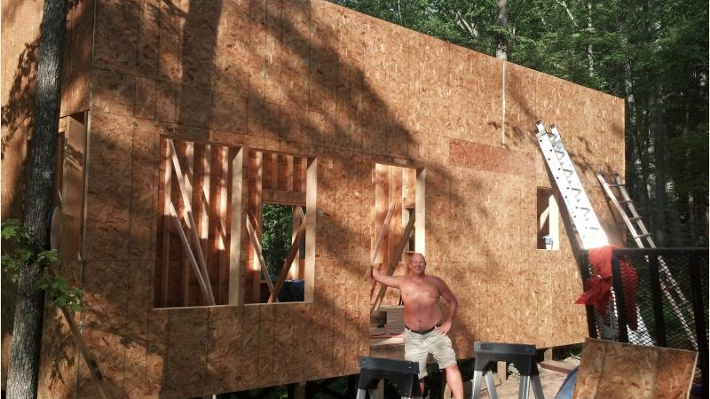

# Posted: 9 Aug 2012 08:02am
Here are some pictures of the sheathing that has been installed! Could not have dont this without my son Jacob helping me!!  201207_sheathing_on.jpg

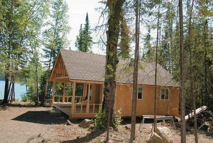

# Posted: 19 Aug 2012 05:59pm
Here's one I built with 8/12 over three sissors trusses in Canada.
Owen

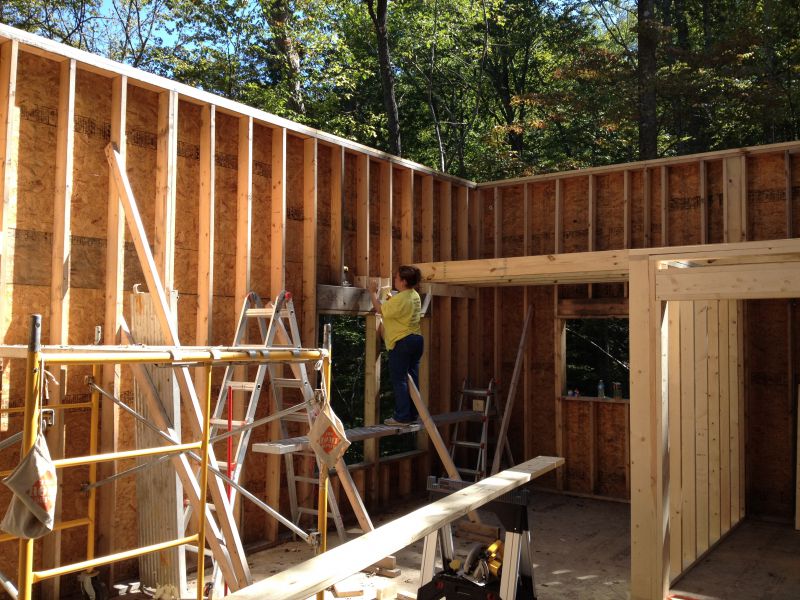

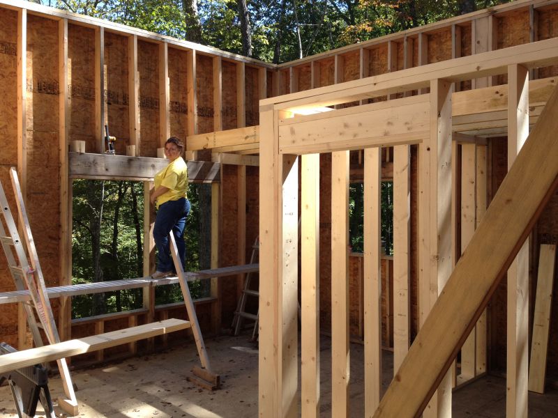

# Posted: 24 Sep 2012 09:15am
Got the bathroom and kitchen framed with one of the loft framed!
Next weekend the other loft will be framed if the rain stays away!

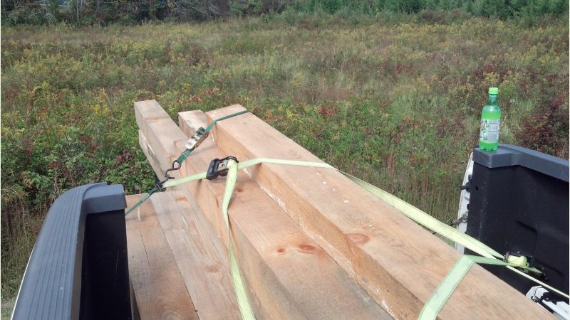

Heading up to work on the second loft tomorrow! Will pick up my timbers cut from the saw mill tomorrow!
Ready to install the second loft!!
SonnyB
# Posted: 2 Oct 2012 05:02pm

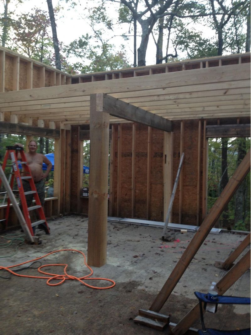

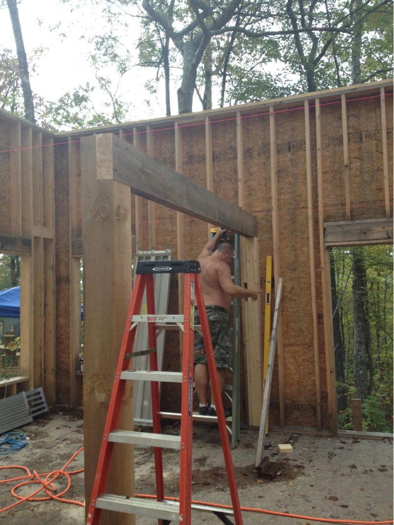

Jodi and I went up this last Fri and picked up a load of timbers! I love the look of big timbers! Then we cut the 8x8 post and but and installed the 4x10 beam! Load_of_timbers.jpg

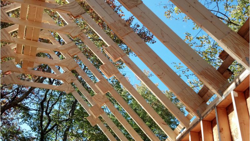

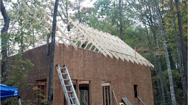

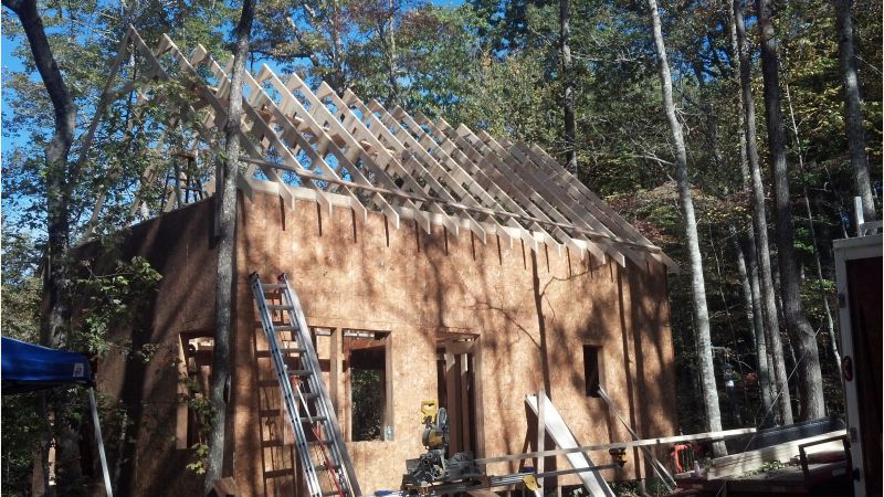

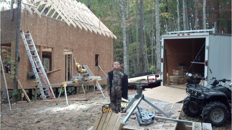

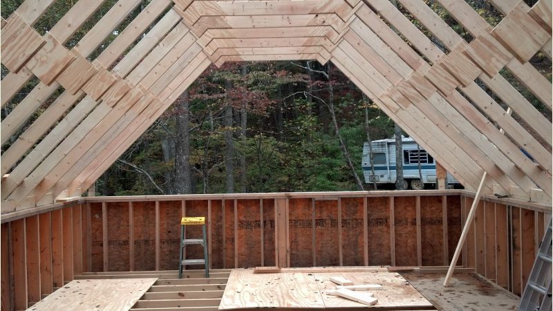

Did a lot of work this last few days! We built the trusses and have them all installed!!
I will post pictures soon!
SonnyB
# Posted: 19 Oct 2012 09:15am

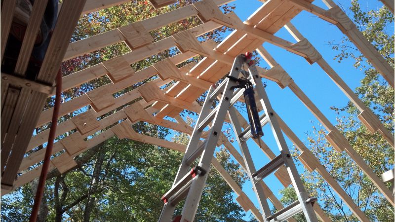

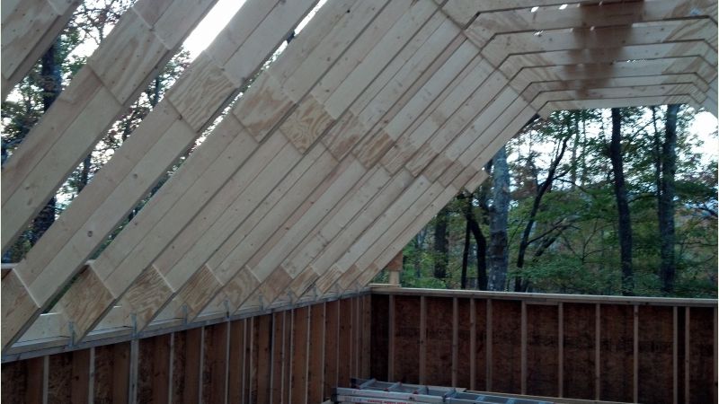

SonnyB
# Posted: 19 Oct 2012 09:17am

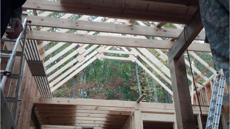

SonnyB

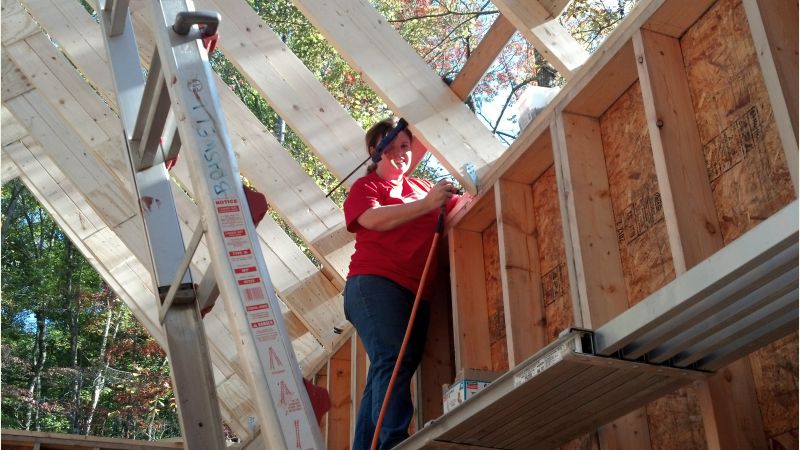

# Posted: 19 Oct 2012 09:21am

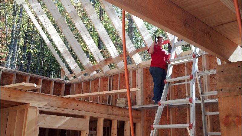

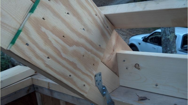

Jodi working hard! Her new favorite tool, palm nailer!! Jodi_on_walkboard_wo.jpg
