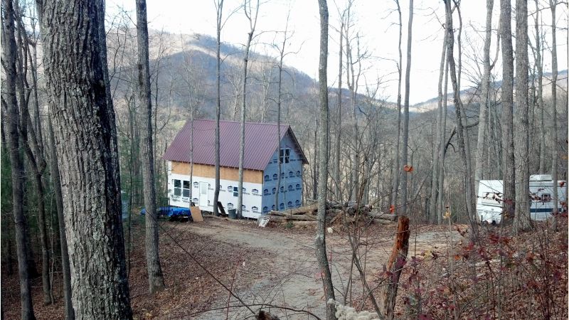

# Posted: 28 Oct 2012 09:00pm
Have metal roof on!! Started framing in the gables Sat. and will finish up in the next few weeks.
I will post pictures of our new roof later this week!!

# Posted: 29 Oct 2012 11:38am - Edited by: SonnyB

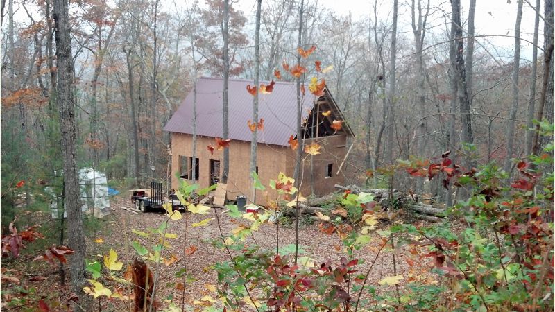

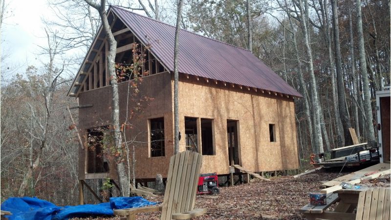

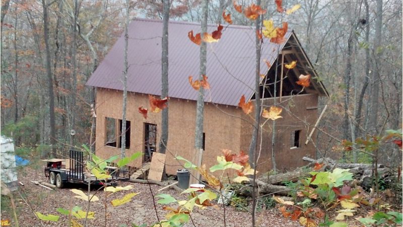

Roof on!!

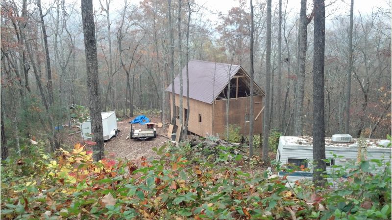

SonnyB

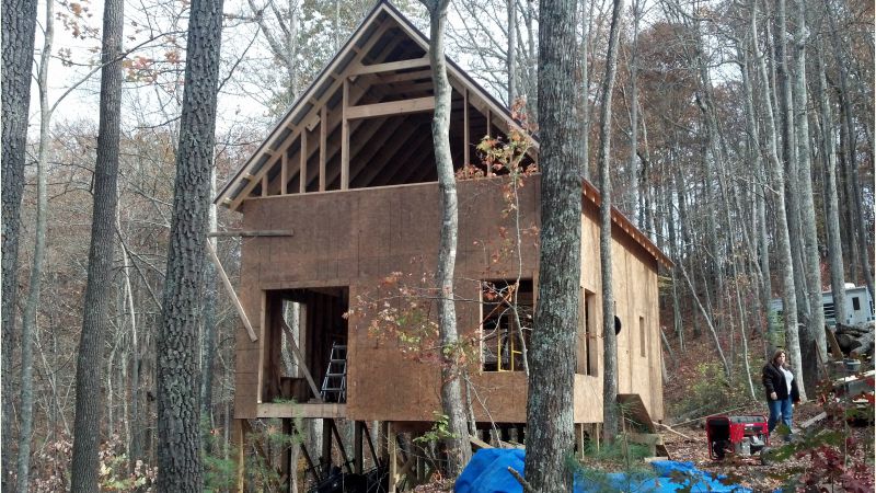

# Posted: 29 Oct 2012 11:41am

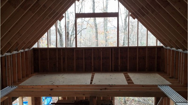

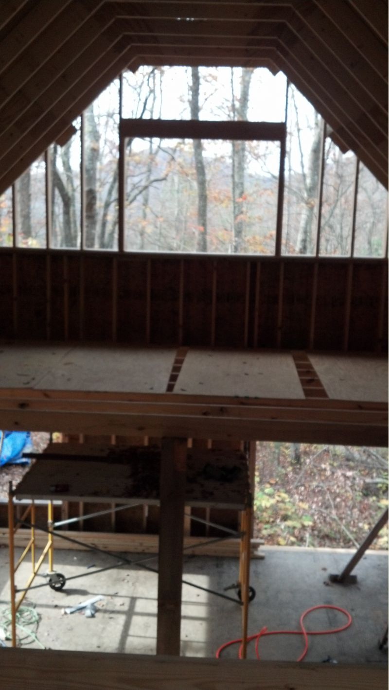

Framed in gable end with double window for a view!
I will have 10' from the loft floor to the ceiling in the cabin. 20121027_view_from.jpg

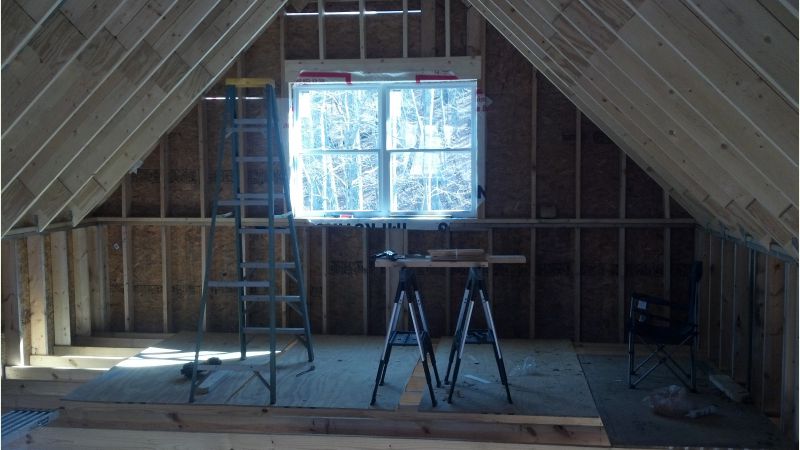

SonnyB
# Posted: 6 Nov 2012 11:09am - Edited by: SonnyB

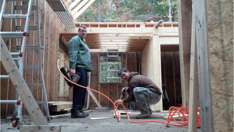

Me working on the gables in the loft. Love having 10' ceilings in the loft!

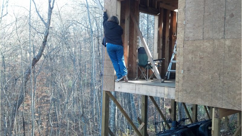

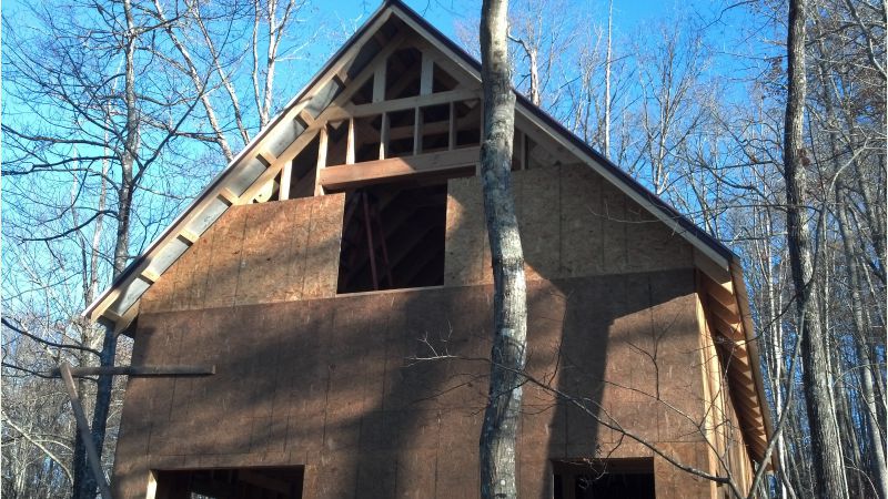

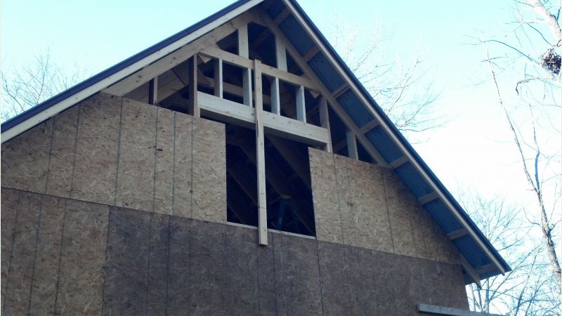

Jodi and I put up a few sheets of OSB in the gables this last weekend. Thats all we could get done for now because my ladder would not reach to the top of the gable.

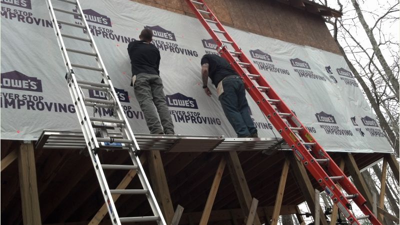

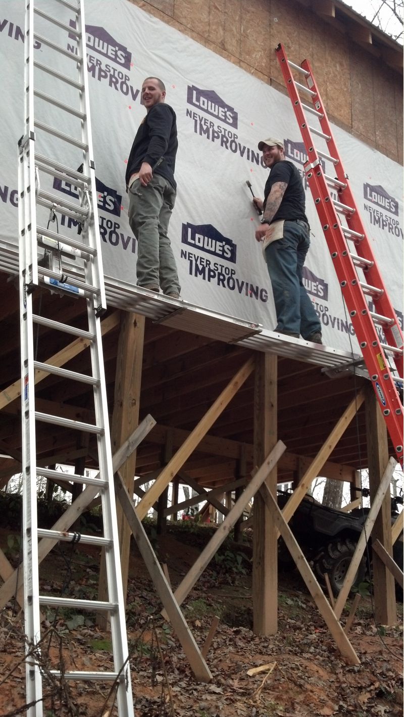

# Posted: 26 Nov 2012 08:21am

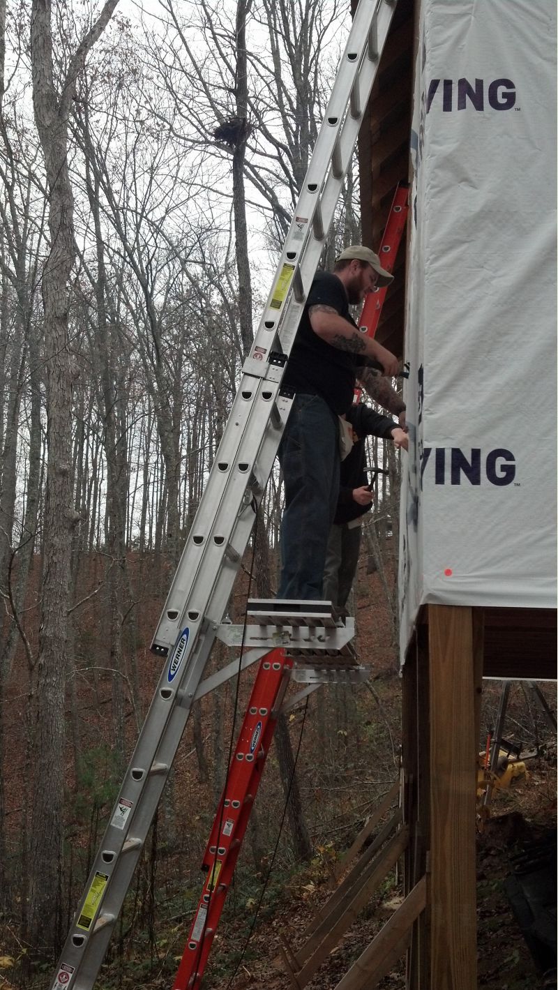

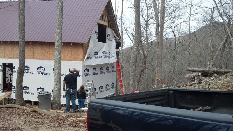

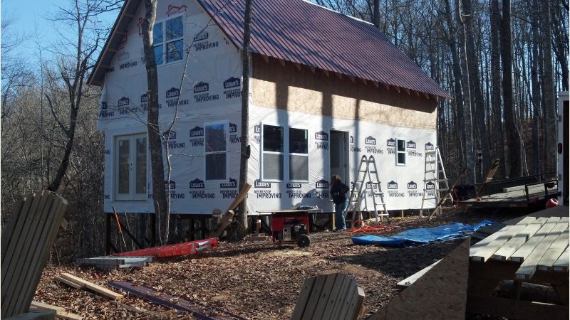

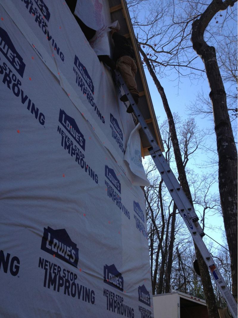

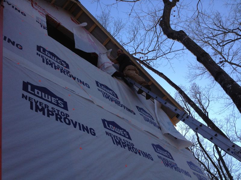

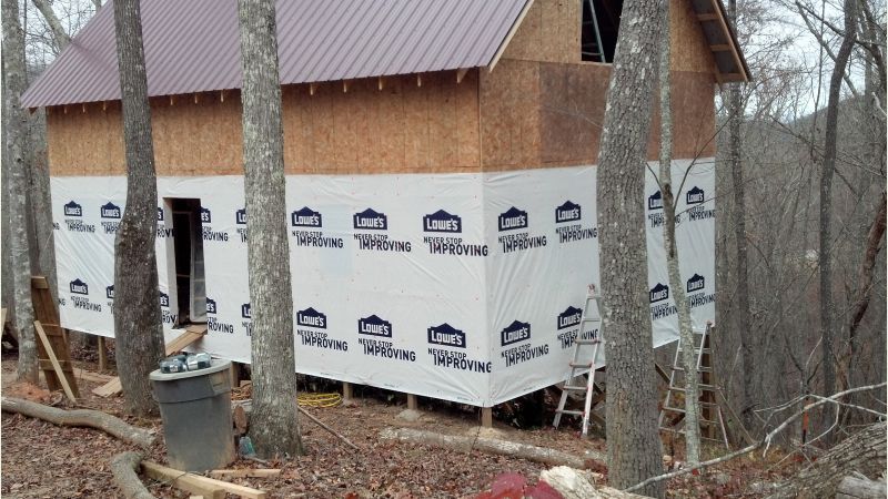

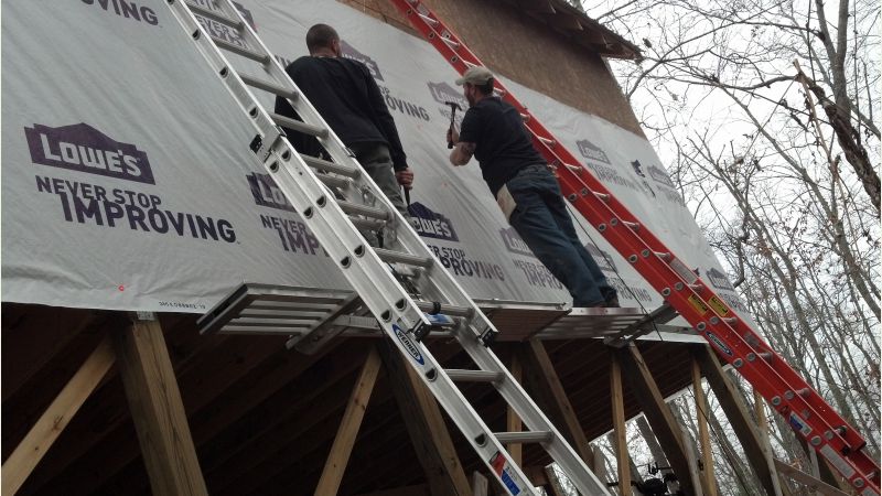

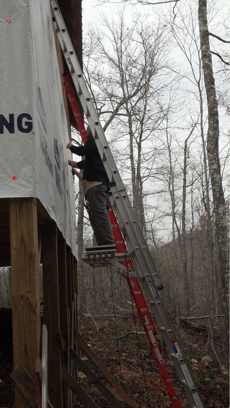

SonnyB
# Posted: 26 Nov 2012 08:24am

# Posted: 26 Nov 2012 08:27am

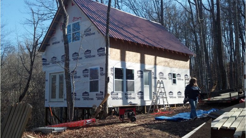

SonnyB
# Posted: 26 Nov 2012 08:49am

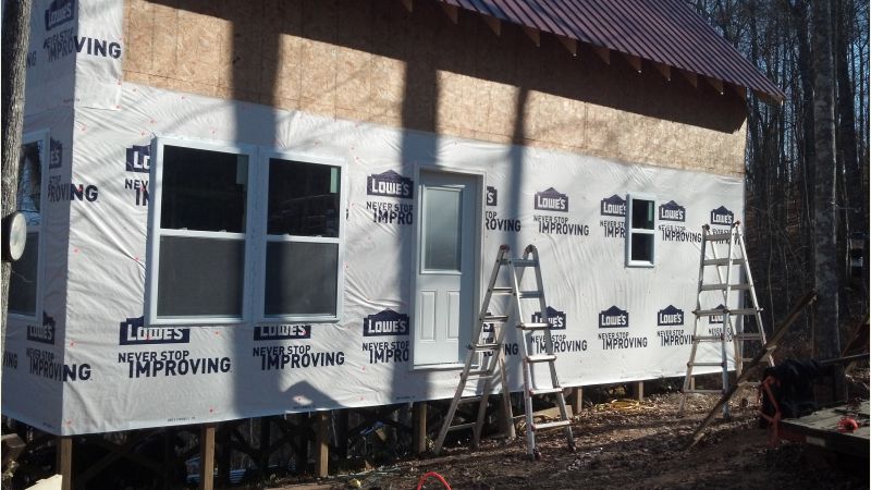

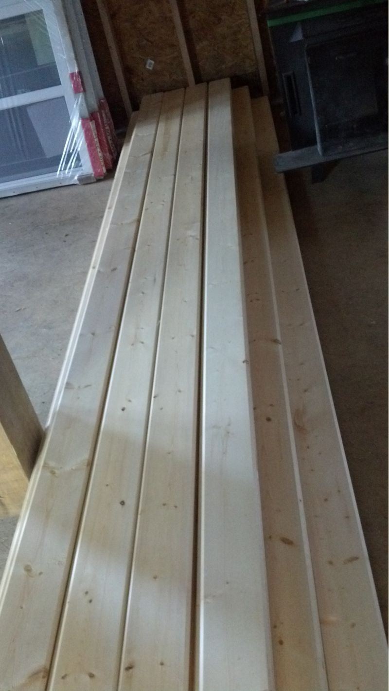

Bought the 2x6 t&g flooring for one side of the lofts! Worked Sat.- Wed last week and got alot done.
Then Sunday took a pontoon ride and went to breakfest at Martians Marina on Jackson Lake. Weather was cold 33 degrees but the lake was nice!  Lumber_for_loft.jpg

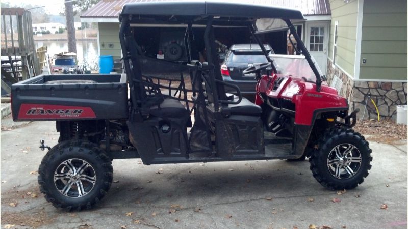

New toy! 2012 polaris ranger crew 800.
Great for work also. Will haul and pull 2000lbs!
2" lift with forward a arms and 28" swamp lite tires, hard top, gun rack, and safety nets in the back for the grand kids!

Looks a bit precarious after studying the hillside pictures. Probably just the angle of the photo. I hope to use 6 x 6 beams on concrete piers, then rims and joists on top of the beams. Building inspector specified piers.
SonnyB
# Posted: 14 Dec 2012 08:22am
It is steep on the back side. Its about 8' from the ground to the bottom of the floor joist and only 2' on the front wall so thats 6' drop in 20'. I used 6x6 on the back wall at 5'5" and the front wall and middle is 4x4 placed 4' oc.
Hope to go up this weekend but now its supose to rain. I need to do outside work so I will just have to wait and see.
