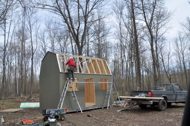

I wanted something simple and easy on blocks (a shed) to ease building permit issues and tax load. I settled on a 12x16 lofted barn setup from Tuff Shed. In hindsight, I wish I knew of Owen C before doing this, he is relatively local and I could have had a better built place. hindsight is always 20/20 I guess. Save for 1 day with a skid steer, this has all been done by hand. I REALLY want to buy a tractor....
I had a heck of a time with Tuff Shed. They couldn't do anything right. Finally after a 2 month fight, I gave up and fixed what I could myself, and started to finish off the cabin (my driveway is still a mess thanks to them though).

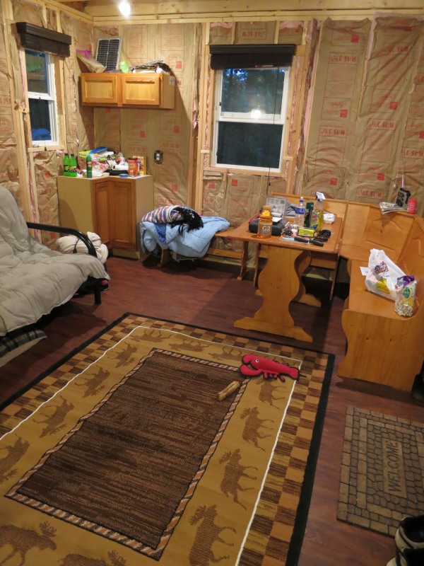

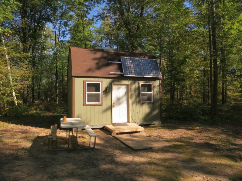

This summer I installed the floor, a few cabinets, futon, breakfast nook, A/C and D/C wiring, sealed it up, insulated, and installed the basics of a solar power setup. Just this past weekend I installed my 4, 80 watt solar panels on the roof and while the wiring is still not complete, they are now charging my (2) 6V golf cart batteries inside with a Rogue 3024 MPPT charge controller, and providing AC power through a Morningstar Sure Sine 300 inverter.
I intend on cleaning up the wiring next weekend and building a battery box, then I am going to divert my attention to heat. Thanks to another thread on this forum, I'm going to install a small, direct vent propane heater in the wall, and eventually install a small wood stove (undecided which yet)

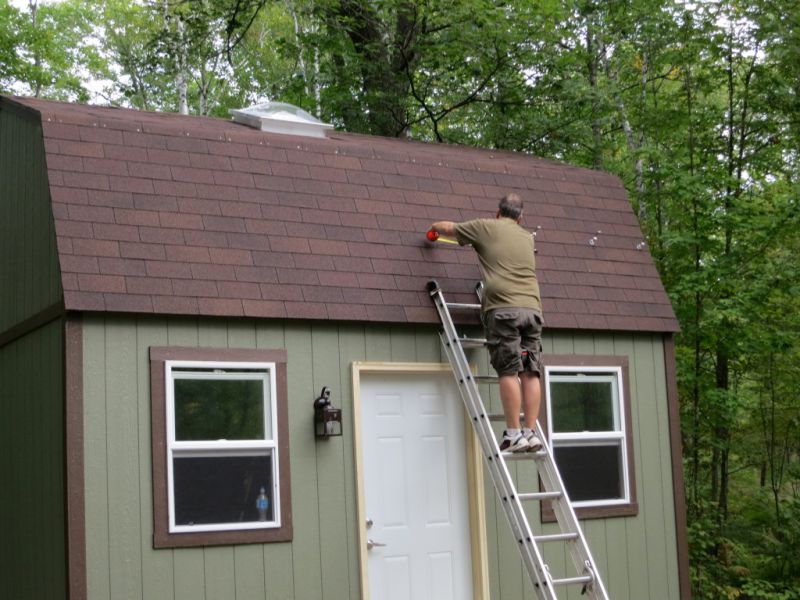

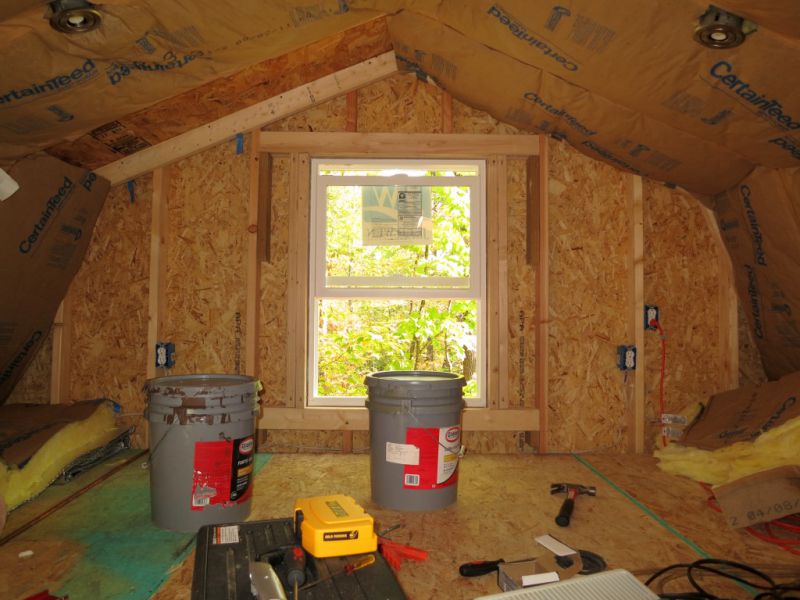

I had my Dad help me install a window in the loft yesterday. All summer it's been so hot up there and I don't know why I didn't think to install a window up there when it was built
Anyways, we started by measuring inside, cutting out the 2x4 supports and building the header and footers, and then the side supports. Then we cut out the siding, caulked up the window, and put it into place. I ran out of time to finish sealing it, but it should be fine until we return in a couple weeks to finish sealing it with tape and more caulk.

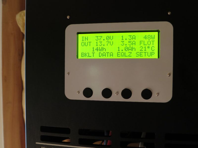

I also installed my new charge controller, a Rogue MPT-3024, and hooked up all 4 panels to it. By noon, the batteries were full and in float mode, and 18ah had been replenished into the batteries. That tells me we haven't been discharging the batteries very deeply, which is good. I still need to clean up the inside wiring and build a battery box, but all in good time.
