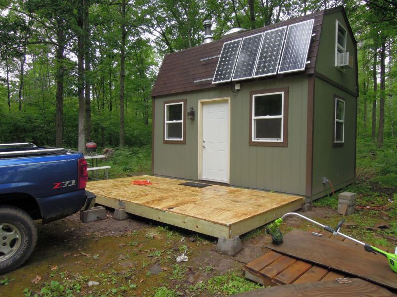

well, it's been a rainy summer. Every time I go up there, it seems to rain. I was finally able to get 4 hours of dry time to build the base/frame for the porch. The drywall has been mudded, sanded, and primed, and as of tomorrow, it will be painted!
I have some more pictures at home I will post up when I remember to. As you can see in the photo, it even rained on me as I was finishing up. I don't want to hear anything about a drought any more this year! It always get so humid there when it rains, and then the sun comes out. You can see the little 5000btu AC in the upstairs window running from the EU1000i.

Looks awesome! Skeeters have been a real pain, too!

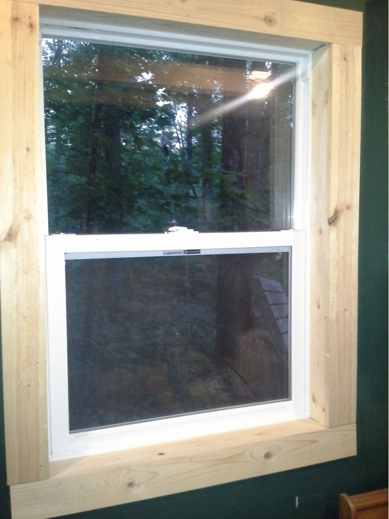

I did some knotty pine window work too. It turned out pretty nice!

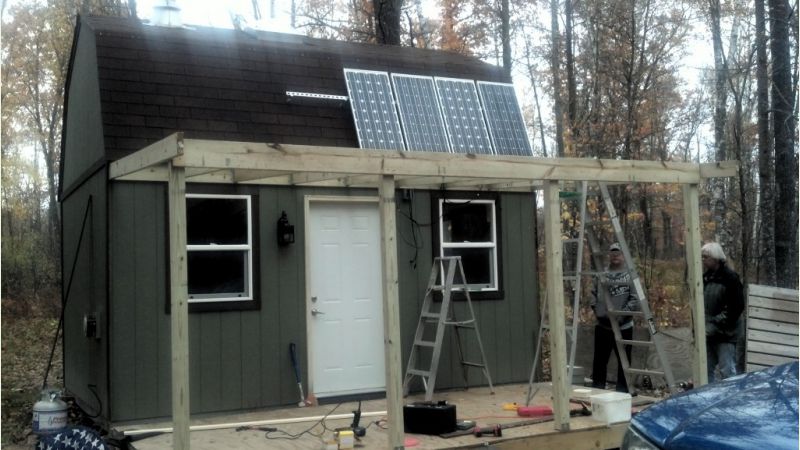

some upgrades in progress...now all it needs is a roof!
# Posted: 13 Oct 2013 09:51pm
Reply Quote
You'll like that porch for sure.
Dillio187
# Posted: 14 Oct 2013 03:01pm
Reply Quote
I've been looking at steel for the roof at Menards, lots to choose from.
# Posted: 14 Oct 2013 04:19pm
Reply Quote
....so many choices.....but any one of them will look great! you are going to love, love, love having a porch!!!!

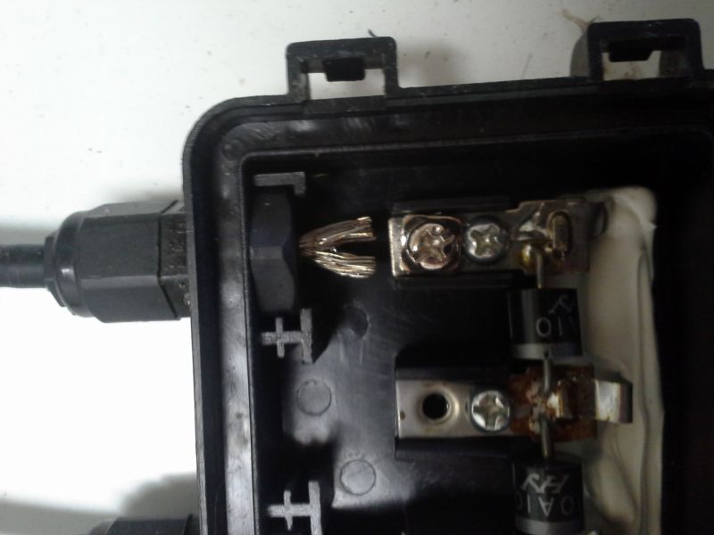

On another note, I had a solar panel fail sometime this summer, I noticed my batteries weren't charging at nearly the rate they used to. Using my multimeter I tracked down which one it was, took the panel down, and brought it home. I took the access cover off the panel and found this. At least it was an easy fix!
