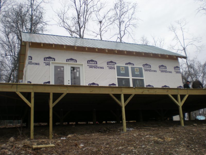

Today we completed the front gable end on the house, got house wrap installed and all windows and doors in.
The forecast for tonight and early tomorrow is 1 inch of ice/freezing rain and 1 - 3 inches of snow so I think tomorrow will be an off day.
Hopefully we will get back out on Friday to build one more set of deck steps and the stairs inside the house.

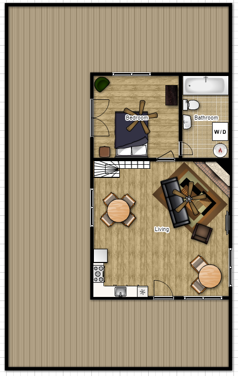

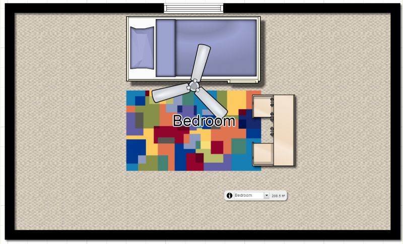

I had someone ask about a floorplan and with the ice storm today I am stuck inside so I found a floor plan website and put these images together.
The house is 20 x 32 with a 12 x 20 loft area that will be our son's room and a little additional storage. The first floor will have our bedroom (12 x 14) and a bath (6 x 12) that will leave a 20 x 20 with cathedral ceiling for the kitchen, living room, dining room, office area.
The deck runs 10 ft out from the house on 3 sides totaling 920 sq ft, making it larger than the house sq footage. It caused me to go way over budget but the feeling you get when out on it is incredible and I wouldn't change it for anything.
Due to the small sq footage of the house, we figured leaving the ceiling area open would allow us to add a second loft later if we decided we needed the room. After getting the house dried in, however, I can't imagine closing that high ceiling up. It looks great.
I hope this answered the questions on floorplan but if not, let me know.

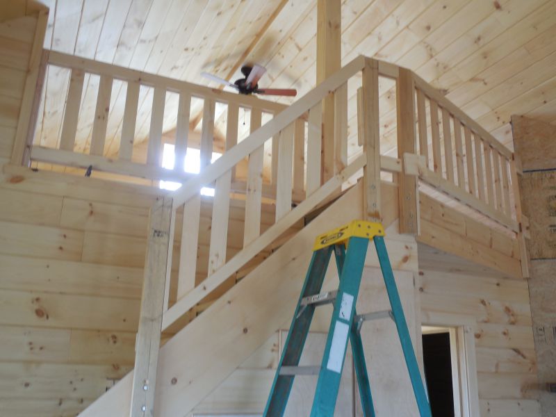

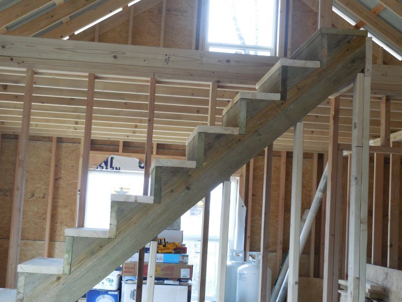

Spent Fri & Sat finishing up a few things. Got the loft stairs built, trimmed the deck boards off (quite a chore on 92 running feet of deck) installed the locks on the house and built another set of steps off of the back of the deck.
We were also supposed to get the fireplace installed on Sat but discovered we were short one piece of insulated pipe and not one fireplace store had what we needed in stock so we had to order it. Hopefully we will be able to get it in this coming week.
We unloaded the rental truck (kitchen cabinets, stove, fridge, flooring for the loft, deck rails & posts, bathroom vanity, assorted lights, etc.) and took it back. Even at $50 a day it was well worth having it as it was a real time saver with regard to trips to the home improvement store and a place to secure materials and tools until the house got dried in.

Stairs to the Loft
Stairs to the Loft
Stair Landing
Stair Landing

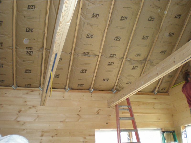

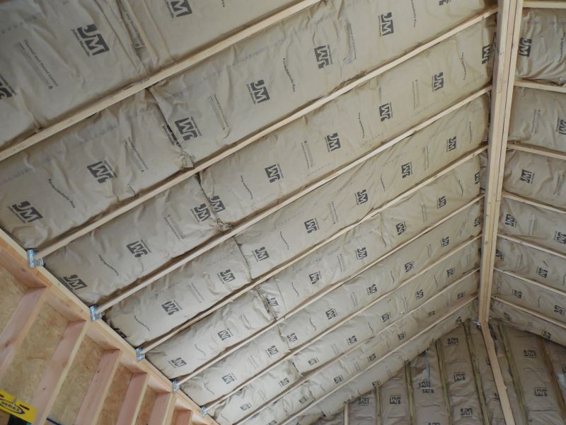

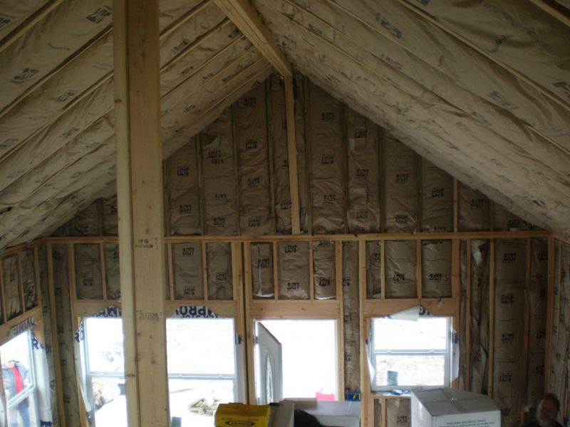

Went out yesterday and started on the cabin insulation & bird blocking.
By the end of the day we had all of the ceiling & gable insulation up as well as about 1/4 of the walls done. The wife had gotten a large area of debris, limbs and wood scraps burned as well.

Ceiling Insulation
Ceiling Insulation
Ceiling & Gable in Lot Insulated

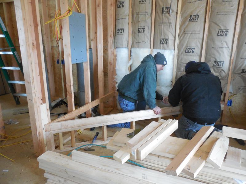

Even though we had light snow all day yesterday and the high was only 30 degrees, we got most of our goals for the day completed.
The breaker box was installed, wall boxes put into place for all outlets and switches and 90% of the wiring run for the entire house.
We also got the fireplace framed up and the first piece of pipe put into place before we ran out of daylight.
Taking the weekend off and back at it on Monday to complete the wiring and pick up the wood flooring and siding that came in.

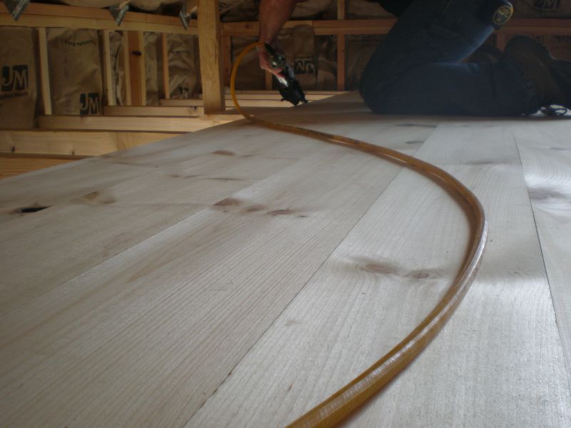

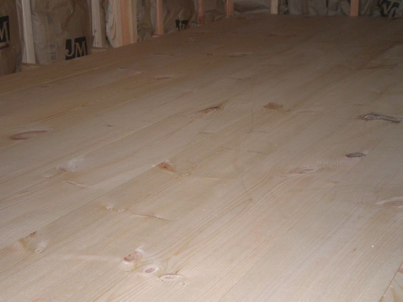

We completed the house insulation, electrical wiring and got almost all of the loft floor installed. The wife also cleaned up a large area that got burned.
Tomorrow the forecast is a high of 40 with 35 mph winds. Glad to be inside for that.
Tomorrow's plan is to complete the loft floor and start on getting the interior siding up.

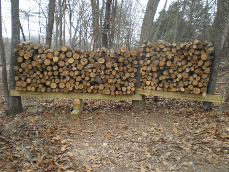

Firewood Rack
Firewood Rack

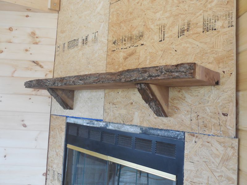

Fireplace Framed Up
Fireplace Framed Up

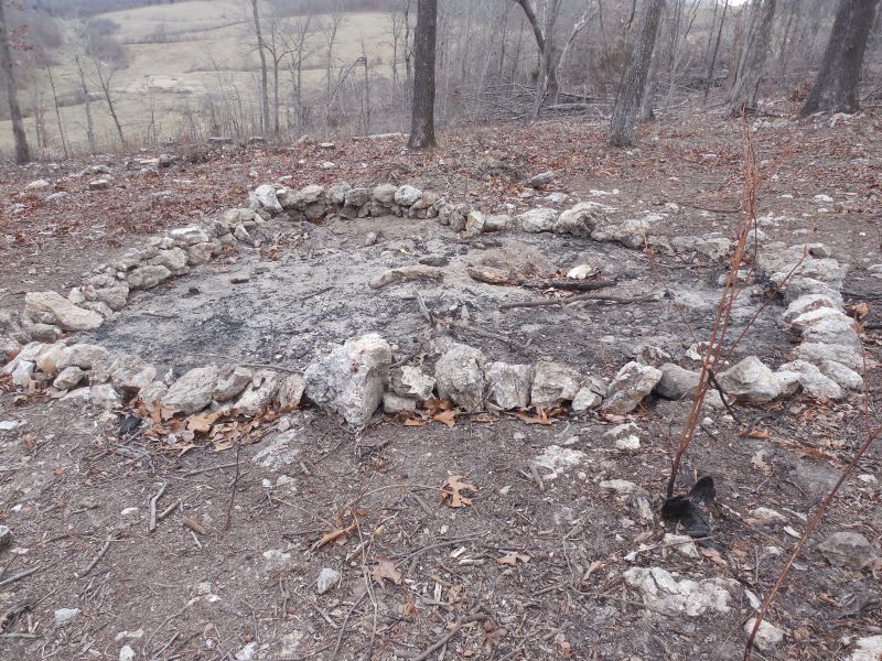

Fire Ring Started
Fire Ring Started

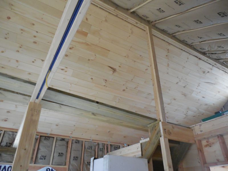

Completed Ceiling and Beam Wrapped

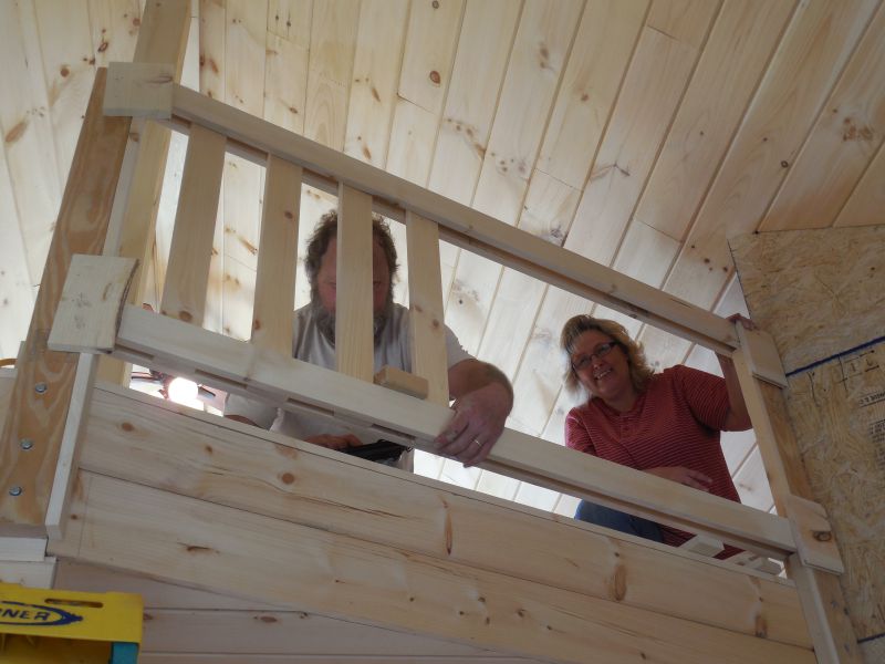

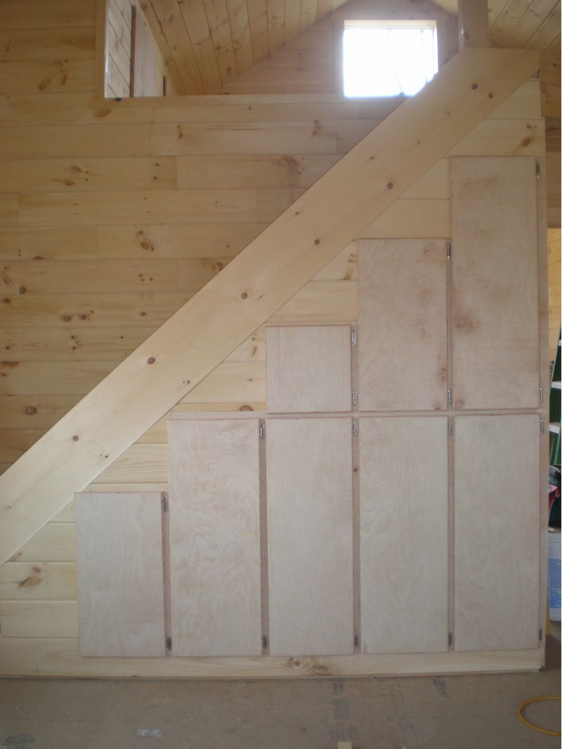

We have completed the interior siding, installed one of the 2 knee walls in the loft for storage, installed kitchen cabinets & countertops, installed the bedroom & bathroom doors, got all the bathroom fixtures in and completed all of the electrical and plumbing.

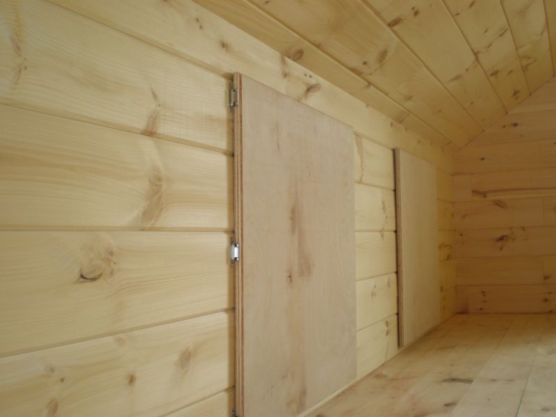

The big deal over the last couple of weeks, at least to the wife, was the completion of the "under the stairs storage area."
My wife is an extreme couponer. A VERY good extreme couponer. In fact, the money she saves by couponing had alot to do with us being able to build this place and pay cash for all of it. She always needs space for her latest haul of "50 cans of free tomatoes" or "20 boxes of free cereal" so the under the stairs storage idea was born.
Every storage space I have ever seen under stairs had tons of wasted space so why not treat it like a giant cabinet? That's what we did. Eight cabinet doors and three sheets of OSB cut into shelves later we have enough storage under the stairs to make her smile. I like it when she smiles.

Goatman
# Posted: 30 Mar 2013 12:52pm
I like this idea, I think I might adopt it and change it some.
Goatman
# Posted: 30 Mar 2013 12:53pm
very beautiful!
# Posted: 30 Mar 2013 12:59pm
Beautiful place. I love the under the stair storage idea! Genius!!!
MJW
# Posted: 30 Mar 2013 03:23pm
Thanks, guys.
Yeah, the under the stairs storage was one of my better ideas.
I am known for occasional milliseconds of brilliance. haha

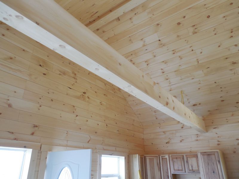

2 greatroom ceiling beams wrapped and finished out.

Started construction on the loft handrails today. We are building them with the same siding we used inside the cabin. Lots of ripping! Hope to wrap them up in one more session.

Beams Wrapped
Beams Wrapped
Handrails Going Up
Handrails Going Up

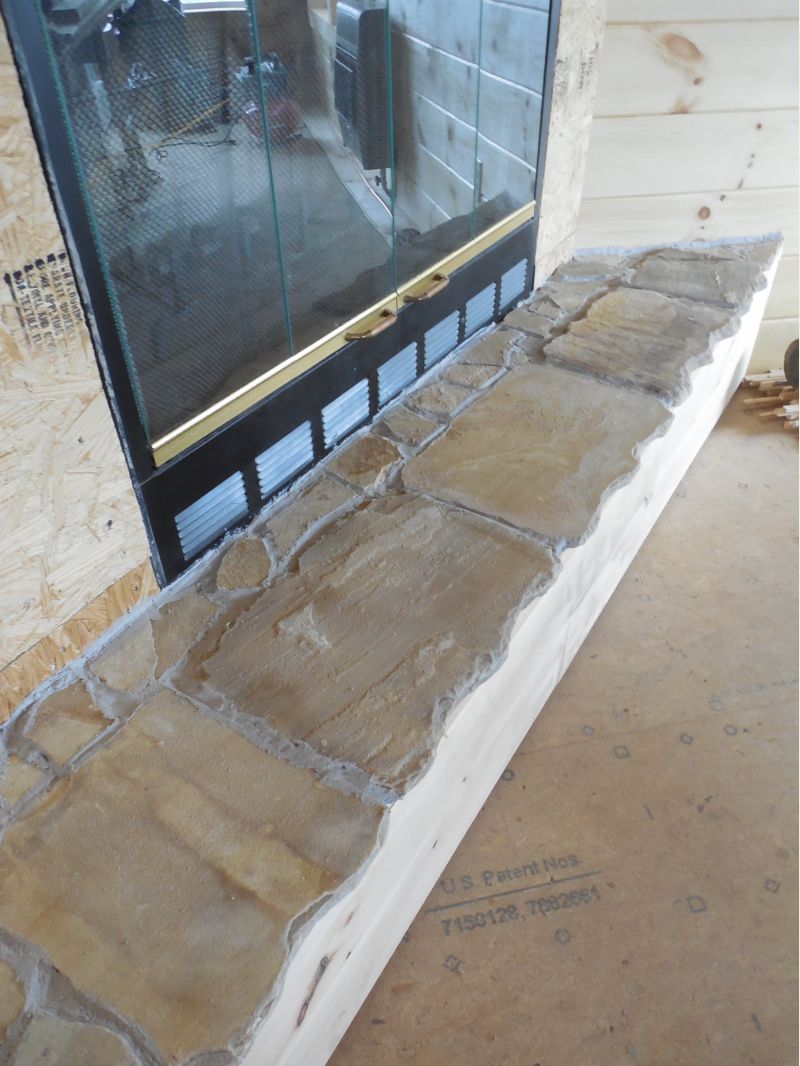

We spent one day in search of something to use for a hearthstone and found some sandstone we liked at Home Depot. Used some of them solid and busted up a few to put together a hearth that looks pretty good.
We found a guy that had a bunch of 3 inch thick black walnut slabs and got one to use as a mantel. Cut it to length and cut a couple of pieces of the scraps for corbels and got that installed.
Starting on the stacked stone tomorrow to complete it.
Spent more time than I anticipated on the loft rails but they are really looking good, I think so anyway. Hopefully only a couple more hours on them and they will be completed.

Hearth Installed
Hearth Installed
Black Walnut Mantel
Black Walnut Mantel
Loft Rails
Loft Rails
