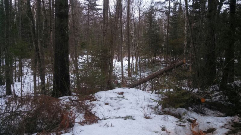

Well after 10 years of owning the property I'm finally getting started on the "storage shed". I went up last week and helped cut the last 10 trees I need to build the frame. The area where the trees were cut down will eventully become a pond. 32 trees in all came down, cut to 12 and 16 foot lenghts and hauled to the staging area for the portable sawmill that will make the 2x4, 2x6 and 2x8's needed to start my "Storage Shed". The ground was just begining to thaw as we got the last of the logs out. Im hoping I can get the saw mill in soon as the ground thaws and stiffens up some what.

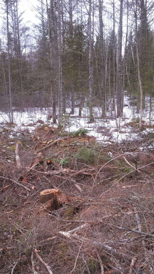

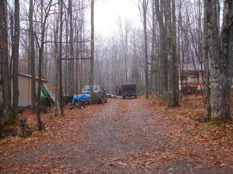

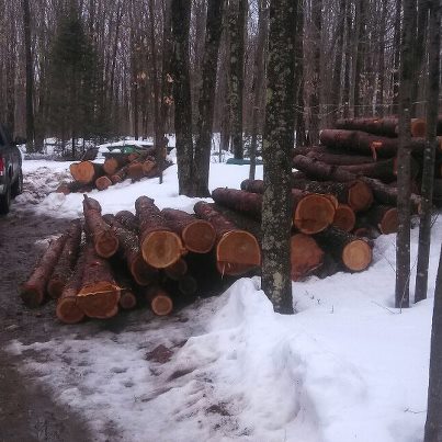

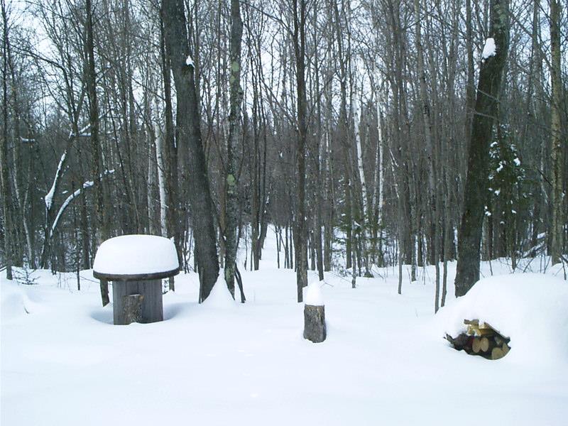

Picture #1 shows the area where the trees are coming out. The large trees in picture #2 are still standing. There are on high ground and will not be effected by the water level of the pond. Picture #3 is the staging area for the sawmill. Picture # 4 is the pond area with most of the larger trees taken out.

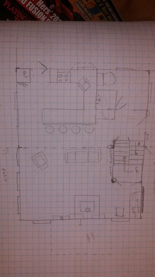

Why don't you post your floor plan and maybe someone here will have a good solution. I know what you mean, I agree a full stairway is probably best, especially with age, but it is hard to fit them in. I love a challenge though, so I'd like to try and help. There is a lot of good storage space under the stairs too...so think of it as gaining a closet too.

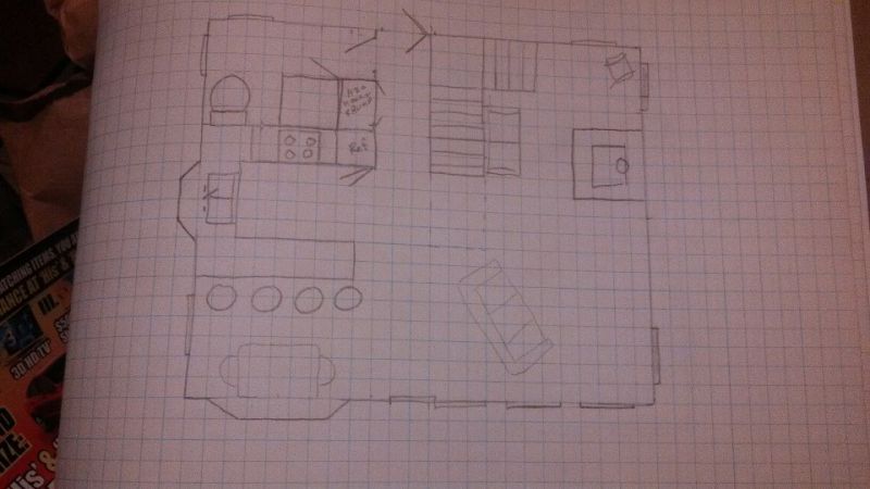

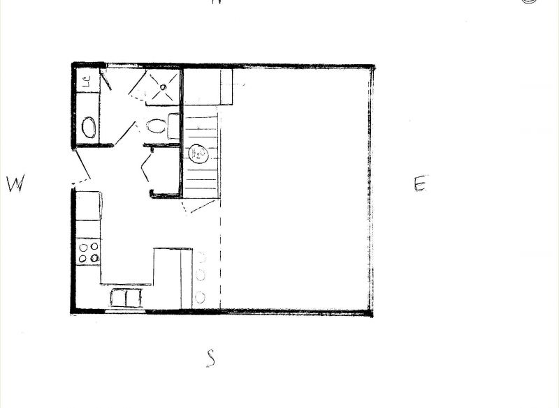

plan on making built in drawers for the first set of stairs, closet out of the rest. I still need a utility closet (hot water and electric) close to the bathroom. Trying to keep all the water lines as short as possible as I wont spent much time up there as Id like in the winter. I'll be using rain water for now (showers toilet, and dishes).
tsvoyager
# Posted: 17 Apr 2013 12:12am
also trying to keep an open concept. The reason for the steps on the North is I'm trying to keep the South wall open for the passive solar. The driveway is on the West side and all woods to the East

A spiral staircase may be a thought as well to take up less space. That's we did so the stairs are out of the way and don't ate up space in our main room. It will take away from under storage if you we hoping for that.
# Posted: 17 Apr 2013 12:15pm
Hi!
Thanks for posting...you have some really great ideas already going. I like your living room in the second plan. Like the table in the first plan-nice to have a table for cards and games. Like the bar stool idea in addition. Did you want 3 doors to outside? Just wondering? We have 3 too-gets us out to different sides of our place. Passive solar is good, as are short water lines. You've put a lot of thought into your plans.
Right off the top of my head I am wondering a couple things. What will your roof pitch be? Trying to consider headroom up there for locating the top of your stairs. Also, if you park on the west, will you be generally coming into your cabin using the north door?

skoot, as you can see, there isn't much storage so I'd really like the stair case over the spiral.
Troll, I'm not sure what the pitch will, be just yet Probably a 12/12. ,that will give me at least 11 feet of usable space at 6'6" height. and 16' at floor level. (knee wall going in at 4'6" height, 2 feet in from the outside wall, possibly rainwater storage tanks area ) The 3rd door could be cut to 2 to free up the wall space in plan #2. I can use either north or south doors to enter, but south is going to be a slider. It's harder to lock down when gone if you need to enter when arriving. (thinking of security issues as well)

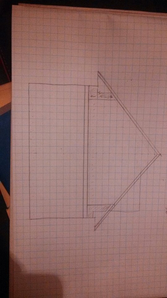

here is one of the elevation plans showing head room. 20 feet from floor to peak with a 12/12 pitch. In the loft, There would be 2 feet of dead space at the eve. A holding tank set up "Could" go there. Or I could use it as storage for the loft area, or both? Just some ideas that crossed my mind. I've thought about adding a dormer to the south side also. but as of right now, I'll be in a time crunch when I start the build in July. I'll have 2 weeks to frame, sheet and roof the shed along with windows and doors. I'm hoping to have it all closed in before I leave. Planning on Tyveking it for now, Siding next year

Wow! You would think a 20 by 24 cabin would be plenty easy to work with, but I understand why you are struggling now! Lol. I worked on your layout last night for quite a while, but trying to keep everything in mind, I feel like a solution is still out there. Now that I have a little more info, I'll work on it more.
One question-would you consider turning the cabin so a 20 foot wall faces to the south? That way instead of a shed dormer you could put windows up high for the passive solar. Also, what about 22x22 ? My thoughts there are you could run your roof whichever direction worked better for your loft. Do you already have your windows and doors?
Trying to get you full headroom for the stairs...I'll keep plugging away

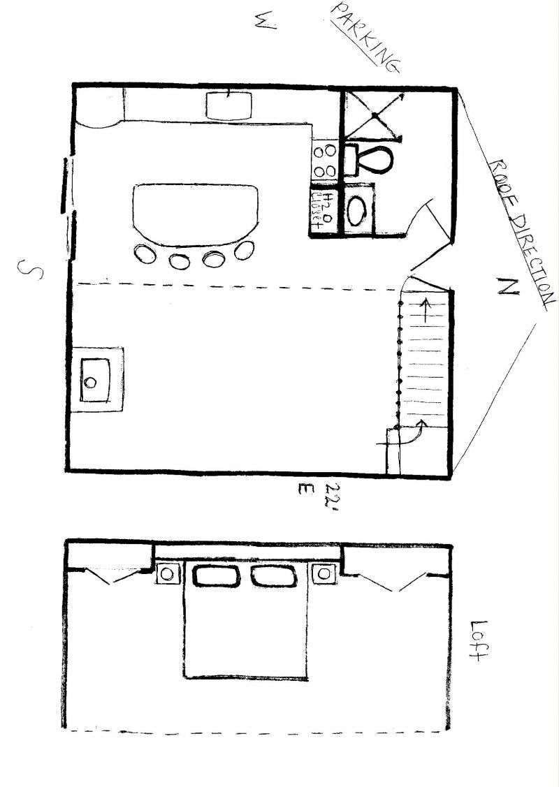

Here is what I came up with. It is 22x22 and I tried to keep in mind what you wanted. I kept your plumbing fixtures all on inside walls except the kitchen sink which you could switch with the range. The water heater closet backs up the bathroom. By running your roof N/S it allows the stairs to the loft plenty of headroom and also south facing windows in the loft for your passive solar- this also keeps you from having to build the shed dormer. It allows a window opposite on the north wall for a cross breeze. Your stairway is open railing with a closet underneath off the entry. Up in the loft I have the built in storage for your water tank over the bathroom area if you go that route. To set the bed back a touch, the wall is recessed at about 18". I'm not sure if that provides you adequate space-depends how tall your bed is. You could increase the width of your loft if you need the space or you could put your shed dormer here lol! ka-ching...
Feel free to rip the design apart, we will come up with a solution eventually. You could turn this, and have the kitchen/bath on the north, but I don't think you gain much. I did cancel your west side door. I also didn't draw in all your windows.
Hope this sparks an idea or leads to a solution!
Oh and yep, we aren't too far from you!

interesting plan Troll, but I was hoping to put at least one large window on the north wall as that is the best view of the land and where I feed the wildlife. Lay out of the land, 10 acres, 330 feet east to west and 1330 feet north and south. The road is aprox 220 feet to the south and the cabin will be just about centered east to west. There is a small ridge between the cabin location and the road with a dip in the ridge where I can see the road from the deck on the south. On the north side the land drops down aprox 30 to 50 feet (about 40 yards from the cabin local) and there is a trail just before the land drops off (going west to east) Pic #1 east view at (cabin location in front of the truck) Pic 2 facing west, Pic 3 facing south to road, pic 4 facing North and into the property.
# Posted: 18 Apr 2013 05:50pm
Well, lol...you could sit on the pot and put your large window in the bathroom directly across from it
What about the u shaped stairs you had in plan 2 only start upwards on the other side? Then you could put the window bench back.
