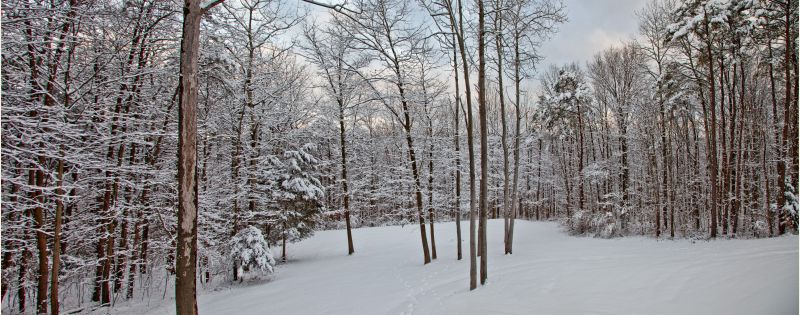

Here are some pics I took recently of the land surrounding the cabin - the woods are in the immediate vicinity, but the sunset was down the road about 1/4 mile.

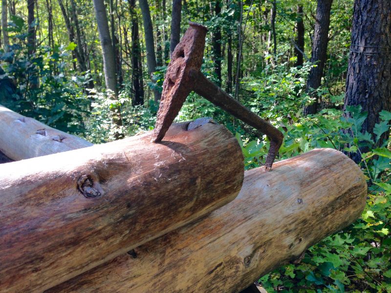

# Posted: 9 Oct 2016 10:48am

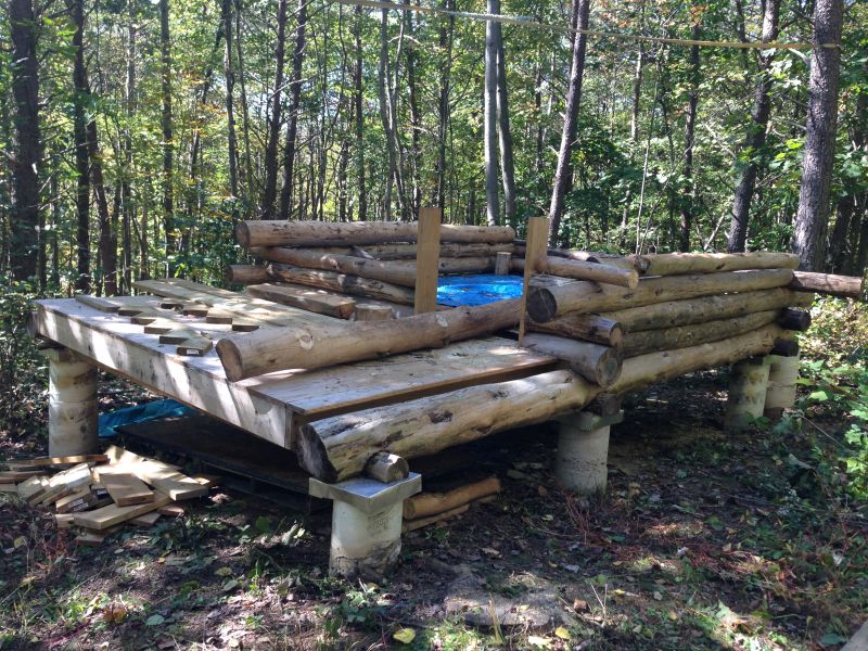

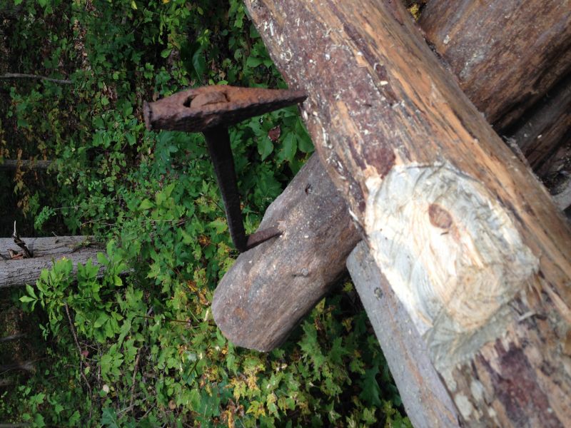

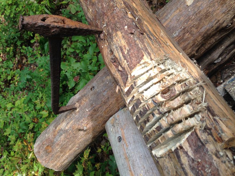

Had some time to work on my cabin this week. I bought an old log dog from eBay. It was found in the woods by the seller in Lancaster, PA behind an old log cabin. After a few logs, the pivoting head broke free and has made things easier. I don't know why I didn't buy one of these sooner! I contacted John Switzer at blackbearforge.com to make me a few new ones.

My logs are not the easiest to work with. There aren't too many straight pines on my property and the majority of these weren't selected for being straight, but cut down clearing the trail and building site. I'm definitely paying for that now!

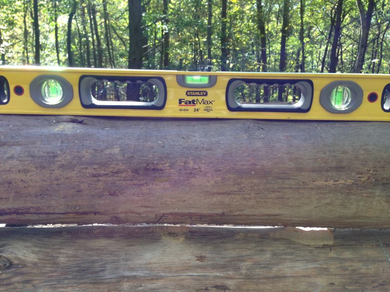

I may have mentioned this before but I'm running my saw between the logs one pass at a time to get the logs to sit as snug a possible.
Not too shabby!
Not too shabby!

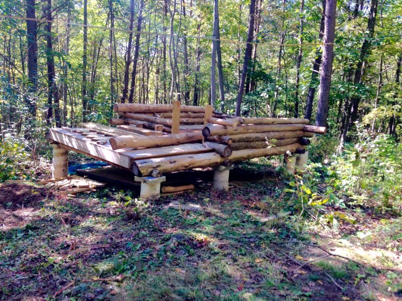

WyattEarp
# Posted: 9 Oct 2016 11:10am

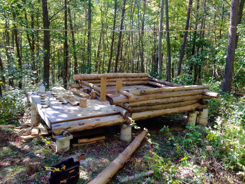

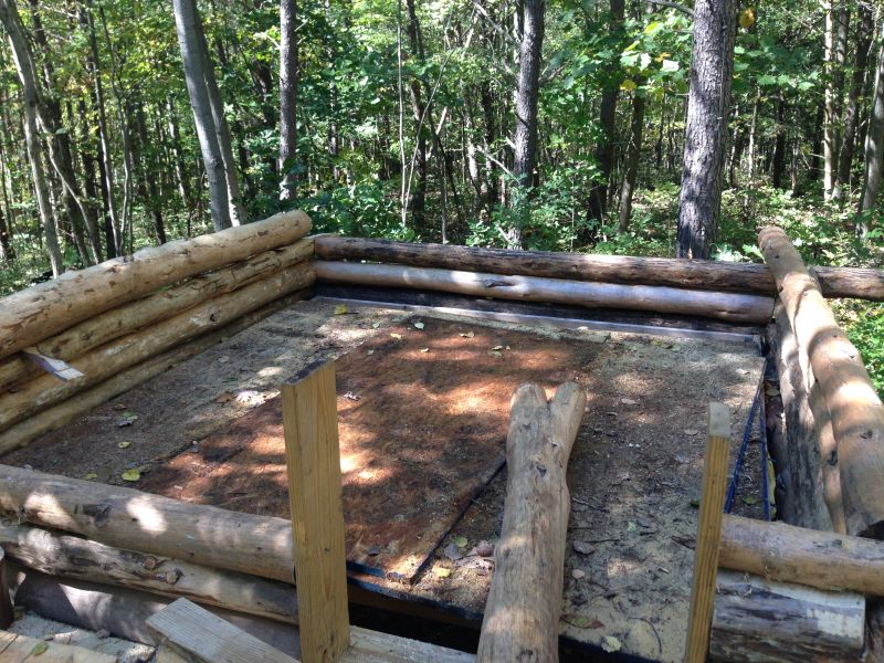

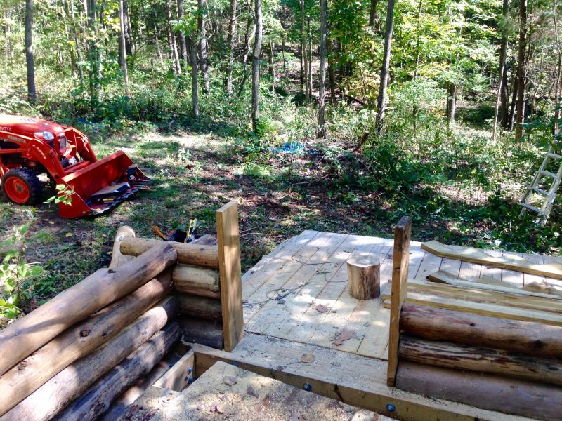

The weather was really good for the 2 days I had to work on it. It was very rewarding to see each log go up. I'm not going back there without a generator to predrill for the log spikes! They are not easy to pound in without it and ate up too much time.

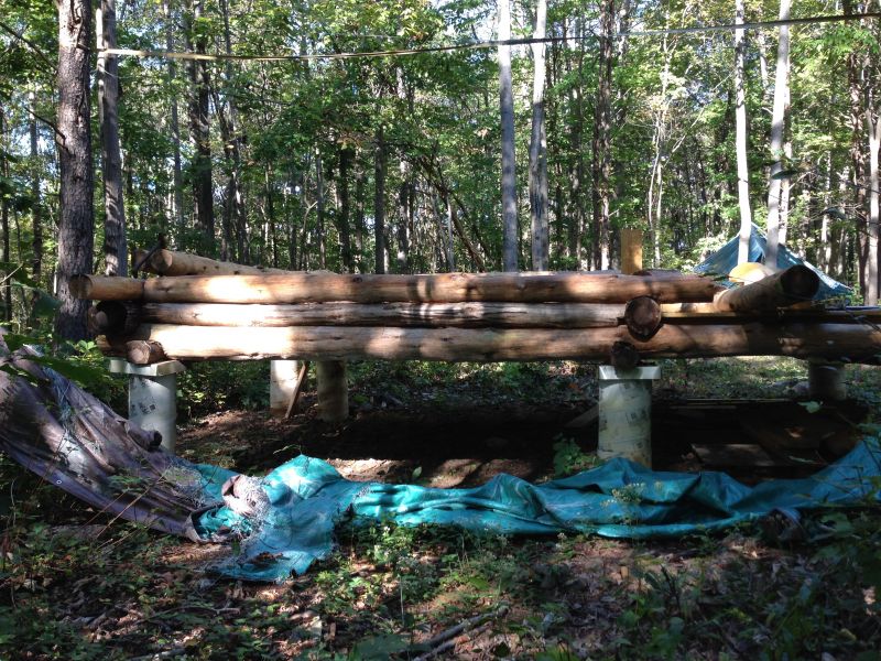

# Posted: 9 Oct 2016 11:23am - Edited by: WyattEarp
I really need to get a move on and get this thing dried in. The tarp I had up started falling apart so the logs have been exposed this summer and some of the logs have a mildew I need to address. I just bought a new tarp I'm going to hang up in the mean time.
Does anyone have any advice on what to clean my logs with? Would a standard deck cleaner do the trick?

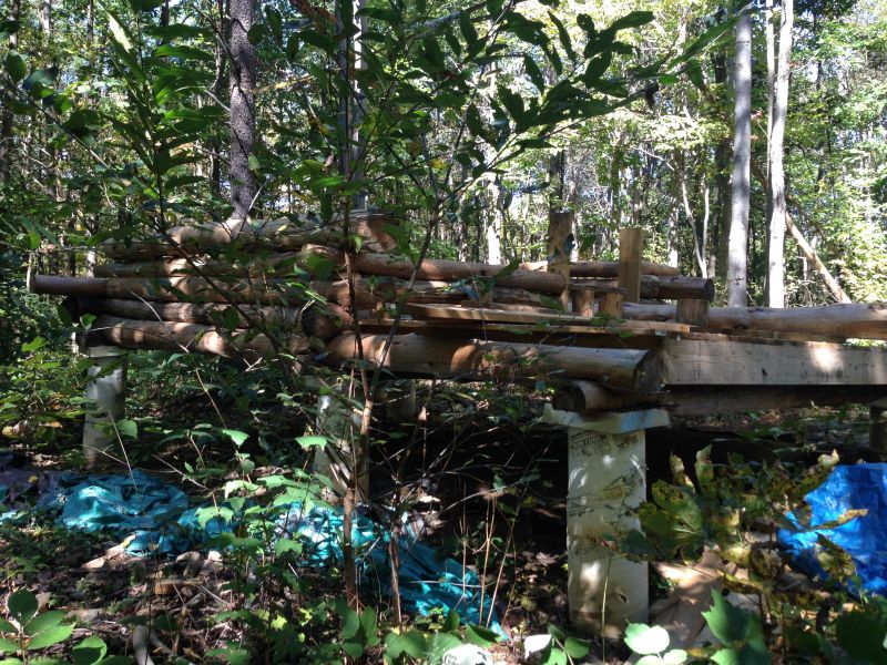

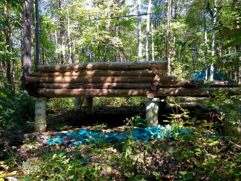

Here are a few more similar (but different) pics of the recent work. The forecast here is mainly sunny and windy for the next week so I'm going to order the solution to clean the logs and hang the tarp next weekend.

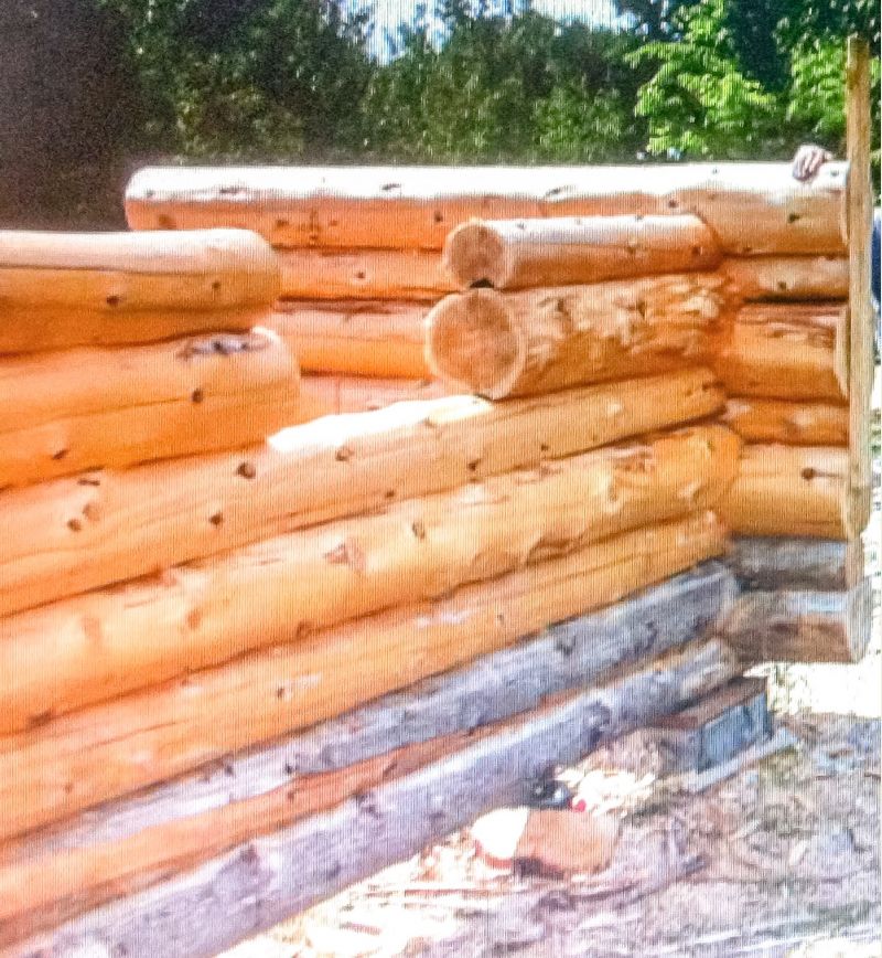

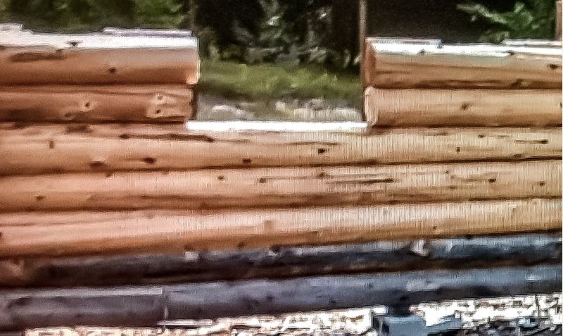

# Posted: 10 Oct 2016 09:28am

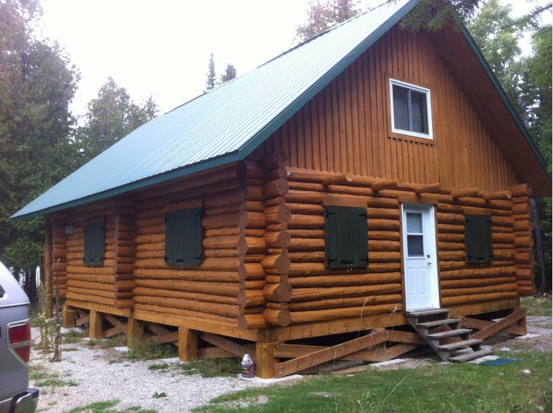

Here are some photos of the exterior of our cabin when it was being built. The bottom logs are the logs where we used Log ReNew after peeling the bark off years later on the interior.
When you call your distributor they will be able to recommend exactly what you need. They are log experts and have been very helpful to us. Thankfully we have all the log preservation under control and have the time to keep it up..that is a huge relief.

# Posted: 11 Oct 2016 03:43pm
Wow. What a difference!
I'll be addressing the issue sooner than later. I've been trying to figure out how to rinse the logwash off the logs once it's sprayed on with a pump sprayer. I'm far from a hose, so I kicked around some different ideas. I think I might invest in a towable pump sprayer so I can haul 20-30 gallons at a time and give it a thorough rinse!

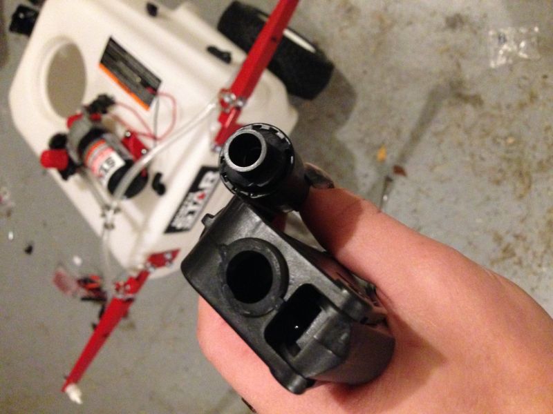

I received my 21 gallon towable sprayer from northern tool yesterday. I got a great deal on it...marked down from $249 to $229 and I used a $50 coupon code so the total was $180 plus shipping.
Unfortunately the last step of assembly was to hook up the wand sprayer and I discovered it wasn't supposed to be in 2 pieces. Hopefully they can ship me a new wand only and they don't want me to return the whole unit after a 1.5 hour assembly.

Just a samall update: northern tool has been amazing in their customer service. They offered off the bat to send a new wand out without ever questioning the situation or asking for pictures of the broken part. I've always liked them but true customer service is revealed when a problem arises. A+. Ok I'm done ;)
