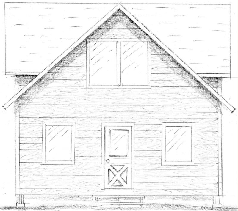

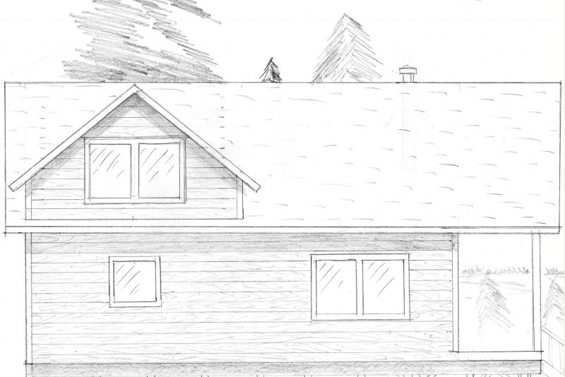

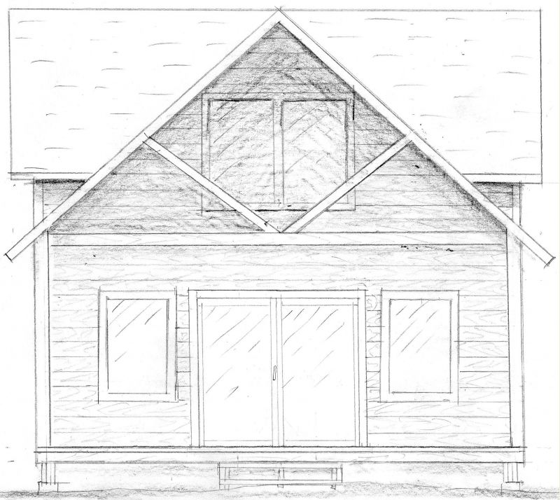

A 24' x 38'. It's maybe a bit large for this sight, but cool none the less.

# Posted: 11 Apr 2014 14:12
Love the design! How many sq feet with 2nd level?
# Posted: 11 Apr 2014 14:38 - Edited by: OwenChristensen
It's about thirteen hundred counting the porch, which is 6' wide across the front. The loft is in the four gables end and is 24 x 16'.

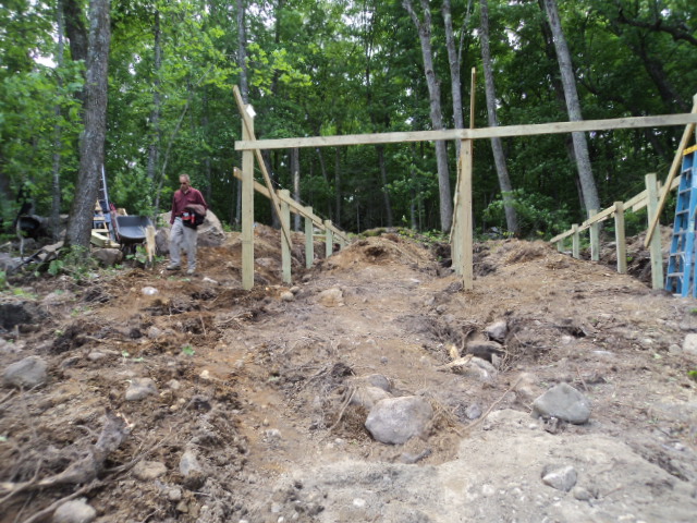

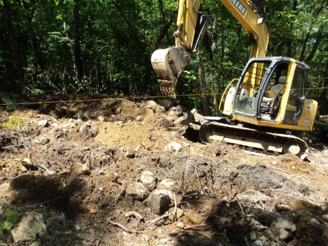

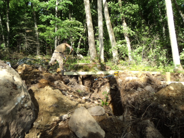

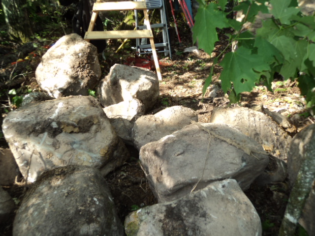

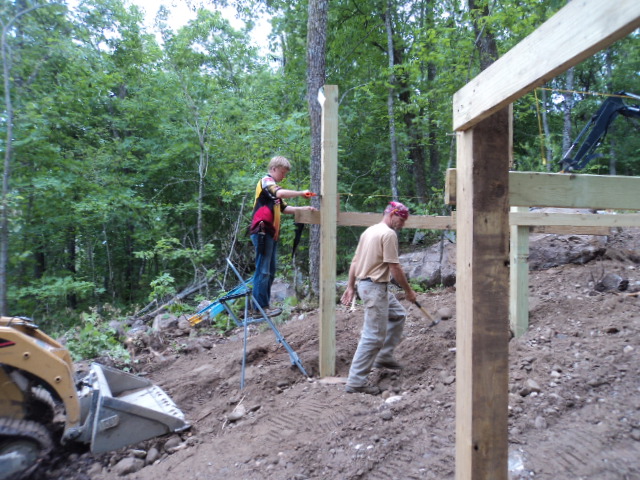

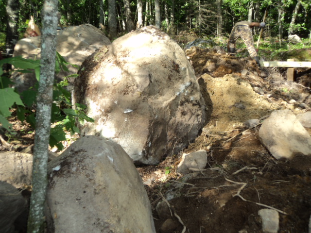

It's-- 6/23/2014-- Finally got a start on this cabin. The septic work and clearing got done this last week. I went up and set up a camp and stayed all week with my daughter, husband, oldest grandson. We had the excavator dig three trenches down to bedrock. It was three to four feet deep. Lot's of large nuggets that would have been to big for hand work. After the rock was exposed we set 21 - treated 6x6's and piled rocks back around them to hold, then we were able to get the excavator to back fill. Temporary bracing and stringlines kept as well as our watchful eyes kept it all straight.![ugly start ugly start](https://www.small-cabin.com/forum/shared_files/uploaded/4482/68793_1.jpg) ugly start

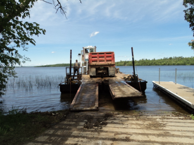

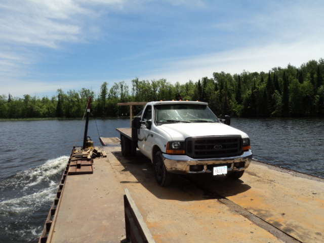

It has been quite worry some as we had to get al the heavy materials over on the barge that only was there to haul equipment and gravel for the septic. Trying to fit our lumber deliveries into that schedule was a great concern. Our great customer gave us a pontoon boat to use, but I didn't want to spend all summer hauling wood. Anyway it all worked and now we have to site to ourselves. By tomorrow we should have the floor built.![took my tools over took my tools over](https://www.small-cabin.com/forum/shared_files/uploaded/4482/68794_1.jpg) took my tools over

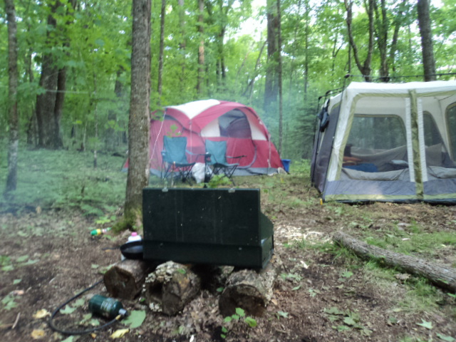

Been tough. No tv, no power, except generator only fishing for entertainment, then living in tents. My grandson never talked about his video games, only how great a fisherman he is.![bass and walleye bass and walleye](https://www.small-cabin.com/forum/shared_files/uploaded/4482/68795_1.jpg) bass and walleye

# Posted: 23 Jun 2014 19:08
Wow what a rocky start...
