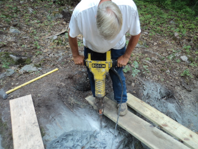

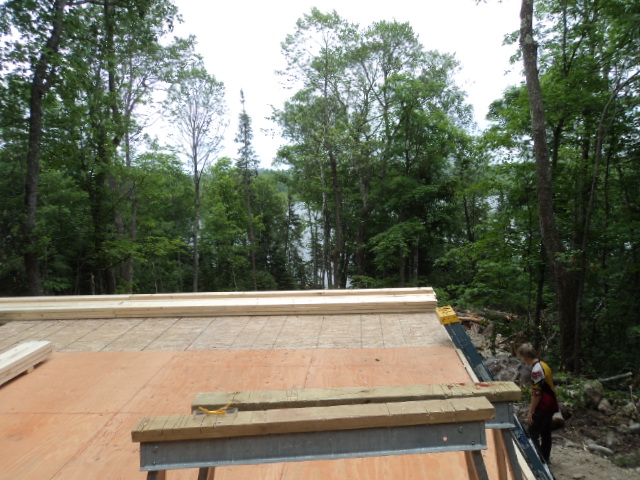

I sure found hard rock, igneous, they tell me. We spent four days chipping less than a wheelbarrow full of rock that was in our way. We never got a chip as big as a fist at any one time. I went and got a 90# jackhammer for a day and it still barely got the job done, but it did get it done after mushrooming two bits. Anyway I'm happy now, we can start the walls soon. Ate fish again for lunch.

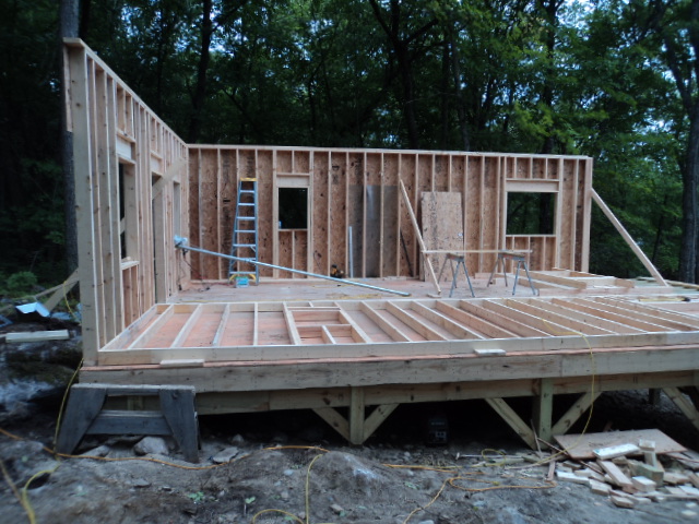

# Posted: 3 Jul 2014 23:34 - Edited by: OwenChristensen

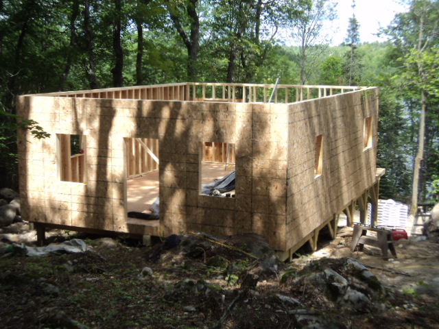

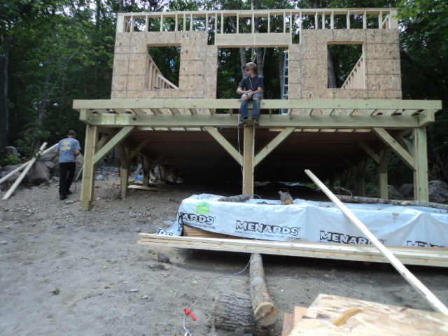

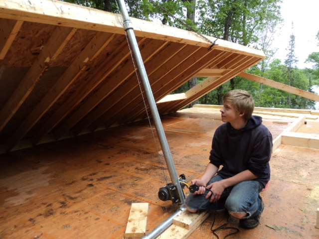

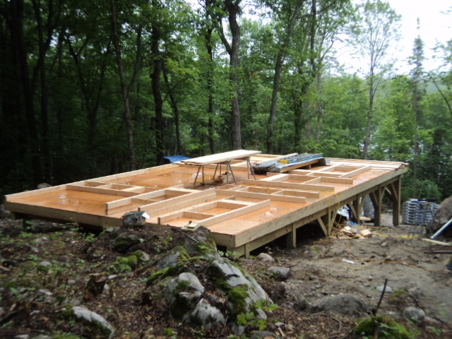

Three more days. I made a electric winch and pipe pole to raise 32' x 10' sheeted walls. we finished the floor and braced the posts.
Owen![the floor complete the floor complete](https://www.small-cabin.com/forum/shared_files/uploaded/4482/69155_1.jpg) the floor complete
| ![a thirteen year old wall raiser a thirteen year old wall raiser](https://www.small-cabin.com/forum/shared_files/uploaded/4482/69155_2.jpg) a thirteen year old wall raiser
| ![two up two up](https://www.small-cabin.com/forum/shared_files/uploaded/4482/69155_3.jpg) two up
| ![all four all four](https://www.small-cabin.com/forum/shared_files/uploaded/4482/69155_4.jpg) all four

how far did you go get through the rock?
# Posted: 6 Jul 2014 17:20
The bed rock was three to four feet deep. I guess I was lucky. digging deeper, I'd be wondering how far, and less there wouldn't be enough to stabilize the posts. As it was, we stacked rocks around each post, then back filled with a dirt and rock mix. They seem locked in place quite well. Here's the bracing.

# Posted: 7 Jul 2014 19:22
looks good. did the 6x6 sit right in the holes or did you build a cement base. I will upload pictures on my progress over the fourth. See what you think, as I ran into a lot of large river/field stone. I didnt think to hammer it out though...
# Posted: 7 Jul 2014 21:15
All my posts got on clean bedrock. The rock I had the most trouble was on the end, between my beams and as high as the lower part of the floor joists. You see we had a clear line between the three end posts. I guess we over focused on getting them in, forgetting that the beams cantilevered over a foot. On the post foot, we didn't use any cement. It might be a good idea, but hard to do on and island. I think some of the loose rock on top might be stable enough to set a post on, since they're is setting on bed. All the rocks in the way of the footing trench were small enough to be moved with the excavator, but not the big one on the end that we drilled and jackhammered. So all in all, quite lucky.
Shadyacres
# Posted: 7 Jul 2014 21:39
Owen , It looks like you have 2 X 6s screwed to your 6 x 6 posts ? What was the purpose of those if I may ask ? I will be building a small deck at my cabin hopefully this fall.
# Posted: 8 Jul 2014 08:30
The extra cladding adds a little beef to them and lags the posts to the beams better than a short scab. Often posts work fine , but look light duty, they may not be necessary.

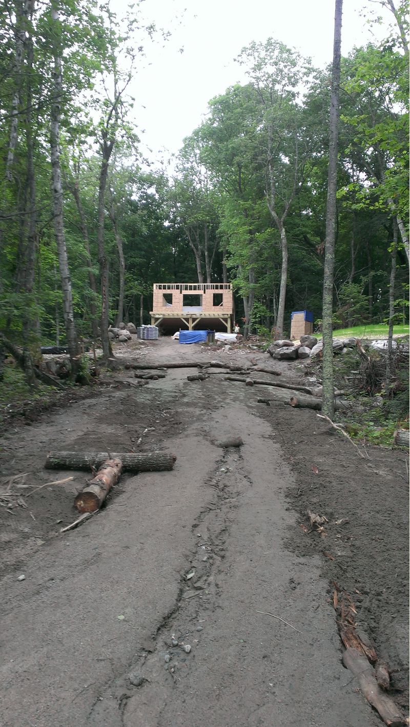

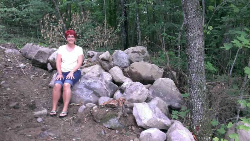

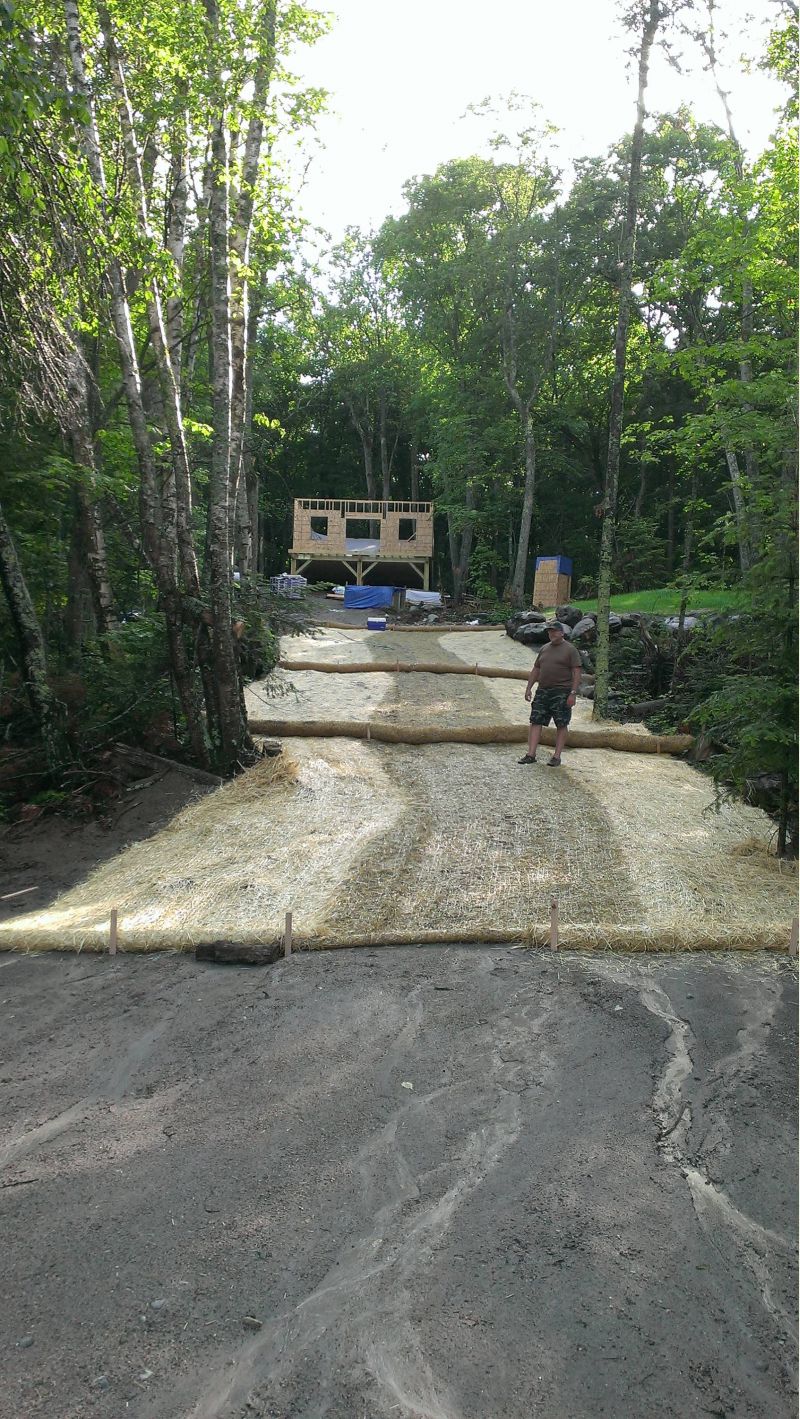

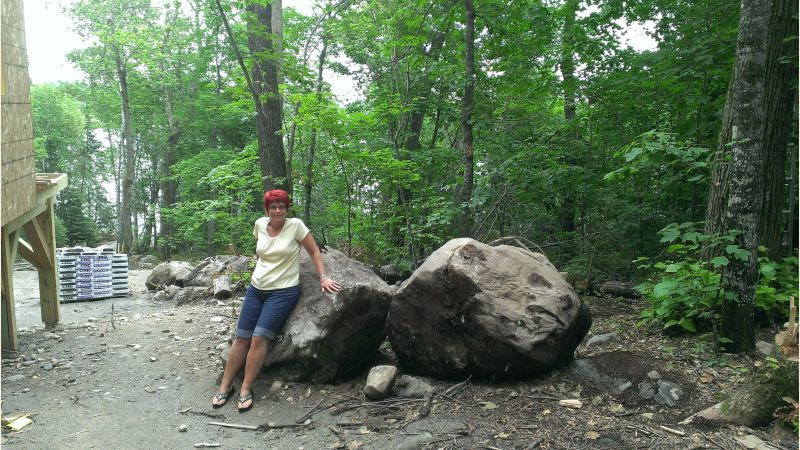

I'm not sure if Owen's pictures did justice to the rocks he had to move to get going on my cabin. Attached are a few pictures with my wife in them for reference. Added a little seed, fertilizer and erosion control to the road in this weekend. I'm hoping to get a little grass going and with all the rain, I think it will happen.
Place is coming along, Owen and his team are doing great.![Wife_in_the_rocks.jp.jpg Wife_in_the_rocks.jp.jpg](https://www.small-cabin.com/forum/shared_files/uploaded/4482/69405_1.jpg) Wife_in_the_rocks.jp.jpg
| ![Wife_in_the_big_rock.jpg Wife_in_the_big_rock.jpg](https://www.small-cabin.com/forum/shared_files/uploaded/4482/69405_2.jpg) Wife_in_the_big_rock.jpg
| ![road_starting_to_was.jpg road_starting_to_was.jpg](https://www.small-cabin.com/forum/shared_files/uploaded/4482/69405_3.jpg) road_starting_to_was.jpg
| ![road_up_with_erosion.jpg road_up_with_erosion.jpg](https://www.small-cabin.com/forum/shared_files/uploaded/4482/69405_4.jpg) road_up_with_erosion.jpg

It looks like a great job on erosion control.

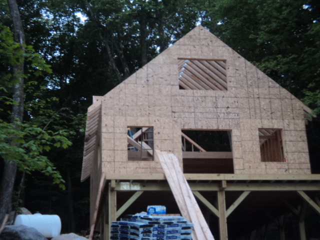

# Posted: 22 Jul 2014 06:54 - Edited by: OwenChristensen

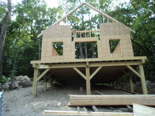

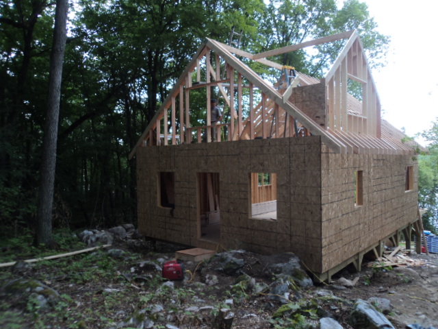

Had a tough week this last week. A sinking pontoon and a lot of heavy materials to be hauled across the lake and up the hill. We got that done , but little else. As of today the loft floor is in and we're working on the stairs this morning. The rafters are all cut , but only the one gable is up. It was 90 deg. and high humidity. I bought a 20' x 20'' aluminum plank yesterday for siding etc. That should be a big help. Now I need a shingle elevator.![Hualing 24'12'' planks Hualing 24'12'' planks](https://www.small-cabin.com/forum/shared_files/uploaded/4482/69741_1.jpg) Hualing 24'12'' planks
| ![many trips many trips](https://www.small-cabin.com/forum/shared_files/uploaded/4482/69741_2.jpg) many trips
| ![first gable first gable](https://www.small-cabin.com/forum/shared_files/uploaded/4482/69741_3.jpg) first gable

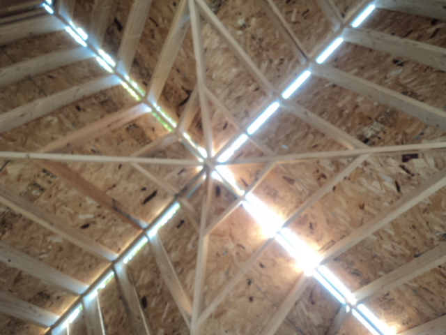

# Posted: 25 Jul 2014 09:22

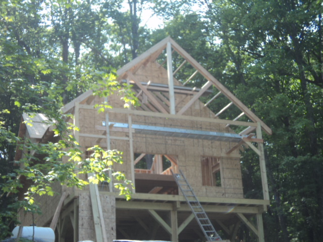

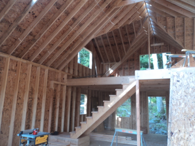

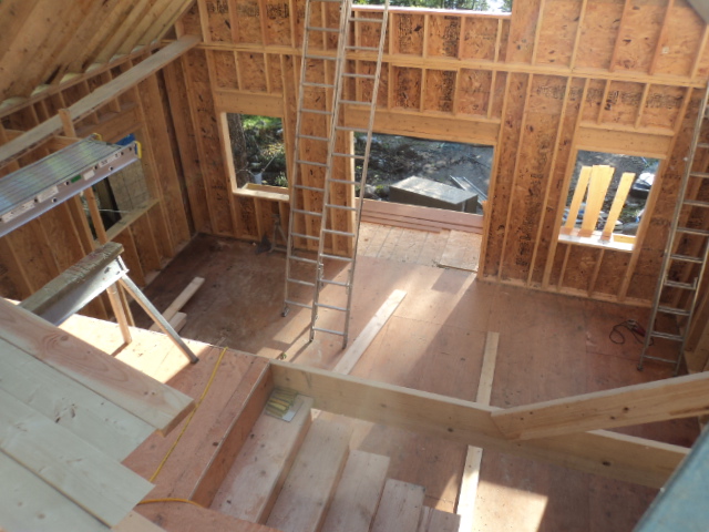

Good week. Build loft, raised rafters, made stairs, made most of bath house, started dormers, and caught fish.![rafters rafters](https://www.small-cabin.com/forum/shared_files/uploaded/4482/69890_1.jpg) rafters
| ![inside inside](https://www.small-cabin.com/forum/shared_files/uploaded/4482/69890_2.jpg) inside
| ![looking down looking down](https://www.small-cabin.com/forum/shared_files/uploaded/4482/69890_3.jpg) looking down

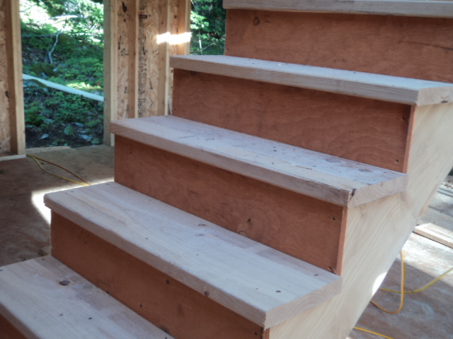

# Posted: 25 Jul 2014 09:34

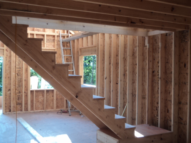

Here's some more. We still have to build the roof over the porch. It will have a large heavy truss for looks and strength. Having enough scaffolding has been a problem. I bought a new aluminum 20' plank on the way to the site, along with my old planks, we're still short. Ps. I got bersiteus bad in my elbow from beating on those rocks with a sledge hammer a few weeks ago.![front front](https://www.small-cabin.com/forum/shared_files/uploaded/4482/69891_1.jpg) front

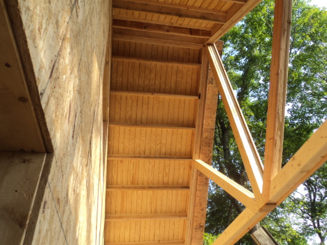

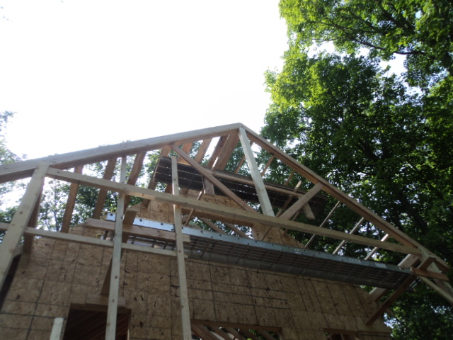

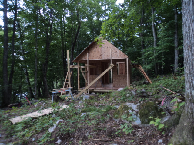

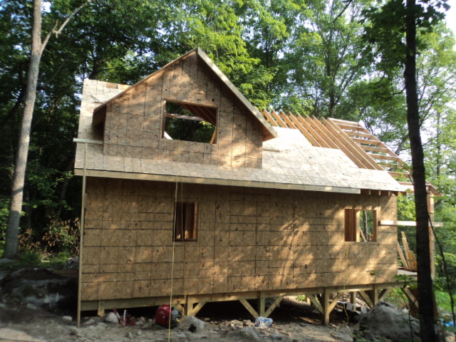

Thanks, big week. Two cabins at once. Working twenty eight feet off the ground in front was hard.![porch roof framing porch roof framing](https://www.small-cabin.com/forum/shared_files/uploaded/4482/70273_1.jpg) porch roof framing
| ![bunkhouse bunkhouse](https://www.small-cabin.com/forum/shared_files/uploaded/4482/70273_2.jpg) bunkhouse
| ![high up high up](https://www.small-cabin.com/forum/shared_files/uploaded/4482/70273_3.jpg) high up
| ![dormers and roof sheating dormers and roof sheating](https://www.small-cabin.com/forum/shared_files/uploaded/4482/70273_4.jpg) dormers and roof sheating

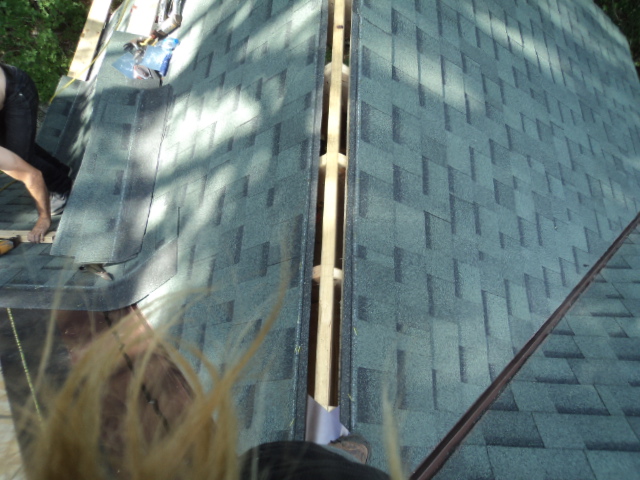

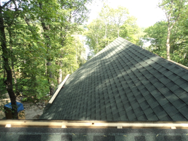

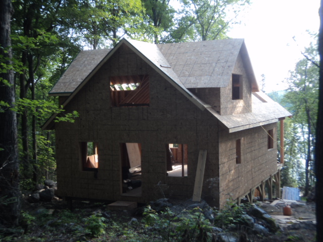

Just a couple weeks to go! Half the roof got shingled yesterday. This week the other half and windows go in. After that siding, stairs and railings.![ridges come together ridges come together](https://www.small-cabin.com/forum/shared_files/uploaded/4482/70547_1.jpg) ridges come together
| ![shingles shingles](https://www.small-cabin.com/forum/shared_files/uploaded/4482/70547_2.jpg) shingles
| ![north half of roof north half of roof](https://www.small-cabin.com/forum/shared_files/uploaded/4482/70547_3.jpg) north half of roof
| ![ready to shingle ready to shingle](https://www.small-cabin.com/forum/shared_files/uploaded/4482/70547_4.jpg) ready to shingle

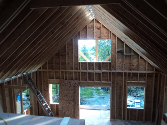

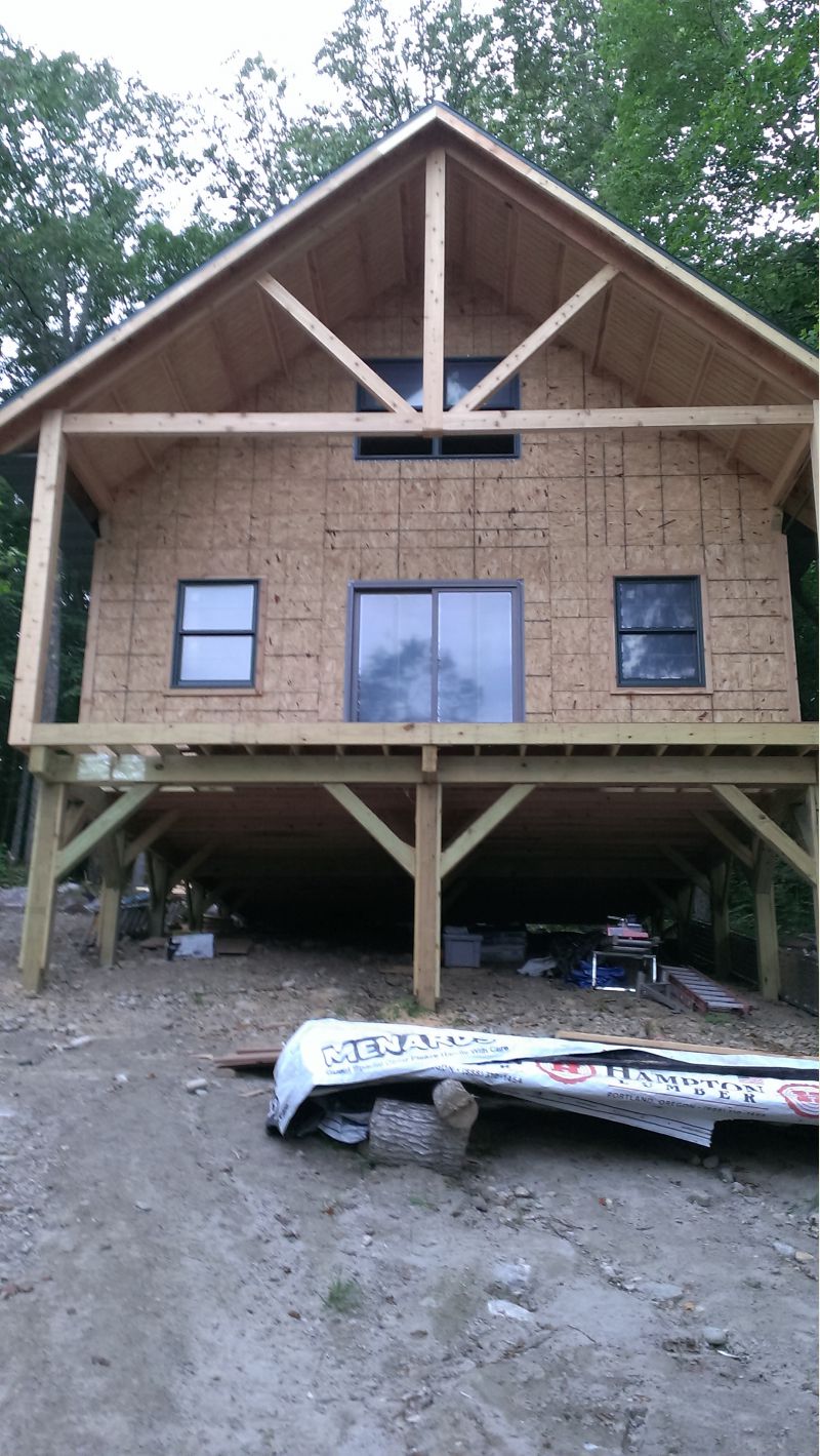

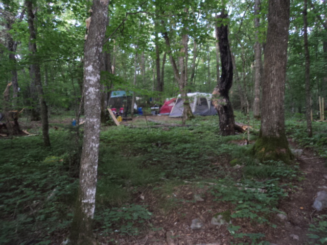

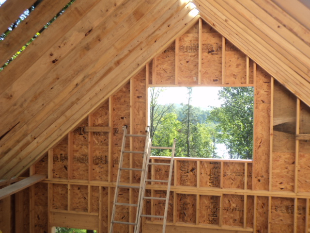

The large truss to hold the porch roof was a challenge. We put a lrge water tank in the attic of the bath house too.![porch roof porch roof](https://www.small-cabin.com/forum/shared_files/uploaded/4482/70548_1.jpg) porch roof
| ![inside inside](https://www.small-cabin.com/forum/shared_files/uploaded/4482/70548_2.jpg) inside
| ![from loft foreward from loft foreward](https://www.small-cabin.com/forum/shared_files/uploaded/4482/70548_3.jpg) from loft foreward
| ![still in tents though still in tents though](https://www.small-cabin.com/forum/shared_files/uploaded/4482/70548_4.jpg) still in tents though
Don_P
# Posted: 9 Aug 2014 10:05
It's a nice looking design. A visit by an engineer would be a good idea before closing things up.
# Posted: 9 Aug 2014 10:43
Don, you're sharp, If you're hinting about the lack of collar tie in the main span, that's coming, another decorative, but structural beam is required in the middle of the 16' open ceiling.

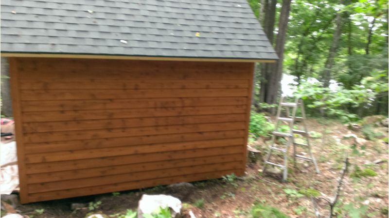

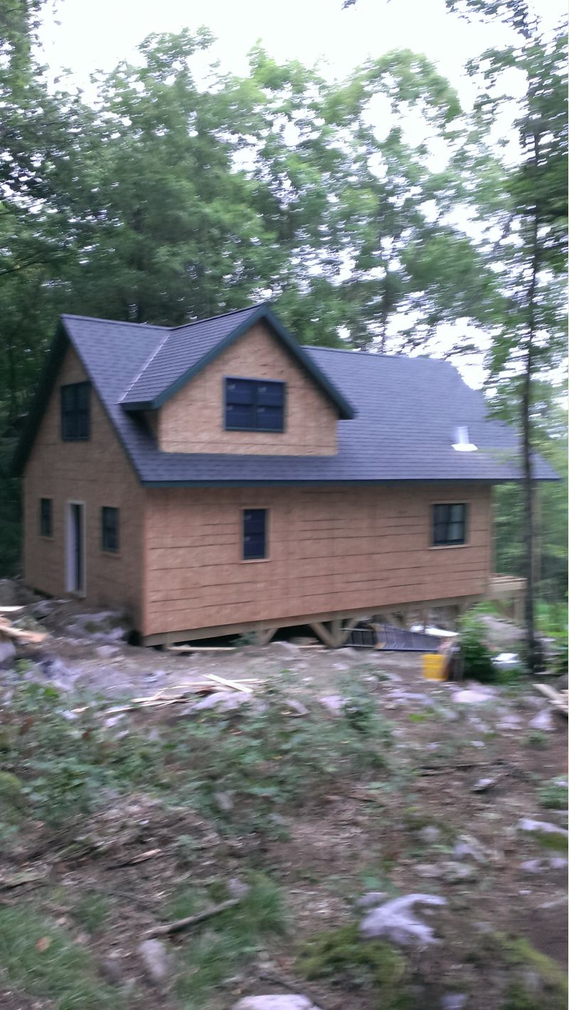

# Posted: 24 Aug 2014 18:18

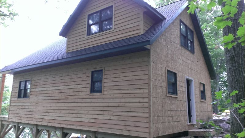

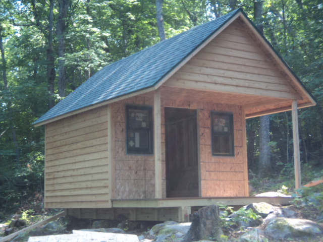

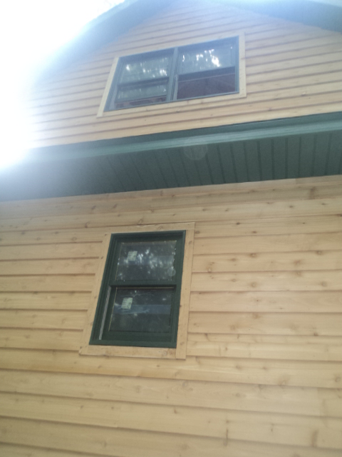

Owen's crew did a great job this week and got a lot done. I managed to get one side of the bunkhouse stained and some doors and doorframes painted before the weather cut my work time short. It is really starting to look like something.![Cabin Front Cabin Front](https://www.small-cabin.com/forum/shared_files/uploaded/4482/71119_1.jpg) Cabin Front
| ![Cabin Side Cabin Side](https://www.small-cabin.com/forum/shared_files/uploaded/4482/71119_2.jpg) Cabin Side
| ![Cabin With Siding Cabin With Siding](https://www.small-cabin.com/forum/shared_files/uploaded/4482/71119_3.jpg) Cabin With Siding
| ![Bunkhouse With Stain Bunkhouse With Stain](https://www.small-cabin.com/forum/shared_files/uploaded/4482/71119_4.jpg) Bunkhouse With Stain
# Posted: 24 Aug 2014 19:01
Thanks, better pictures than I got. Good choice on siding. My wife wants that now and will be asking about stain, because we know best.
Owen
Shadyacres
# Posted: 24 Aug 2014 19:16
Owen , what stain did you use and is that white pine or hemlock or other ? Shady Acres
# Posted: 24 Aug 2014 19:33
beautiful smallie. best fightin' fish pound for pound in fresh water. that must have been a hoot.
i was at lowes and they grieved me about osb sheathing. but that's all you've used. what size and type? can I ask?
# Posted: 25 Aug 2014 08:02
Gary, the owner is doing the stain. I'm sure he will let us know. I think he likes Sherwin-Williams.
I'll be taking a couple weeks away from this job to close in two other ones close to home.
Creeky, all osb is 1/2 '' . I only use it where it will stay dry, and the floor is 3/4'' t&g coated plywood. The siding is all western red cedar.
