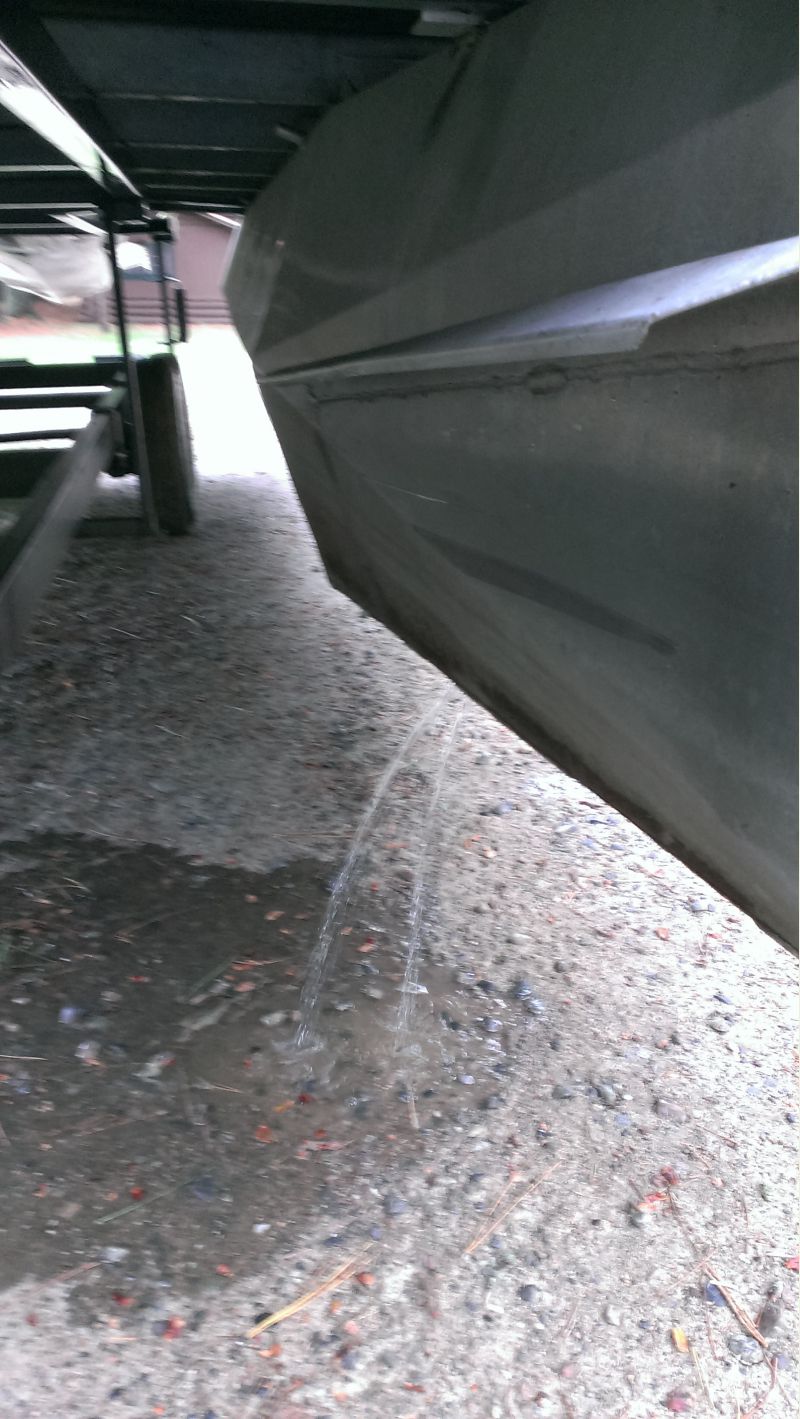

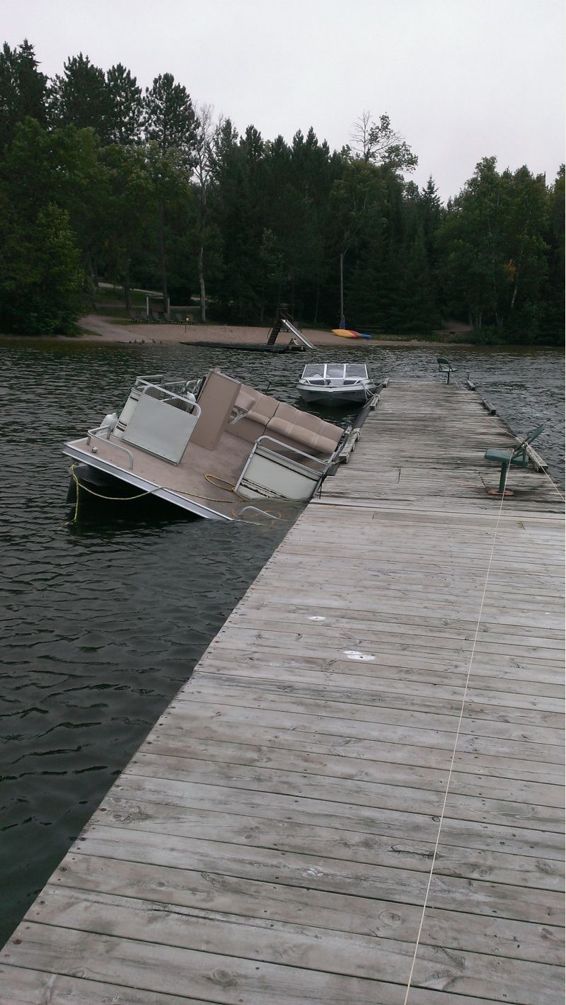

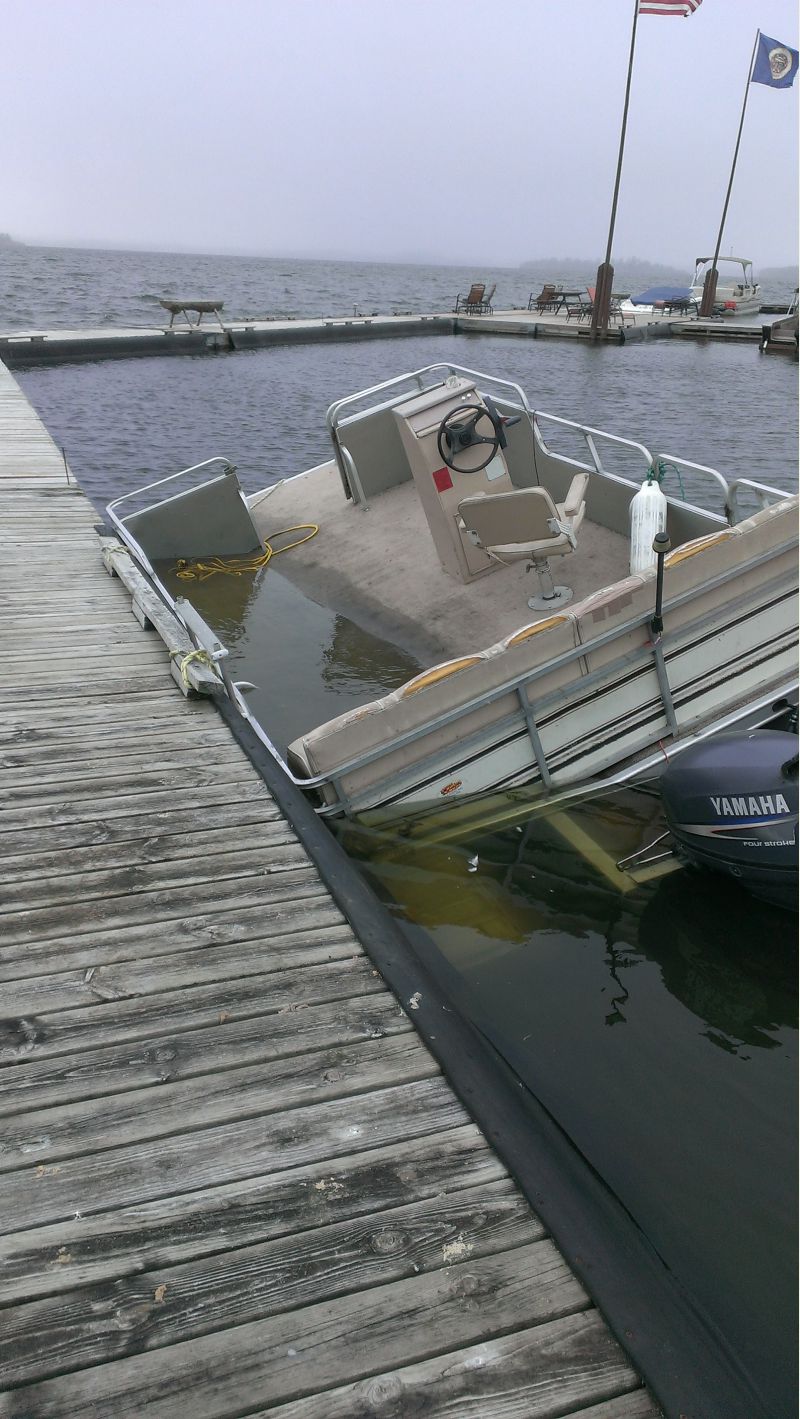

Had a bit of a setback this week. Owen's crew continue to get things done. I just need to work on their transportation system a little bit.![IMAG0116.jpg IMAG0116.jpg](https://www.small-cabin.com/forum/shared_files/uploaded/4482/71816_1.jpg) IMAG0116.jpg

On the brighter side, when we were winching the boat up to pump it out, I did see a nice perch swimming around on the deck of the boat.
# Posted: 11 Sep 2014 07:46
You're lucky you didn't get a DNR ticket for not draining your bilge.

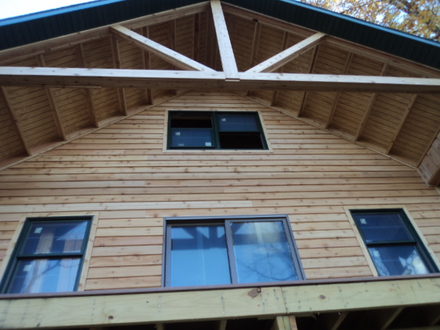

# Posted: 16 Oct 2014 18:18 - Edited by: OwenChristensen

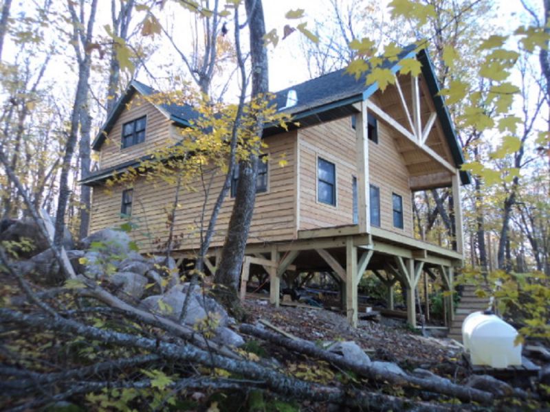

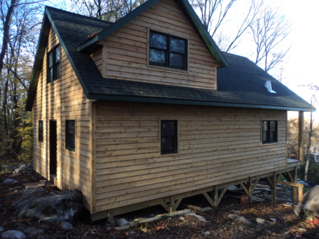

Well we're closing in, just a few things left for the season. Here's what it looks like now.![Oct 16th, '14 Oct 16th, '14](https://www.small-cabin.com/forum/shared_files/uploaded/4482/73453_1.jpg) Oct 16th, '14
| ![south west side south west side](https://www.small-cabin.com/forum/shared_files/uploaded/4482/73453_2.jpg) south west side
| ![porch roof porch roof](https://www.small-cabin.com/forum/shared_files/uploaded/4482/73453_3.jpg) porch roof
| ![guest house guest house](https://www.small-cabin.com/forum/shared_files/uploaded/4482/73453_4.jpg) guest house
hct4all
# Posted: 16 Oct 2014 19:57
WOW!...Just wow! Very nice
# Posted: 19 Oct 2014 18:38
Thanks! It's been quite a challenge out on the island, rocks everywhere, 120 miles from home, sinking boats, falling trees, and the climb, oh yes, the climb. thanks for good help and a great, understanding customer, (gsreimers).
