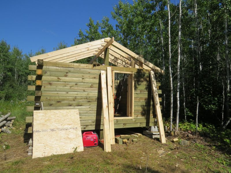

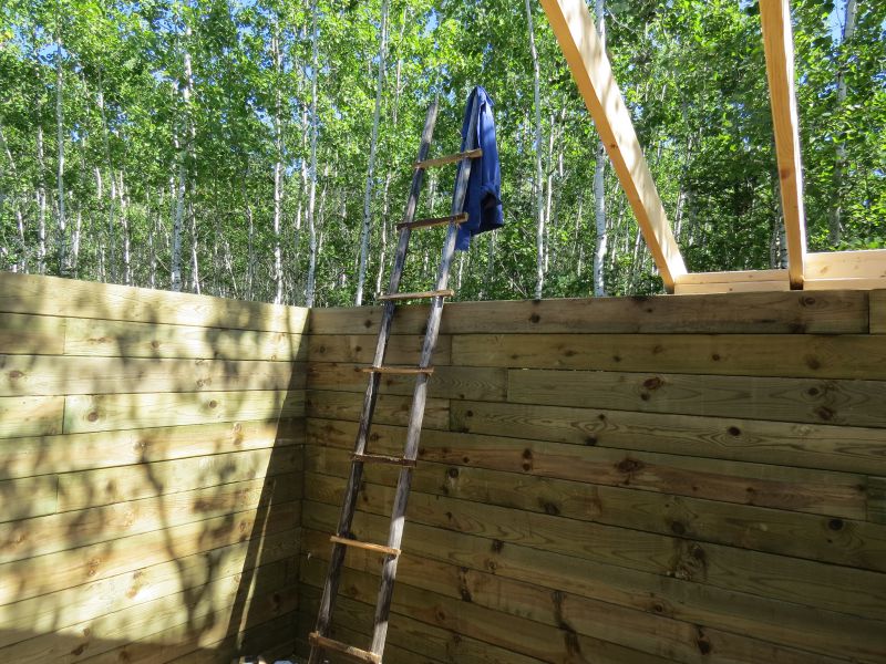

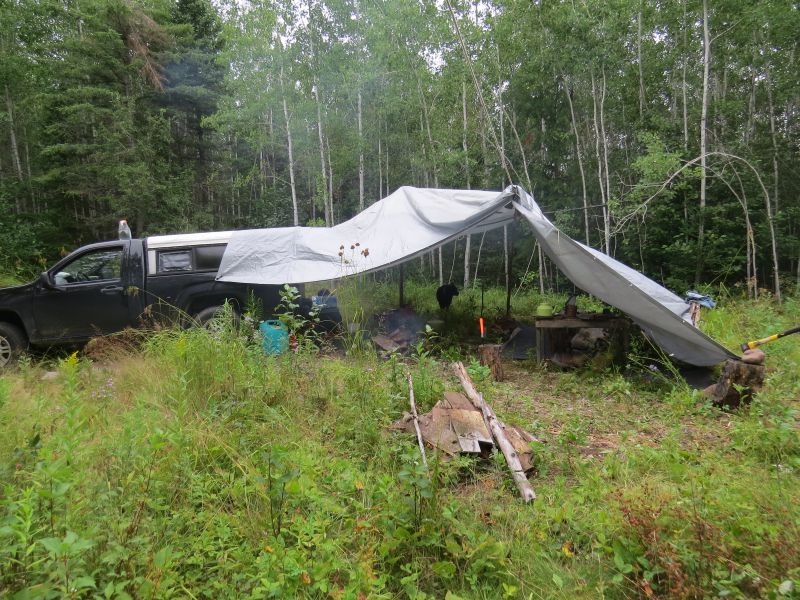

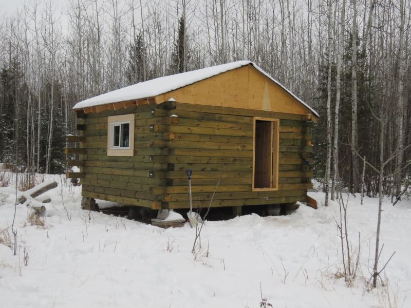

I finally got some land in sept 2013. The plan was a log cabin, but being all alone on this build, and completely off grid, I soon had to change plans quickly.
I made lots of mistakes and there's lots I do differently. But considering I have no building experience, I'm pretty happy. It's not finished yet, and I plan on touching up a couple things.
bc thunder
# Posted: 6 Jan 2015 06:59pm

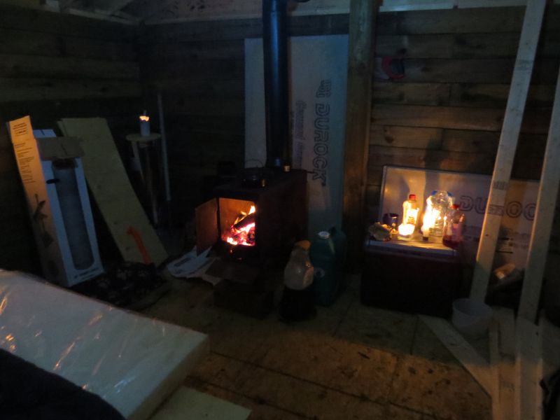

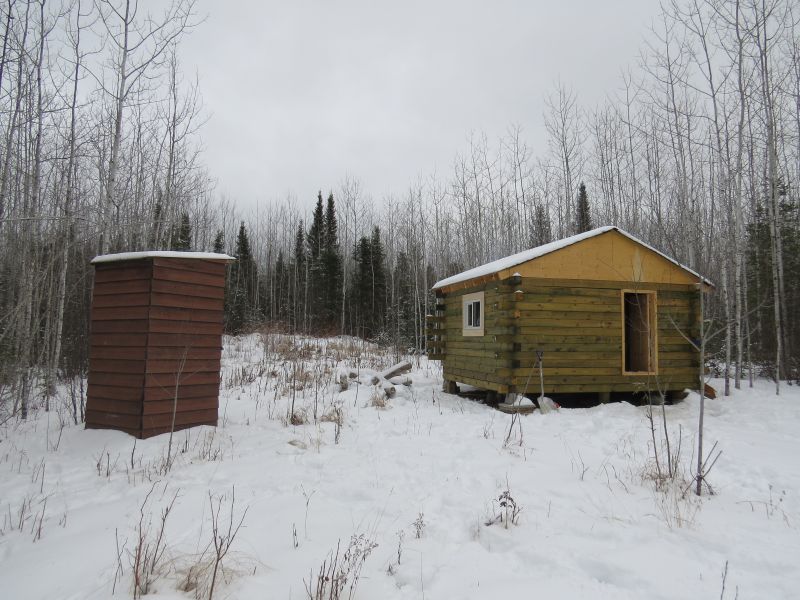

Spent a week there last month, till it hit -30. Not insulated yet, made for some cold gettings up.
bc thunder
# Posted: 6 Jan 2015 07:08pm
My only two helpers, and they don't have any thumbs.

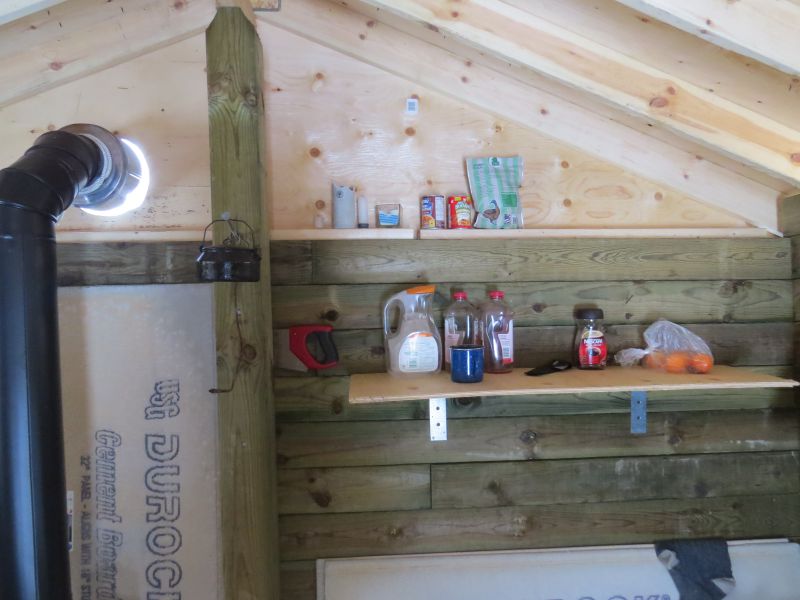

Maken coffee with the new stove.

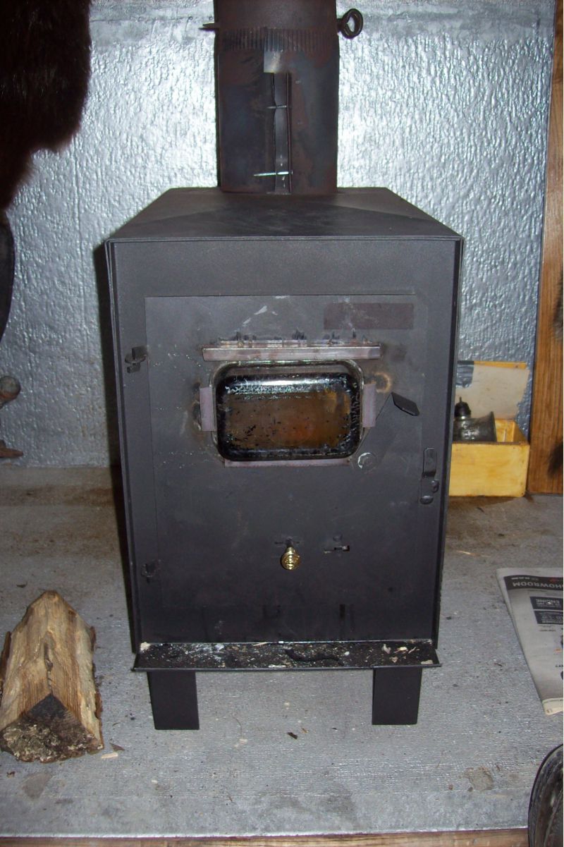

Thanks guys, I put an old stove in that I found on the property, and just hooked up on a temporary basis.
Just: the cabin's in Ont.
# Posted: 6 Jan 2015 11:20pm
bc i think we have the same stove , except i put in a glass

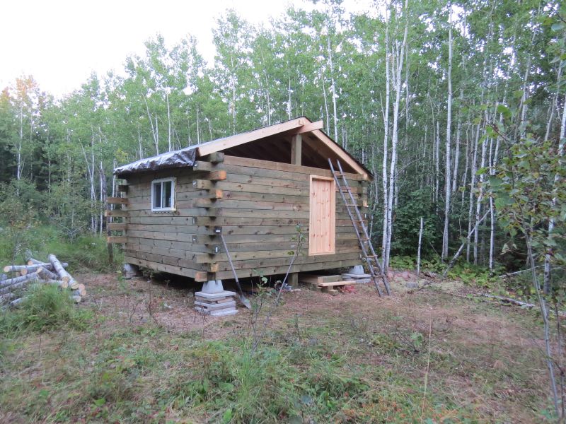

bc thunder, that is amazing! I wish I would of seen your posts earlier.
I have a few questions:
- What does your floor look like (3/4 plywood over 2x6 framing @ 16")?
- How high are the walls?
- Are those 4x4 or 6x6? They look like they are treated as well, right? Does the smell of treated wood go away eventually? Would you use treated wood again?
- Did you use any fasteners between rows of lumber? Long wood screws, rebar, etc? At what interval (corners only, at the both ends of a piece of lumber, every X ft) did you use the fasteners?
- How much snow do you get in your neck of the woods (qc, canada here, we get a lot)?
- Are you planning on insulating it somehow?
- Did you use asphalt shingles on the roof?
If you don't mind me asking, how much did you have to spend to get the cabin (not including outhouse, etc; Floor, foundation, walls, roof) up?
Cabin looks amazing!

6x6s
6' walls 8' center
I dont notice any smell, and pt wood is much safer now.
I only used pt bc it was readily available, non pt would be a lot cheaper.
I used 12" galvanized spikes at all ends and 4 or 5 spikes on the top of every beam.
Same snow as you I think (northern Ont)
Only insulating floor and ceiling, being 12x12 I think the wood stove will do the rest. (I hope)
I wanted metal roof but got a deal on discontinued asphalt.
I've got about four grand in it so far total, with some more to go.
This is my (for now cabin) as I'm not there to keep an eye on it. I hope to do a much better job next time now I have learned a bit more.

bc thunder: Ah, that's a shame for your long response. I was bitten by that too many times on various forums. Before submitting a long post, I always click once in the text area, do CTRL-A (select all the text I just typed), then CTRL-C (copy all the selected text). That way, if something goes sour, I can just do CTRL-V and get the text I typed back.
Only question that was left unanswered was about floor. I can't quite wrap my head around that part was done.
Is there a reason why you didn't continue the gable ends with 6x6's? I guess it would of taken a bit longer. The ridge beam is supported at both ends and that's it, right?
Really wish you had more pics!! Great job

Fish, The floor should have been done as you spoke of earlier, (2x6s off 16 center), but I had some 4x4s already, and decided to use them instead. Then I added some extra bracing underneath to keep them from warping. Samething with the overhangs and higher walls for a loft; I wanted both, but cost, time, and being alone kept me from doing it precisely as I would have liked. This summer I'll add a covered deck to the front. As for the ridge beam, ya two eight foot beams, spiked inside to both walls. Probably overkill for this little cabin, but as I'm doing a lot of things "my way" as opposed to the "right way", I want to over build for piece of mind. I will go back in places and add more support, better support, with things like L brackets and better fitting braces for the tops of my rafters. It might be unorthodox in places, but will be very sturdy and safe.
Have you already started a build, or are you in the planning stages?

bc, I was thinking about your cabin and I had a couple of questions if you don't mind!
The cabin has been up for 2 years now or so(?). With time, did you get any warping of the 6x6's?
If so, did you have to caulk or fill in the gaps in anyways (with what)? In picture IMG_0292.JPG above, you can sort of see a crack above/left of the door.
You mentioned somewhere that you were at your cabin in -30C weather: How was it? Did it take a long time to warm the cabin up? Did you have any issue with condensation inside the cabin?
Cheers!

Hey Fish, The cabins been up closer to a year now, no sings of warping. I will run some calking between to fill any gaps, but it fits together pretty tight. Only really one bad spot, and that was my last 6x6. The pickens got real slim at the end from the HD selection. -30 was real cold cause I didn't have the facia and soffit on it yet. I could've passed ya a cup of coffee outside thru the wall. The stove did the trick till about -20. It will be finished this summer.
