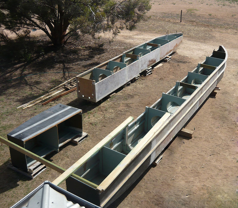

Hello again everyone I thought I would post pictures of our progress building a little tiny home destined for the river.
victorvector
# Posted: 15 Jan 2015 12:39

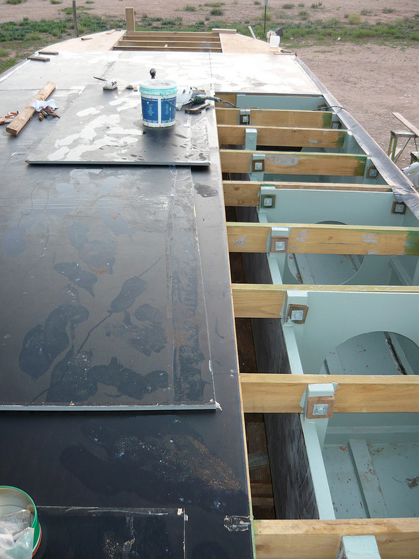

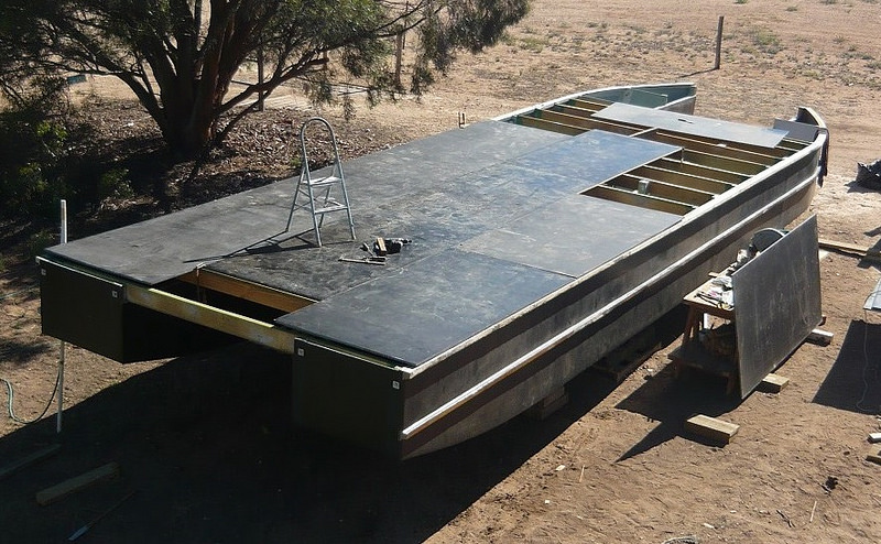

Second try.![Assembling the hull sections. Assembling the hull sections.](https://www.small-cabin.com/forum/shared_files/uploaded/5237/76903_1.jpg) Assembling the hull sections.
| ![Assembling the hull sections. Assembling the hull sections.](https://www.small-cabin.com/forum/shared_files/uploaded/5237/76903_2.jpg) Assembling the hull sections.

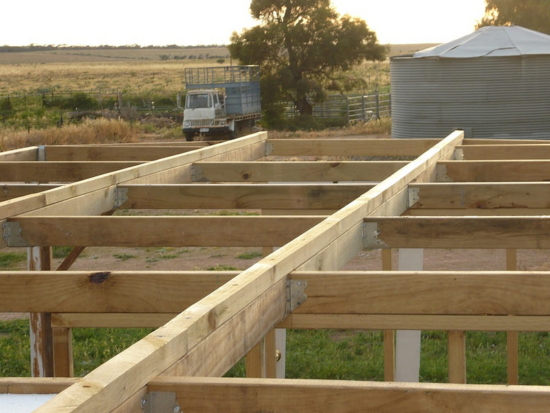

| ![Platform floor being assembled Platform floor being assembled](https://www.small-cabin.com/forum/shared_files/uploaded/5237/76903_3.jpg) Platform floor being assembled
| ![Floor framing bolted up Floor framing bolted up](https://www.small-cabin.com/forum/shared_files/uploaded/5237/76903_4.jpg) Floor framing bolted up

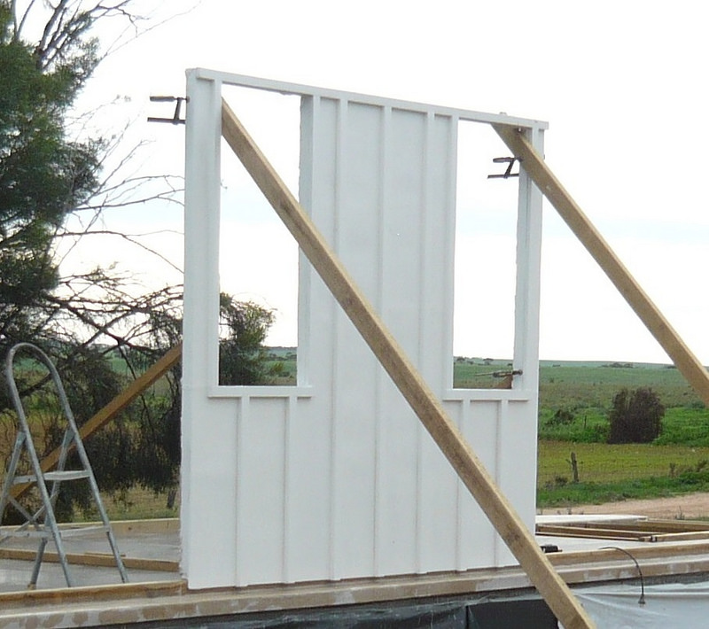

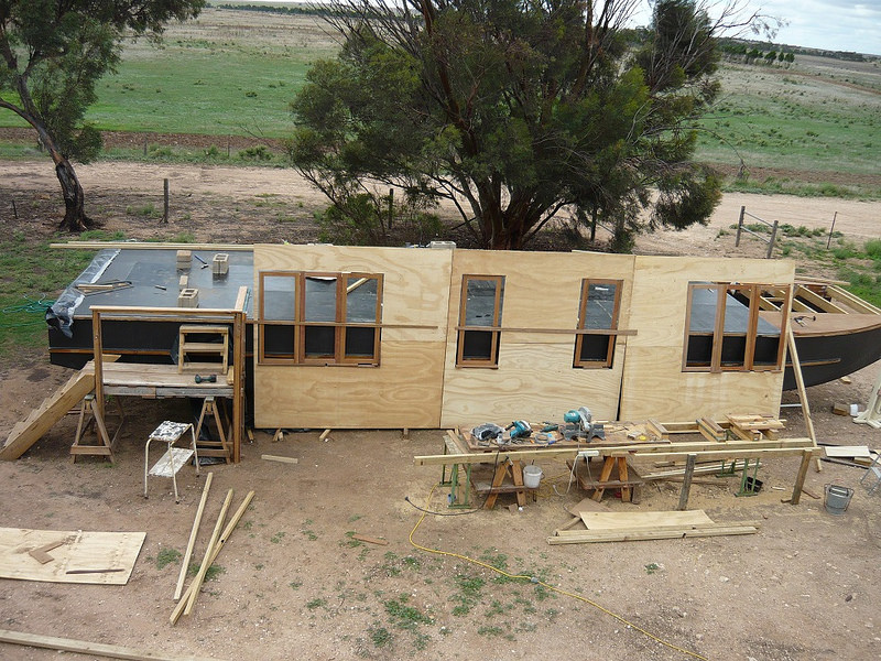

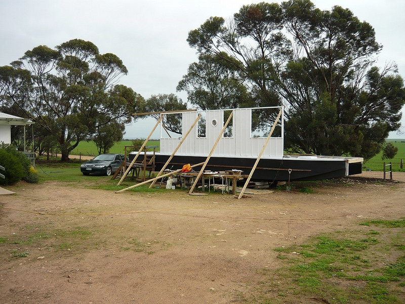

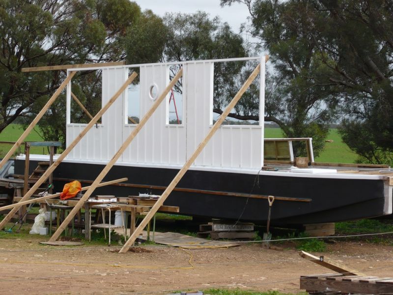

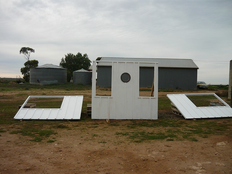

Building the walls.![All wall panels were 8ft long. All wall panels were 8ft long.](https://www.small-cabin.com/forum/shared_files/uploaded/5237/76905_1.jpg) All wall panels were 8ft long.
| ![Walls. Walls.](https://www.small-cabin.com/forum/shared_files/uploaded/5237/76905_2.jpg) Walls.
| ![Water proof plywood was covered with canvas set in Titebond III water proof adhesive. Water proof plywood was covered with canvas set in Titebond III water proof adhesive.](https://www.small-cabin.com/forum/shared_files/uploaded/5237/76905_3.jpg) Water proof plywood was covered with canvas set in Titebond III water proof adhesive.
| ![Standing up the first wall panel. Standing up the first wall panel.](https://www.small-cabin.com/forum/shared_files/uploaded/5237/76905_4.jpg) Standing up the first wall panel.

I`m in South Australia. It is said to be the driest state on the driest continent on the planet.
The platform is around 480 square feet.
The length of the hulls is 40 ft. The width of each one is about three feet , and the overall width when assembled is 12 feet.
Semi trailer and low loader is the plan.

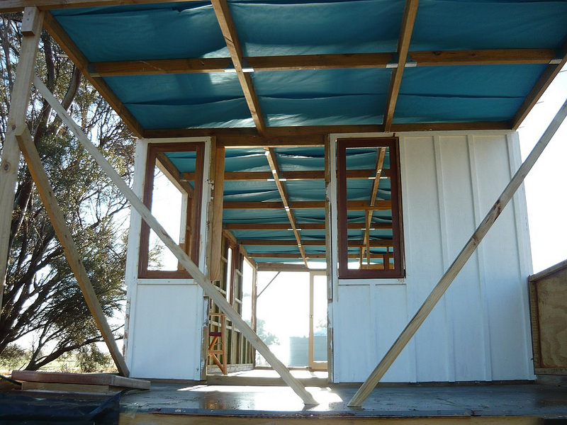

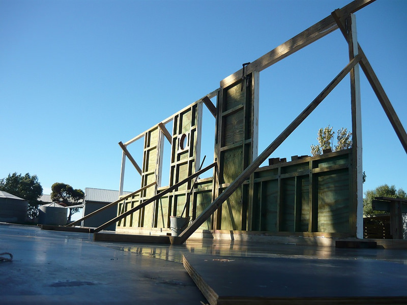

Standing up the wall panels.![Bracing wall panels. Bracing wall panels.](https://www.small-cabin.com/forum/shared_files/uploaded/5237/76908_1.jpg) Bracing wall panels.
| ![14462699073_54a4449a.jpg 14462699073_54a4449a.jpg](https://www.small-cabin.com/forum/shared_files/uploaded/5237/76908_2.jpg) 14462699073_54a4449a.jpg
| ![14672541042_e29ce0c4.jpg 14672541042_e29ce0c4.jpg](https://www.small-cabin.com/forum/shared_files/uploaded/5237/76908_3.jpg) 14672541042_e29ce0c4.jpg
| ![14672860765_251d3d86.jpg 14672860765_251d3d86.jpg](https://www.small-cabin.com/forum/shared_files/uploaded/5237/76908_4.jpg) 14672860765_251d3d86.jpg

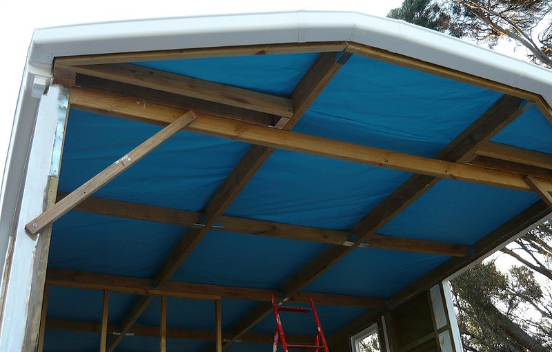

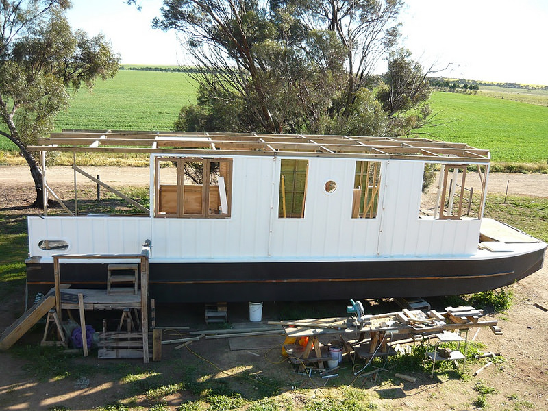

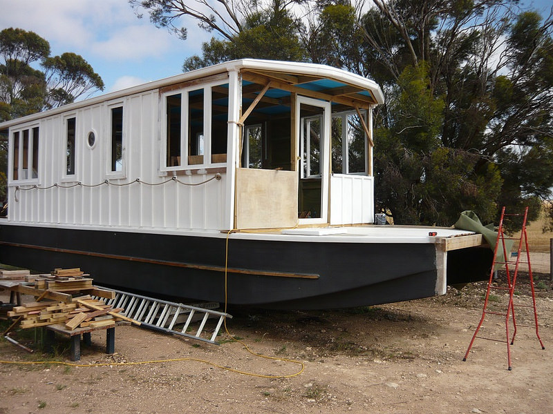

Roof.![Treated pine wall and roof framing. Treated pine wall and roof framing.](https://www.small-cabin.com/forum/shared_files/uploaded/5237/76909_1.jpg) Treated pine wall and roof framing.
| ![14975190346_89320fd6.jpg 14975190346_89320fd6.jpg](https://www.small-cabin.com/forum/shared_files/uploaded/5237/76909_2.jpg) 14975190346_89320fd6.jpg
| ![14811469899_49368bd1.jpg 14811469899_49368bd1.jpg](https://www.small-cabin.com/forum/shared_files/uploaded/5237/76909_3.jpg) 14811469899_49368bd1.jpg
| ![14900244809_b6fb6df0.jpg 14900244809_b6fb6df0.jpg](https://www.small-cabin.com/forum/shared_files/uploaded/5237/76909_4.jpg) 14900244809_b6fb6df0.jpg

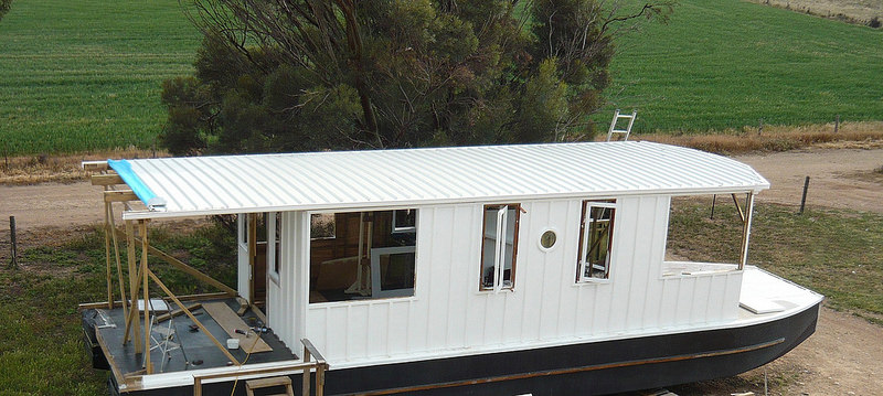

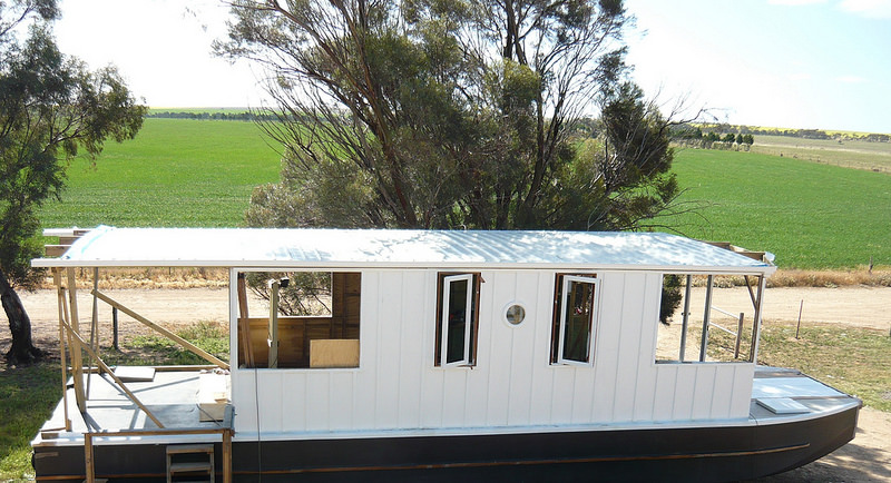

Sheet metal roofing.![15077633008_80ce2dc6.jpg 15077633008_80ce2dc6.jpg](https://www.small-cabin.com/forum/shared_files/uploaded/5237/76910_1.jpg) 15077633008_80ce2dc6.jpg
| ![15260965041_3e460720.jpg 15260965041_3e460720.jpg](https://www.small-cabin.com/forum/shared_files/uploaded/5237/76910_2.jpg) 15260965041_3e460720.jpg
| ![15165590365_95dc16f7.jpg 15165590365_95dc16f7.jpg](https://www.small-cabin.com/forum/shared_files/uploaded/5237/76910_3.jpg) 15165590365_95dc16f7.jpg

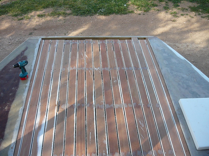

| ![Front deck. Front deck.](https://www.small-cabin.com/forum/shared_files/uploaded/5237/76910_4.jpg) Front deck.
victorvector
# Posted: 15 Jan 2015 13:45

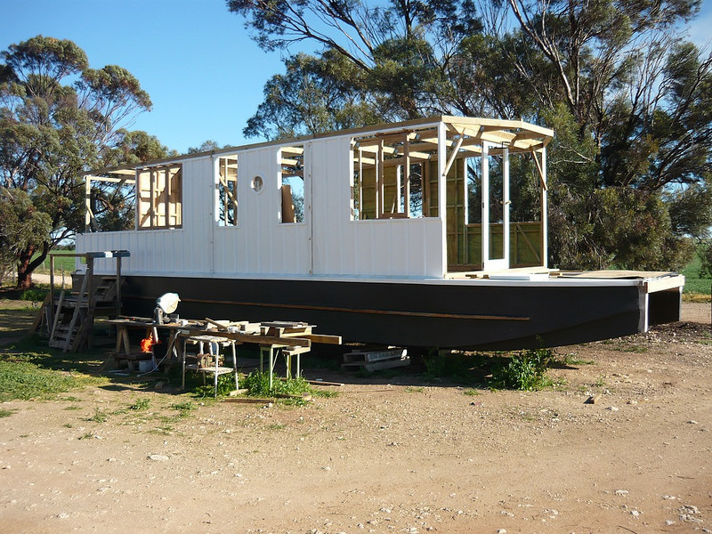

Cabin walls and roof completed.![PVC guttering. PVC guttering.](https://www.small-cabin.com/forum/shared_files/uploaded/5237/76911_1.jpg) PVC guttering.
| ![15079408318_4654b2b7.jpg 15079408318_4654b2b7.jpg](https://www.small-cabin.com/forum/shared_files/uploaded/5237/76911_2.jpg) 15079408318_4654b2b7.jpg
| ![15089529509_75d9062e.jpg 15089529509_75d9062e.jpg](https://www.small-cabin.com/forum/shared_files/uploaded/5237/76911_3.jpg) 15089529509_75d9062e.jpg
| ![14979012668_cb5c4e50.jpg 14979012668_cb5c4e50.jpg](https://www.small-cabin.com/forum/shared_files/uploaded/5237/76911_4.jpg) 14979012668_cb5c4e50.jpg

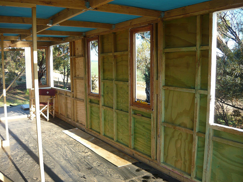

victorvector
# Posted: 15 Jan 2015 13:55

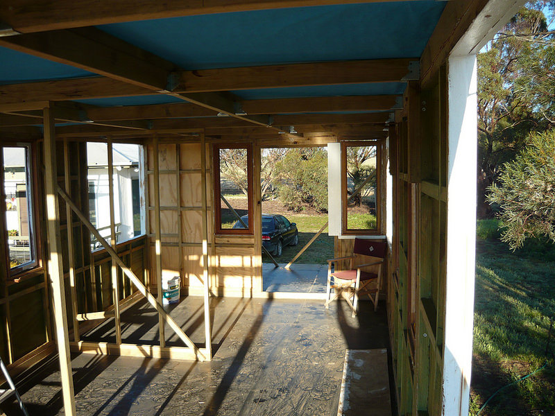

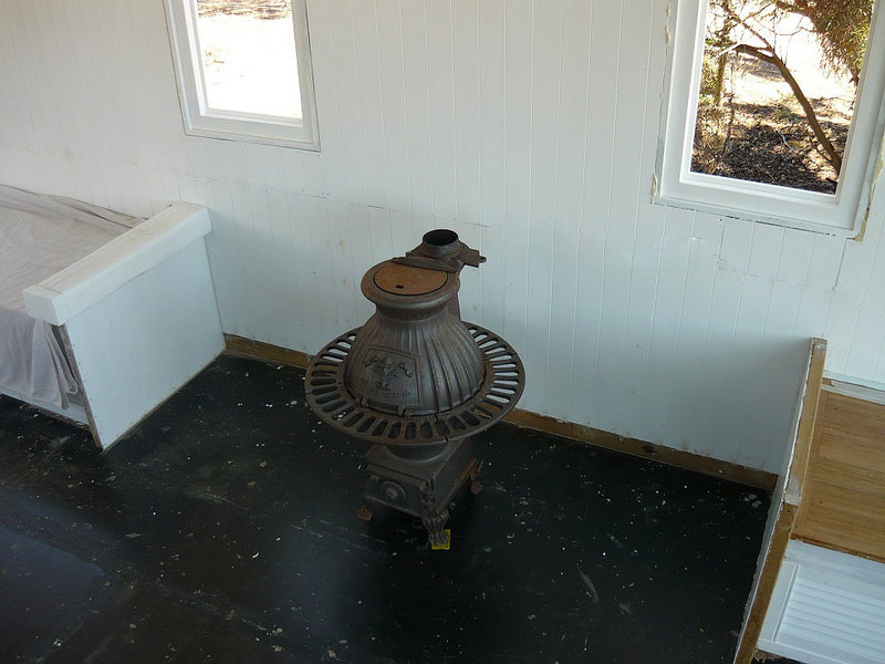

Interior.![Starting the fit out. Starting the fit out.](https://www.small-cabin.com/forum/shared_files/uploaded/5237/76913_1.jpg) Starting the fit out.
| ![15165209292_f42f8b08.jpg 15165209292_f42f8b08.jpg](https://www.small-cabin.com/forum/shared_files/uploaded/5237/76913_2.jpg) 15165209292_f42f8b08.jpg
| ![Insulating the walls. Insulating the walls.](https://www.small-cabin.com/forum/shared_files/uploaded/5237/76913_3.jpg) Insulating the walls.

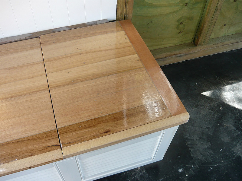

| ![Fitting the seating. Fitting the seating.](https://www.small-cabin.com/forum/shared_files/uploaded/5237/76913_4.jpg) Fitting the seating.

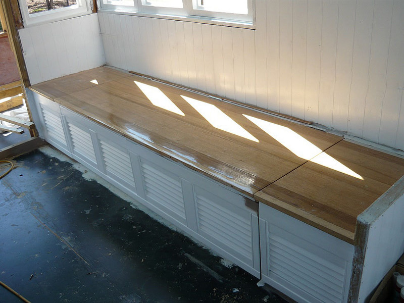

Fitting out the interior.![Seating. Seating.](https://www.small-cabin.com/forum/shared_files/uploaded/5237/76914_1.jpg) Seating.
| ![15687650947_efc7c6f9.jpg 15687650947_efc7c6f9.jpg](https://www.small-cabin.com/forum/shared_files/uploaded/5237/76914_2.jpg) 15687650947_efc7c6f9.jpg
| ![15687648007_26dba0a7.jpg 15687648007_26dba0a7.jpg](https://www.small-cabin.com/forum/shared_files/uploaded/5237/76914_3.jpg) 15687648007_26dba0a7.jpg
| ![15251169804_98607ee9.jpg 15251169804_98607ee9.jpg](https://www.small-cabin.com/forum/shared_files/uploaded/5237/76914_4.jpg) 15251169804_98607ee9.jpg

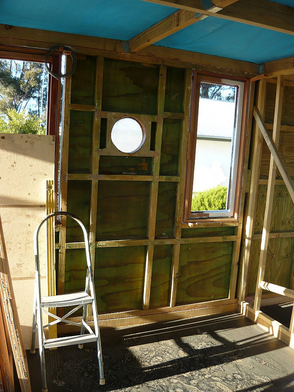

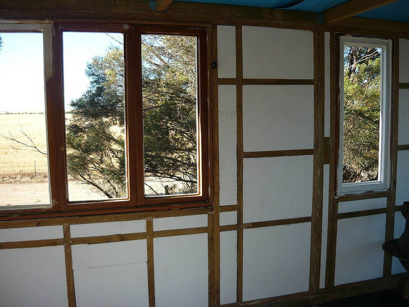

Some more interior work.![Insulating the walls. Insulating the walls.](https://www.small-cabin.com/forum/shared_files/uploaded/5237/76916_1.jpg) Insulating the walls.
| ![Lining the walls Lining the walls](https://www.small-cabin.com/forum/shared_files/uploaded/5237/76916_2.jpg) Lining the walls
| ![15937938129_ce10f624.jpg 15937938129_ce10f624.jpg](https://www.small-cabin.com/forum/shared_files/uploaded/5237/76916_3.jpg) 15937938129_ce10f624.jpg
| ![16123460372_3b61d51c.jpg 16123460372_3b61d51c.jpg](https://www.small-cabin.com/forum/shared_files/uploaded/5237/76916_4.jpg) 16123460372_3b61d51c.jpg

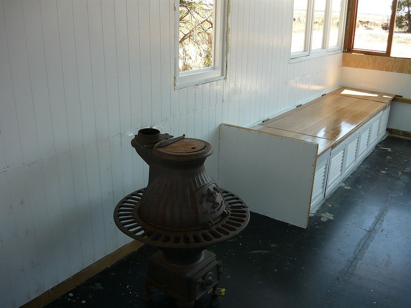

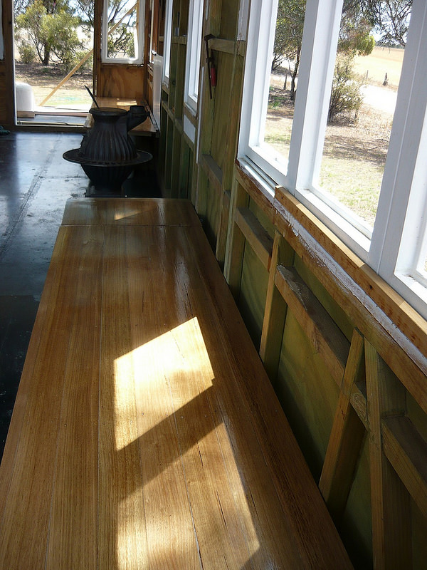

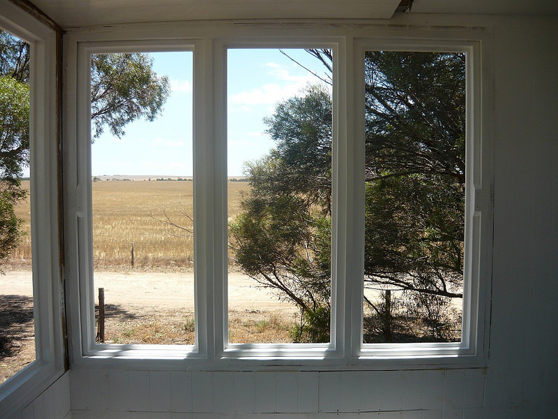

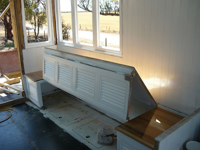

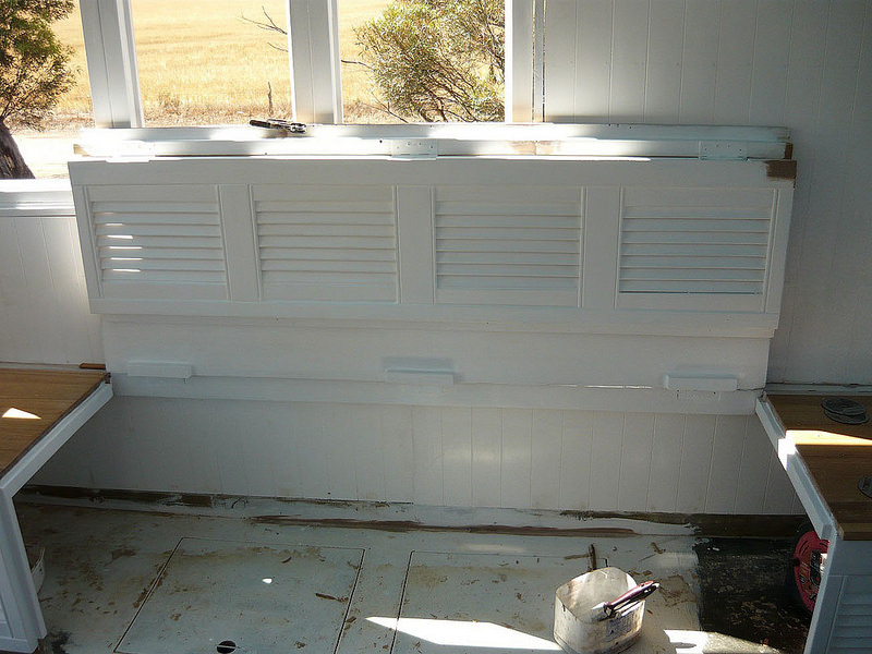

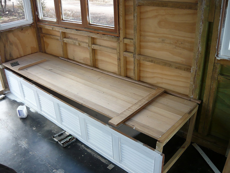

Interior work so far.![Seating folds for storage and hull access. Seating folds for storage and hull access.](https://www.small-cabin.com/forum/shared_files/uploaded/5237/76924_1.jpg) Seating folds for storage and hull access.
| ![Folding up the seats. Folding up the seats.](https://www.small-cabin.com/forum/shared_files/uploaded/5237/76924_2.jpg) Folding up the seats.
| ![Hull access .Hatches in floor. Hull access .Hatches in floor.](https://www.small-cabin.com/forum/shared_files/uploaded/5237/76924_3.jpg) Hull access .Hatches in floor.
| ![Casement windows. Casement windows.](https://www.small-cabin.com/forum/shared_files/uploaded/5237/76924_4.jpg) Casement windows.

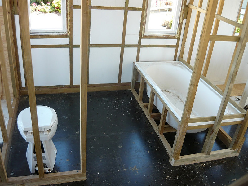

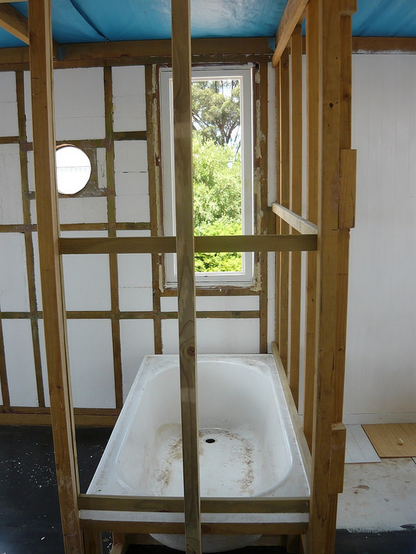

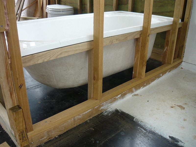

Bathroom framing.![Framing out the bathroom. Framing out the bathroom.](https://www.small-cabin.com/forum/shared_files/uploaded/5237/76925_1.jpg) Framing out the bathroom.
| ![Installing Bath Installing Bath](https://www.small-cabin.com/forum/shared_files/uploaded/5237/76925_2.jpg) Installing Bath
| ![16257473506_cbd73317.jpg 16257473506_cbd73317.jpg](https://www.small-cabin.com/forum/shared_files/uploaded/5237/76925_3.jpg) 16257473506_cbd73317.jpg
| ![15661512934_92242ea8.jpg 15661512934_92242ea8.jpg](https://www.small-cabin.com/forum/shared_files/uploaded/5237/76925_4.jpg) 15661512934_92242ea8.jpg

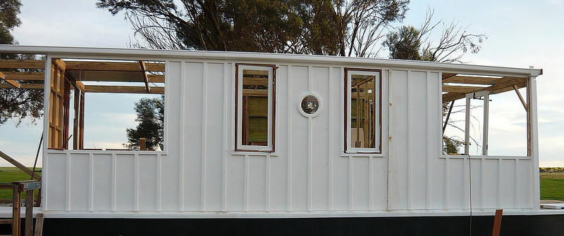

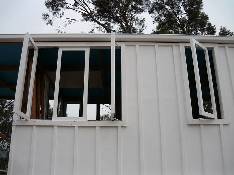

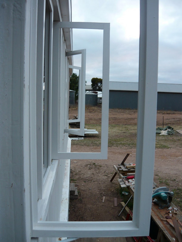

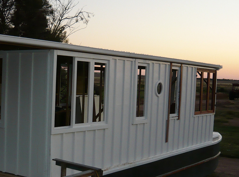

# Posted: 15 Jan 2015 21:20

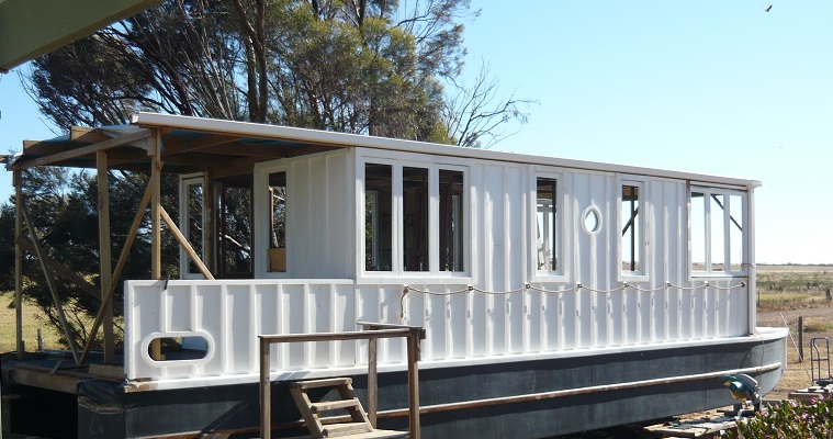

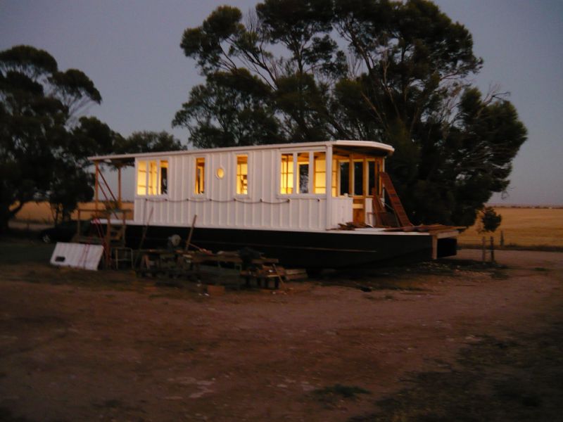

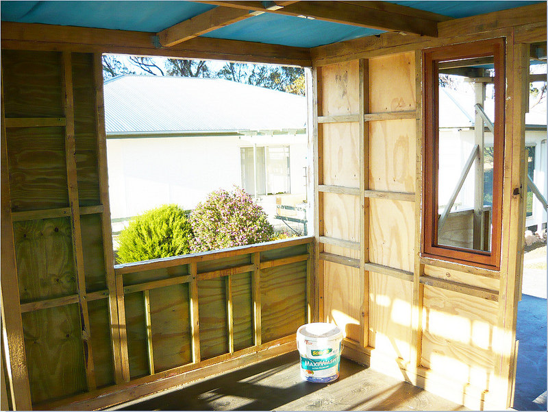

Final pictures. This is the current state of my project.

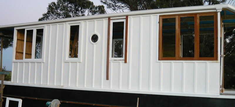

Thanks for your interest.![Casement windows open. Casement windows open.](https://www.small-cabin.com/forum/shared_files/uploaded/5237/76926_1.jpg) Casement windows open.
| ![Trimming out windows and painting the exterior. Trimming out windows and painting the exterior.](https://www.small-cabin.com/forum/shared_files/uploaded/5237/76926_2.jpg) Trimming out windows and painting the exterior.
| ![Exterior .Board and batten look. Exterior .Board and batten look.](https://www.small-cabin.com/forum/shared_files/uploaded/5237/76926_3.jpg) Exterior .Board and batten look.
| ![Canvas set in Titebond III exterior skin. Canvas set in Titebond III exterior skin.](https://www.small-cabin.com/forum/shared_files/uploaded/5237/76926_4.jpg) Canvas set in Titebond III exterior skin.
# Posted: 15 Jan 2015 21:39
the house on a boat in the desert.....is your name NOAH!!!![](http://www.small-cabin.com/forum/img/smilies/wink.gif)
fine job on your build!!! looks fantastic!!!

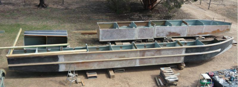

# Posted: 16 Jan 2015 04:28 - Edited by: victorvector
Firstly ,thank you for the kind comments.
I have to admit , I do sometimes think that I know what NOAH must have thought. (AM I MAD ?)
I am building this little boat entirely by myself and at times I could have used a little help.
The most difficult part was assembling those pontoon floats , at 40 feet long they were a handful to handle .I built those in sections to divide them into smaller bites ,and then glued and bolted them together with epoxy.The exterior was fiber glassed marine plywood set in epoxy .
Regardless , I can finally see some light at the end of this particular tunnel.
I should also mention that the cabin area of this little craft is 24 x 12 or 288 square feet.

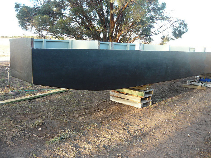

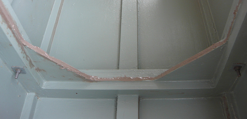

Thanks again , I do appreciate your interest.![Bolting together the hull sections. Bolting together the hull sections.](https://www.small-cabin.com/forum/shared_files/uploaded/5237/76934_1.jpg) Bolting together the hull sections.
| ![Bolted and epoxy glued hull section. Bolted and epoxy glued hull section.](https://www.small-cabin.com/forum/shared_files/uploaded/5237/76934_2.jpg) Bolted and epoxy glued hull section.
| ![Little ship in the desert Little ship in the desert](https://www.small-cabin.com/forum/shared_files/uploaded/5237/76934_3.jpg) Little ship in the desert

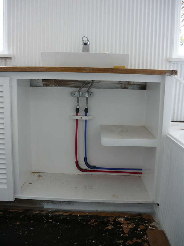

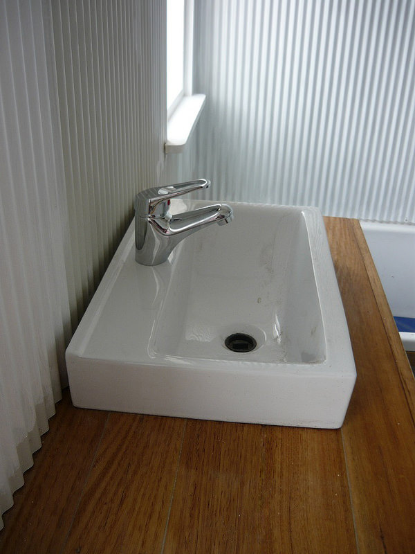

# Posted: 28 Mar 2015 22:39 - Edited by: victorvector

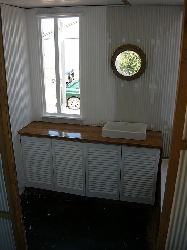

Domestic mixer tap and RV plumbing.![Sink Sink](https://www.small-cabin.com/forum/shared_files/uploaded/5237/80255_2.jpg) Sink
| ![Recycled oak flooring bench top. Recycled oak flooring bench top.](https://www.small-cabin.com/forum/shared_files/uploaded/5237/80255_3.jpg) Recycled oak flooring bench top.
| ![RV style push on plumbing. RV style push on plumbing.](https://www.small-cabin.com/forum/shared_files/uploaded/5237/80255_4.jpg) RV style push on plumbing.
