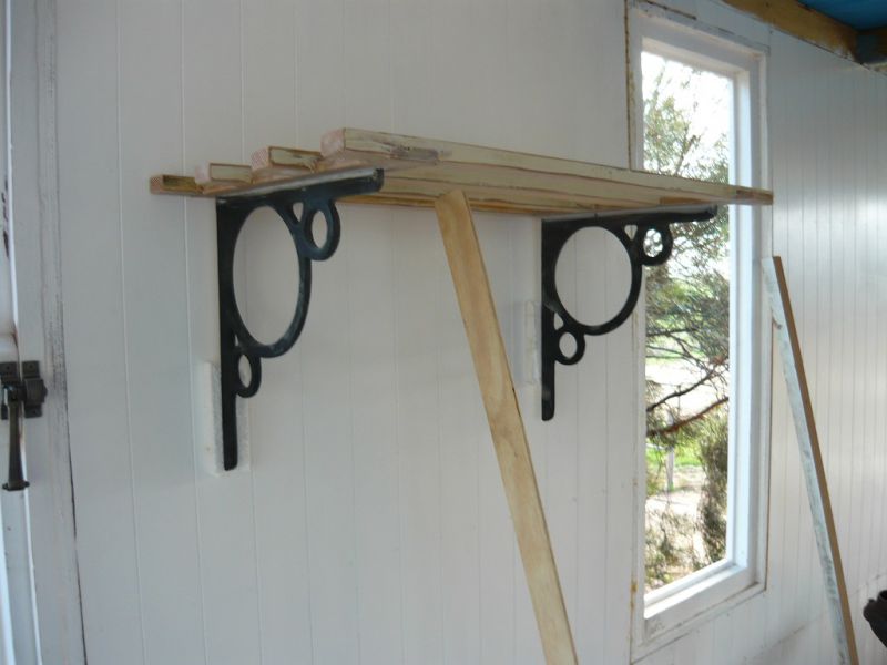

| victorvector Member
 | # Posted: 13 Jun 2015 03:10pm Reply

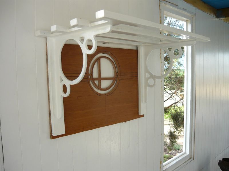

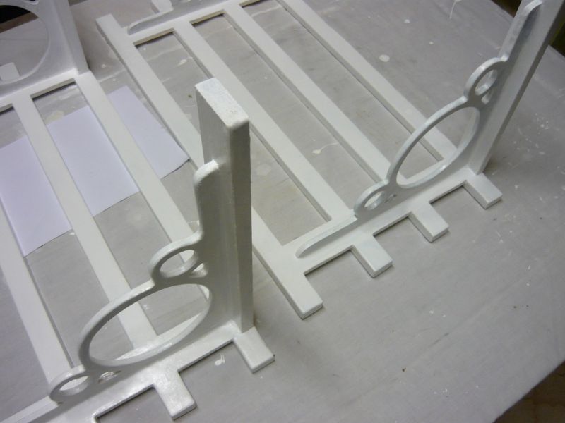

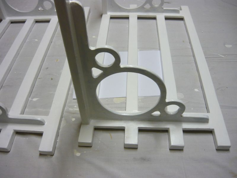

 Working on the last of the shelving inside the cabin space.
 |  Rough free hand sketch of the shelf bracket
 |  Marine plywood shelf bracket cut out with jigsaw
 |  Cleaned up and painted bracket
 |  Slats attached to bracket , checking for fit on the wall
| victorvector Member
 | # Posted: 13 Jun 2015 03:15pm Reply

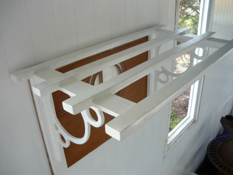

 Time consuming details.
 |  Seems to fit the space.
 |  attaching the shelf uprights and first coat of paint.
 |  Sanding and painting .....again....
 |  Light panel for the shelving , 3/8 marine plywood.

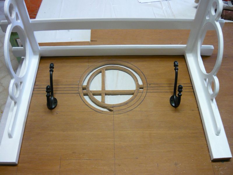

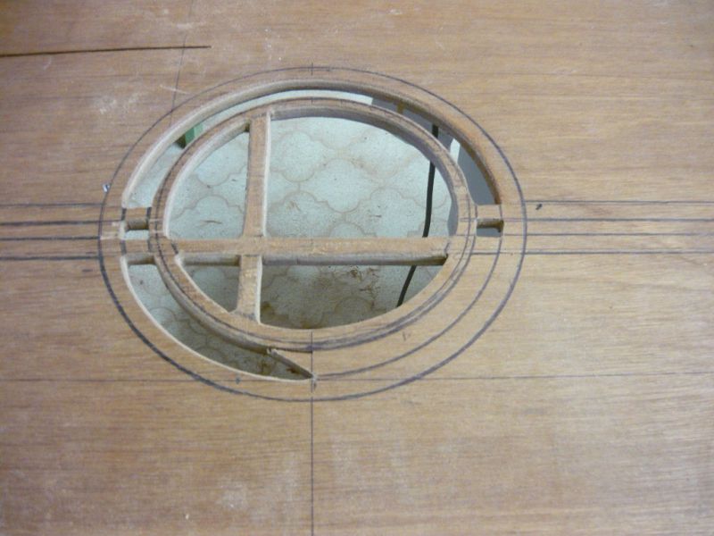

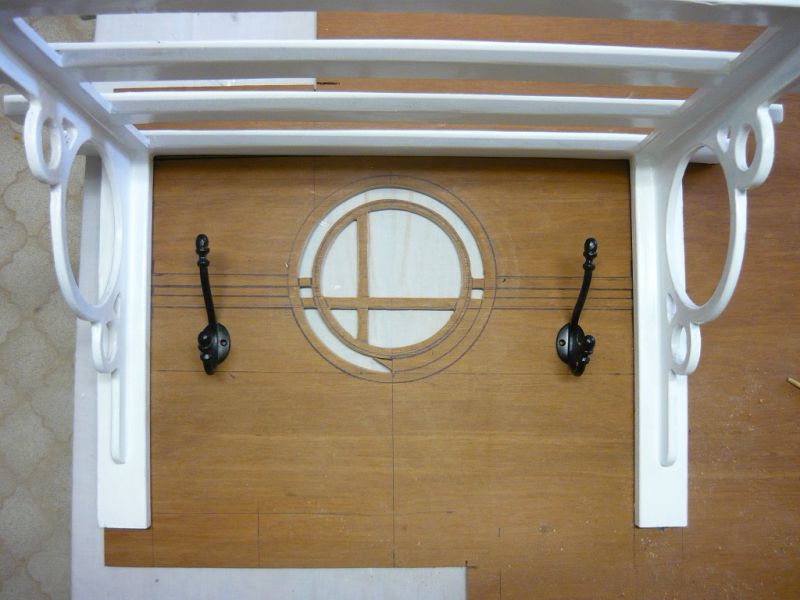

 Ambient lighting built into shelving
 |  Cutting out the light panel .
 |  Approximate placement of hooks on the wall.
 |  Top view of shelf.
 |  Panel will be back lit with led warm white strip lighting.

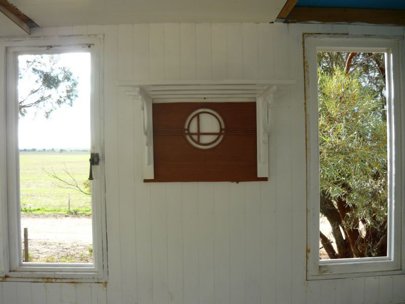

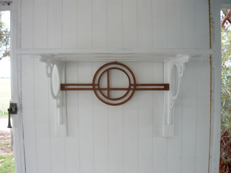

 A touch of art deco.
 |  Art deco style.
 |  Current state of shelving more to come soon.

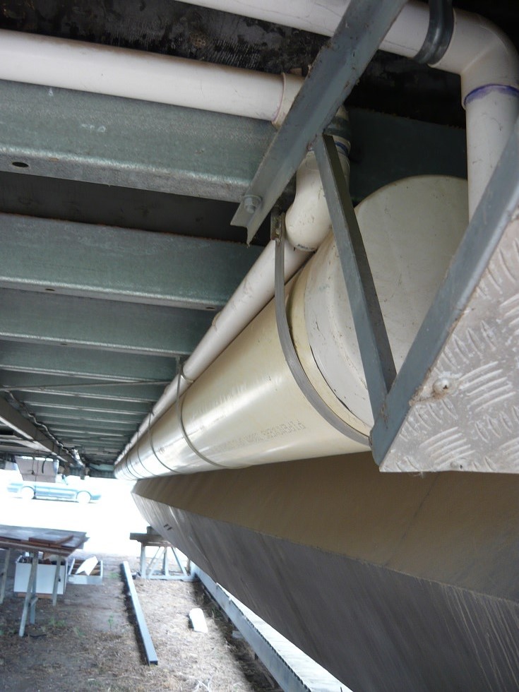

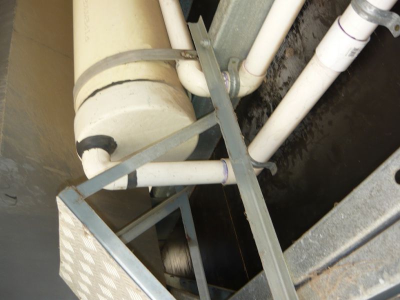

 Waste water will be handled by a long cylindrical tank strapped under the bridge deck / floor beams.( There are 24 x 2x6 inch cross members bolted to the pontoons at 24 inch centers.)
 The tank it self is constructed with 12 inch pvc thick walled sewer pipe fitted with end caps.
 Capacity of the tank is approx 235 Gallons.
 I may fit twin tanks side by side to double capacity to 460 Gallons.
 The pictures of the black water tank attached is not of my boat , but is very similar to what will be fitted ..... thank you for the interest , and dropping by.

 The waste water tanks are completed.
 Vents fitted to waste tanks.
| victorvector Member
 | # Posted: 22 Jun 2016 12:00am Reply
 Pump out and flush pipes.
 Covers for the pump out camlock fittings.
