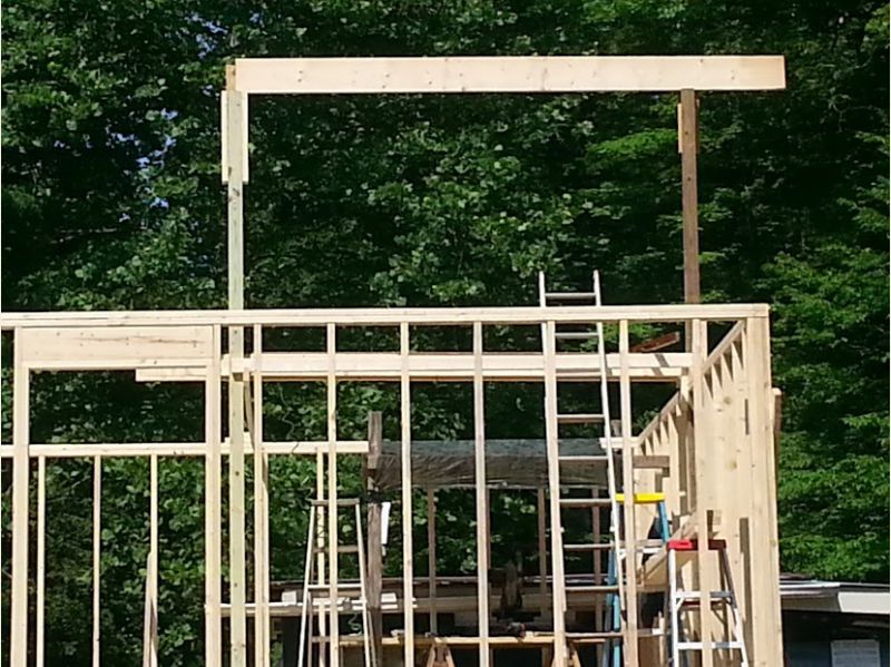

I like the fact that you used a structural ridge beam to carry the roof loads. It looks like you either have some experience in framing or you did your research prior to starting work or both. Congrats!

Does your post supporting the ridge beam lay in the row of the wall framing (two separate wall panels - one to each side of the post)?
Or did you build the wall framing and tack the supporting post to the inside of the wall framing?
I'm considering doing a ridge beam & I've been turning that over in my head lately....
Rowjr
# Posted: 29 Jul 2015 03:09pm

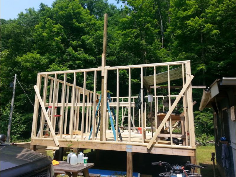

My ridge beam support will be part of an interior wall. I used a 4x4 so it would frame in the same as my 2x4 meaning my cabin eventually will be divided into a bedroom dimension will be 10x12 and bathroom 10x6 and one large room 14 x18 for my kitchen and living area. So my longest span for my ridge beam will be 14' span. The interior wall didn't line up with any of my floor joist so I added a ground pad and what they call a décor block that supports a 4x4 or 6x6 and I will eventually add the 4x4 this fall. I'll put a 4x4 under or directly under the 4x4 that's sitting on my floor right now. Also its center of course to line up with my ridge beam.

couple more pictures of my ridge beam support

My only question is why you didn't put a row of 4X4's, 4X6's or 6X6's down the long axis of your cabin for floor support, in the very center of the floor? Our original cabin is only 12 feet wide, but I ran two 2X6's on each side of the 4X4's in the center of the front and rear of the cabin as well as a 4X6 in the very center of the cabin. Basically, I sandwiched the 4X4's and 4X6's between two 16' long 2X6's and put two 1/2" bolts through the three support posts. Everyone told me I was going way overboard but I would rather be safe...than sorry.
If I look at your photos it appears that you are spanning 16' with no support. If I missed something I apologize but I just thought I would mention it. You can always put pillars under the cabin, if need be. What size floor joists are you using?

I have 6 x 6 post every 6' in a grid formation under the cabin joist. I have two doubled 2 x 8 girder supports running the full length as girders supporting under the 2x6 floor joist so my longest span is 6 foot. Its rock solid and all my joist are notch into the top of the 6 x6 or rest on top so I do have weight on supporting bolts,etc. I used 3/4" plywood for the subfloor. I suppose I will have to get under and insulate eventually but I was just focusing on drying in the cabin first. I live in Florida so my time up there is limited. I was debating on using solid Styrofoam for the floor but seeing your process I'm thinking different maybe.
Rowjr
# Posted: 10 Oct 2015 08:47am
The cabin is 18' x 24'

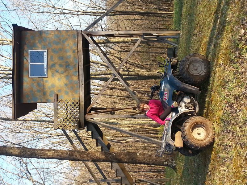

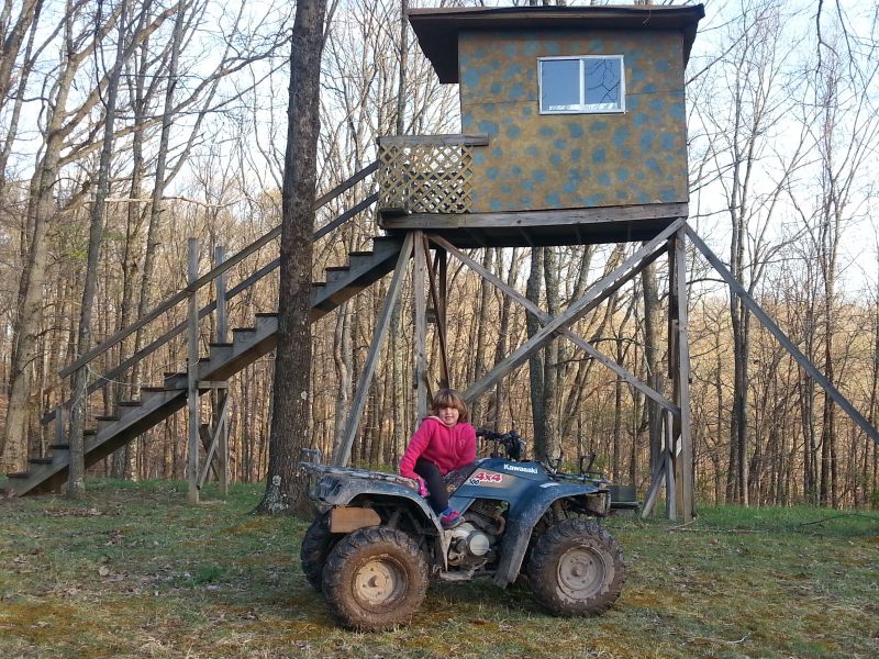

MY little cabin away from my cabin

Well then it came but side ways don't understand...We call it 5 star and its heated....
