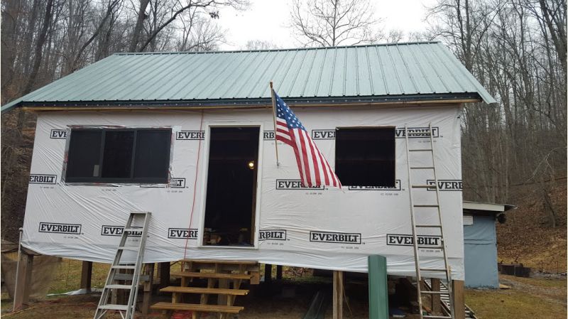

# Posted: 12 Dec 2015 04:17pm

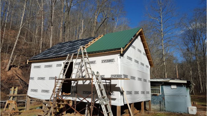

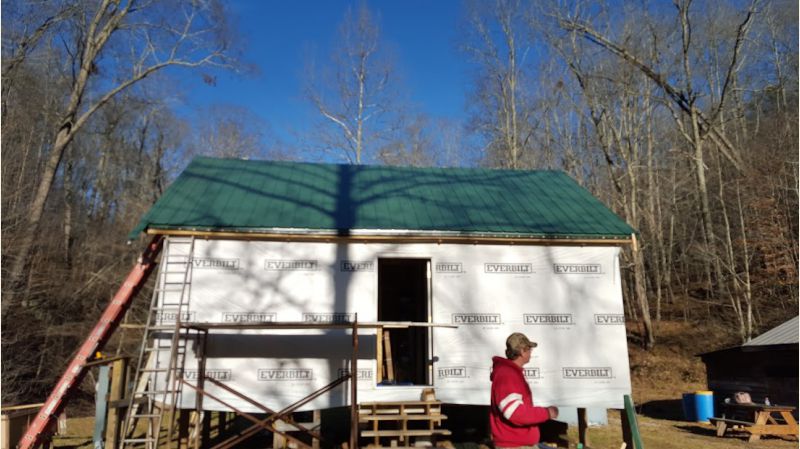

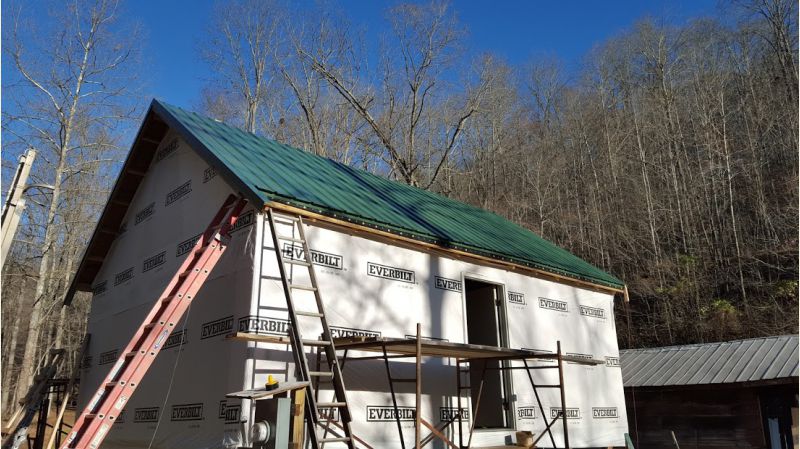

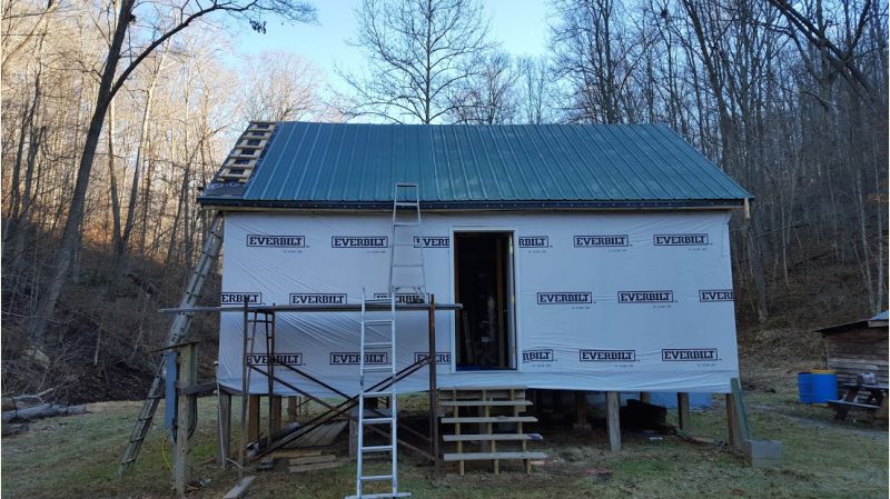

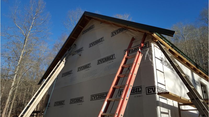

As you can see I finally got my roof done 10/12 pitch can be a b#%@&!...

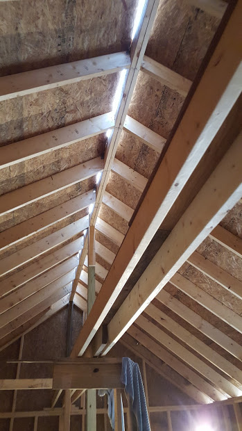

# Posted: 12 Dec 2015 04:26pm

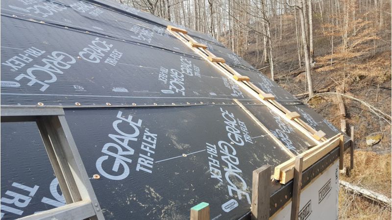

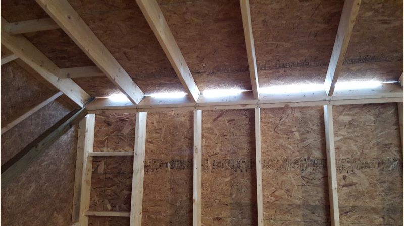

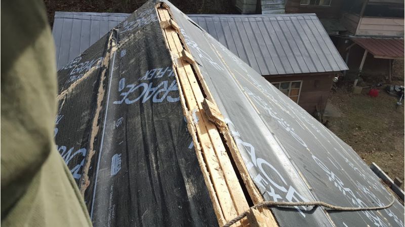

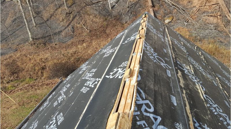

Sort of always starts out like this maybe even more but this time not so bad. 2nd I check my feeder and as you will see I move onto solving my hot roof issue. I cut back 2 1/2 inches of plywood on both sides of my ridge beam so it will breath to the ridge vent now...
AK Seabee
# Posted: 12 Dec 2015 04:27pm
The roof is a huge step! The 10-12 pitch is steep but it definately adds to the space in the loft.
Rowjr
# Posted: 12 Dec 2015 04:29pm
No problem now for breathing hoping it wont leak though
Well the ridge vent was pretty large and I also put in those foam inserts blocking any access holes into...

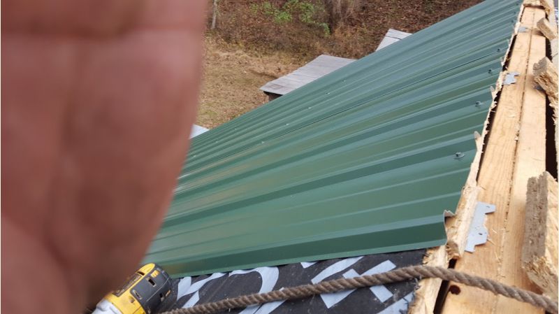

# Posted: 12 Dec 2015 04:30pm

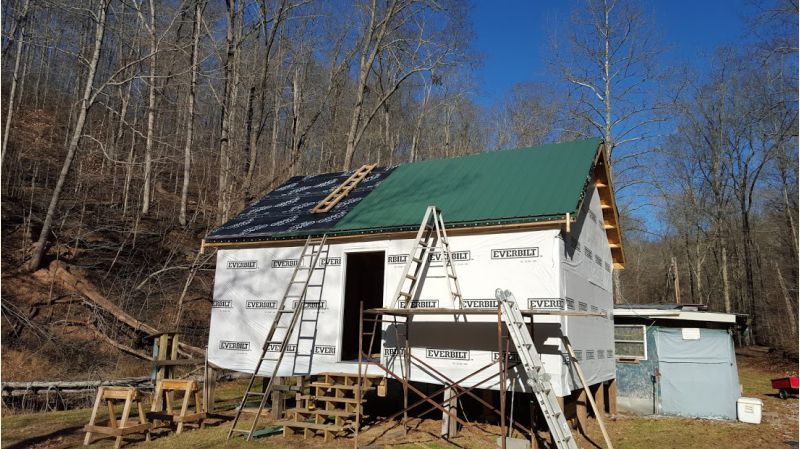

built a custom wooden ladder just for the metal install
Rowjr
# Posted: 12 Dec 2015 04:39pm

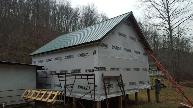

roof going up
Rowjr
# Posted: 12 Dec 2015 04:40pm

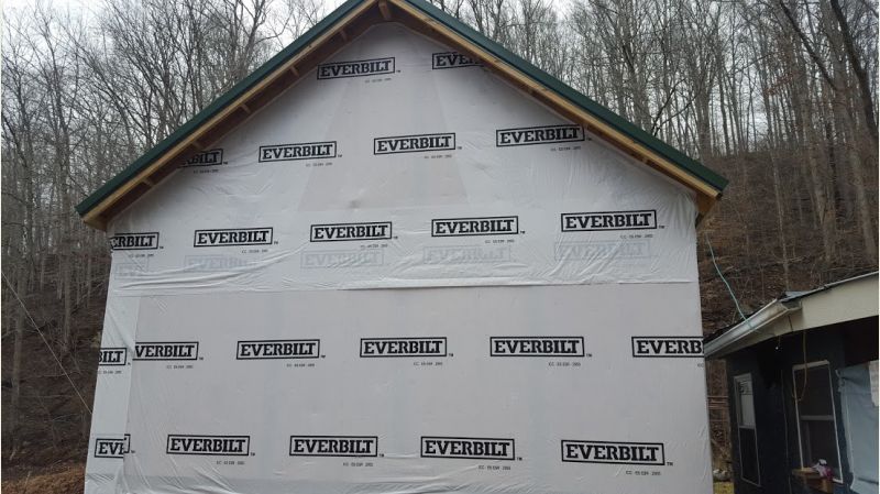

more roof and some deer hunting time

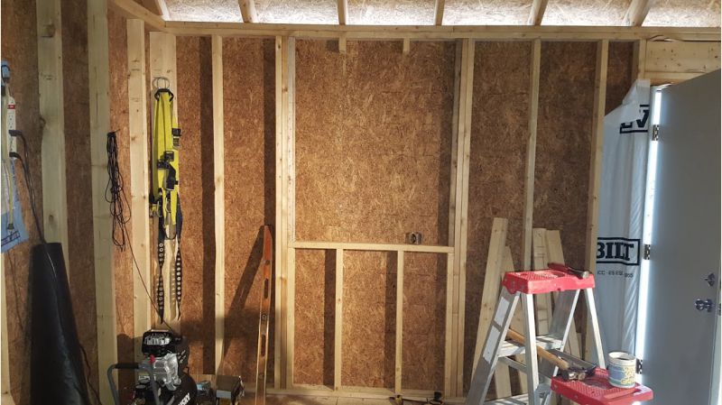

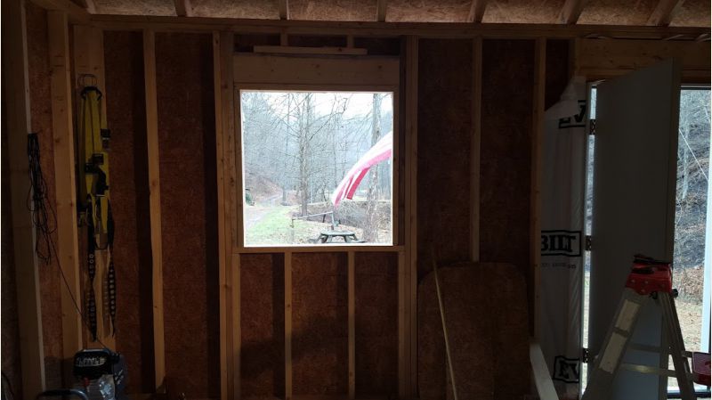

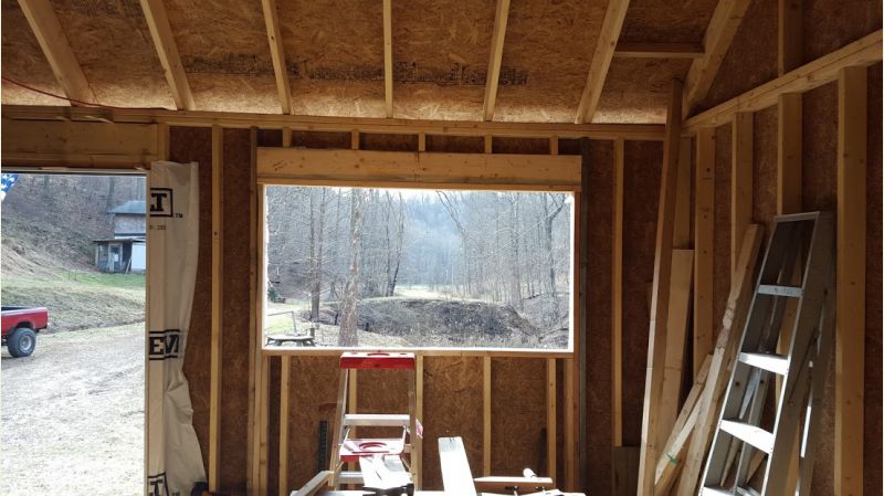

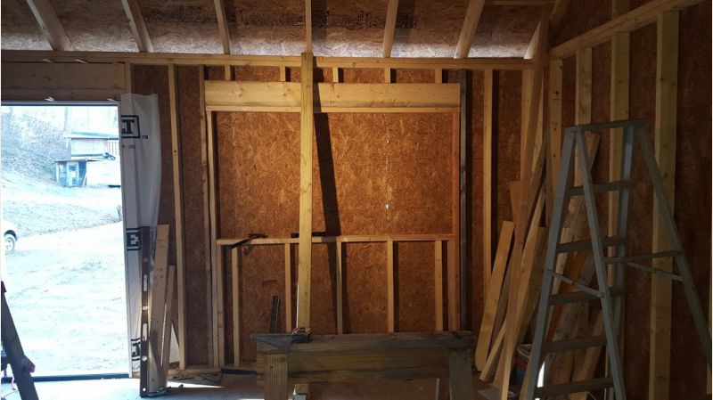

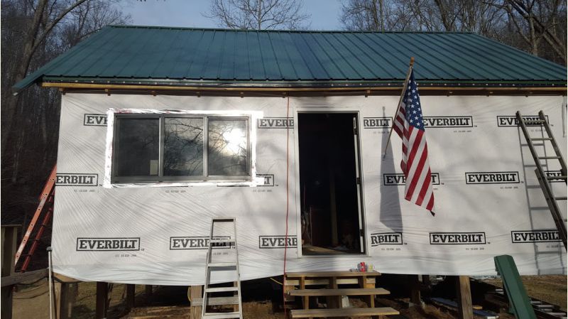

New window install
Rowjr
# Posted: 12 Dec 2015 04:53pm

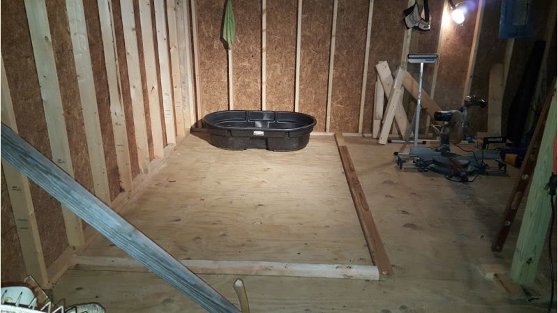

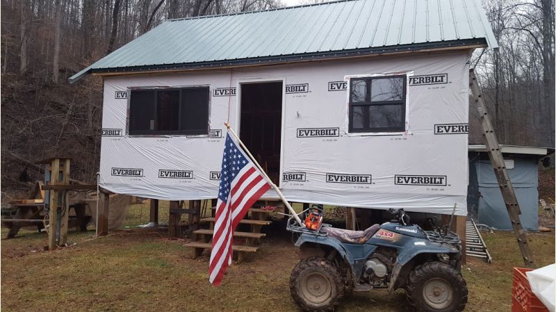

Another window install and bathroom lay out started

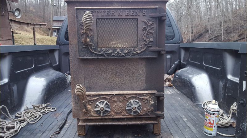

dug up an old stove might clean it up for a back up for heat in the cabin

looks fabulous. that old stove......be still my heart! I would so restore that beauty!
