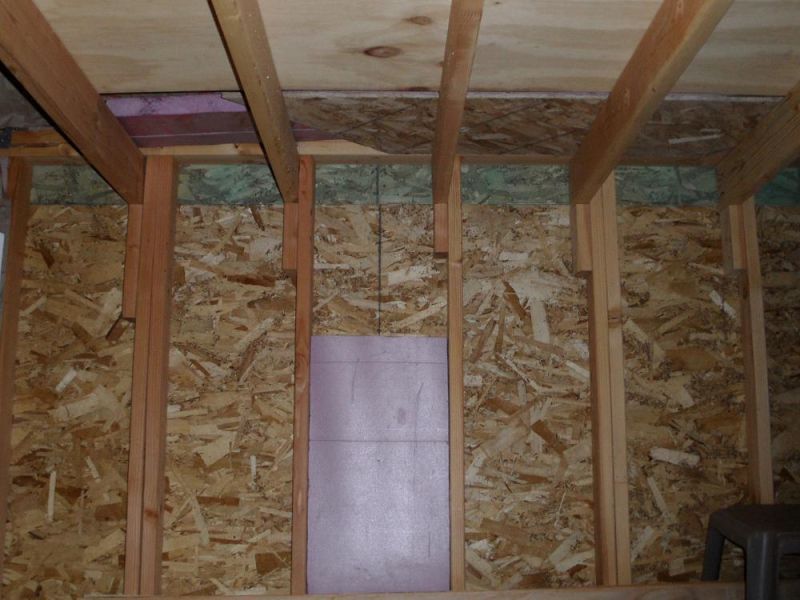

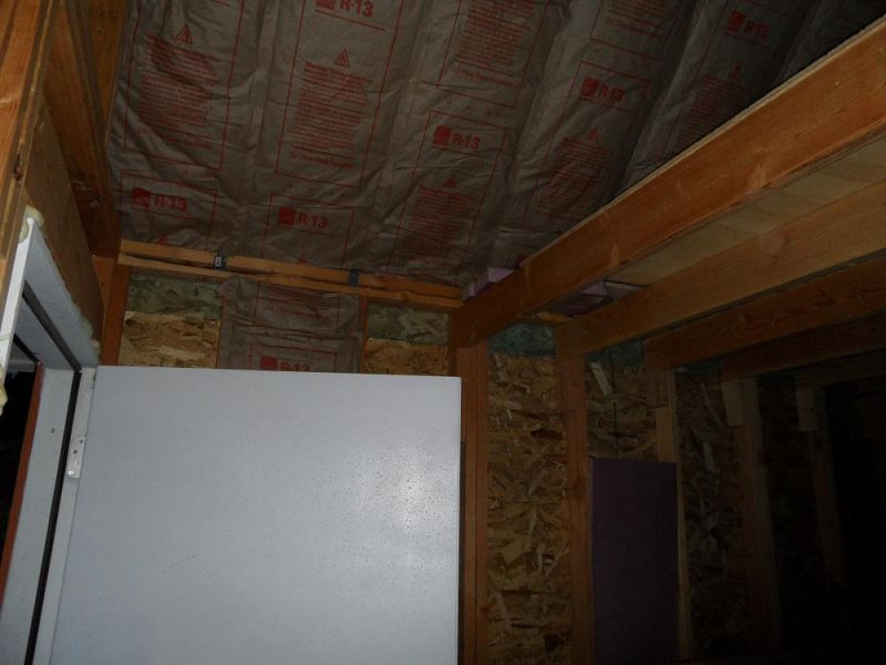

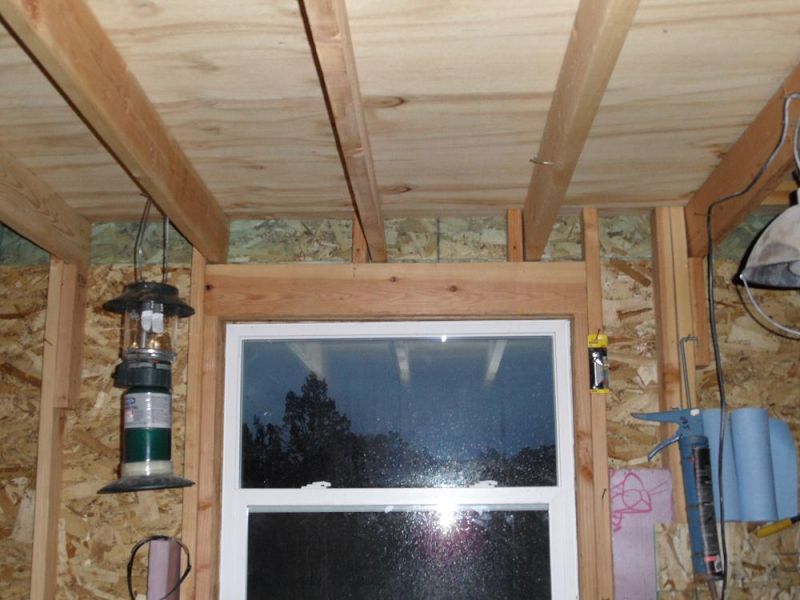

A few of you asked for pictures of the loft construction. I tried to take some pictures but it is tight quarters so I'm not sure I captured the view you were looking for.
The basic construction was to build the walls then add the loft joists up under the double top plate. We then added a supporting block under the joist. The loft decking is 1/2" plywood.

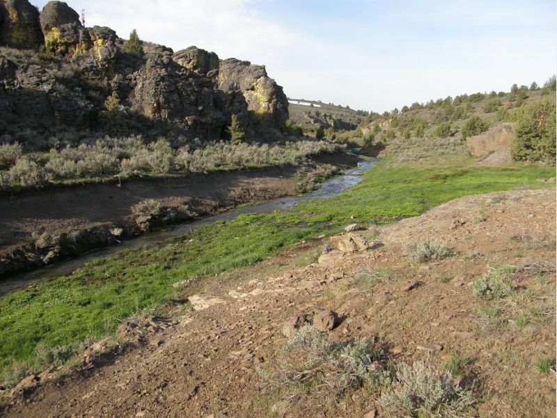

Yes bugs, it is in sad shape. A classic case of allowing the cattle to run unrestricted access up and down the stream. Another problem with easy access to the stream is that the cattle tend to congregate here and badly overgraze the ground closest to the stream. They are reluctant to travel up or over the hill to better grass. They don't eat as well as they could and so don't put on the weight the rancher would prefer. A better method is to fence the stream and create a water gap for access. Even better in my mind is to plumb a water trough fed by gravity feed and keep the cattle completely off the stream.
There is no shade and a lot of erosion. We will have our 80 acres and the resulting 1/2 mile of stream fenced off this spring. Our land is at the head of the creek and unfortunately the water gets warmed very early. There are remnants of willow, blackberry and aspen along the stream. We have removed quite a few juniper from along the bank. Other projects have been shoring up some of the banks and slowing down some of the stream flow.
There is a lot of work left but it is a labor of love.
