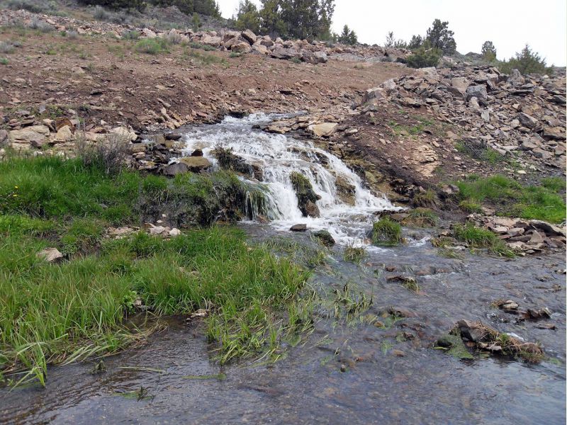

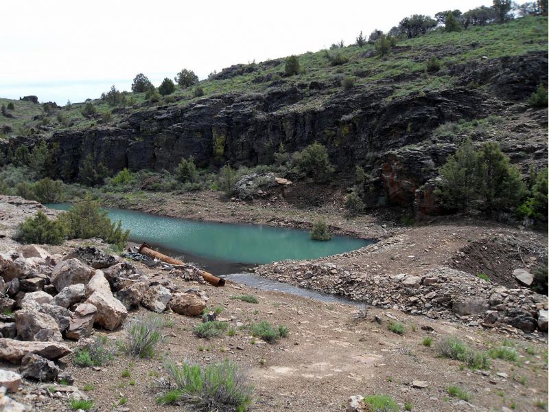

It finally dried out enough to get into our place. Lots of water this year. The pond is full and the overflow is running with plenty of water. The spring is flowing well too.
I only had one day this weekend. Lots of mosquitos and not enough breeze to keep them away. The humidity was really high so we sweated it out while working inside. The shed looked fine. Maybe something chewed on the door jamb but that was it.
