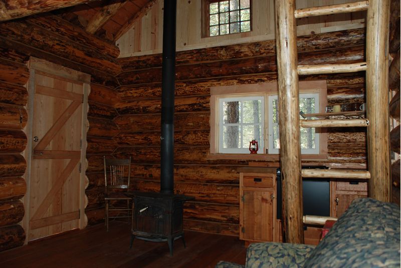

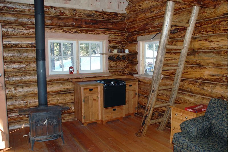

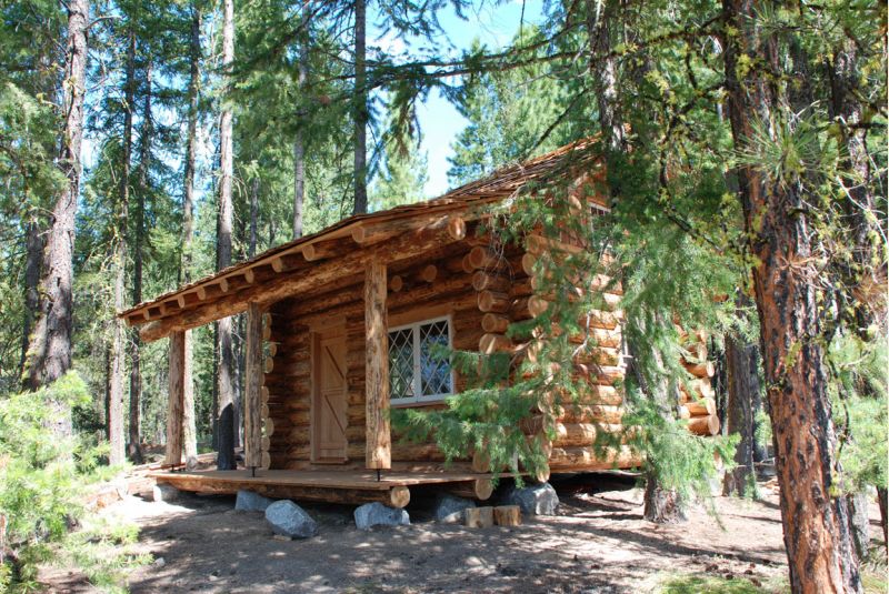

Hello!
Here is my cabin. I am absolutely thrilled to have this at my time in life (with my kids). I bet a lot of folks on this forum feel the same about their cabins!
Its up high, in snow country, and sorry I'm not too comfortable telling the location. Incidentally the tax assessor found it during construction and assessed tax on it - I'm OK with that. I fear the day when the building dept. comes by to tell me to take it down. It's way out there, behind a locked gate, with no vehicle access for 6 months of the year, so it's somewhat safe as long as the taxman doesn't talk too much (or me).
I paid a local to build the structure then trimmed it out with help of friends & family. I used rough-cut lumber from a local sawyer. The shingles are hand-split cedar, and the gable ends are board and batten, with long, hand-split cedar planks. The roof is 1 1/2" thick wood (plus shingles), but the floor has R19 insulation. The foundation is 9 granite rocks. I constructed it under the goal that it should look 100 years old, so there is no visible modern materials (very little). But for now the wood all looks bright and new.
A water pipe from the creek runs outside onto the ground constantl. It flows 800 feet by gravityy, with 17 feet of head, at the rate of 1 gallon per minute. I had the water tested, and my "stream sample was safe to drink". The stream originates from a spring on a steep hillside about 2000 feet away (origin is in a cedar grove but off my property). I drank it all of Sept/Oct/Nov, and no problems, but since it's on the surface there's no assurance that it will always be safe. I'll build an outdoor sink at some point. The kitchen counter is made of rough cut doug fir, Grandpa-built, and the range is an RV unit by Atwood. No refer yet.
I bought the windows at a used building materials store. I have an 85W solar panel about 30 feet up a tree, charging 250Ah of batteries.
T Porch view
|  Kitchen
|  Woodstove and dutch door

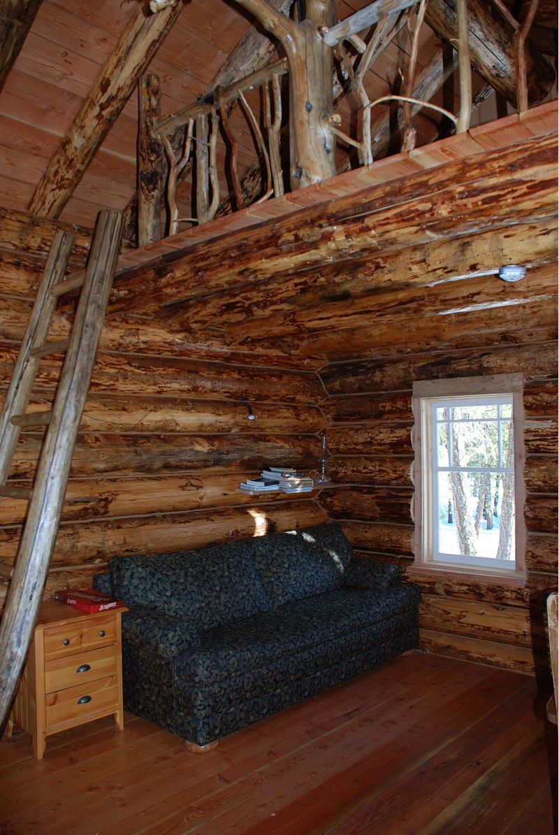

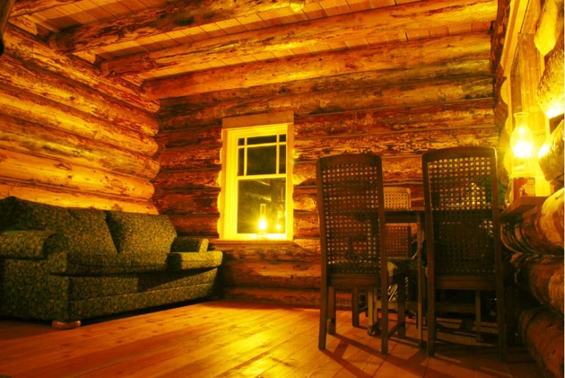

Here's the outhouse and a couple other views. The porch is 7x16 feet. It's empty because we have just cleaned it out to leave. When the family is there you don't even see the floor for all the gloves, boots and coats, firewood, groceries. It's a lot smaller than it looks in the pictures. Cedar Outhouse

We used permachink on the logs. Used a wet gloved finger to smooth the chink. Have not put any stain or finish on the outside yet. Was advised to let the logs breathe for a few months before staining. Maybe sometime this spring 2011. I did spray the entire outside with "Borate" to make it unhealthy beetlefood.
I did not use any stain on the inside, just one coat of varnish. I was advised to use only one coat, for longer life. You can see in the photos where I 'missed', the flash tells all on the railing and ceiling.
The floor has 3 coats of Daly's floorfin, an oilbase finish. The floor is rough cut doug fir boards of varying widths, nailed down onto 3/4" OSB. I sanded it very lightly to take the fuzz off then put on one coat. Then hand-sanded lightly to cut all the sharps off. Then 2nd and 3rd coat no more sanding. So the floor is kind of rough, but it can be swept or mopped.

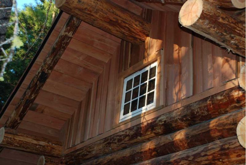

Thought some folks might like to see how I did my gable ends. Gables are covered with long, hand-split cedar shingles, in board-and-batten style. These are pretty small gable ends (cuz the cabin is only 12x16). The windows came from a used building materials store. Under the cedar (not visible) is OSB on 2x6 framing with insulation. Board and batten cedar shingles

the board and batten, gables look GREAT!!!!!! good job for sure, your camp is so nice. It looks so rugged but beautiful.

Roof pitch is 8/12 and 3/12 on the porch

Regarding stoves, I started another thread in January called "controlling heat from a woodstove". It has a pic of the "too-small potbelly stove", and good replies from other members.
I'm certain that a HUGE amount of my heat is lost thru the roof. Also due to air leaks because it is "just boards" with shake felt above. The roof boards were not adequately dried before nailing them on. Sitting under that nice dry heated roof, they've shrunk, opening a 1/4" gap between each board. So at each gable end I have 26 little 'vents' (one between each board, that add up to 4.5 inches each gable). Plus there is leakage across the whole roof under the felt. Don't judge your stove by my roof. My roof is designed to be 'classic' not to save firewood.
If you can use a modern stove and an insulated (and a tighter roof) it should be no problem heating your place at 0deg. I'd place the stove at least 30" away from the wall so people can stand all around it. Also you can build a hotter fire. And theres room to hang clothes on the wall to warm, (or dry) behind the stove.
