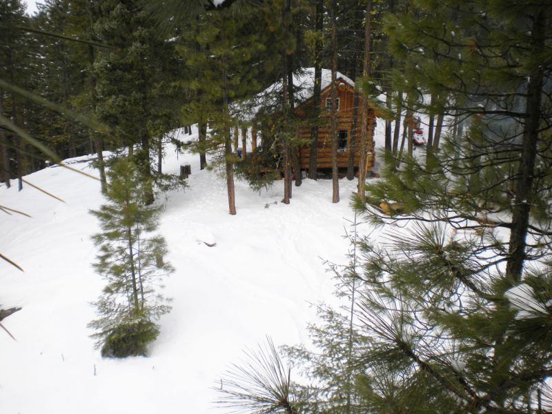

I have a single 85W panel, and two 6v batteries. It's marginal in the wintertime, but seems like plenty for summer thus far. I'll know better after more time there. I don't have any electrical appliances, just a laptop computer and about 12w (total) of LED lighting.
Currently 'affordablesolar.com' has 230w panels for about $2/watt. I paid about $5/watt. My panel is way up in a tree where it gets un-obstructed sun. Here is the view from the tree.

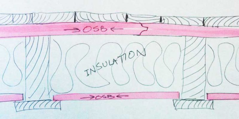

Here's a drawing of the floor joists and insulation. The lower "OSB planks" (14 inches wide) are just sitting there by gravity.
Floor insulation, with critter barrier below.
View of the cabin from the solar tree

Thanks for the drawing- that makes a lot of sense. It sounds like the solar is a great option for you. We have electricity very close so we'll be on the grid. We're headed up to paper and frame the roof this weekend (and put plastic on the door and window openings.) Here's a shot of our "shell."

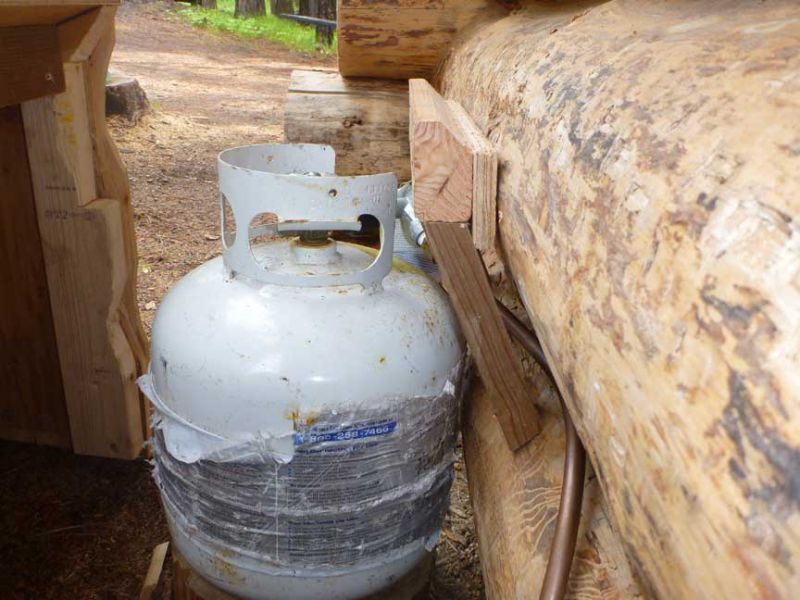

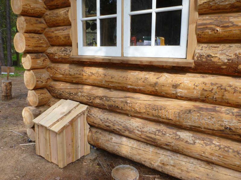

Yesterday I made a cover for the propane tank. It's sided with cedar scraps.
There is a similar shaped piece of wood on the cover that engages this support. It 'hangs' on a ledge at the top, and 'floats' over the ground, for good ventilation. To turn propane on/off I have to lift the whole cover off.
Propane tank cover
Propane tank cover
Tank cover support
Tank cover support

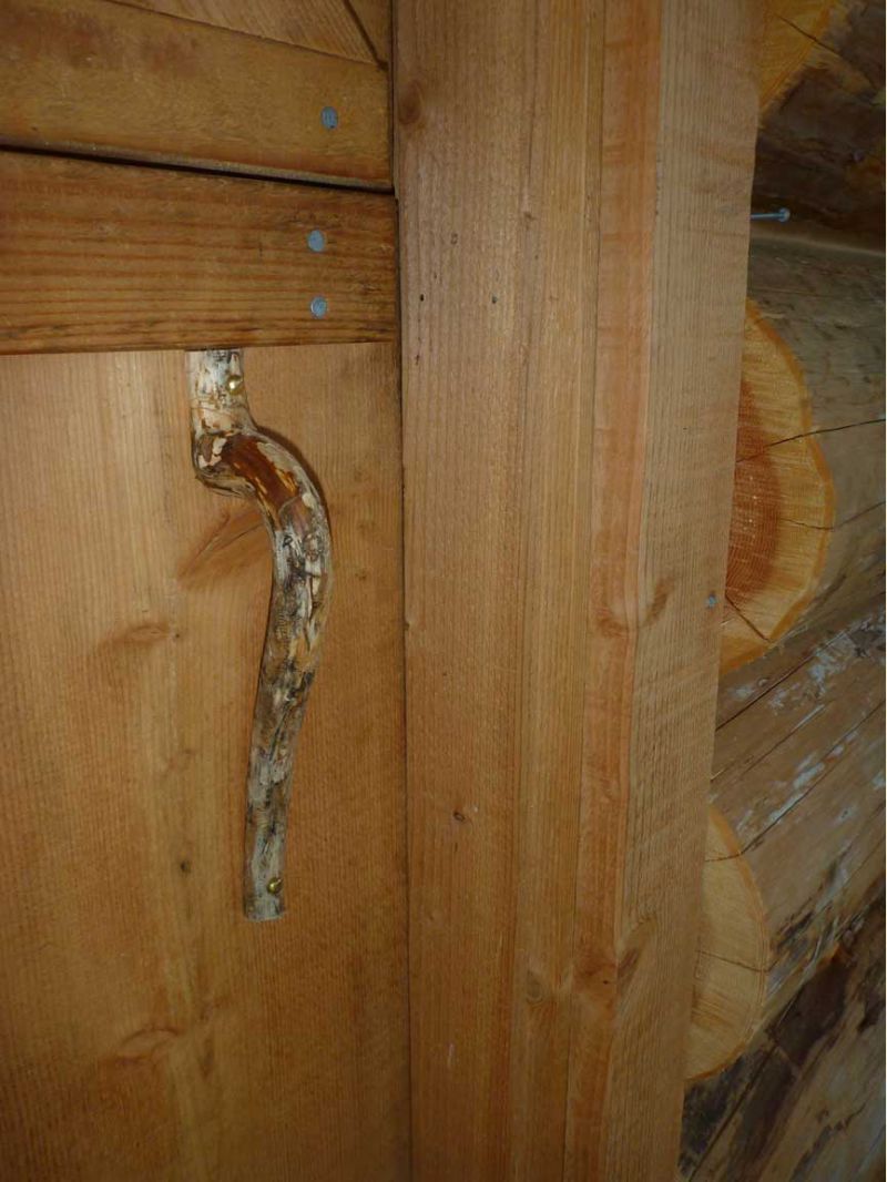

# Posted: 8 Aug 2011 12:04am
Installed a front door handle
Door handle
Door handle
Montanan
# Posted: 8 Aug 2011 12:22pm
Love that door handle!

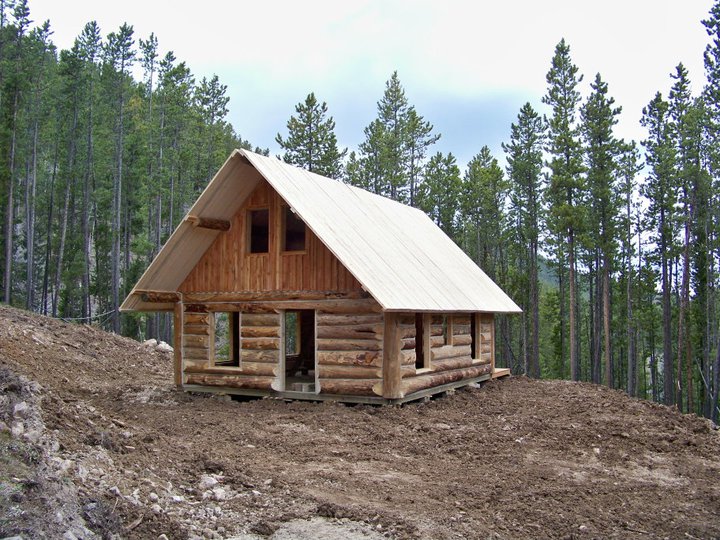

# Posted: 21 Sep 2011 12:17am - Edited by: toyota_mdt_tech

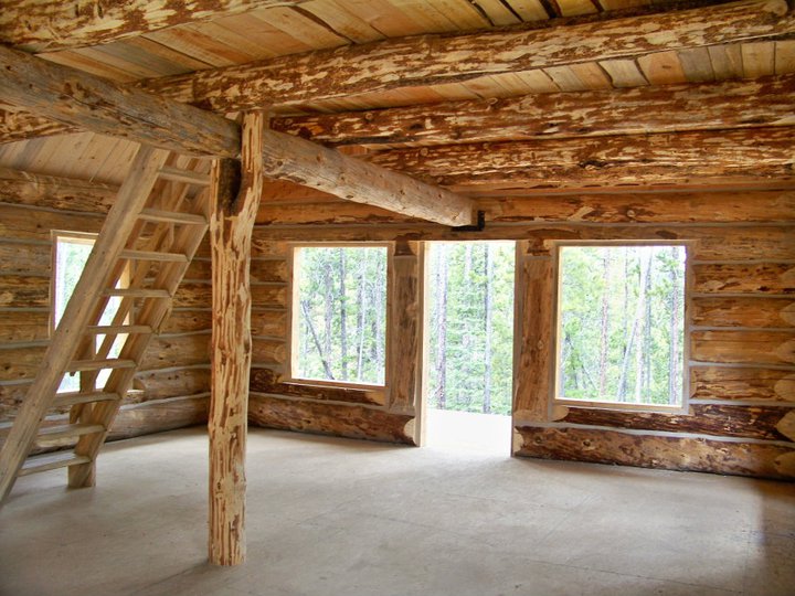

Montanan, your cabin corners are like nothing I've seen before. Any photos from the inside of the corner. Interesting, looks great, but I bet it sped up building time.
Tom, love your place too with the saddle notching.

# Posted: 25 Sep 2011 12:06am
Quoting: toyota_mdt_tech
Yes- it's a technique the builder uses because they specialize in small cabins that they build at their facility and truck to the buyer's site. Since ours was too large to move as one piece, they build it with those corners so they can dismantle the shell into 4 walls and the roof panels, stack them on a truck and drive them to the site. So each wall is structurally sound and then they bolt them to those vertical logs at the corners. It's pretty cool. I'll see if I can find a good photo of the inside corner.
Montanan
# Posted: 25 Sep 2011 12:13am - Edited by: Montanan
Here's a decent one:
Oh, and it took 7 months for the builder to build the shell at their facility and then dismantle it...once they delivered the pieces to our site, it took 5 days to re-assemble (from site excavation, to pier installation, to complete shell.) We were impressed.
Interior corner
Interior corner

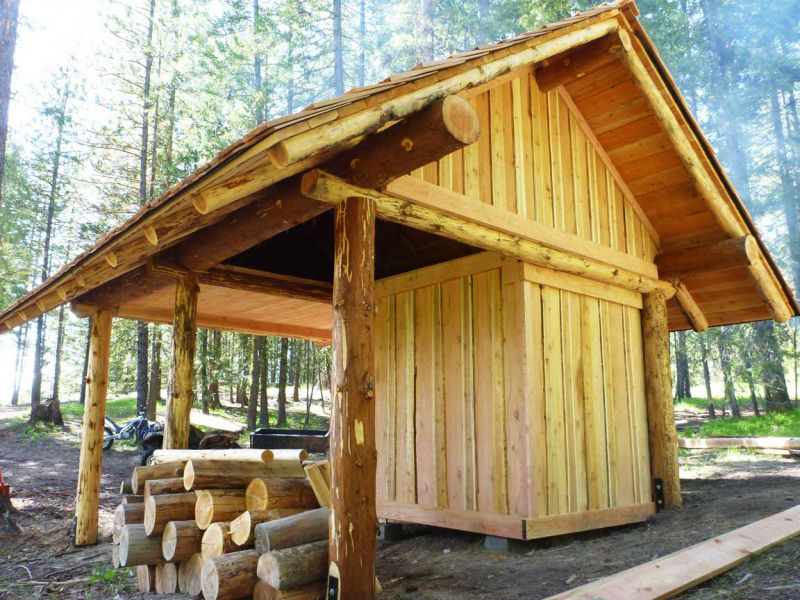

There is no closet space. The cabin is small ! It gets pretty messy after a few days with a family of 4. It would be nice to have a little attached storage. It's built to be a small retreat "under 200SF" for 'farious reasons' ... ;-) I have an outdoor wood-shed, that provides cover for a snowmobile and firewood with a 6X8 foot storage room for some stuff.
Add-ons to this classical type of log cabin is a hassle. You have to wait until all the log-settling is done (several years). And whenever you see Log cabin with (later) added room it's always built with boards, never log-construction. Montanan's log home is built using a different style that CAN be added onto. It would be more orderly to discuss that other type construction style in Montanan's cabin thread.

12x16 Woodshed with 1/4 enclosed storage area.  Strange colors by sun shining thru smoke.

# Posted: 27 Sep 2011 03:33pm
Love that woodshed/snowmobile storage area! We're planning to add something like that next summer. We have the same issue with lack of storage space- definitely going to need some outbuildings.
