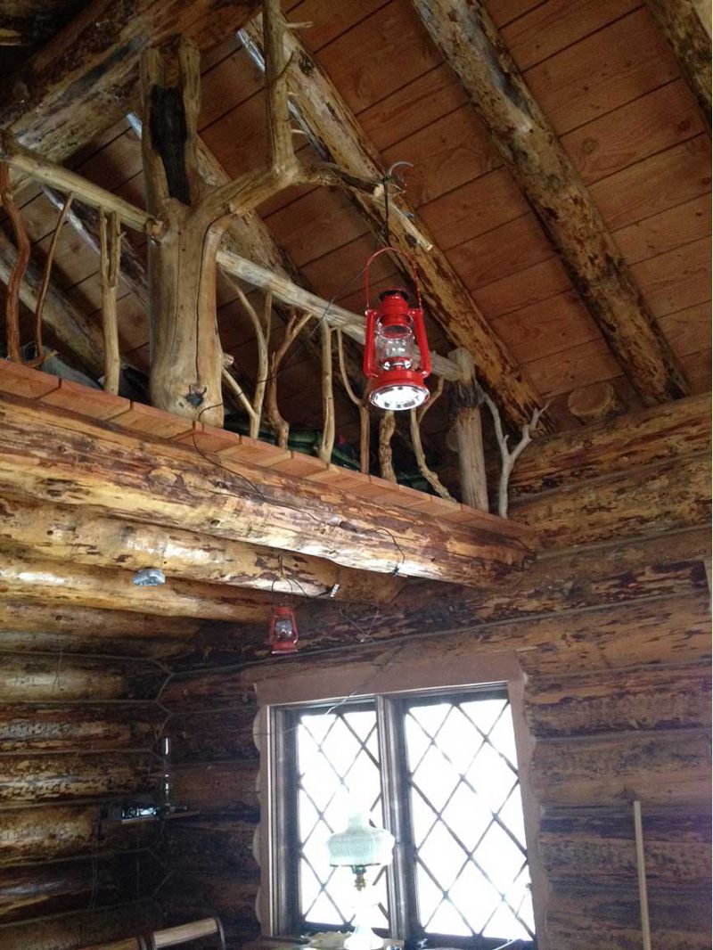

Hung my LED electrified lantern from it's intended location, the railing certerpiece. It only consumes 6.5Watts, and BRIGHT! Very nice light, (2900k) similar to halogen. The little "3W" lantern is in the background, and wiring is in the "rough stage". There is also a battery-powered LED puck light in the photo, that's coming down. It has that hospital-blue color LEDS, I don't use it.
It has a tiny 1/2watt "flame" that makes a nice nightlight. It's about half the light of an actual flame.
wakeslayer
# Posted: 18 Jan 2012 03:41pm
Nice. I love that railing. That center branch is sweet.

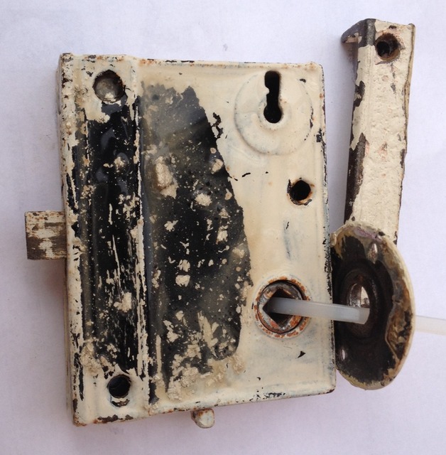

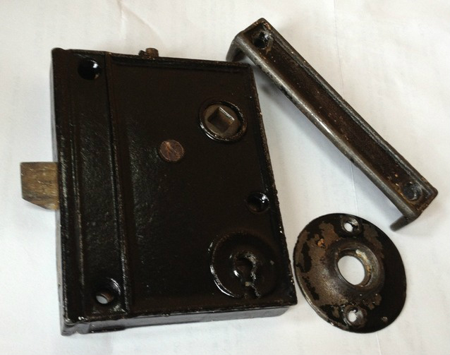

After a year and a half (no latch) I finally found the lockset I want to use. It was covered with latex paint, which was surprisingly easy to remove. The soap took the latex off, and left the original black paint nice and shiny.
Here's what dishwasher soap did to the painted lockset, soaking just 10 minutes in 50/50 dishwasher gel + water. Then scraping off the softened paint with my fingernail.Basically it has to clean your dishes by "just splashing". It's mean stuff, be careful with it. Don't use diswasher soap on your car! Lockset painted
|  Dishwasher Gel / Paint remover
|  Lockset stripped

That door is beautiful and so is the latch. Nice job!!!
