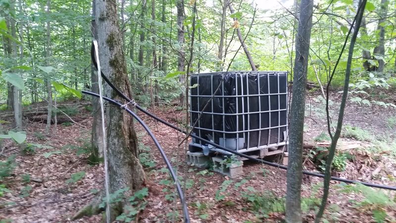

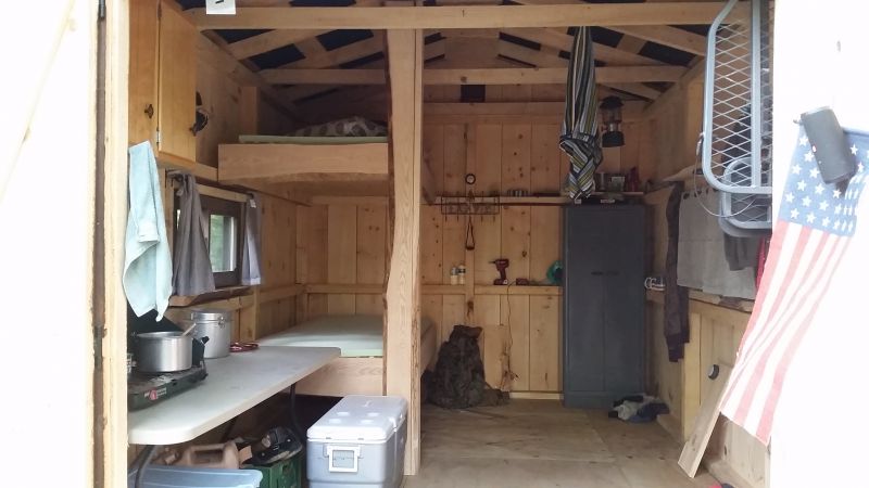

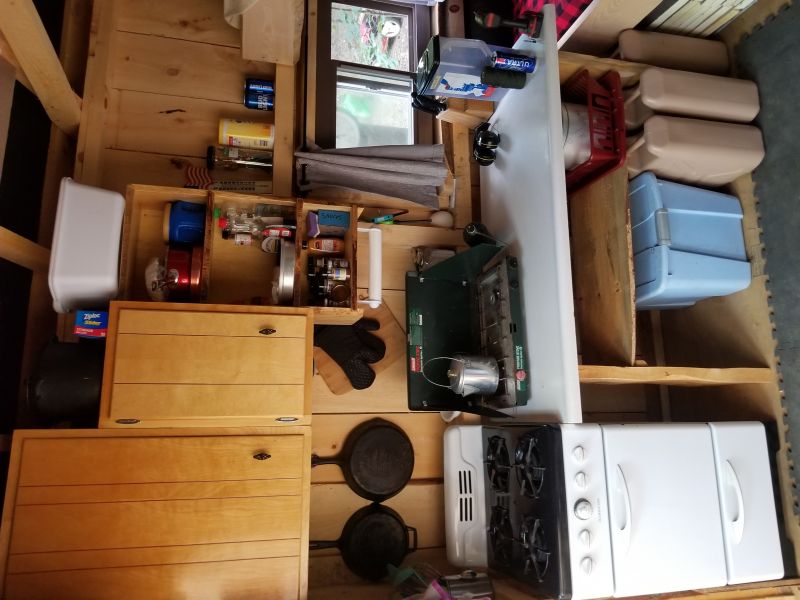

 A big double 3 day weekend at the shed this past weeks.  More stone delivered, wood shed built and semi filled, burned a brush pile, got the water pump working and the IBC tote filled.  Its pumping at 7.5gpm into our tank, 35min on the generator and that should be enough water for half a year.  Got a bunk bed built out of beatle kill ash i milled.  I highly recomend the 6in foam mattresses walmart has.   And...we have a hot shower with a half built shower stall.  Lots of work for one guy and two dogs.
 I have to drive to town, about 30min to get the wood chips for around the cabin.  I also placed a tree stand on state land and scoped out a spot on my own property.

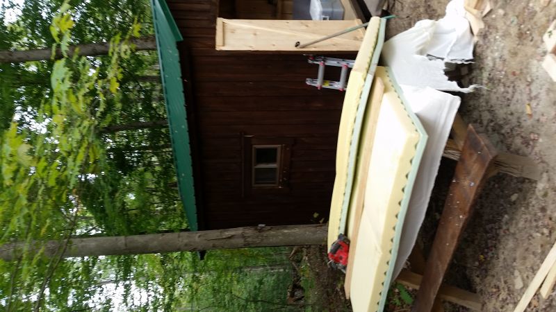

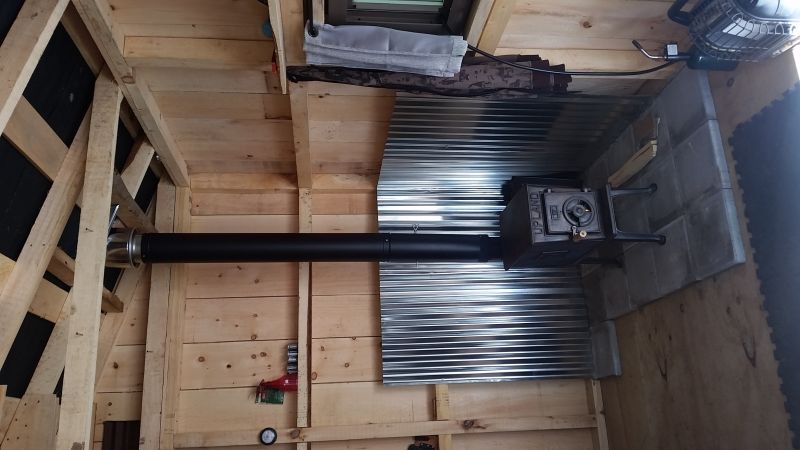

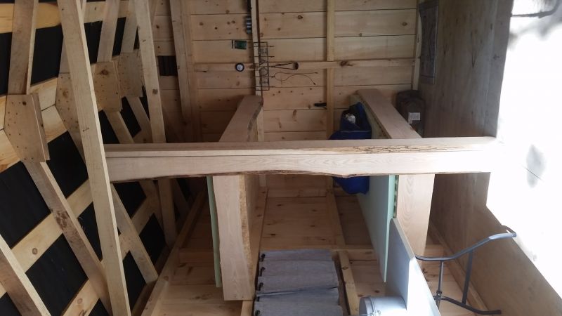

 Spent the wekend at the property again.  Got the wood stove mostly in, it still needs a heat shield for the stove pipe. Worked on the shower stall a bit more, put up a ladder stand and cleared some more tree tops covered in pricker bushes.  We also burned a large pile of brush. I got rained out for half the weekend but overall not a bad weekends work was done.

 The ceiling is 70* insulated with foam board that i cut to fit between the rafters and spray foamed the cracks.  That was one of the things i can do mid day durring hunting season or in the rain.  The floor has foam tiles and im not going to insulate the walls.

 The Upland is a nice little stove...dad had an Upland 17 in the house.
| Brettny Member
 | # Posted: 2 Nov 2019 10:51am Reply
 Thank you.  Seams like a well built unit.  We found it at a local thrift shop

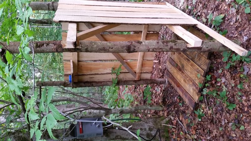

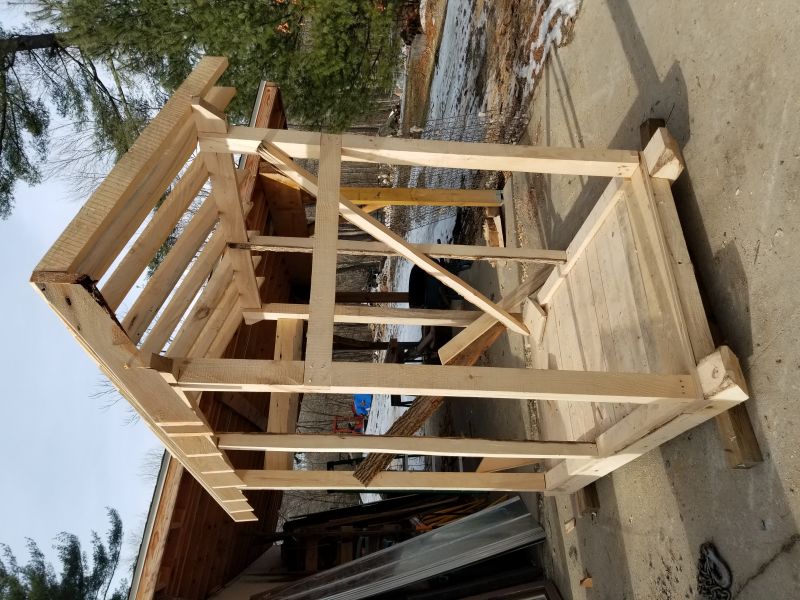

 No real property updates but a local tree company did drop off a bunch of pine logs for me.  Some where 7ft long and not to useful for the future cabin build.  Between short logs and the large pile of slab wood I have laying around I decided to build a small 4x6ft 7ft tall hunting shack.
 The runners are 7ft long 6x6 ash that's notched into cross braces and through bolted.  The floor is scrap 1in thick from those same logs that I made into ship lap on the table saw.  The idea is that in the future I will build legs for it so a strong base will be important.

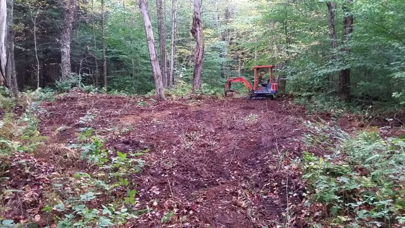

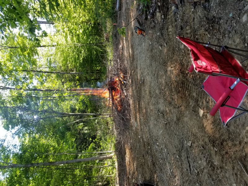

 We have now located and cleared a cabin site along with removing any trees that could be a future issue.  Removed the stumps and graded off the area.  This past weekend I also burned all the brush.  I also brought up a water tank that I'm going to burry under the cabin as our plans for a water source has now changed.  We found a spring on the property that I improved and even with very little rain its producing 5gpm.
 We now have a cleared build site that I will leave to the mosquitos until fall.  It should be well compacted by then.

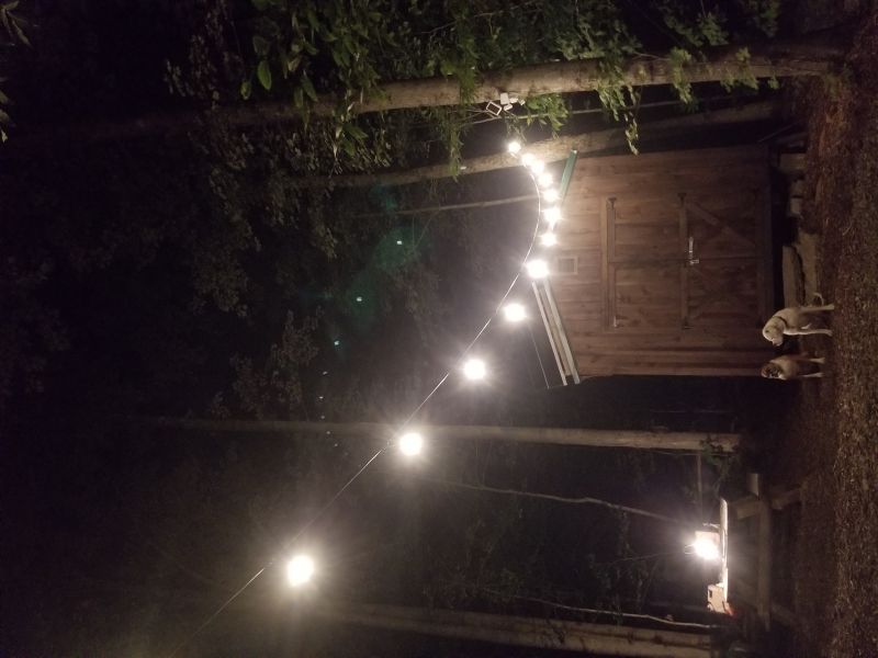

 The mosquitos finally gave up enough for me to have some cabin time...they own the place for the summer.  I was able to get 470w of solar on the roof, 40a CC, 1200w inverter and 30a iota charger all hooked up and running a mini fridge.  I also found these LED string lights on amazon that only use 30w and light the place up really well.
 I spent a few hours moving gravel from the road up our 700ft driveway so now have a gravel covered driveway.  I also installed our vintage stove and a section of countertop...gone is the plastic table.
