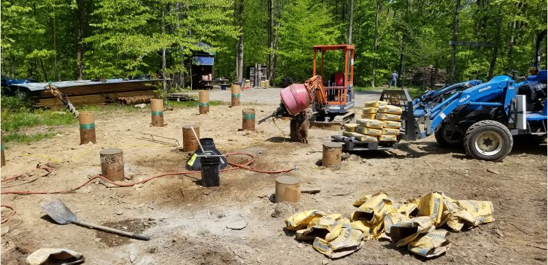

We actualy made the 3hr drive, tried to auger the holes with a auger on the mini ex but failed, then dug every one, got them inspected and filled with concrete and rebar in 2 days. I also did a rough grade of the area around the tubes and dug a swale. It was dawn to dusk both days with just my nearly 70yr old father and me.
What really helped was mounting my electric mixer on the bucket of my mini ex and useing my tractor to move the concrete right to where the mixer/hole was.

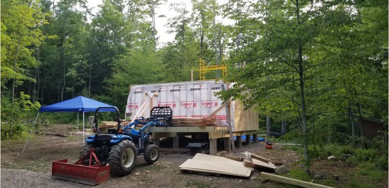

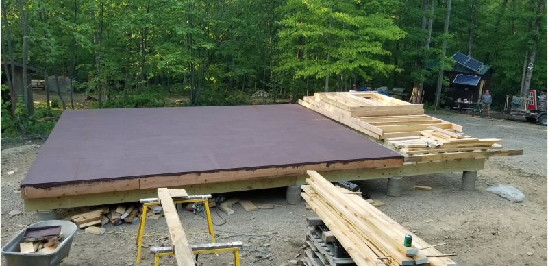

# Posted: 28 May 2023 07:41pm
Sub floor on, 24' walls framed and stacked off to the side. It's been a very productive weekend. Tomorrow we cut more studs, clean up and head home.

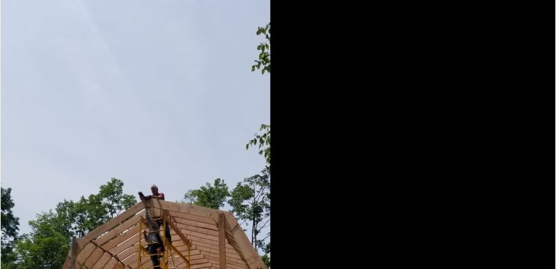

Dang! This was apparently well planned out before starting! Did you have the roof trusses all pre-cut andvready to assemble? Wall studs pre-cut as well?
Way to go, great progress!
# Posted: 14 Jun 2023 08:24pm
Yes. I have been planing this for what feels like years. We built the roof trusses in half at home. We cut all the wall studs and layed out the top and bottom plates the weekend we did the floor joists and sub floor.

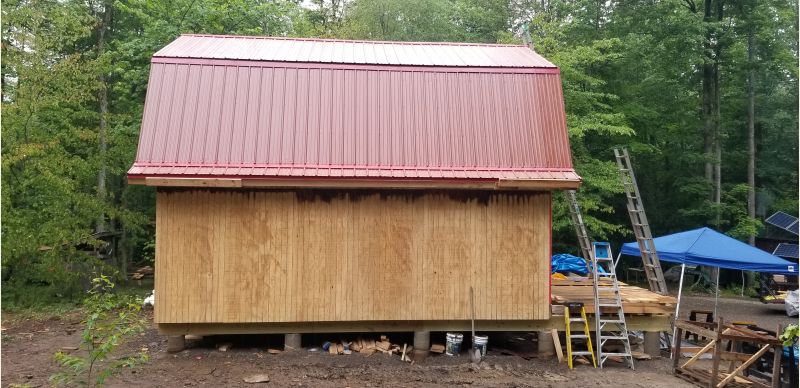

We are useing metal roofing. We are starting that today.

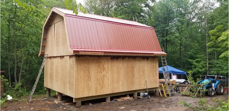

# Posted: 16 Jun 2023 07:29pm
Got the roof 98% done just as the heavy rain came in. This was 7 days of 12-14hr days but we started with the sub floor on. We have had about 2 days of good solar gain the whole 7 days so having a generator with a battery charger has been key

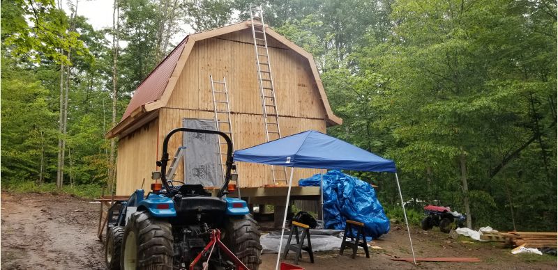

# Posted: 17 Jun 2023 11:06pm
Day 9 at this point I think.. roof is totally done, front door on and trimmed. We spent the rest of the day cleaning up a wreck of s build site, stacking lumber, packing, drying everything and we will be headed home tomorrow morning. It's been such a wonder full mental and physical push for my father and I. We are both happy to have done so much and things turned out looking great.

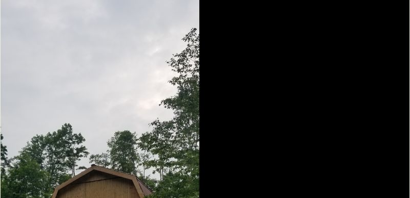

# Posted: 18 Jun 2023 01:52pm
Sorry I forgot these forums dint do vertical pics

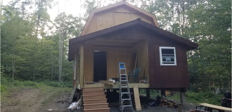

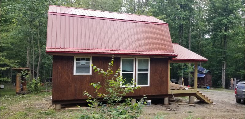

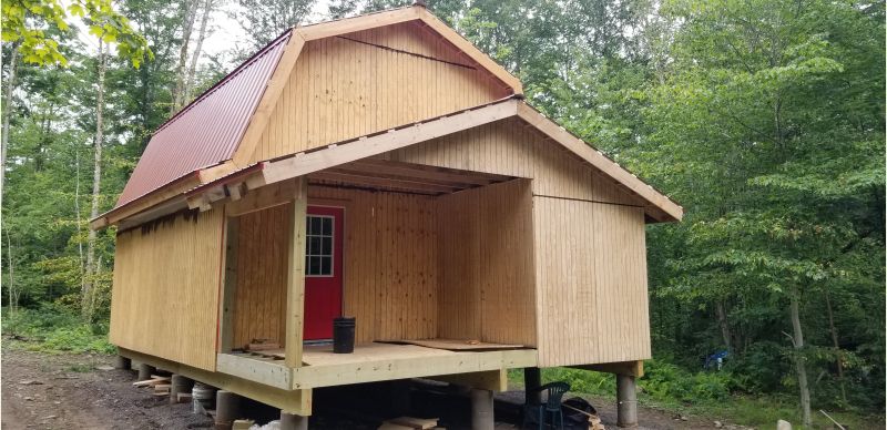

Went up for a 3 day weekend and got the porch roof on and bathroom enclosed. Next is railings, stairs and decking. After that I'm going to stain the exterior, put the windows and back door in then schedule the framing inspection.

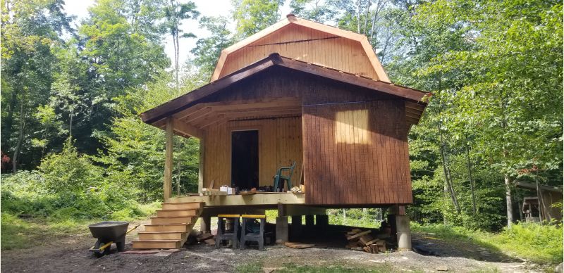

# Posted: 1 Aug 2023 07:35pm
Spent a weekend putting front stairs in, staining the siding and putting windows and the back door in.
# Posted: 1 Aug 2023 07:38pm
We also did alot of odds and ends like putting collar ties up in the 16ft ceiling, re working some interior walls and cleaning up the job site.
