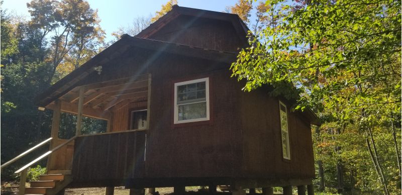

The stain is TWP 1500 series dark oak. I sprayed it on and back brushed every inch of it.

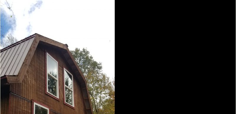

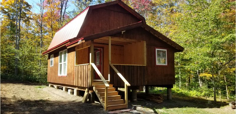

Got some more exterior done. Window trim is mostly flashed and installed along with all the exterior siding stained.
I used permachink lifetime accents in garnet for the window trim stain. I wouldnt suggest it. I dont see the stuff lasting to long and it cost $116 a gallon.
Also did alot of exterior finish grading and grass seeded the area around the cabin.

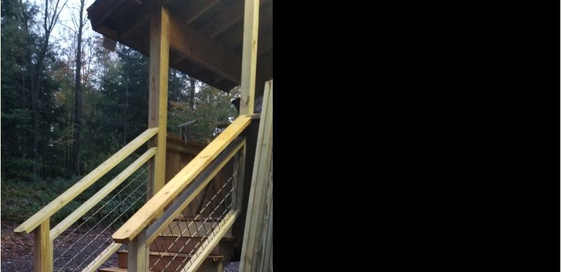

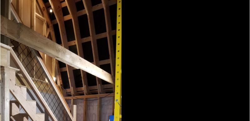

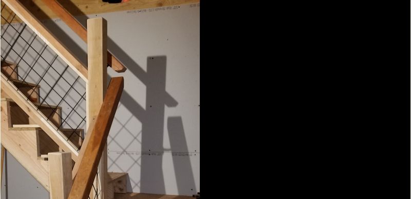

Been up a few times. We now have finished exterior stairs along with all the window trim on. We also got the interior stairs nearly complete, but with temporary stair treads until all the painting and drywall is done. The hand rails and guard rails are black cherry with a ash boarder around the black metal.
We also passed our framing inspection. We are now in a bad dash to get the wood stove put in before it gets really cold.

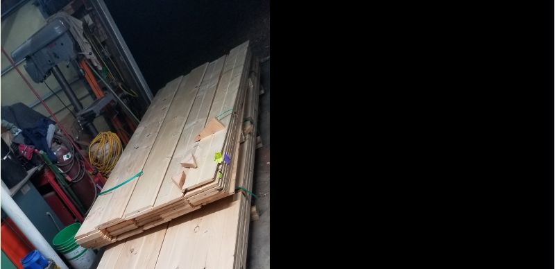

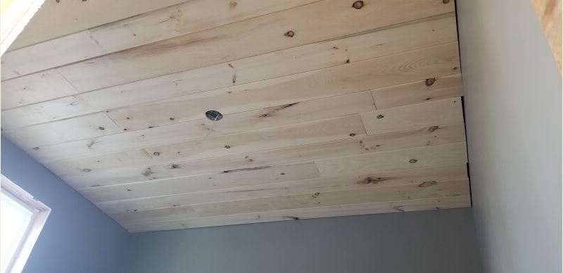

I'm going to have my work cut out for me in the coming weeks. I'm doing 1x8 and 1x10 tongue and grove in a staggered pattern. I'm going to HVLP spray this at home and bring it up to install.
What are people useing for a black colored backing to tongue and grove? I dont need a vapor barrier...maybe landscape fabric?

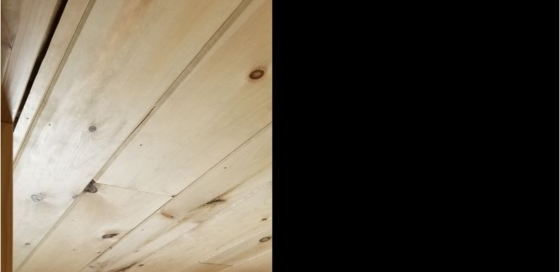

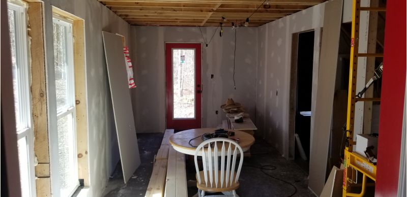

Was a busy weekend here. Picked up 12 sheets of drywall, hung them and did one coat of spackle. Also did the tongue and grove ceiling in 2 rooms and layed down vinyl plank floor.
I decided to not put anything behind my tongue and grove. Where theres large knot holes I have been just stapling some black roof underlayment.
