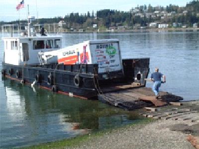

 Barging materials is a great option out here, however to load and unload a barge by hand with 2 people would have been a really expensive way to spend 2 back breaking days.
 So I came up with the bright idea (ha) to rent a moving truck, load it with everything we would need to build and furnish the cabin, put the truck on the barge, take the truck off the barge onto our beach, drive it back up to our site, load it back onto the barge, and then off load back onto the main land. Nice idea I thought.
 Things to remember if you ever think that this is a good idea (though you are all likely much smarter than me on this esp. if you are boaters) With the size of a 5 ton moving van, the angle of the ramp, and the lovely soft sand, getting on and off of a small barge was the most challenging, difficult, and dangerous thing I was ever stupid enough to propose we try. If it were not for the only person who lives at that beach year round and his 30 year old pick up, we would be the proud owners of a moving van, loaded with all of our tools, and materials which was sitting at the bottom of an ocean.
 To my husbands credit, he has never told me how crazy I was to make him do this. He instead just raises his eyebrows each time someone asks us how we got out stuff over and shakes his head.

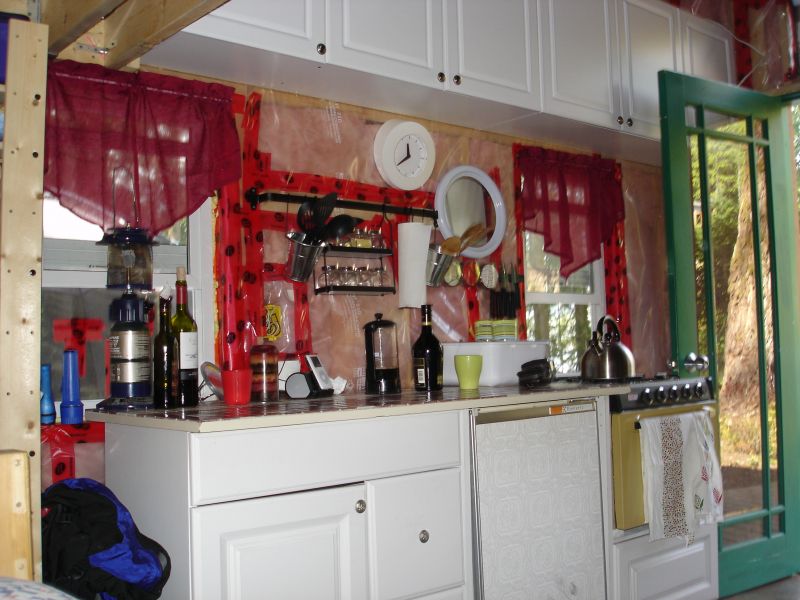

 so about off the grid appliances on a shoestring.
 I mentioned that Craigslist was our plan for picking up everything we needed on teeny tiny budget right.

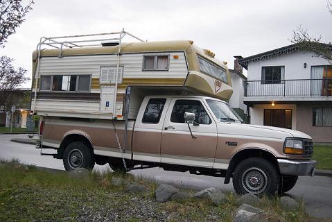

 So with our little guys at home, it was important to us (me) to have cold milk etc. which means a fridge, and the means to bake a cake because what is a cabin in the middle of an old growth forest without a warm chocolate cake to attract the bears right.....(don`t ask, I assure you my husband already has gone on.....and on......about my ideas around needs for our lil bush wacked retreat)
 So we found a late 70s harvest gold model vangaurd, pick up top camper on craigslist (don`t know who craig is but I owe him a big kiss!) We talked to the current owner and paid his 300 dollars, plus an extra fee to allow us to take it apart, pull out the appliances, oven, burners, lights, windows, regulators....ah heck, we took everything that a sledge hammer, saws all, and assorted tools would allow us. The extra fee was to have him haul the scrap metal to the yard for us.
 Cost 350.00
 Watching your two little boys (2 and 7) with jean and no shirts helping their dad (wearing a wife beater, jeans, with a sledge hammer in hand) dismantle a camper...priceless. Looked like something out of the beverly hillbillies. So I not only got a great laugh and memory, but I also got my fridge and stove which are in perfect working condition:) and later loaded on the moving van of my hubbies discontent:)

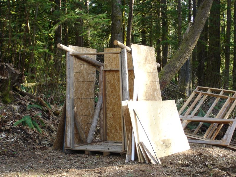

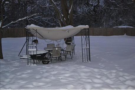

 On storage of your things before you have your cabin built.
 Well, by the time we got all of our building supplies, furniture, wood stove, lovely lovely appliances, and boxes of glasses, dishes, tools, etc. over there it was already August. (why I needed dishes at that point I have no idea, but there was room in the truck and I figured how often would we be barging over a truck) It takes a lot of time and planning to make so many mistakes over a summer! No time to get a cabin up to lock up for 2 people with no heavy machines, (hell, some days I would have taken light machines), two small children, and very little idea of how to build a birdhouse.
 So what did I determine was an acceptable storage unit to house all of our valuables in the mean time..a garden gazebo. Heck, that has to stand up to a BC winter right...I mean how much damage can rain do....didn`t count on the fact that we would have the worst snow storms of 100 years. So we packed up our belongings into large tarps at the end of the summer and wrapped them like a great big Christmas package with a garden gazebo over the top.
 So I don`t have a picture of what the gazebo looked like 4 months later, but it was something like this:
 Luckily the next summer the building began and my harebrained ideas were just warming up:) the next few posts will have the actual cabin pics attached as we moved through the building process.

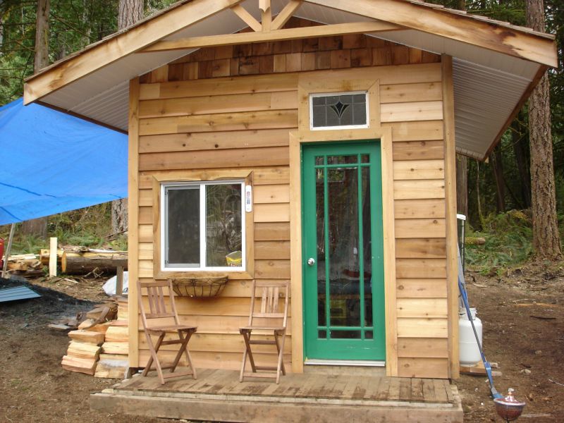

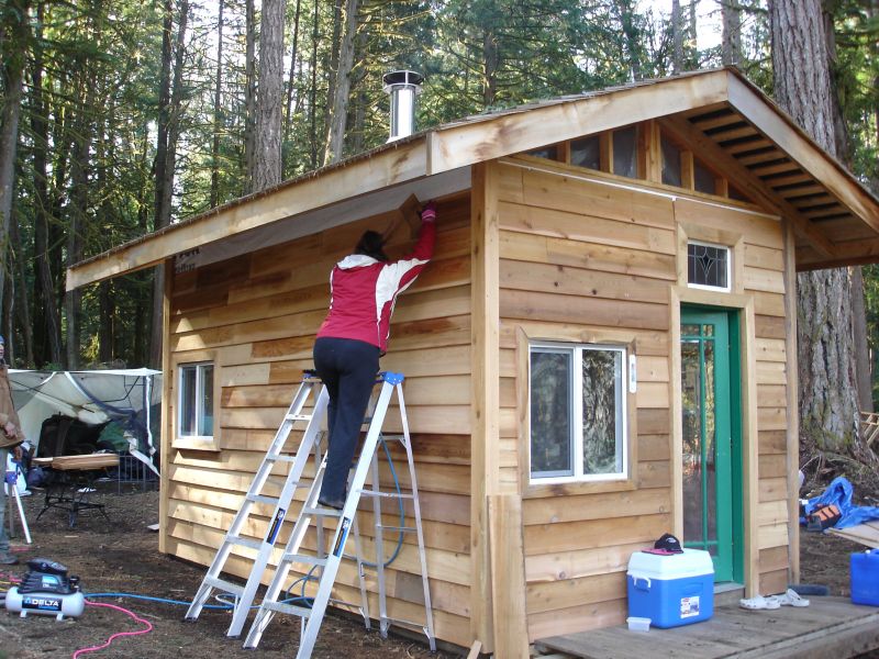

 To be or not to be.....nope.....To permit or not to permit that is the question.!
 So here we are at year 2.
 The age old question of to permit or not to permit came up. I called the district and they said, well if it is close to 100ft they won't bother you....but if you want a permit, the septic has to be installed and the health ticket issued before the bylaws department will issue a permit. Well in beautiful BC the septic installers are also the regulators so the prices in the past few years have increased X 3....really??? That is like giving the fox the keys to the hen house! anyway long story short we didn't have the 30k to get the septic in so made the determination that we would try to keep it to 100 ish square feet....I guess 160 isn't that far off!
 The inspector flew over to a near by logging camp and noticed that there was a nice new roof on a newly cleared piece of property....opps:) ...he asked a neighbor how big the cabin was and the neighbor said....well, I haven't a complaint about that lil old cabin and given that this is a complaint driven system...well, he hasn't been back....yet!
 Usually they send a warning, make you apply for the permit and charge you double for your error of an early start for your permit costs:) So we have decided to ask for forgiveness if we get that notice tacked to our door:)
 So back to building.

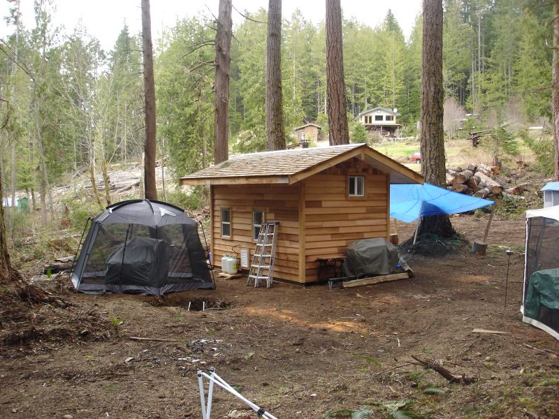

 Day 1
 We selected the spot and tried to level the land with a shovel and a quad. There is only 1 "cabin" that overlooks our property. The owner is one of the guys that cleared our land. He and the other two land clearing guys were sitting on the deck, drinking a beer and watching us. They are all builders by trade so they must have had many giggles watching us in our inexperience. Now if we were not in the middle of the wilderness with no electricity, I am sure that we would have been posted on you tube with some colorful descriptions about why city folk should not be allowed in the wild with power tools.
 They let it go on for about 5 hours before strolling down to our site and asking if we needed some help....uh, yup. So after some back and forth we decided that what we needed was someone who had some skills that we were lacking, and we hired one to be our PM, and teacher, and we would be the students and do the work. Except the roof which we contracted out to the three of them.
 Do I think that we could have done it....yes, and it may have made it through the winter....maybe.
 But the real question is can we do it now and the answer is yes without question. We have learned so much through this process. So in the end, we did the framing, they helped us put it together, and they did the roof and installed the wood stove. We did all of the finishing, wiring, doors, windows, insulating and inside work.
 So with their help in 6 months at the end of year 2 this is the start of base camp.

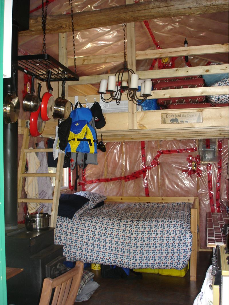

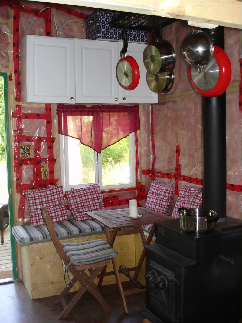

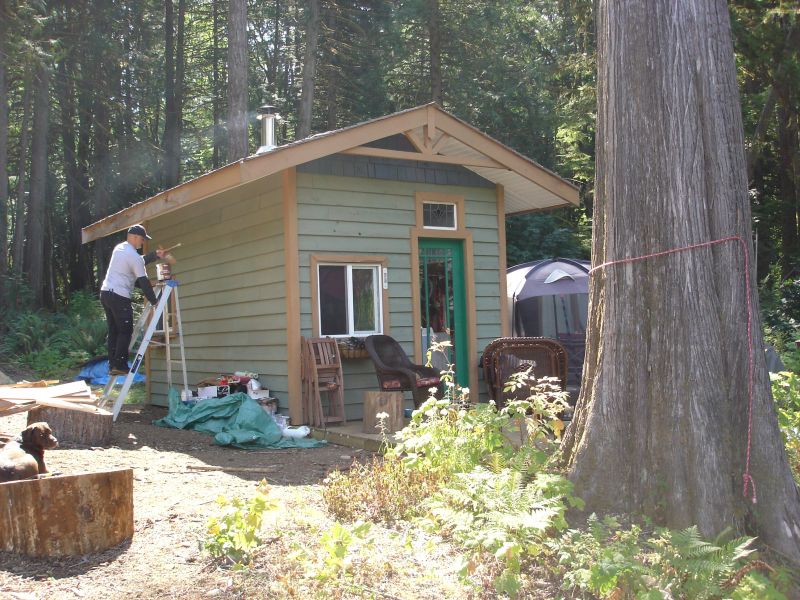

 So year three we started the year off with a warm and dry roof and walls around us!
 Yay!!!!
 This year, The Loft. So I went to the trusty internet and found the formula to calculate load to ensure that we used the proper size boards for stability. We also wanted to install cupboards, a front deck, and build in bench seats around the table that would hinge at the top that that they would double as wood/paper storage for the stove. We also wanted to stain the exterior to make the wood last.
 And low and behold by the end of year 3 we had it all complete. Plus some extras! We wanted to build a woodshed. The "guys" offered to help. Well we now have a woodshed of gigantic proportions (bigger than the cabin to be sure) but we decided that when all of the building is done, we will make the half of the woodshed that is not full of wood into the spare bedroom:)
 We also brought over Bessie. Our 30 year old pick up truck that is Giants Orange and White (was the half time give away in 1980).
 So at the end of year 3 this is what we looked like:

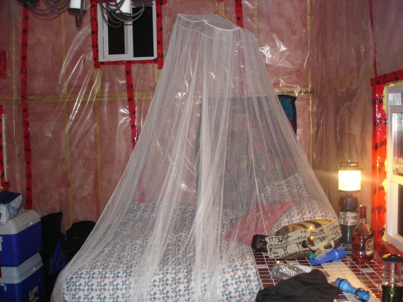

| nicalisa Member
 | # Posted: 4 Apr 2011 09:44pm Reply
 and more pics from the end of year 3:)

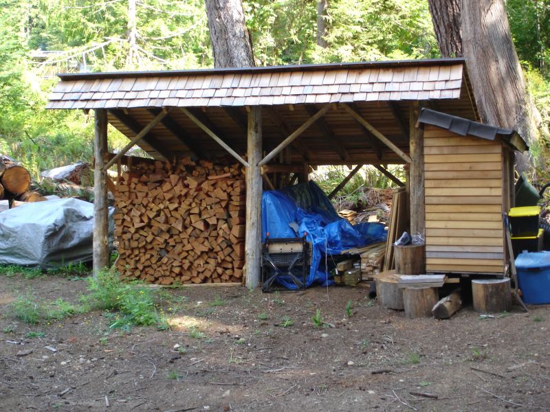

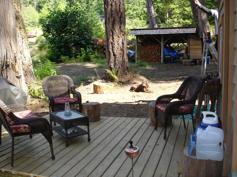

 Quoting: Anonymous I love everything you have done. Great deck for the wine I saw on the counter. Great woodshed. What are you planning for the interior walls.
 Can't take credit for the woodshed except for writing the check, but love all of the split wood that they installed inside of it! When we build out the extra room on the empty side of the shed, I will post the pics. I love the idea of a guest room.
 For the interior walls we picked up scads of free paneling. Some Great....some not so much. We have decided to use that and paint over it for the interim (want to keep the creepy crawlies on the outside of the cabin as our friendly 4 and 8 legged friends keep finding their way through the vapor barrier and scaring the heck out of our kids...they are a bit big to be honest, even for me). Our plan when we have the time is to use some of our cedar and fir, and hand saw the trees to a rough pattern and notch them together for a cool tree house look.
 the deck is great for wine:) We also keep Rum and beer stocked as it is a type of currency out there when you need to barter:) "hey there! come on over for a beer and look at our loft to see if we really missed the boat on our calculations" Seems to work so far! And if they are not in the mood for a beer or rum (rare:), the bartering of TP works too!

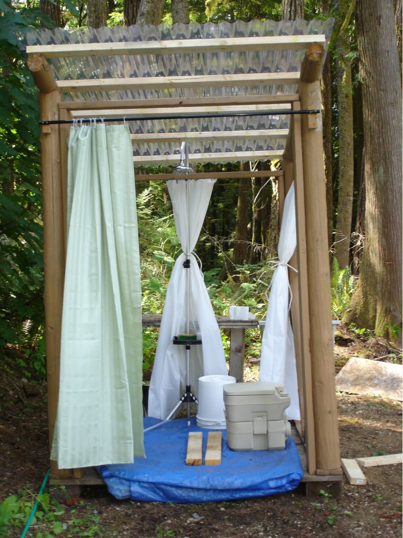

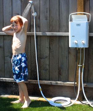

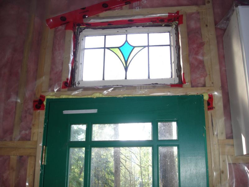

 So on hot water and washroom facilities:
 We have found the most amazing hot water propane on demand system....It is called an Ecotemp system. We went with the L5 model as it is going to be a camp shower, but if you have a bigger system need, there is the L10 model. The best part is that it needs no electricity, (D batteries for the starter...and we are looking for solar rechargeables) and cost only 129.00!!! we had it delivered to a shipping place in the states and drove down to do our shopping and picked it up on the way back. So cool!!
 I have attached a picture along with the current shower/potty (and the one from year 2:) We have come a long way babe!. We are going to make this the shower only and we have a panelized 4ft x 4ft building for our sunmar composting toilet. We got it on clearance at home depot....a friend of ours happened to be there one day and it was sitting in the middle on an aisle (apparently a return) with a 75% off sticker on it!!!! yay!!!! I told him to sit on it (no pun intended) until I got to the store, so for less than 500 dollars we got a composting toilet, that is both electric and non electric with the modifications, fan and solar panel we added.
 The last pic is of the 100 year old stained glass window that was a must have......don't say it.......my hubby already did!!!!
