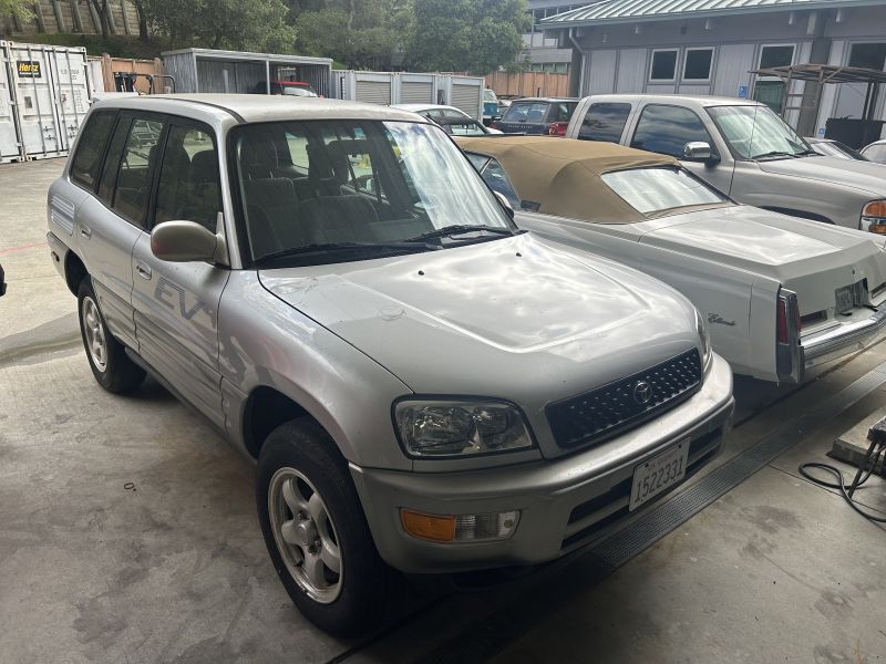

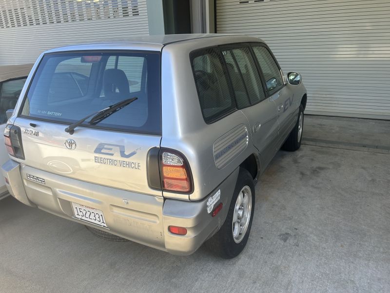

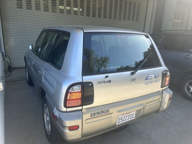

Someone donated a car to my auto shop class. It’s a 2003 Toyota RAV4 electric. Doesn’t run they say, needs new battery(s), NIMH. They said I can have it. Immediately I thought hey, I have a bunch of new 100ah LFPs!
Obviously different architecture…but..
TMT, ever play with these?

If you get your hands on that vehicle be careful. The Toyota Rav4 hybrids use a 245 volt battery pack. There might still be enough energy in the battery pack to kill you. 100 MILLIamps can kill; even less depending on assorted factors like general health of the individual, how or where the current enters and leaves the body and so on. Perhaps the school did all the right things to disable or disconnect the high voltage battery. Perhaps the battery is stone cold dead. Or not?

Thanks guys, no wonder the shop class doesn’t want to mess with it. My brief online checking tells me this is a ‘stage 1’ RAV4 EV, a few made until early 2000s, then reintroduced a decade later. It may not have the battery power of the stage 2s. TMT is a Toyota tech member on here, he’ll know more if he sees this.
Furthermore these early ones were 2wd only, which sours me as I need AWD for the cabin. I did see ads for complete battery jobs for about a grand. Wouldn’t be a bad deal to have a ‘new’ used car for a grand, if only it were awd. I’ll keep checking on it.. I did get a quick look at it, apparently a doctor donated it to the school and it looked very good.

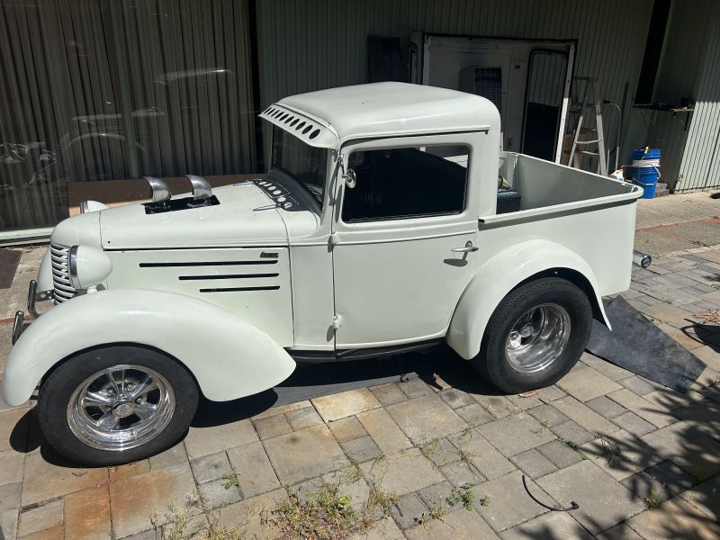

Mean time, I got my Bantam running while killing time at the grid. Ya know, it’s only 10 ft long and very light. I could probably fill the bed with my LFPs, take the plugs out and drive around just on the starter! Or yank the flathead and put in a big electric motor.

That Bantam is SO Cool
# Posted: 12 Apr 2025 08:28pm
Yeah just peeling the tarp off got me going to work on it. Too bad it’s just rotting away there. No inside parking. I could build a covered area there, or move it to the cabin shop..

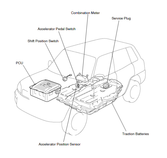

Paulz, the service plug interrupts the battery series, splits it right down the middle. The only voltage potential is now inside the sealed (but serviceable) metal battery compartment and only half of the voltage.

Pal, as far as EV, first one was 98 in the repair manual.
Here is the component location. I suspect the service plug is under the rear seat. With that open, wait 10 minutes. Should be good. But we are required to still measure for voltage and have on out leather covered 1000V rubber gloves.
