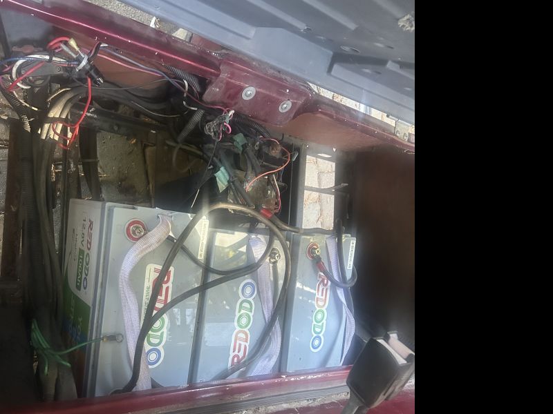

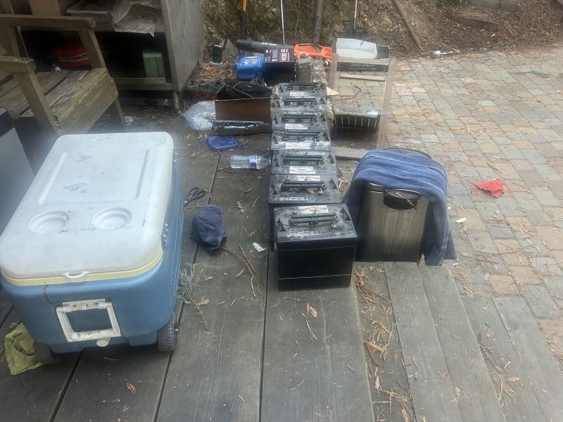

Got this shitbox going. Yanked the 7 dead 6 volt land anchors, 80 friggin pounds each wedged in there. The 3 LFPa, 39 volts in series and 60 pounds total, move it along my cabin deck fine, but having taken it a few yards down the hill i discovered its one wheel drive., spun my way back. Next step is take it down the hill and try climbing.
