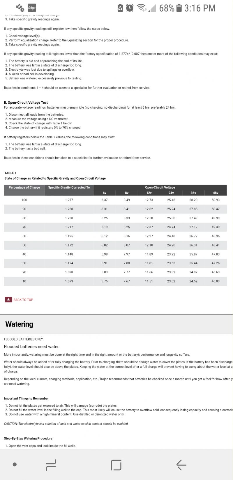

Here is a spec sheet for volts/SOC from Trojans website. 6.08v is about 50% or dead. Can you re work the bank to remove that one and see if the problem still exists?
bc thunder
# Posted: 3 Nov 2021 09:20am
Its 24 volt system, so id need to remove 4 altoghter I think. So no
