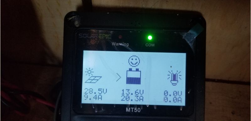

Something else to think about is the loss you may get in in the charge controller. For instance my solar pannels are two full sized 29v 230w. I have never ever seen more than 390w going into the battery. That's full sun and pannels aimed directly at the sun. I only get full sun for about 2.5-3hrs durring the summer, we have alot of trees. I actualy get about the same daily wattage in the winter because no leafs.
Pic is from today. Early november, pannels in full sun but not totally aimed correctly. I'm loosing about 11W to the MPPT conversion. This is a 40a EPever BN series. I would put another pannel on the roof (I have 4 more) but theres no room on the roof.

Brett, I'm using 840watts of bifacial panels, and have seen them pull in over 1kw a few times, but yes I hear what your saying.

Not sure how your panels are configured (parallel or series), but that makes a big difference with Epever controllers. They have so many bugs in the MPPT tracking that series connections are literally unusable. Frankly, my advice would be to throw that controller in the bush. They really are poor and probably the reason you are seeing low numbers. ..
EDIT - Looking at your numbers on the MT-50, you are hooked up Parallel. Those are very poor numbers for even an Epever. Wondering how much cable between the panels and controller and what size!
Again Victron has some good products at good prices. It will outperform that Epever an insane amount. With those panels I would go 2 75/10 (or 75/15). However you could go a single 100/20 and put the panels in parallel. Personally I would use 2 controllers as it gives you redundancy (and slightly better performance). However, that is the boat guy in me talking (you can't just order new stuff from Amazon in the middle of the ocean).
