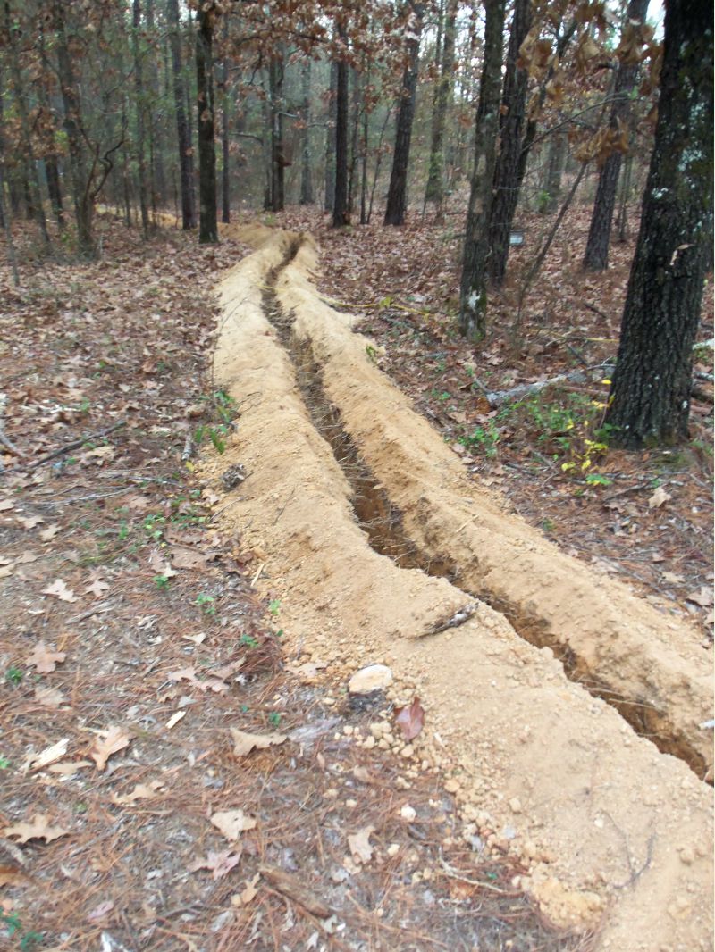

well did some more work on the camp last week.............
started with digging my ditch for power and ditch from well to cabin......
hard digging around all the trees.......

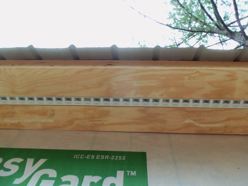

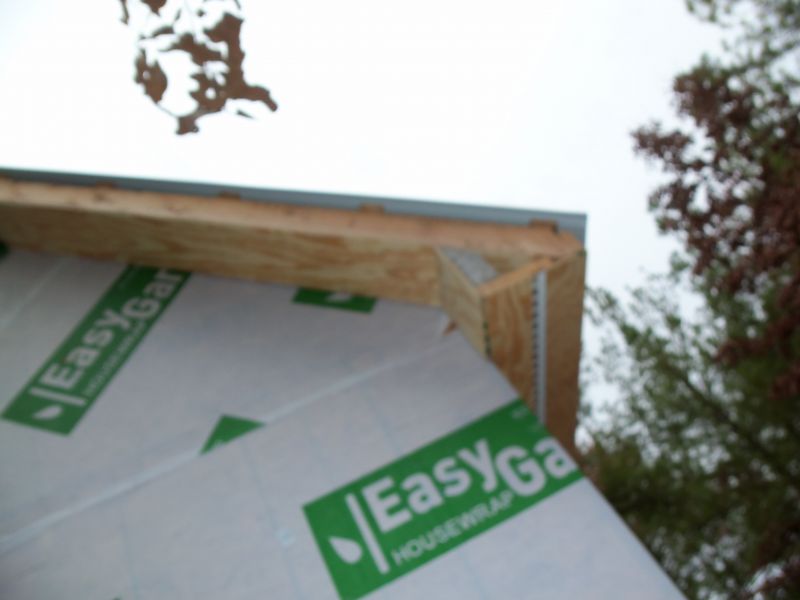

also been working on enclosing the overhang.............
also bought 1 x 8 cypress boards last week for the facial board, will install them over the 2 x 6 this next week.......cypress is GREAT wood but $$$$![overhang with vent overhang with vent](https://www.small-cabin.com/forum/shared_files/uploaded/1010/20621_1.jpg) overhang with vent
| ![side view side view](https://www.small-cabin.com/forum/shared_files/uploaded/1010/20621_2.jpg) side view
