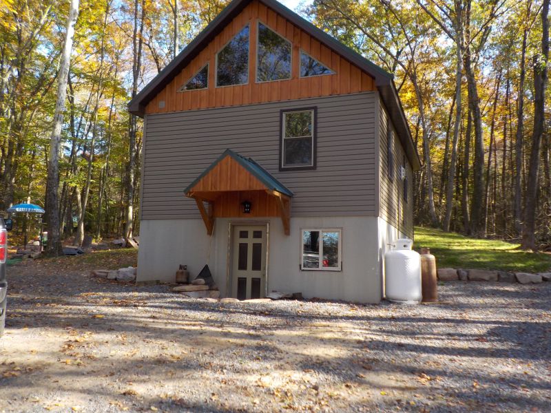

 Exterior complete and ready for inspection
| Shadyacres Member
 | # Posted: 19 Oct 2014 08:44pm - Edited by: Shadyacres Reply
 |  inside
| Shadyacres Member
 | # Posted: 24 Oct 2014 03:40pm Reply
 Final inspection passed. Now time for some serious camping.

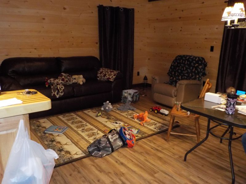

 A few interior pics
 |  Very LARGE bean bag for the loft
 |  Light stand , still unfinished

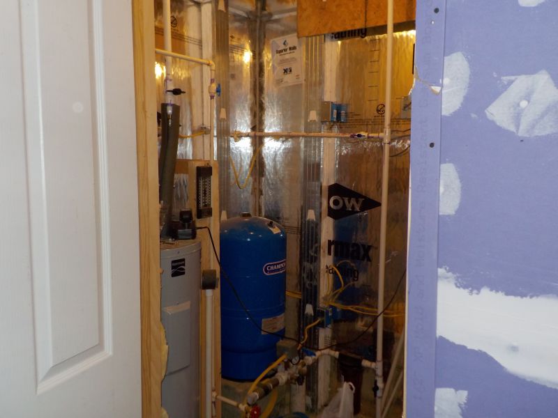

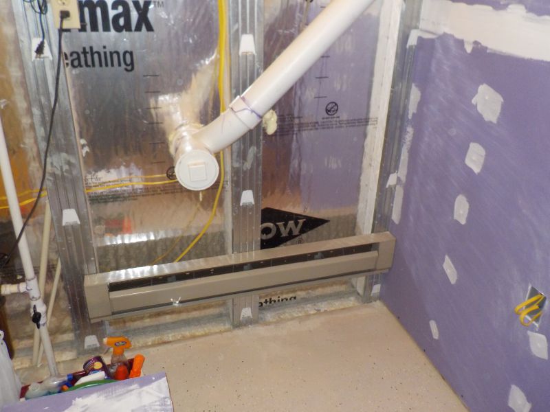

 | # Posted: 3 Jan 2015 10:03am Reply
 I've also closed in an area in the corner of the basement ( 6 X 8 ) insulated it and installed an electric heater on a thermostat which will keep all my water drains and water heater including water tank at whatever temp I want. Right now I have it set at 45 degrees. It is working great.

 | # Posted: 10 Jan 2015 11:44pm Reply
 Room in basement to keep water fixtures from freezing.

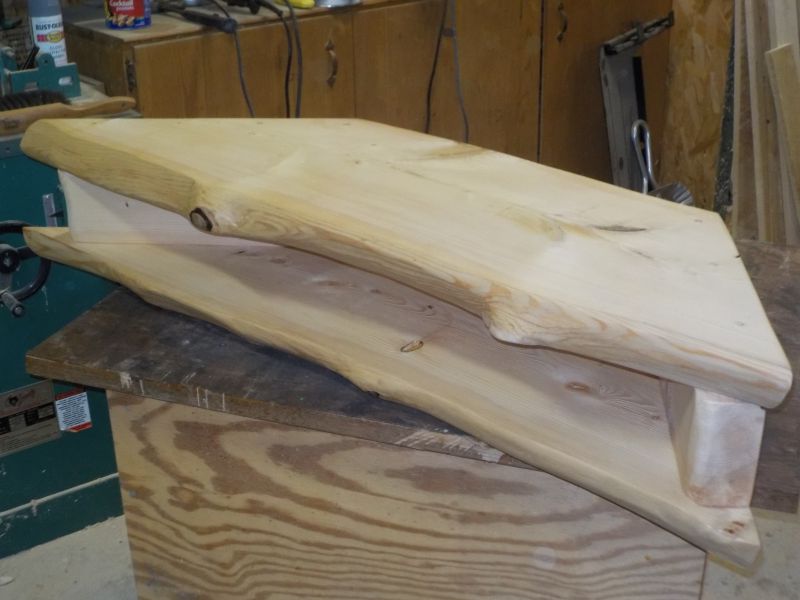

 | # Posted: 26 Jan 2015 07:52pm Reply
 Took off work today because of the snow so I got my corner TV stand done for the cabin.
