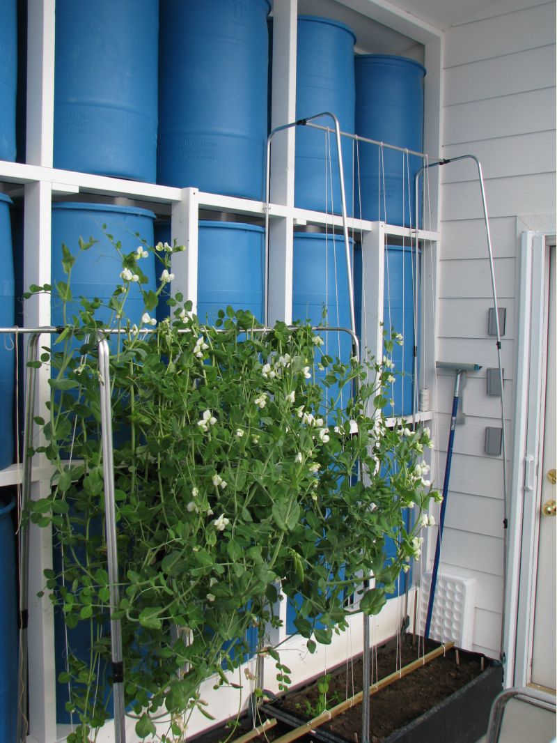

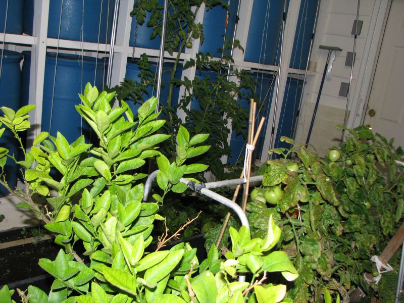

not to hijack your thread, but hattie...you line the interior of your greenhouse with barrels of water. even in the worst of winter? they don't freeze? I'm loving this idea, but still trying to get the full grasp. ![](http://www.small-cabin.com/forum/img/smilies/grin.gif)
# Posted: 9 Mar 2016 17:03
Quoting: abby you line the interior of your greenhouse with barrels of water. even in the worst of winter? they don't freeze?
We line one wall with barrels of water. They never freeze because the sun heats them in the winter. Bob took great pains to calculate the angle of the glass. In the winter, the barrels are in full sun. In the summer, the sun does not hit the barrels. We don't want extra heat in there in the summer as it gets 90+ degrees. In the winter we want as much heat as we can get. It works quite well for us.

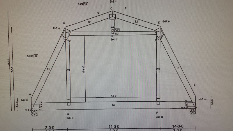

Truss engineering done and builder sent me a pic of the cross-section to see what I thought. It gives me a second floor of great space and a full ceiling below so I don't think the loft will get terribly hot from the pellet stove. There will be windows on each side of the loft, anyway, and I won't need the solar ceiling fan after all!
Don_P
# Posted: 16 Mar 2016 07:58
I can't see clearly enough, is headroom 5'8" or 6'8". Steepening the side pitches directly affects interior room. There is an aesthetic point there though. I agree with the ceiling joist, I'm not certain that W1's are necessary at that span if B1 and possibly T1 are upsized. That might be a personal call though. No doubt, as drawn is stronger. Another thought, you might also see if every other W1 could be cut to allow built ins. Not really onerous to ask those questions if desired. This was generated by a truss design program, I can often sit down with the tech and play through a couple of iterations like I just described, he plugs them in and it spits out the new member sizes and geometry, generally with the weight and price right there.

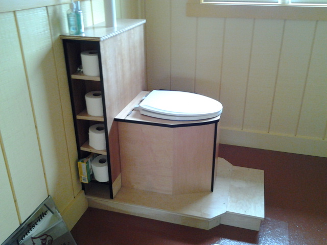

https://letterstocreationists.wordpress.com/2015/03/14/comparison-of-composting-toile ts-towards-a-global-commode/

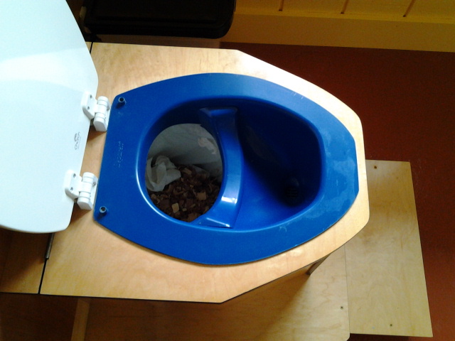

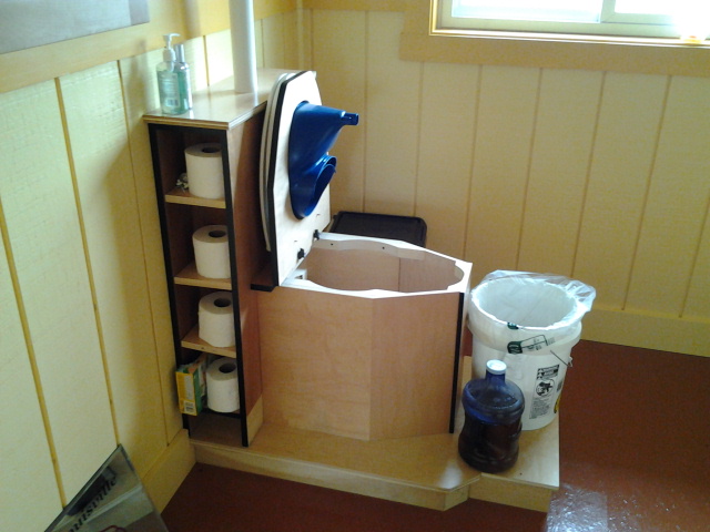

Good article on the various composting toilets available. We our using the Separatt urine diverter system. Bought the plastic diverter and built the throne.
It's been working great for almost two years![The throne The throne](https://www.small-cabin.com/forum/shared_files/uploaded/6474/96010_1.jpg) The throne
| ![Diverter Diverter](https://www.small-cabin.com/forum/shared_files/uploaded/6474/96010_2.jpg) Diverter
| ![All the parts All the parts](https://www.small-cabin.com/forum/shared_files/uploaded/6474/96010_3.jpg) All the parts

Quoting: Don_P I can't see clearly enough, is headroom 5'8" or 6'8". Steepening the side pitches directly affects interior room. There is an aesthetic point there though.I agree with the ceiling joist, I'm not certain that W1's are necessary at that span if B1 and possibly T1 are upsized. That might be a personal call though. No doubt, as drawn is stronger. Another thought, you might also see if every other W1 could be cut to allow built ins. Not really onerous to ask those questions if desired. This was generated by a truss design program, I can often sit down with the tech and play through a couple of iterations like I just described, he plugs them in and it spits out the new member sizes and geometry, generally with the weight and price right there.
Don, it's 5'8" headroom. Was hoping you'd weigh in because I have no idea what these things mean, lol. What are the Ts and Ws and Bs?
One big thing that comes into play for my area is seismic code. I read some of it (until my eyes glazed over, heh) and I know I'm in Zone D but don't know if I'm DI or II. But there were special requirements when it came to trusses and such. Could that be why there are more, um, thingies? ![](http://www.small-cabin.com/forum/img/smilies/ashamed.gif)
There's snow load, too, since I'm on a mountain but I don't think that's as much a consideration as seismic. Of course, I could be very wrong on that. When I spoke with the county guy, he said the code was 30 psf but perhaps when they put in my particular location it came out a bit higher.

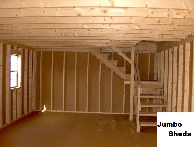

The steps to the loft will be something like this, although the angle will be different (less sharp). I found this pic online and sent it to my builder because the shabin is a gambrel, same size, and the steps are where I want mine.
The space in front of the steps will be my kitchen. There will be a window on the solid wall in the pic and I'll use the space under the steps for storage. The landing space would be perfect to stash my portable washer when not in use! Perhaps some storage for dry foodstuffs under the smaller section?

5'8" is your ceiling height? I was looking at the building code and found this: (a) Every habitable room and bathroom shall have a minimum ceiling height of not less than 7 feet, 0 inches for a minimum of 50 percent of the room's floor area. The remaining area may have a ceiling with a minimum height of 5 feet, 0 inches. Minimum height under dropped ducts, beams, etc. shall be 6 feet, 4 inches
Also, you must provide egress windows for a room used for sleeping.
An egress window must satisfy four International Residential Code (IRC) criteria:
• Minimum width of opening: 20 in.
• Minimum height of opening: 24 in.
• Minimum net clear opening: 5.7 sq. ft. (5.0 sq. ft. for ground floor).
• Maximum sill height above floor: 44 in
The window must have a minimum net clear opening of 5.7 sq. ft. Net clear opening refers to the actual free and clear space that exists when the window is open. It is not the rough opening size or the glass panel size, but the actual opening a person can crawl through.

Built this condensed version in a gambrel a few years back . Note the extra tread in the landing ,saves 2 sq. ft. of floor space , perhaps not to code but 2 sq. ft..
