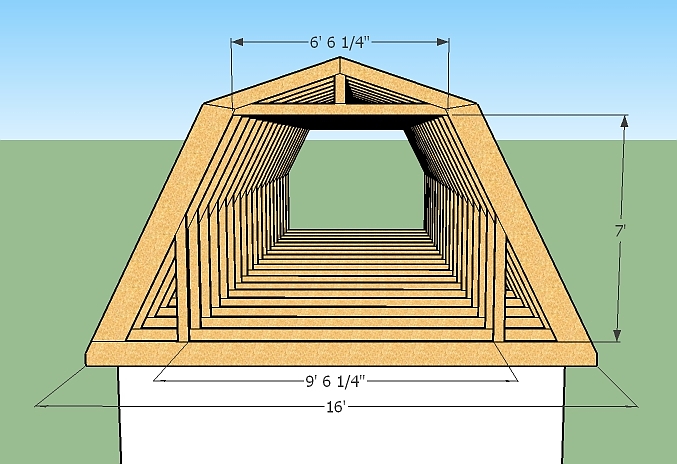

See if something along these lines would work. I've cantilevered the gambrel 1' to give an overhang and to launch from a wider base. Then I ran the same 24/12 pitch up to a 7' ceiling height... I drew 2x12's leaving room for insulation if you go with fiberglass. I moved the vertical webs out... this could give the truss tech heartburn, let him run it and see. He might be able to play with the cantilever and hit a happy spot too. Anyway, the looks don't hurt my feelings and it gives better headroom up there.
Rockies and I posted on top of one another... I do agree. Having said that, I built a 3 level home with one level prepped just in case for a client with lupus. It's been 15 years, she still has run of the house with wide doorways and the blocking is quietly there hoping not to be used.

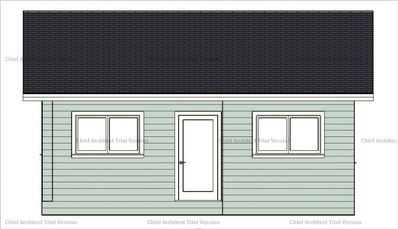

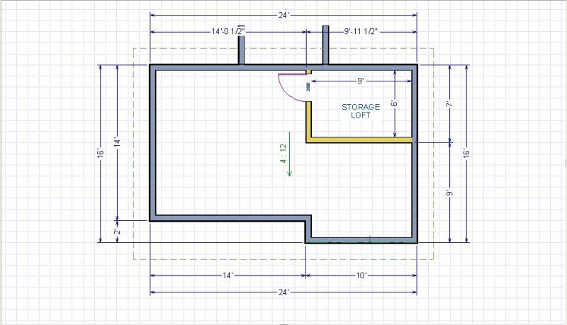

# Posted: 18 Mar 2016 20:07

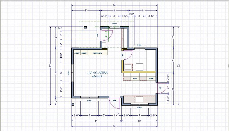

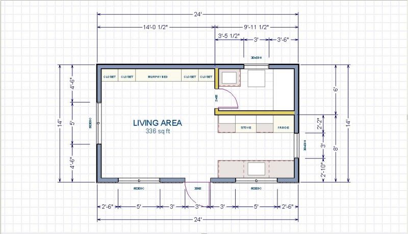

Here are some options for you to consider. The basic plan I've drawn up follows the same foot print as your chosen cabin (14' x 24'). It is all on one level with a full 7'6" x 9' kitchen, a 9' x 5' bathroom, queen sized Murphy bed and clothes closets. The south kitchen wall is a standard 8' high and the roof is a simple shed design at a 4:12 pitch. There is a small storage loft over the bathroom.
The intermediate plan has a 2' bumpout in the kitchen that widens the bathroom to 6' x 9' and kitchen to 8'6" x 9'. A mudroom with bench seating and coat hooks has been added to the north side of the cabin and the bathroom toilet and vanity changed to keep all plumbing in the interior kitchen wall.

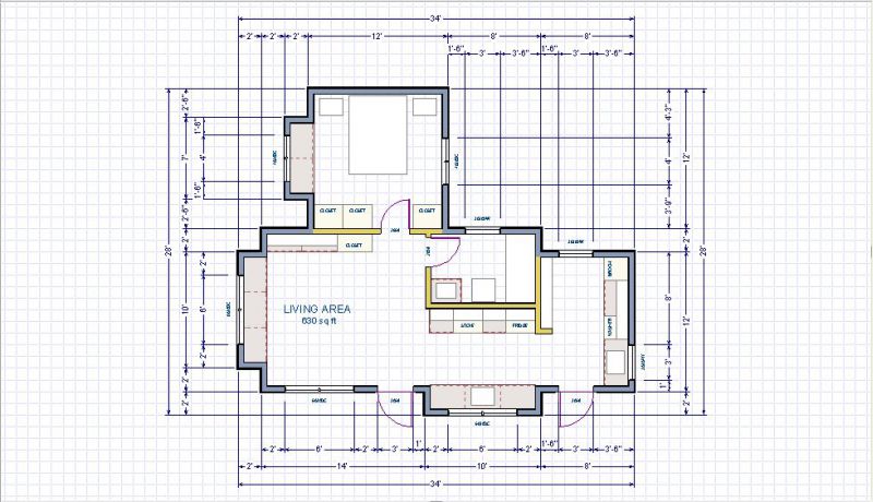

The delux plan shows what the cabin might look like if you decide to add a master bedroom to the main floor instead of the mudroom on the north side. A mudroom/pantry/laundry could be added to the east off the kitchen in the future as well.
Of course, any type of room in any shape could be added to the east, north or even west side of the cabin provided that framing is included in the wall to allow the easy conversion of a window into a doorway or the addition of a new door opening. All the current window and door locations and sizes could be changed as well

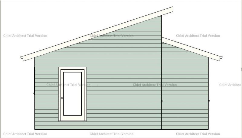

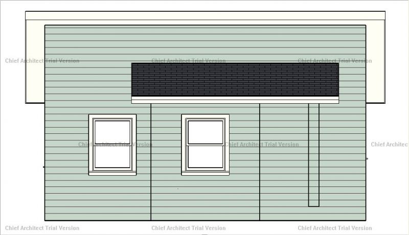

The elevations show the intermediate plan. This would be a simple to build, inexpensive plan in whatever configuration you needed and easily added on to in the future.![Basic Plan Basic Plan](https://www.small-cabin.com/forum/shared_files/uploaded/6474/96153_1.jpg) Basic Plan
| ![Intermediate Plan Intermediate Plan](https://www.small-cabin.com/forum/shared_files/uploaded/6474/96153_2.jpg) Intermediate Plan
| ![Intermediate Loft Plan Intermediate Loft Plan](https://www.small-cabin.com/forum/shared_files/uploaded/6474/96153_3.jpg) Intermediate Loft Plan
| ![Delux Plan Delux Plan](https://www.small-cabin.com/forum/shared_files/uploaded/6474/96153_4.jpg) Delux Plan

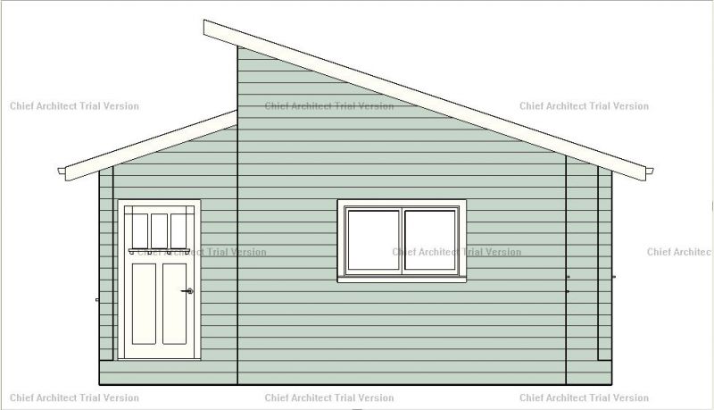

# Posted: 18 Mar 2016 20:09
Intermediate elevations. The living room bumpout containing a built-in sofa could be added to the intermediate and basic plans as well.![East elev East elev](https://www.small-cabin.com/forum/shared_files/uploaded/6474/96154_1.jpg) East elev
| ![North Elev North Elev](https://www.small-cabin.com/forum/shared_files/uploaded/6474/96154_2.jpg) North Elev
| ![West Elev West Elev](https://www.small-cabin.com/forum/shared_files/uploaded/6474/96154_3.jpg) West Elev
| ![South Elev South Elev](https://www.small-cabin.com/forum/shared_files/uploaded/6474/96154_4.jpg) South Elev
