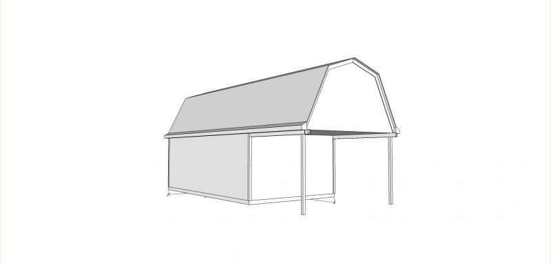

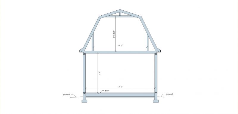

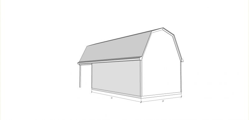

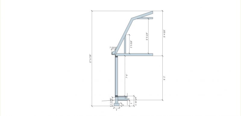

Well, the builder decided to consult with a different truss company, one that would be more responsive, shall we say. This one is located just 25 miles from my land, so that's a plus!
And he also came up with a new design for me to consider, putting the carport on the side rather than the back. Wowza. Obviously, this is just a sketch and the support beams for the carport wouldn't be sticklike.
This is no longer a loft but a second floor and if I do it, I WOULD put it to use. That would mean I WOULD put the full bathroom up there, in the area over the carport. Dedicated storage space, too. And since I'd be saving space by not having a utility room downstairs, I wouldn't put in a staircase that turns. Rather, I would do a longer staircase with a much more gradual incline/descent and wider steps, like I have on the outside of my current house.
I think I like the carport space on the side. It could lend itself to a screen-in porch in the future or another room, of course. I ESPECIALLY like having all of that space on the first floor solely for kitchen and living room. MAGIC!
The front door will be on the 24 ft. side, btw. Big windows on each side with window boxes for plants. A small slider on the side and I'll get creative with windows on the back. There will be a plain 36-inch wide exterior door from the carport. Windows in the loft, of course. An egress window over the carport might be good. Cabin1.jpg

# Posted: 21 Mar 2016 08:58pm
That's a nice style. This might help as well.
http://www.easyrafters.com/gambrel.htm

Good luck Julie, Do make sure the truss company is providing a stamped drawing... the drawings may be more conceptual but are a little "sketchy" looking in the details. If he got there he can get to 7' upstairs, go ahead and hit code as long as you're at it. Don't forget insulation room for whatever method you choose there. Look into using hardipanel or something fire resistive on the carport ceiling.
Julie2Oregon
# Posted: 22 Mar 2016 12:43am
Quoting: Don_P Good luck Julie,Do make sure the truss company is providing a stamped drawing... the drawings may be more conceptual but are a little "sketchy" looking in the details. If he got there he can get to 7' upstairs, go ahead and hit code as long as you're at it. Don't forget insulation room for whatever method you choose there.Look into using hardipanel or something fire resistive on the carport ceiling.
Yeah, Don, they will. The builder just sent the sketch over to me to make sure this design would be OK since the carport placement and size of the second floor is different from what we had discussed.
The loft ceiling is 7.1 but the center beam brings it to 6.5'. That's allowable by code for attic/sloped ceiling habitable space, right? (If I'm remembering correctly, it is but I could totally be wrong.)

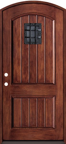

I found the front door. Looks like I'll be driving to Houston in the near future and hauling the thing to Oregon with me, sigh. But this is the best price for a speakeasy door that I've ever seen by many hundreds of dollars. Have NOT seen a speakeasy with an arched top. Gotta do it. This is my one cabin splurge. The front door is important to me. It turns the shabin/barn into "home."

I love the door!
