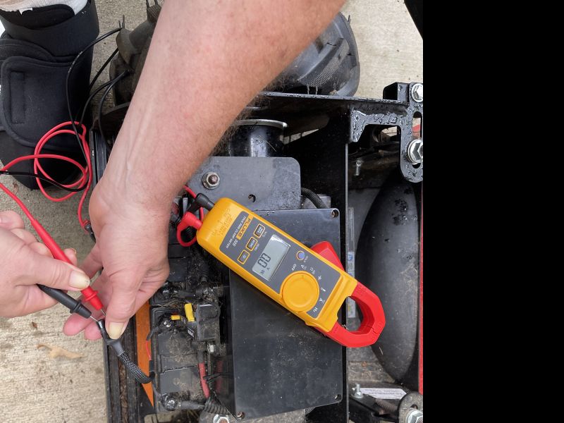

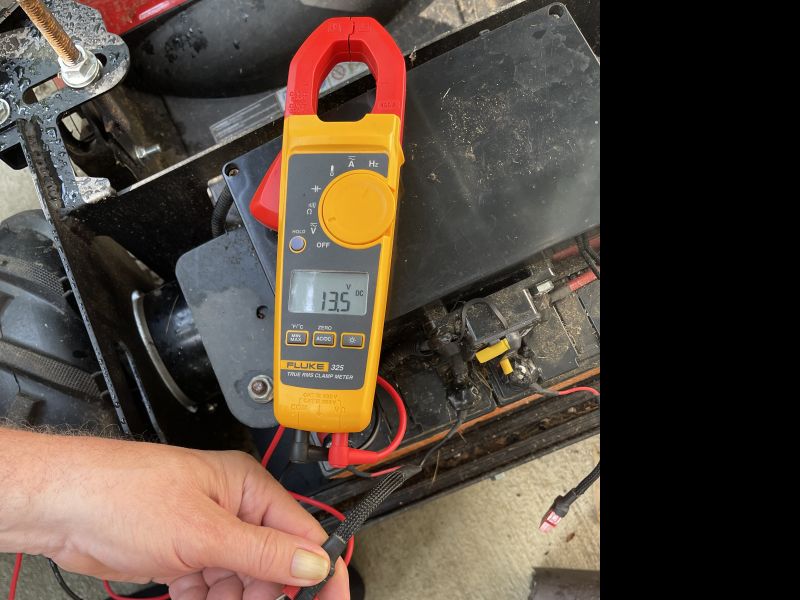

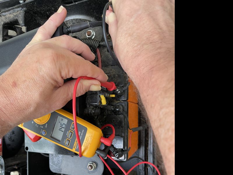

battery pics.
# Posted: 4 Aug 2024 11:33am
Well that doesn’t look good. Did Super Droid get back to you about replacing it? If you end up with that duff battery one way or another, my inquisitive (and bored) nature would want me to try and find out what happened. Is there an open in there somewhere? Every cell gone out?
Grass must be getting long
# Posted: 4 Aug 2024 12:44pm
Break out the Dremel for a pop top job?
This reminds me of when one of my multi-bat flashlights wont work it is often just one bad bat.
# Posted: 4 Aug 2024 02:46pm
I opened up my dead chainsaw bat, just screws. Found a dead cell but there was so much solder and wiring in there I gave up. At least I could do that. That 10 volt car fla I was fooling with showed one dead cell with the hydrometer. I tried to flush and refill it, no luck. It’s in the core pile now, for good.
# Posted: 8 Aug 2024 01:10am
Yes the grass is long.
When I Google LiFePo4 battery warranty, I find examples of 5-10 years.
I emailed the mower manufacturer, Super Droid Robots with this info. They replied they only warranty the batteries for one year. So I emailed the battery manufacturer and they replied they warrant their LiFePo4 batteries for three years.
I forwarded the email reply from SHENZHEN CBT POWER showing them the three year warranty and demanded they honor the manufacturer's warranty and replace this defective battery.
# Posted: 9 Aug 2024 07:01pm

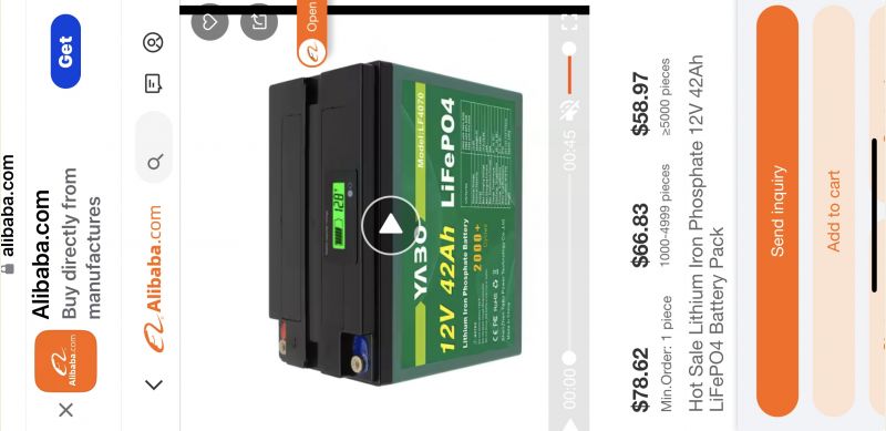

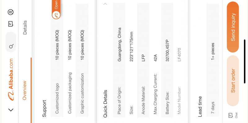

Super Droids Robots replied to my email. They won't honor the manufacturers warranty. Can any of you guys look at the pictures and tell me what format this battery is? I know car/truck batts are type 31, etc.

I am not aware of group numbering applicable to this battery type. I have used either or both the Ah capacity needed and the actual dimensions of the old battery to help in finding a replacement.
I have bought numerous batteries, LFP and Li-ion from batteryhookup.com. A few weeks ago I got a 34 Ah LFP for a power gate, with 30 amp BMS for $55 + shipping. I had several items in the order. Might be worth a look.
# Posted: 10 Aug 2024 12:01am - Edited by: paulz
I too have not seen those size batts by ‘type’. I sure wouldn’t pay $600 something for what super droid wants. Same dimensions as this one?
# Posted: 10 Aug 2024 12:47am
Dave, with lfp you don't have to age match or ah match the batteries. Your real limit is the bat box.
See if you can get a matching volt bat (24?) and 'somewhere close' to your 42ah? that will fit in the hole.
Amazon has had some good prices of late.

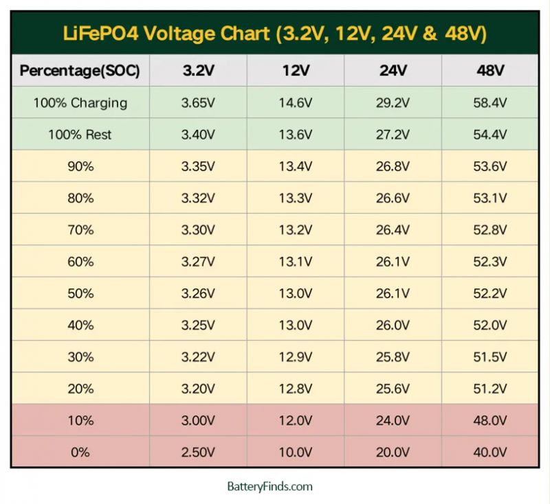

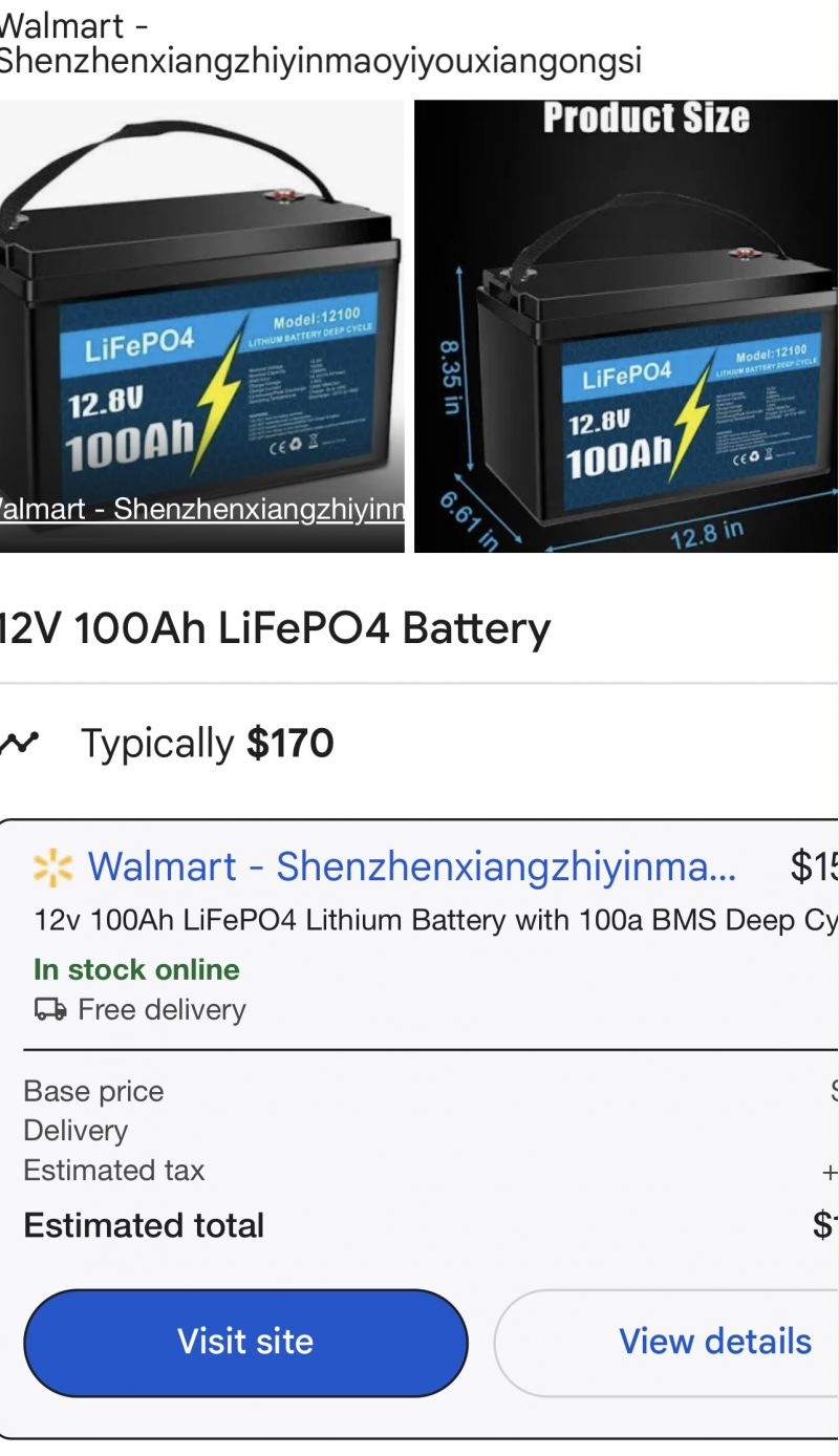

Why are these new lifepo4s labeled 12.8? The charts I see say that’s only about 20% SOC. That’s been panic mode for me.

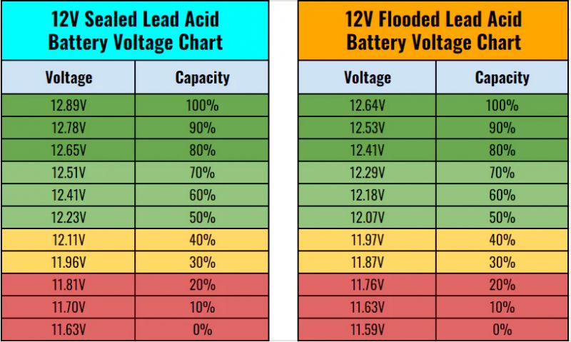

# Posted: 4 Oct 2024 03:02am - Edited by: ICC
I'm not sure what you are comparing to. LFP batteries that are labeled as being a "12 volt" battery have always had a nominal voltage rating of 12.8 volts. That comes from having 4 cells of 3.2 volts rating.
Don't confuse the nominal voltage rating with the actual voltage at various states of charge.
Below are images of two charts, one for LFP and the other for lead-acid. You can see that a 12 volt lead-acid battery also has a range of actual voltages at different SOC. (different charts may have slight differences in voltage at various SOC)
LFP
LFP
lead-acid
lead-acid

Ahh marketers.
A few companies like this one use the NOMINAL Voltage which is 3.200Vpc X4 = 12.8V
Some companies use 3.650 (Top of Allowable Range) and will advertise their batteries as 14.6V
I've never heard of that brand.
100AH cells are retailing for around $32ea USD
A dumb BMS (no balancing, Bluetooth etc) about $20
ABS Box to put it in about $15
* USD Retail with basic discount.

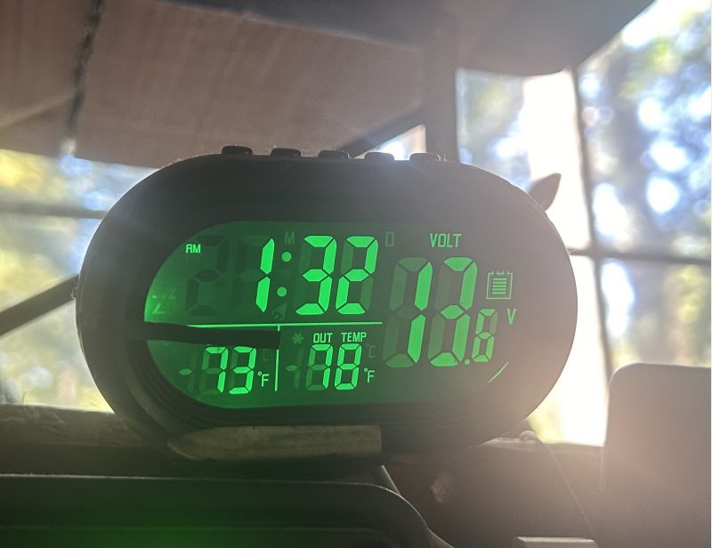

# Posted: 4 Oct 2024 02:24pm
Got it, thanks guys.
My days of summer Off Grid Bank Fat City are slowly coming to a close, seeing 12.9 mornings occasionally got me wondering if my old LFPs will go another winter. So I was looking at maybe grabbing a couple new ones to have around here, can’t just run down to the Auto Parts like the cars (although you can run down to Walmart now I guess). Anyway going online and seeing 12.8 labels threw me.

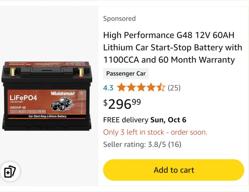

Noticed these, Lfp starter batteries with posts? What’s with these?
# Posted: 4 Oct 2024 03:10pm
Paul, honestly those scare the hell out of me ! Car alternators are not designed for anything other than Lead/AGM and have the wrong voltage/amperage setup. So many have gotten screwed one way or another, either blowing battery pack and/or frying the alternator... this applies to cars/trucks & "boats" who learned long ago. Doesn't matter what Lithium chemistry either.
Cold Cranking is quite possible for Li based batteries as long as the cells & BMS handle it and many do, usually targetted for trolling motors though.
# Posted: 4 Oct 2024 06:28pm
Many have burned out their alternator after installing a lithium starter battery. The lithium can accept so many more amps than lead-acid and can cause the alternator to overheat.
# Posted: 4 Oct 2024 08:53pm
A friend with a fishing boat kept his LA starting bat when he switched to LFP for the 2 trolling motors. He runs an inverter off the starting bat which charges off the engine alt) to his LFP charger to keep the trolling bat charged up. He has been running this system all this year with great satisfaction.
# Posted: 5 Oct 2024 02:53pm
This auto Lfp is a new thing to me (yes I was hiding under a rock). Seems like the holy grail, perhaps they have jumped the gun? And assuming they get the auto alternator issues worked out, there’s still the low temp problem. They have them with heaters now too, and BMS should handle any charging issues?
