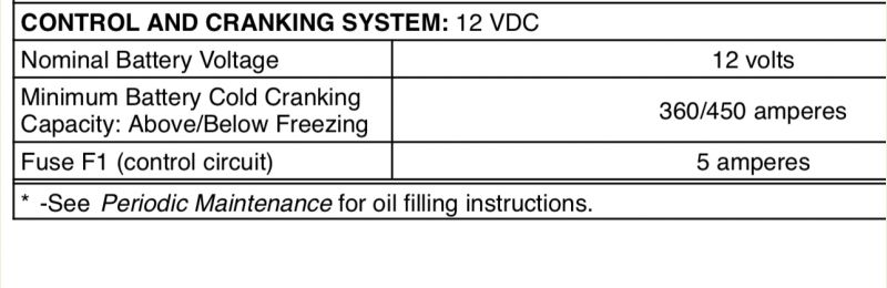

I did use it to crank over the Onan 2800 under the van which draws <25amps
Found in my Onan manual it takes 360-450 amps to start. It’s a 2 cylinder.
Also saw some Onan Lfp discussion on diy solar.

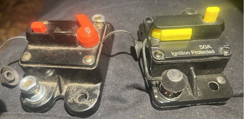

Good idea on the fuses. I drove the cart a couple times today with the Lfp, no problem. But it did start right up. I still have some halfway good flas but when they die LFPs would be nice. No heavy lifting, no battery tenders…
Found some leftover 50a breakers from my cabin wiring, I’ll try those.

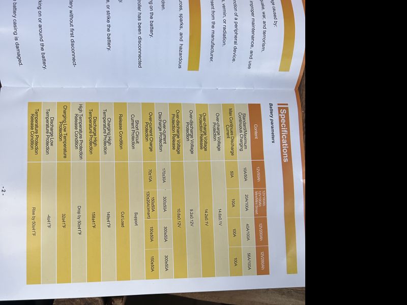

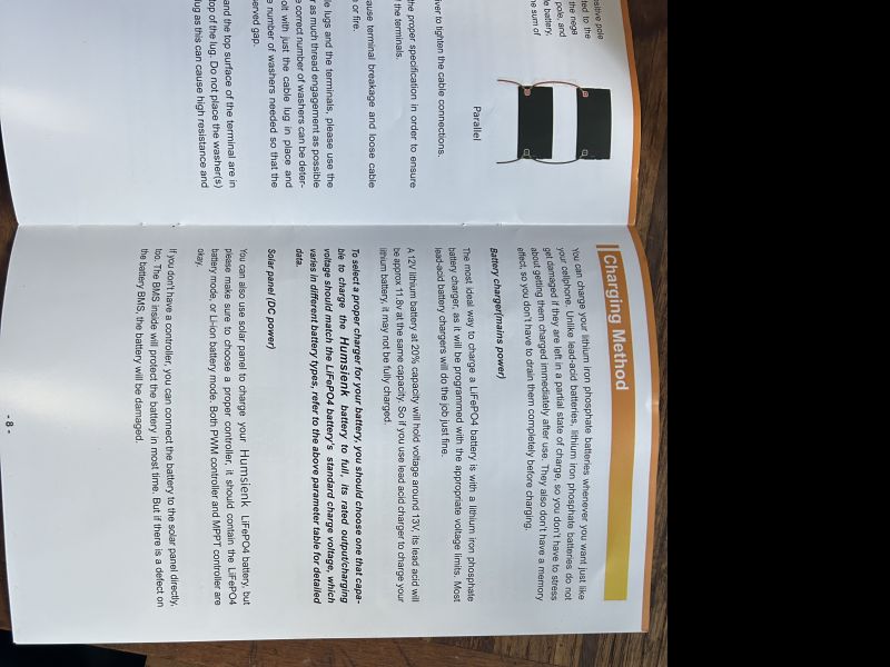

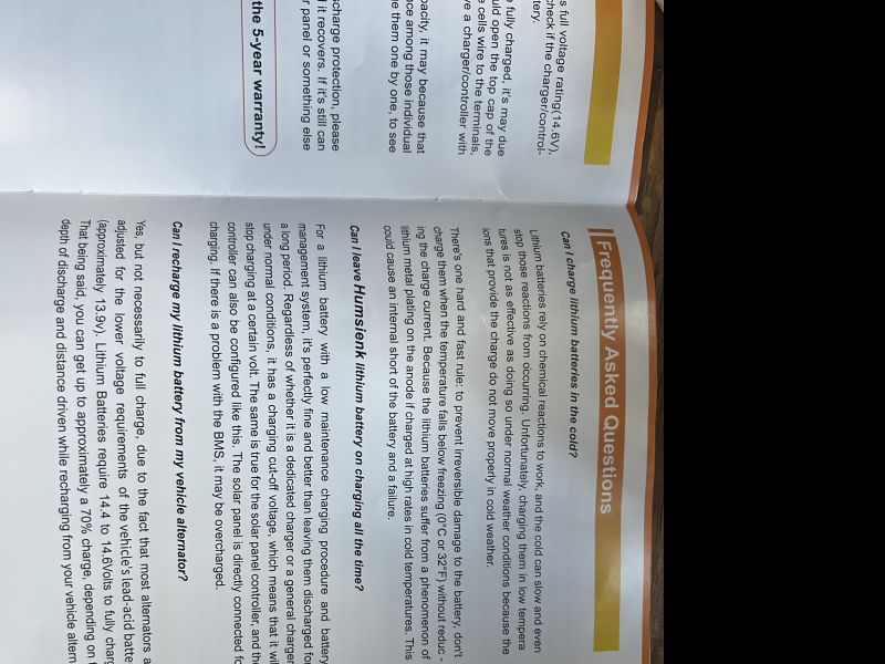

Back at the cabin. A couple bits from the booklet.
