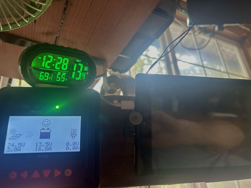

Couple more things:
Came inside after a few hours this morning and saw the voltage at 13.4, after 13.1 this morning! Solar says 16 amps coming even though not a patch of blue in the sky, just quit raining matter of fact. Maybe that washed the panels off. or blue sky not necessary, light gray ok.
The Epever Tracer controller display says 13.5 I know, but it always reads higher than a VOM, which matches the 13.4.
Next thing, speaking of Epever solar controllers, I have a second one down at the shop with just a couple panels and FLA car battery hooked to it. Again minimal sun and the battery only supplies a couple led lights and motion detection trail camera. But the fla keeps going dead, tried a couple known good ones. My question is can a controller use that much juice? I do get a decent spark from it when I hook it to a battery. Something wrong with it maybe? I do have a spare little Renogy controller, one of those little black things, maybe I’ll try swapping that in.

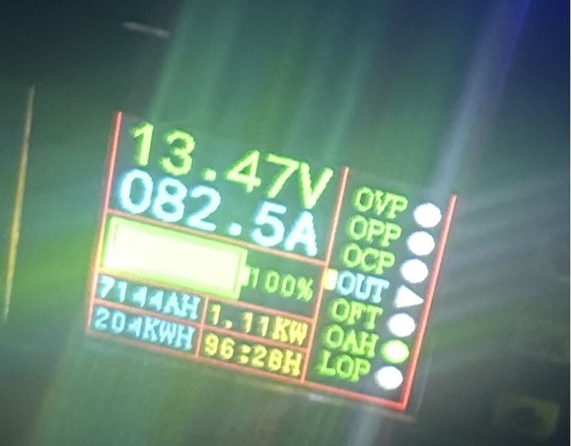

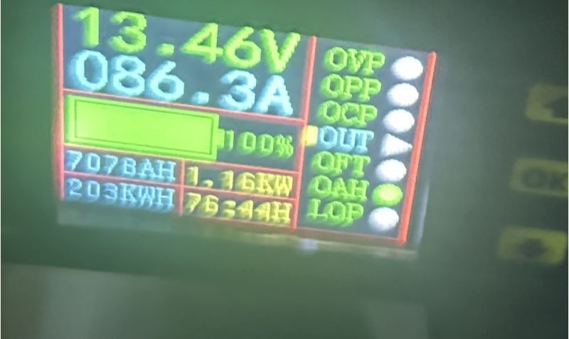

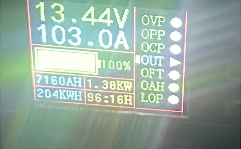

Yay! I had left all 3 chargers hooked up after quitting the other night. This morning I figured I would run them one more time. Bank was low, about 13.0-1, sunny day with some solar coming so no big deal. So I fired up just the big genny, plugged in all three and 101 amps! After 5 minutes of that it had dropped to 86, battery resistance going up I guess. Turned off the genny, bank now at 13.2.
Gonna leave em all hooked and test again tomorrow morning.

Im sure no expert, but my gut tells me that the bat-bank voltage is 'reading off' and that your bank isn't near as depleted at it looks like.
Why? Because I would not expect the bats to come up that fast to that reduction of amps; ie, the recharge in 5ish min to that kind of internal resistance doesn't seem right.

A battery that seems to recharge very quickly can also be a battery that is failing. If it doesn't have much good capacity left it can seem to recharge fully quite quickly, but when used not have the full rated capacity.

Nothing Wrong there ! No they are NOT worn out.
Here's the deal and this is where MANY get confabulated with the new chemistries.
You charge your batteries to the proper 100% Voltage regularly and the cells within balance out quite nicely (valence always used great cells). The chemistry is "Fully" active since commissioning and you've kept them that way and haven't abused them (frozen, deep discharge to 0% or super high stress loading etc). HAD this not been the case, charging at Higher Amps would take longer.
There is a few things at play which causes some confusion.
- Charging from 2.500 to 2.900 volts per cell is quicker due to the chemistry curve. It's that "cliff fall" segment of the curve.
- Charging from 2.900-3.500 is slower because the curve there is very very flat, it "looks" slower due to the slow incremental gain. Remember 3.0-3.4 is the "delivery segment" of the curve.
- Charging from 3.400 to 3.650 speeds up as that is the other side of the Hockey Stick curve (beyond the working/delivery range). This is also were the Resistance climbs FAST and drops the Amps being taken in.
* This is where it gets a tad confusing if you are "Eagle Eyeing" the charge process because you see the change in Voltages & the Amps taken change fast .
Again, remember that the Deliverable Amp Hours come from that 3.000-3.400 (12.0-13.6) Volts per cell range and most use down to 2.8/2.9 volts per cell (moderate usage profile).
The PARALLEL GOTCHA ! Ohh yeah, like everything, gotcha's lurk to get ya ! Ohhh such fun !
-- Assume you have 3 Packs, all identical (age, wear and "tested" AH Capacity).
(A) These will all charge equally and take the same Amperage per pack nicely. They will lower amps taken in unison and top-off balance politely. That would be monitorable at the pack terminals.
(B) Packs with different wear/tear & slight AH Capacity Loss. These will all take full Amps when low, but as the charging progresses, the packs with lower capacity will hit their "full" first and drop amps taken while the Fresher Packs will take more amperage (think of it as saturating a sponge, more capacity = more sponge) and ultimately they will lower the amps taken till Endamps is reached.
* This can be monitored & replicated. IE put a 100AH & 120AH pack in parallel and you can replicate the effect. 100AH will fill & drop Amps while 120 will take some more & follow suit as it fills.
PSST: remember I was running 1x105AH, 2x175AH & 3x280AH in my bank for quite some time, and other combos & setups as well. Some PITA factors to work out when doing so.
Paul, we do not know the true status of these batteries because you haven't been able to do a full & proper capacity test on each battery individually. They are all likely fairly close but not exactly (you don't know what kind of life they had before). It's likely safe to assume that they likely have slightly different "true" AH capacities, maybe 5AH difference or so.
I suspect, what you saw was they were already 13.0V/3.250vpc (3.200 = 50% SOC) and the 101A was split and delivering 33.6A to each pack. So the Internal Resistance was already in play (@ 12.0V/3,000vpc they would have taken 40A). Now if "A" cell or cells are diminished a bit, they will increase resistance a bit faster & lower the input amps accepted. The Batteries in Parallel will try to share/divide all incoming & outgoing power and by chemistry, they do this proportionately relative to their actual capacity.
Confused yet ? Sorry I think I got a tad circular but letting it stand.

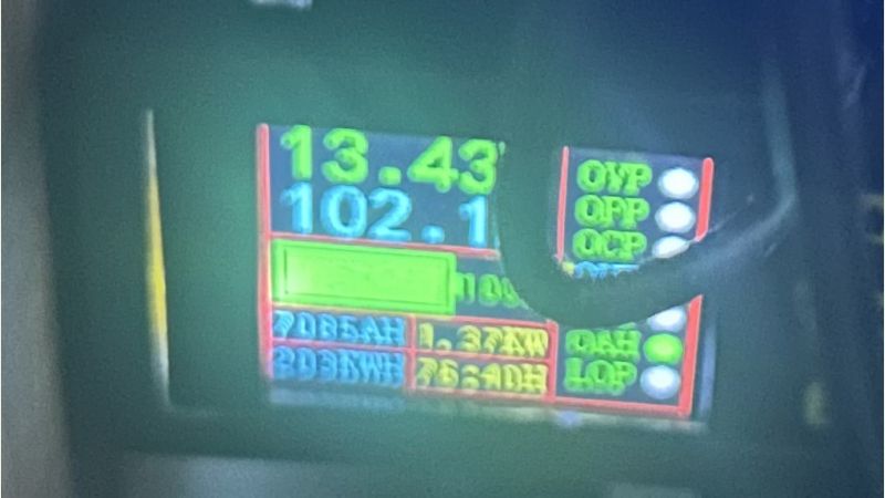

In the mean time, I repeated yesterday’s test just now since all still plugged in. Bank was at 13.1, been there all night, didn’t pay attention to second decimal place. As soon as I waddled inside after firing up the genny, less than one minute, it was at 103 amps. Verifies that all three Meanwells are in fact working, and cabling/genny too. In 10 minutes the amperage had dropped to 82. Turn off genny, voltage now at 13.2.
Sunny weekend predicted, should be at 13.3 from solar when I get back Monday. We really didn’t need the genny all week, voltage stayed between 13.0 and 13.2 just from solar. Hit the high 30 degrees this morning, fridge outside stays off a lot I’m sure.

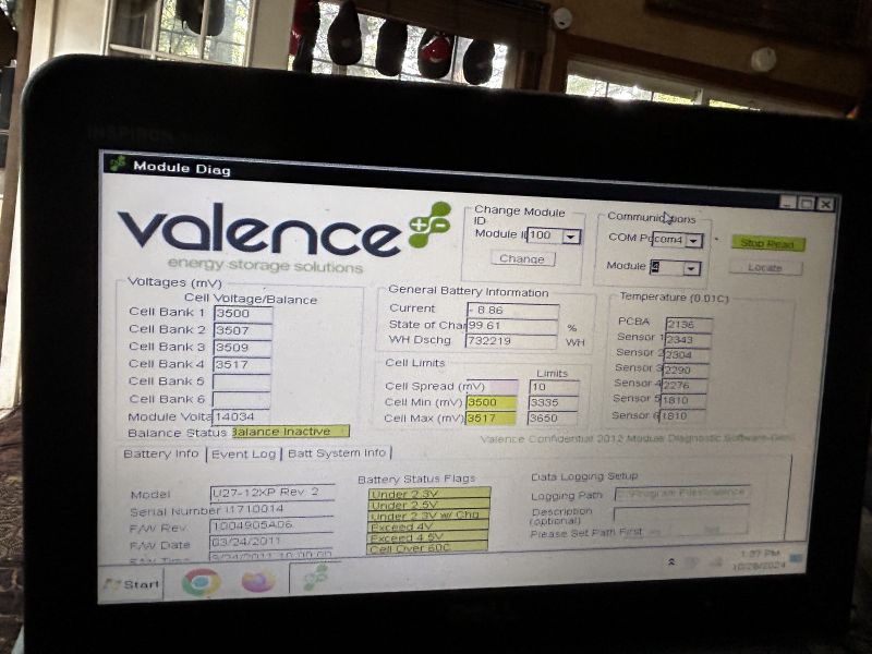

Gosh... I would really love to see Screen Captures from the Valence BMS Software for PC. I know that software is out there and some folks have it available but not sure where.
I also made a USB wire setup that attaches to the bank like the video you posted and connects to the Valence software I have and have been posting photos.
I don’t know if it’s the same software though and I myself am limited by the laptop I have. It’s a small old Dell I’ve had for years and only use for this. It has Windows 7 or 8, upgrade no longer supported. It won’t show the bottom part of the Valence screen shown in your video. I have tried turning orientation sideways, shrinking text, scrolling down.. won’t do any of that so I don’t know if there are additional display or BMS entry options I’m not seeing, again as shown in your video.
Again thanks for helping Steve. If I get a newer laptop I’ll try that. I’ll be giving that laptop away when the batteries die, package deal!

Win 7 Forward came with a tool called SNIPPING TOOL. It lets you capture the screen or just a part that you highlight. After Win-10 they added a few more similar tools but with some extra funds. That is what I use for my screen grabs that I post.
You can save the Screen Captures as JPG, PNG etc to your desktop or a folder.
the Valence APP should have the std icons on top right to allow you to go from Full Screen to Windowed which will then let you scroll through the entire APP screen and even shift it around a bit or scale it by dragging the sides or corner tabs.
You can see those Icons (I see them on the photo) so give that a try.

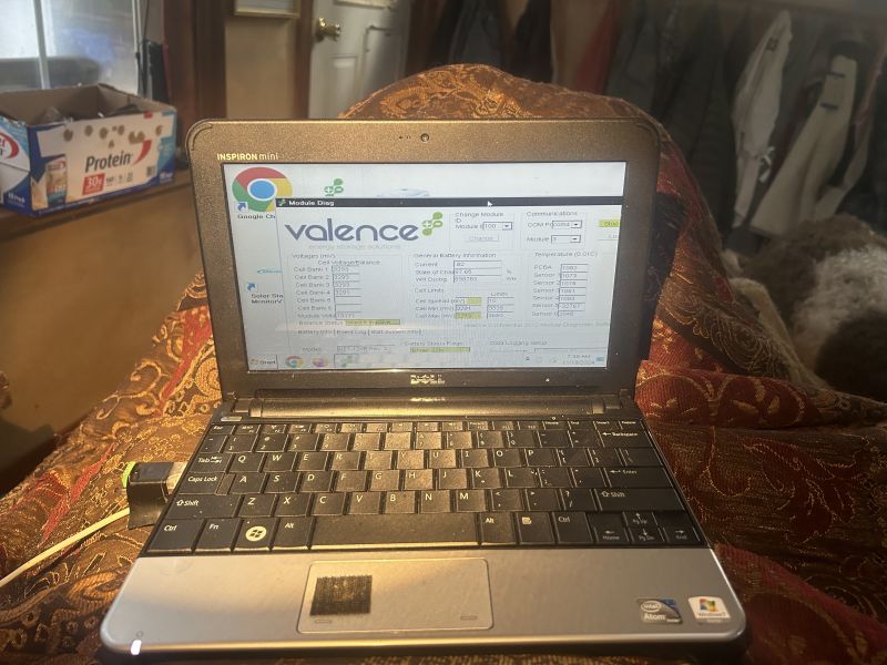

I’ll try your suggestions on that laptop when I get back to the cabin late Monday. Mean time I’m at the grid house, desktop PC, space heater, TV, fridge all plugged into the wall, the easy life. I’m paying a PGE minimum bill here I’m sure, might as well use it.

Playing with that old laptop Steve. I can move the app a little, only by holding cursor on the blue bar. It will go left and right, up and down but won’t raise the bottom. Ctrl plus or minus doesn’t do anything. It does min and max with those icons you mention.
# Posted: 20 Nov 2024 06:14pm
Hmmm Haven't used Win 7/8 in a very long time... subtle differences.
When you move the cursor over the sides of the App Window, it should change to something like this: <--> which would let you stretch/shrink the app window.

Hi Steve,
It does show those arrows, left right and top, and I can move the valence screen in those directions, but no arrows at the bottom where I really need it. Windows 7.

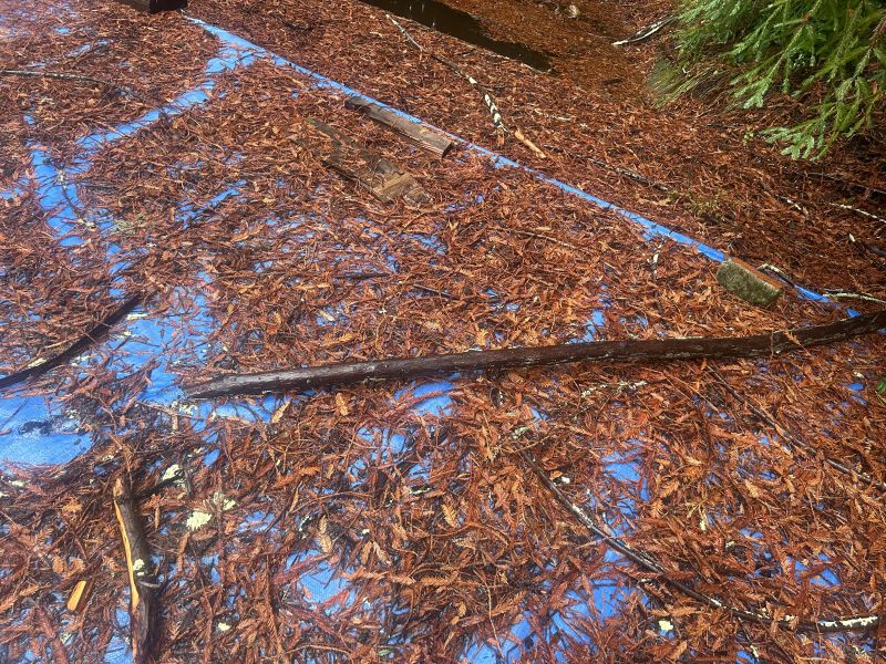

Found that falling limb bang from yesterday on the way out. It went through the shop roof, loud enough that it sounded like the cabin. Just put buckets under, more work next week.
That redwood duff is everywhere, including the solar panels. Oh well, if we’re going to sell the house and live here year round better get used to it. It was kinda nice last night, rain beating on the roof, fire going.. Until venturing out this morning….

Well been back at the cabin 3 days now. Quite a storm it was. On the bright side, no additional damage, cabin pulled through well. A few minor things gave me a workout:
The cover of the pop up awning covering my gas genny blew off, I guess some water found its way in and it took some time, carb rebuild, to get it going.
Same with the washing machine. Wife’s pile of laundry died halfway through. Just after I hand rinsed everything the stupid washer lights started working again. Right after I dug out the manual that said “unplug for five minutes and try again”…

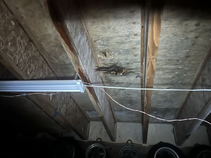

Then it was down to the shop to pull the branch out of the roof and patch. Did that, but plywood still wet and no rain expected for a week so letting that dry out more.
Stopped on the walk back up to pick and shovel a rut the rain put in my nice asphalt gravel driveway. Did about ten feet but slipped and hurt a hip joint. Limped back to the cabin and called it a day.

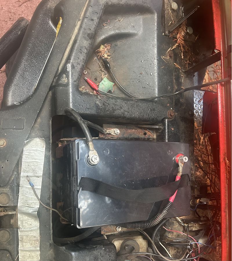

Been at the cabin trying this new 100a Lfp. So far just ran the TV and modem for a few hours.
I’m thinking about trying to start my cart with it. It has a Honda Vtwin, 20 hp or so. Runs off the magneto once started. I don’t have the charging system hooked up, just hook it to the solar when sitting.
I don’t see a CCA rating, it does have a 100a BMS it says. Will that come into play if I try and it has a problem? I see they sell Lfp motorcycle batteries, maybe they are different.

If a LFP battery doesn't have a CCA rating, it's not suitable for engine starting. The instructions for the LFP battery I'm using to power the fuel pump in my plane explicitly say not to use it for engine starting.
# Posted: 11 Dec 2024 06:25pm
I believe it's the BMS that can be damaged by too high a current surge when used as a starting battery if the LFP battery is not rated for cranking.
As an aside and FWIW. I have an LFP battery in a dirtbike and an ATV. When it is cold, like now, it fails to crank the engine because the battery has reduced output when cold. That issue can be sidestepped by turning on the headlight before cranking. It takes a few minutes for the discharge current to warm the battery sufficiently to crank the cold engine. That takes a leap of faith as it goes against everything I grew up with regarding cold weather starting.

Thanks Guys. Nothing in the manual about CCAs or engine starting. It does list Over Current Discharge Protection as 300 amps. Best I could find for Honda GX batteries was 18ah minimum.
Sounds like it would work, or at least turn off if not. But I have no great need, the little LA cycle battery it has in it works fine.

Curiosity got the better of me so I tried it. Started right up, however I did give it its usual 15 second turnover on the choke first with the old LA motorcycle bat. Lfp was already down to 13.1 from cabin testing.
I figured these Lfp bats have to have the umph to do other small things, water pumps etc and this engine can be started with a rope pull start, not like a car engine.
I’ll try it again tomorrow on a stone cold turnover.
