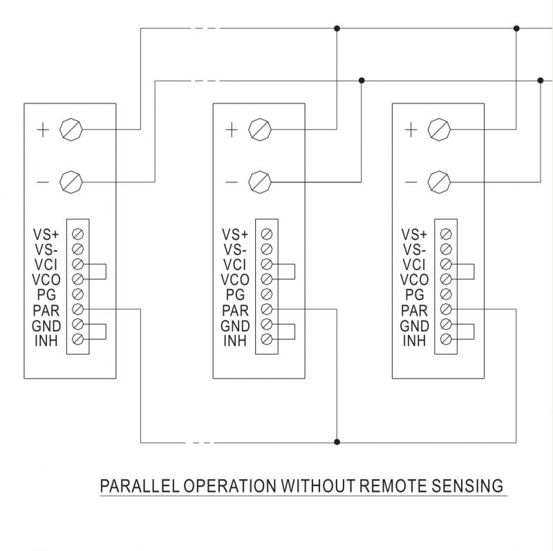

Hmm, interesting, if I understand. These Meanwells have parallel operation jumpers, which I have connected. What that does I’m not sure. They also have a voltage adjustment screw, up to 15 on mine.
Very sensitive, 14.2x about the closest I can get on each. The bank of course is at 13.

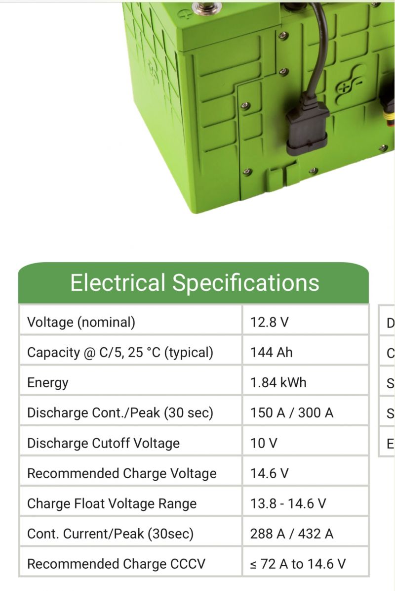

Good question. These Valence batts don't have bms in the common (modern?) sense. They have an led that blinks green about every 30 seconds and also plugs that connect them together and connect to my laptup and provide the pictures I've been posting,. There is apparently additional Valence control software the hospitals used that I don't have. I do have a Victron low voltage disconnect.
All that said you would think a 140ah battery could take in more than 20 amps.
https://www.lithionbattery.com/wp-content/uploads/2019/12/Valence-U27-12XP-Data-Sheet -210623.pdf
You would think that. However, 20 amps would be quite safe. The user manual for my SOK 24v100A recommends a 20-amp charge but also states a maximum of 50 amps. My solar panel at the cabin seldom puts out more than 20 amps, so I am quite happy.

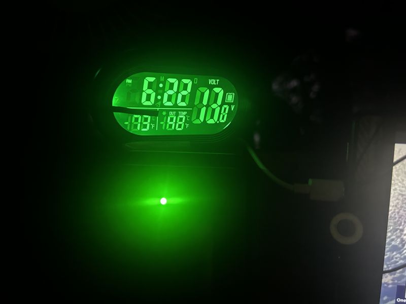

I have both 12v 100ah lfp's back home now, pulled Bat2 from cabin at 12.6v. Ran an old headlight and found after 1.25hrs the lvd tripped at 11.8.
This is the bat that I found the hvd at 14.5 previously reported on this thread.
Bat1 has been sitting in my basement for the past 5? weeks at 13.1, and it has held that steady and fine.
Putting the light on it the v dropped quick to 13.0, 6hrs! later it was down to 12.2. Surprised me that much life left.
I kept going looking for the lvd, went all the way to 10v (2.5v/cell) and stopped, NO bms disconnect!
I charged it for 1.5hrs tonight at 13.8v on the Meanwell, will finish it off tomorrow looking for that hvd or 14.6 tops, whichever comes first so I Know just where it is. If I don't get a top trip like I didn't get a bottom trip I will be concerned about the bms.
My intent is to document the high/low for sure and certain.

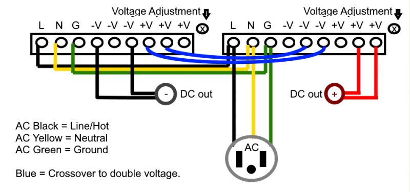

Way back somewhere in this thread or another I posted a diagram with my paired set, which are a "Knock Off" Meanwell type supplies, very close but not quite the same.
Attached is the Diagram of how mine are setup.
CLONE s600-12's paired

I goofed my verbiage, Meanwells calls it parallel operation, not paired. Looks about the same though. This is how mines wired. So what does “parallel” do?

The way mine is setup, it doubles the volts & amps out, otherwise they are 12V/25A max ea. I did download some actual meanwell manuals a ways back and I recall they have different models that can be wired in different combinations. Nature of "industrial" general purpose supplies I guess.

I ended up with these "Knock off Meanwells" way back when I bought an assembled LFP Pack that included this "setup". Of course no docs of any kind and similar but not quite the same as "Genuine" meanwells.
I've used that setup a couple of times for testing, including during my Thrash Tests. They do the CC/CV charging quite nicely & cleanly, especially after I cleaned up and upgraded the charging wires. The original wires go too hot to touch, way too small AWG to carry that current and No More "Aligator Clips either" bloody cursed things...

Thanks guys. Still digesting your posts but for now, the Valence spec says 70 amp cccv per battery I think. And I did test the Meanwells individually, each putting out the 40amps.
